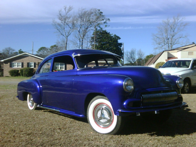

    Here is mine. Stock front suspension and 3" lowering blocks in the rear.

    That's a good looking Chevy!

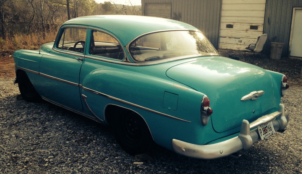

    1.5 coils cut in the front with stock replacement shocks and 3" drop blocks in the rear with the bottom leaf removed. Need to throw some new rear shocks on yet and cut the rear bumpstops down a bit. May lower the front a hair more, but I want to drive it a little more to see how it all settles out.

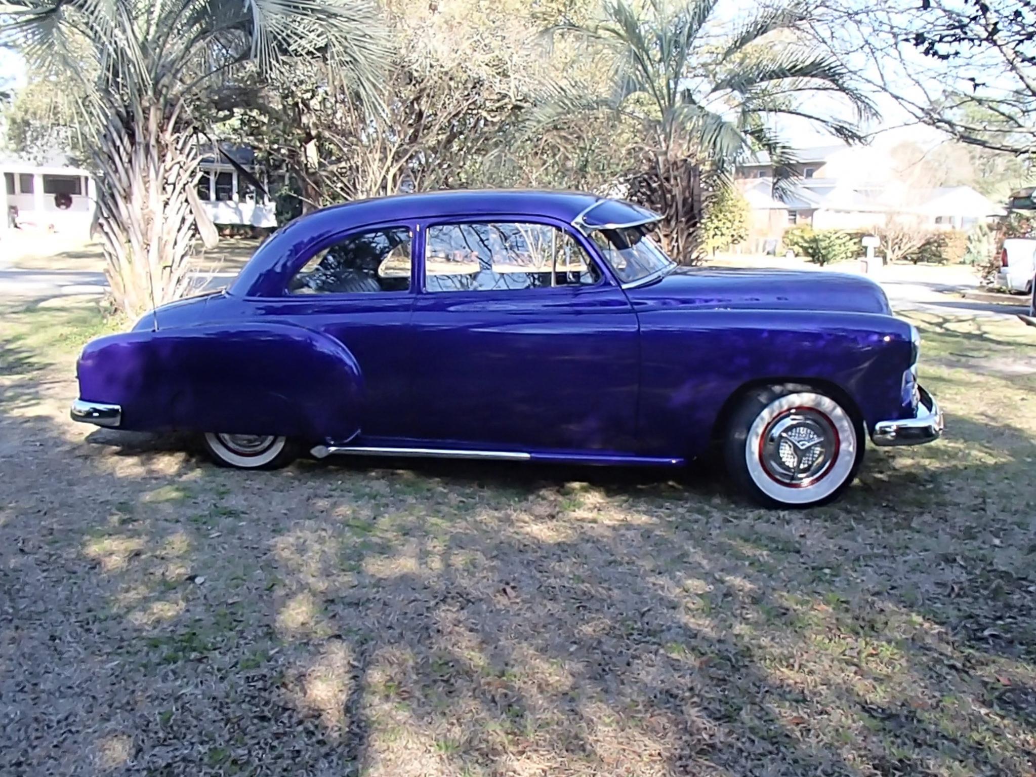

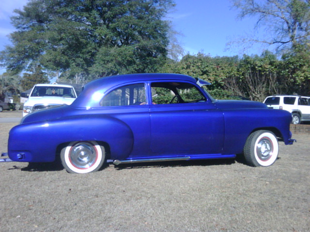

    20140608_080849.jpg 20140608_080817.jpg I went with 54 uprights and cut just a bit over 1 coil up front. 3" blocks in the rear.
    It rides really well but thinking of stepping the control arms up front and going back to stock springs to help with camber adjustment.

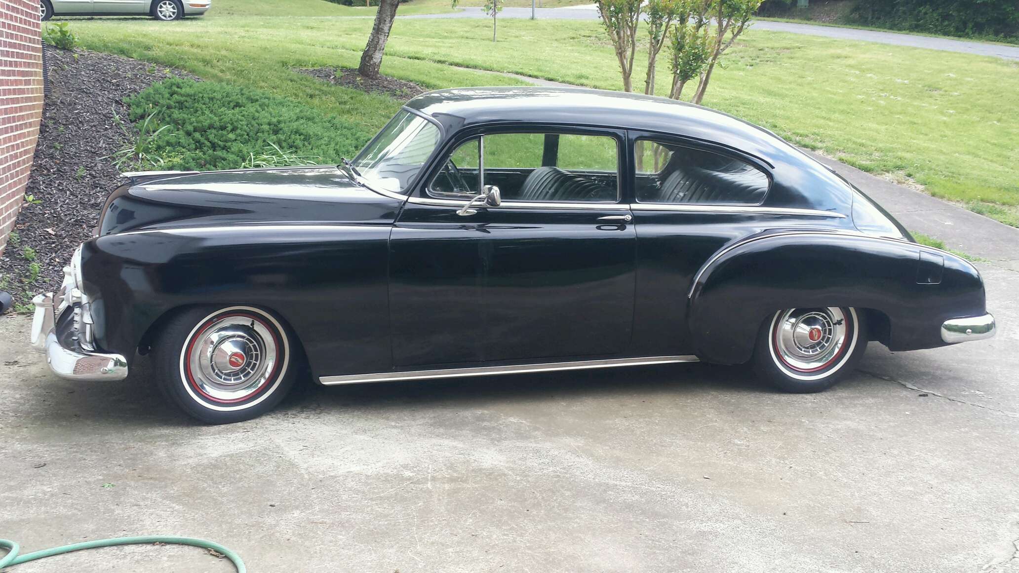

    011.JPG My daily beater, family more door. I dropped the back with 3" blocks. No issue with anything unless I have the car loaded down with people and trunk full of stuff. If so I tap the frame on a hard bump. Front is next. Just one coil. I like the tail dragger look.

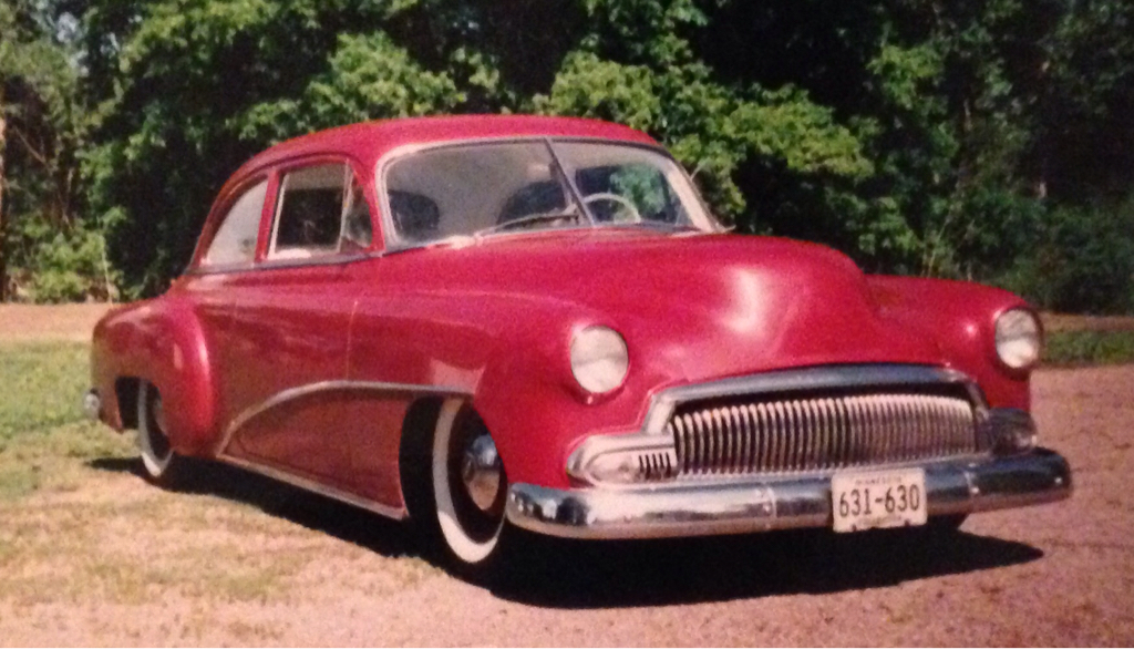

    Here is a 52 I did back in the eighties. Stepped a arms, 54 uprights and cut coils (1 1/2 rounds) up front and 3 inch blocks out back... Boy I miss that car, it went in my divorce sale....3250 bucks in 1991

    That's damn near perfect in my eyes.
    You just sealed the deal for me on the stepped control arms. Any issues with that setup?
    Also, is that a 54 column or did you cut down the original? Would love to see more pics if you have any.

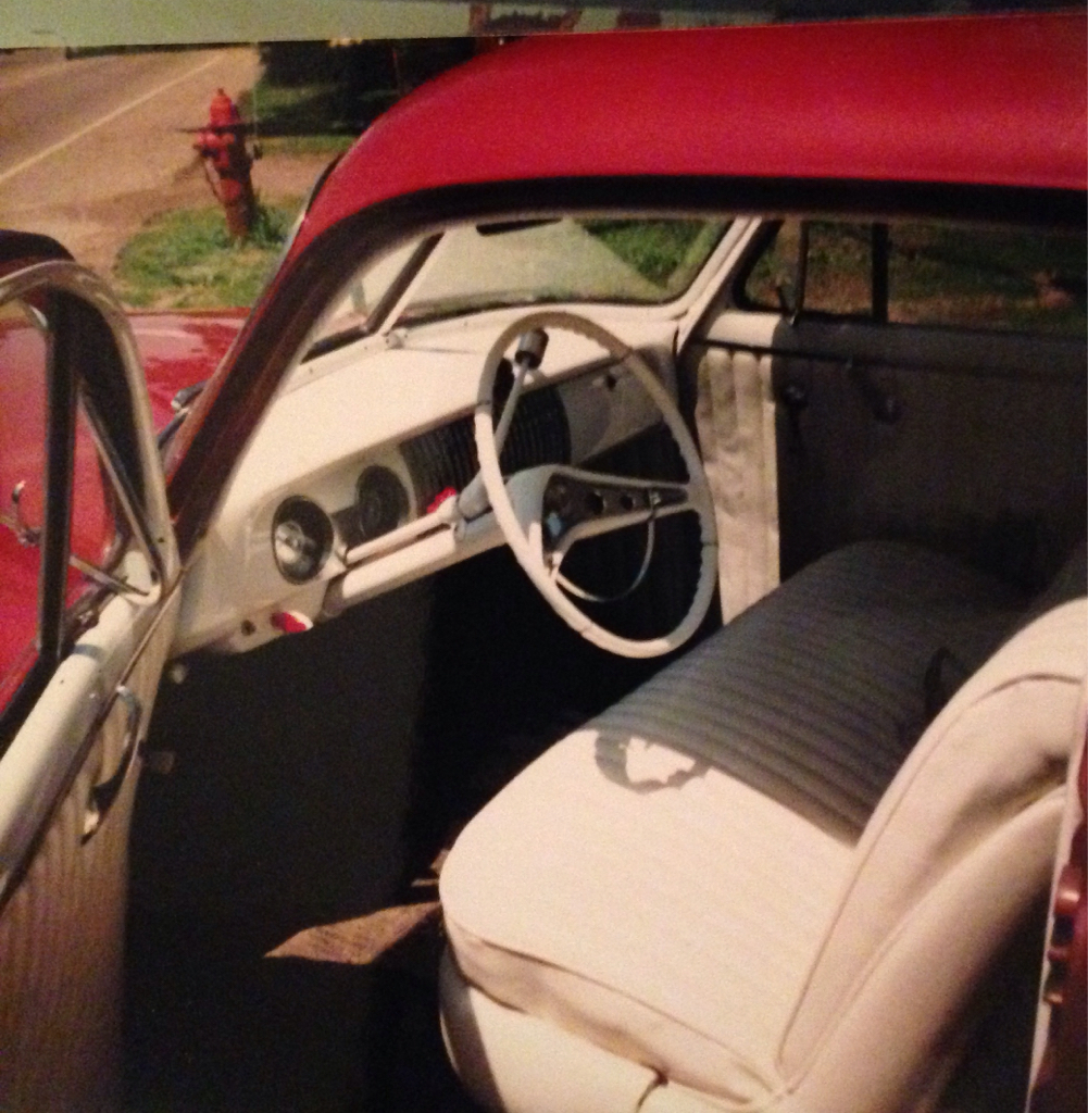

    No issues that I remember. I stepped the a arms myself and it worked out pretty well. The steering column was stock 52 and the wheel was a little too on your face. Found another pic ImageUploadedByH.A.M.B.1425398180.716684.jpg
