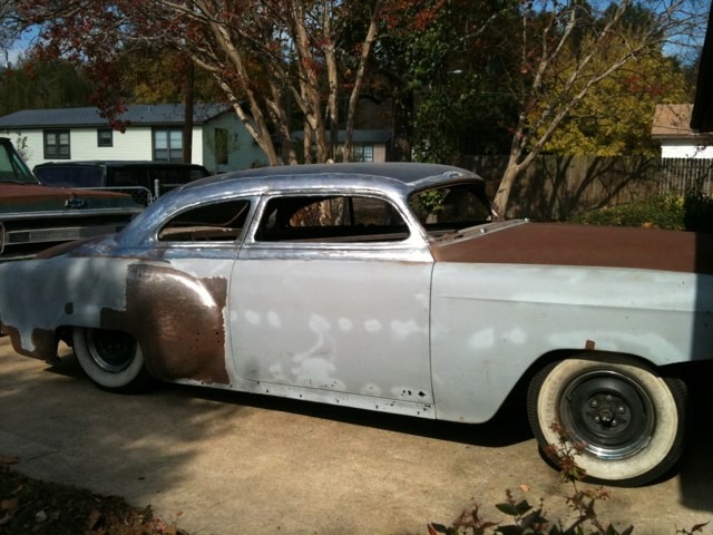

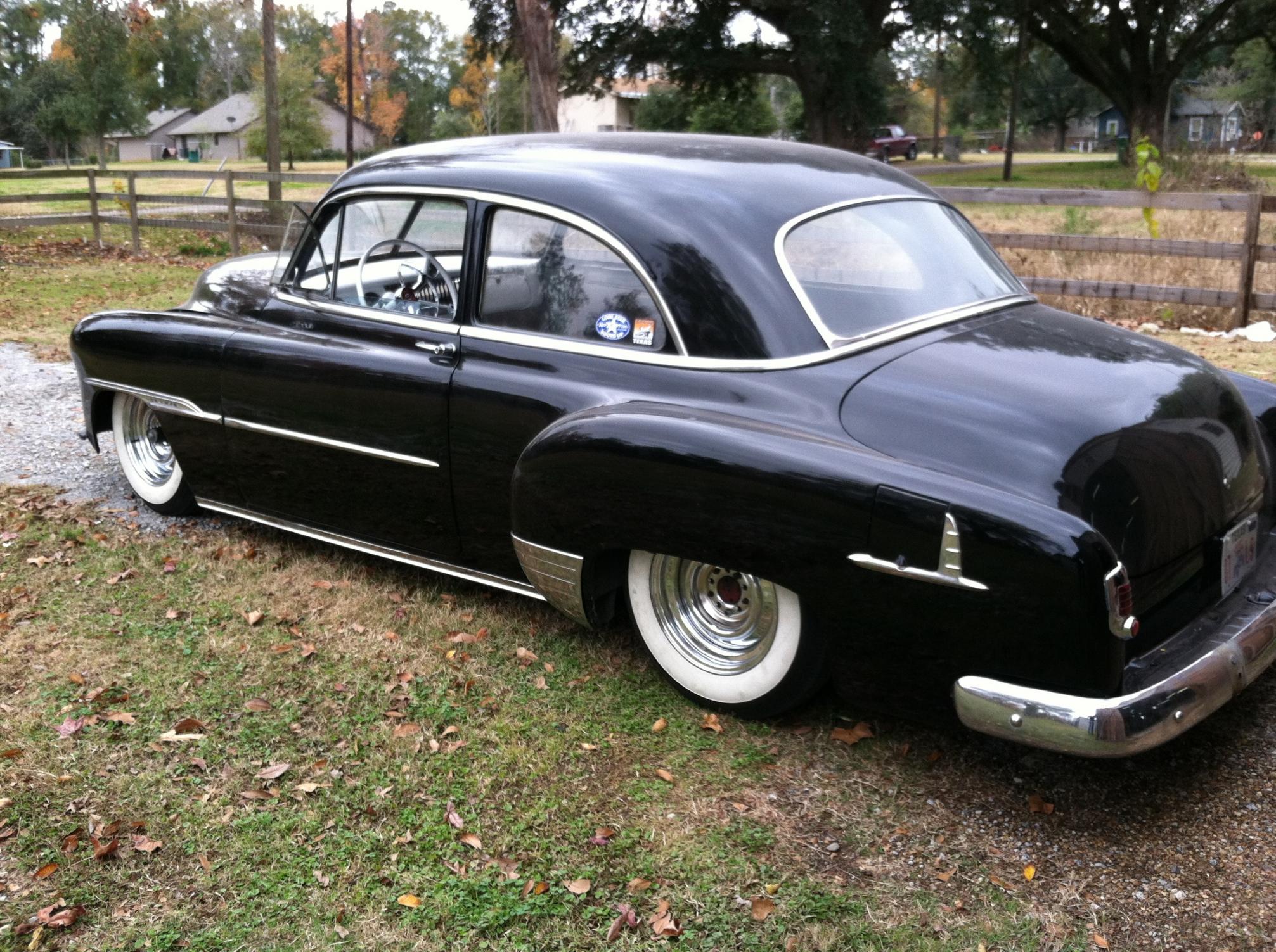

    Here's mine. Leaf pack dearched 2 inches with 1" blocks in the rear. Stock front suspension. Planning on dropped uprights for the front. Does anyone know if it will sit nose heavy with this combo. I'd like it to be level or with a slight rake to the rear
  8. e z i
    Joined: Sep 5, 2007
    Posts: 601
    e z i
    Very nice. Sets perfectly. Slight forward rake is the look. Airbags...Jesus...

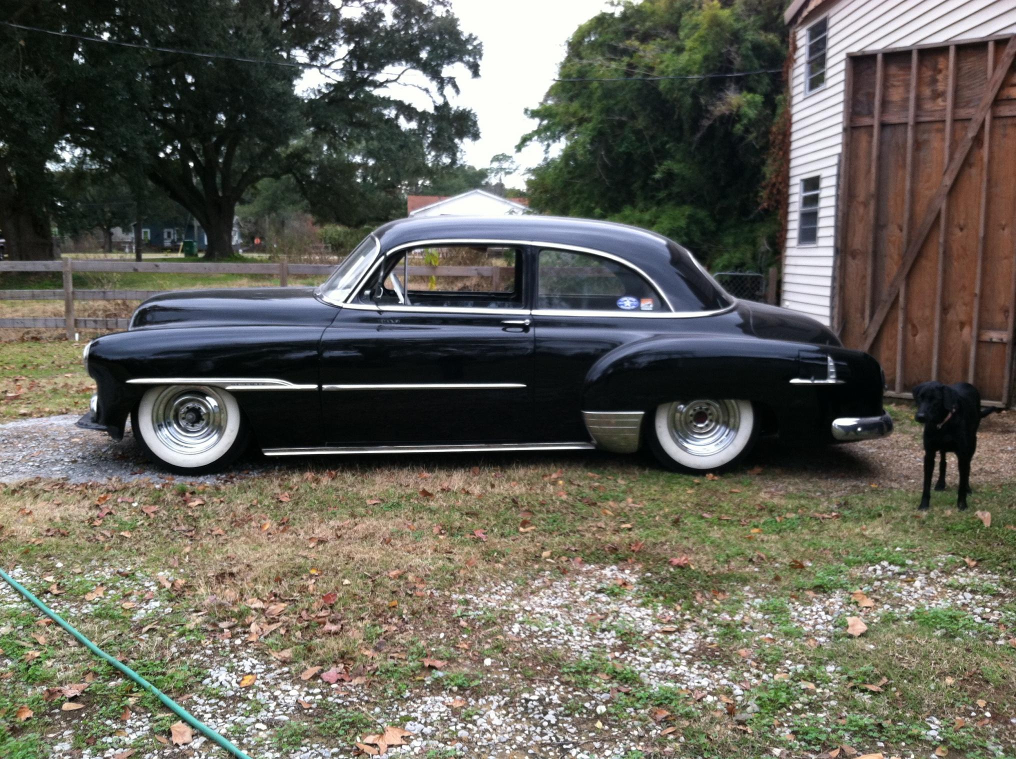

  12. This thread is great! I have 3" lowering blocks in the rear and ordered some shorter springs up front rather than cutting the originals. Blocks from Jamco, springs from Western Chassis.
    First shot is before and after
    ImageUploadedByH.A.M.B.1461777767.476223.jpg ImageUploadedByH.A.M.B.1461777797.006634.jpg

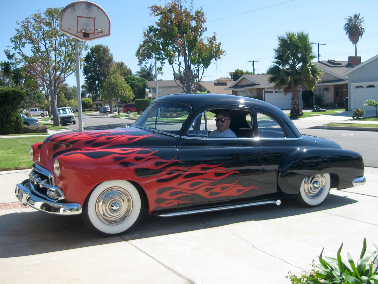

    Here's mine. MII front suspension, 2" drop spindles with 1 coil cut, 3" blocks on back with Chassis Engineering leaf spring kit & Chevy 10-bolt. Currently running 6.70-15 tires (about 28" tall). Will be upgrading to wide-white radials soon.

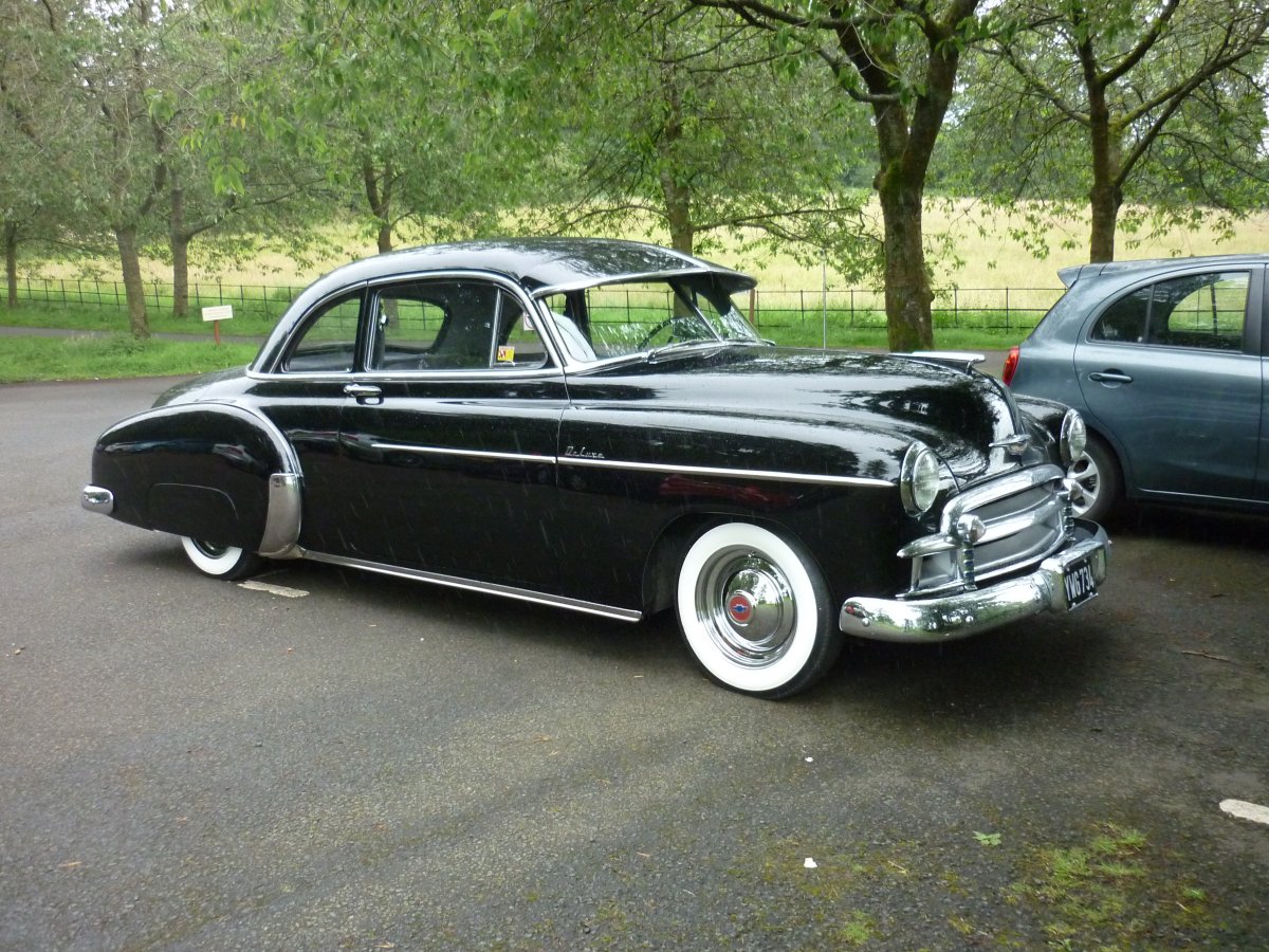

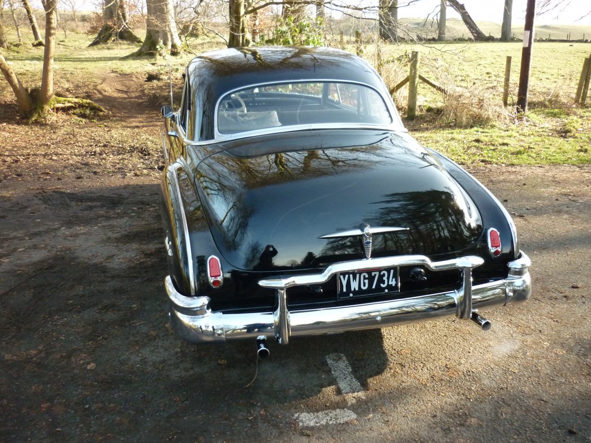

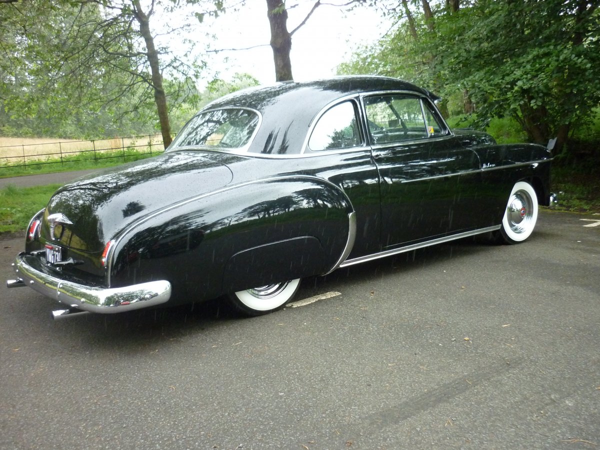

    Here's my 50 Chevy Sport Coupe:
    Dropped uprights up front: Low rear springs with blocks and air shocks at back
    Phil from SCOTLAND

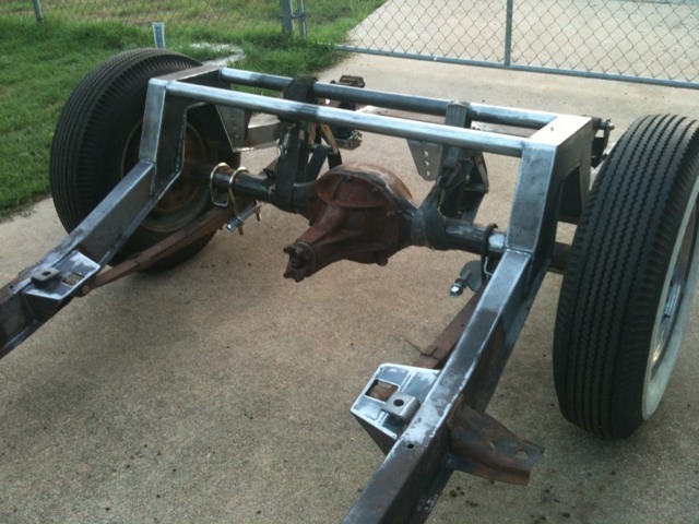

    This is an old post with an ongoing thread. I'm at this stage in my 53 Belair hardtop build. The body is off the chassis and I'm working on the rear suspension now. I bought 4" lowered leaf springs and 3" block kit. Installed it and I'm still not convinced it's low enough. Maybe it's just me not seeing it realistically low because the body is not bolted up to weigh it down. What I want to know is how did you come up with these dimensions to relocate these leaf spring mounting brackets?? I can't figure this out. I have a "Chevrolet Passenger Car Shop Manual" I got at Pomona Swap and it shows dimensions of the leaf spring shackles front and back holes center-to-center 49-1/4". Without knowing where a flat spot is this frame parallel to the ground, I am having a hard time finding where to relocate.

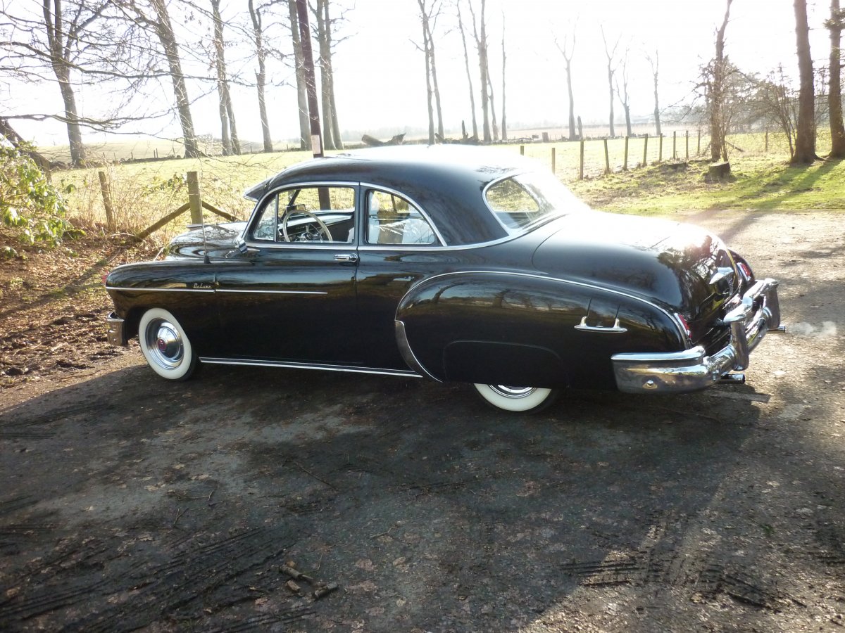

    Quick update if anyone's interested. Chevy back on the road after new flywheel and ring gear. Plus new clutch
    I love customs but, as I don't have the bodywork skills, have gone the lowrider bomb route. I think I like them equally.
    Still got a '49 accessory hood ornament to go on, I'll try and light up?
