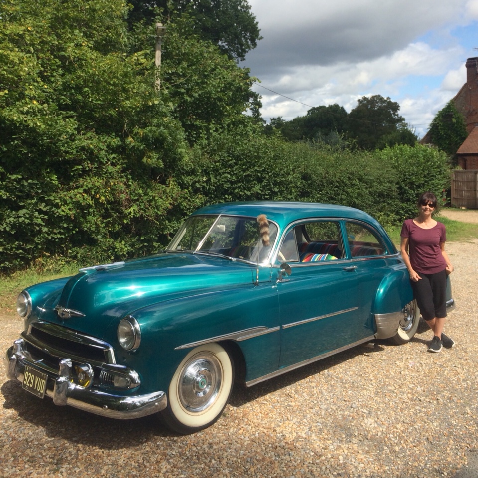

    new exhaust which meant I could get it lower.
    Phil from SCOTLAND

    Phil, How is this lowered? And what size tires?

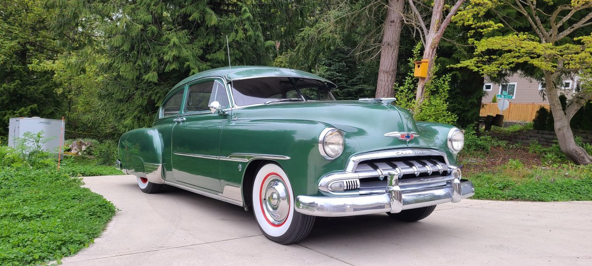

  5. Lowering similar to the green one. I used Posie rear springs with '' blocks CHEVY DONE 009.JPG and dropped uprights from Fat Man.
  6. ^^^^Also I extended the skirts down 1''.^^^^

  8. I just welded a 1'' strip of sheet metal to the bottom of the skirt and then another at a 90 degree angle. The ends are curved to match the front and rear of the opening.

    Dropped spindles and lowered springs up front. Low springs and 2 1/2" blocks rear. Also has air shocks in rear which operate from dash. 6x15 tyres

  19. I tried air shocks but they would leak down after a week or so. I ended up with overload shocks.. They have a coil spring around them. I put them in the original upper mounting location. Better than air shocks. Rides great and rarely bottoms out. CHEVY DONE 009.JPG

  23. I got the shocks from Rock Auto, part # 58510 for $61.97. I have Posies rear spring with blocks, I forgot but maybe 1 1/2''. It rides great and rarely bottoms out. I talked to Monroe and they said they wouldn't raise the car but they raised it 1/2''.

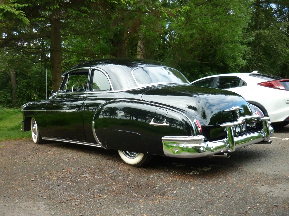

    Dropped uprights with 1" lower front springs. 1" lower rear springs with 2 1/2" blocks. It will ride like that but only on the smoothest roads. I added air shox with inbord compressor for driving. It only raises it about 1". Then lower it back down when patked P1020156.JPG View attachment 5222810 View attachment 5222810 View attachment 5222810
