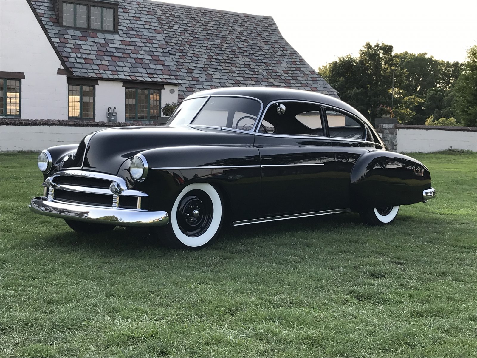

    rusty1
    my old 49, Nova clip, stock rear springs, blocks,...
