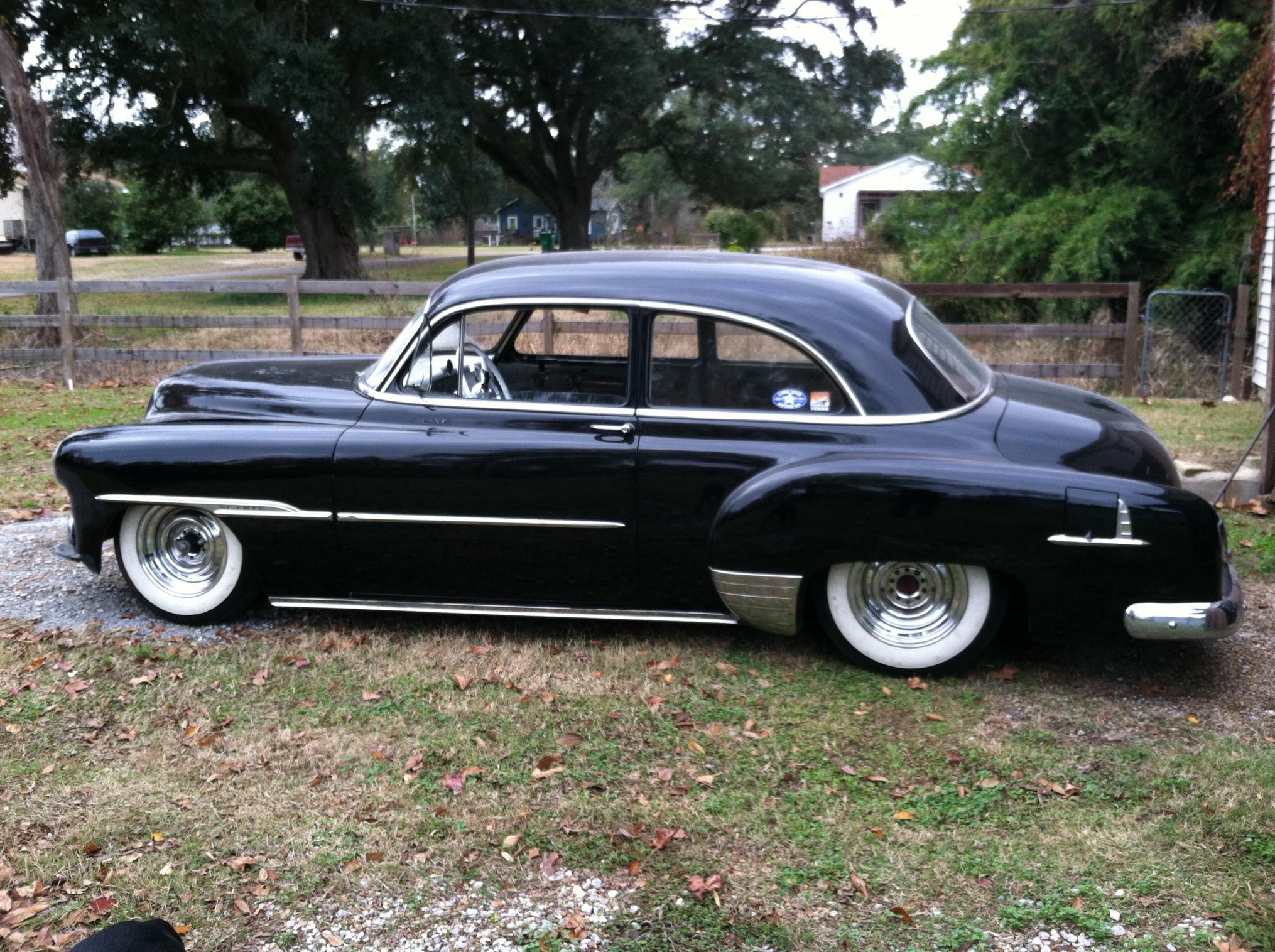

    Stock front end, cut coils. 10-bolt rear, custom saddles, 1" blocks, and removed a few stock leafs. Sitting on frame in rear, awaiting a notch. Will come down another inch or so. 6.70-15 WWW Bias BFGs.

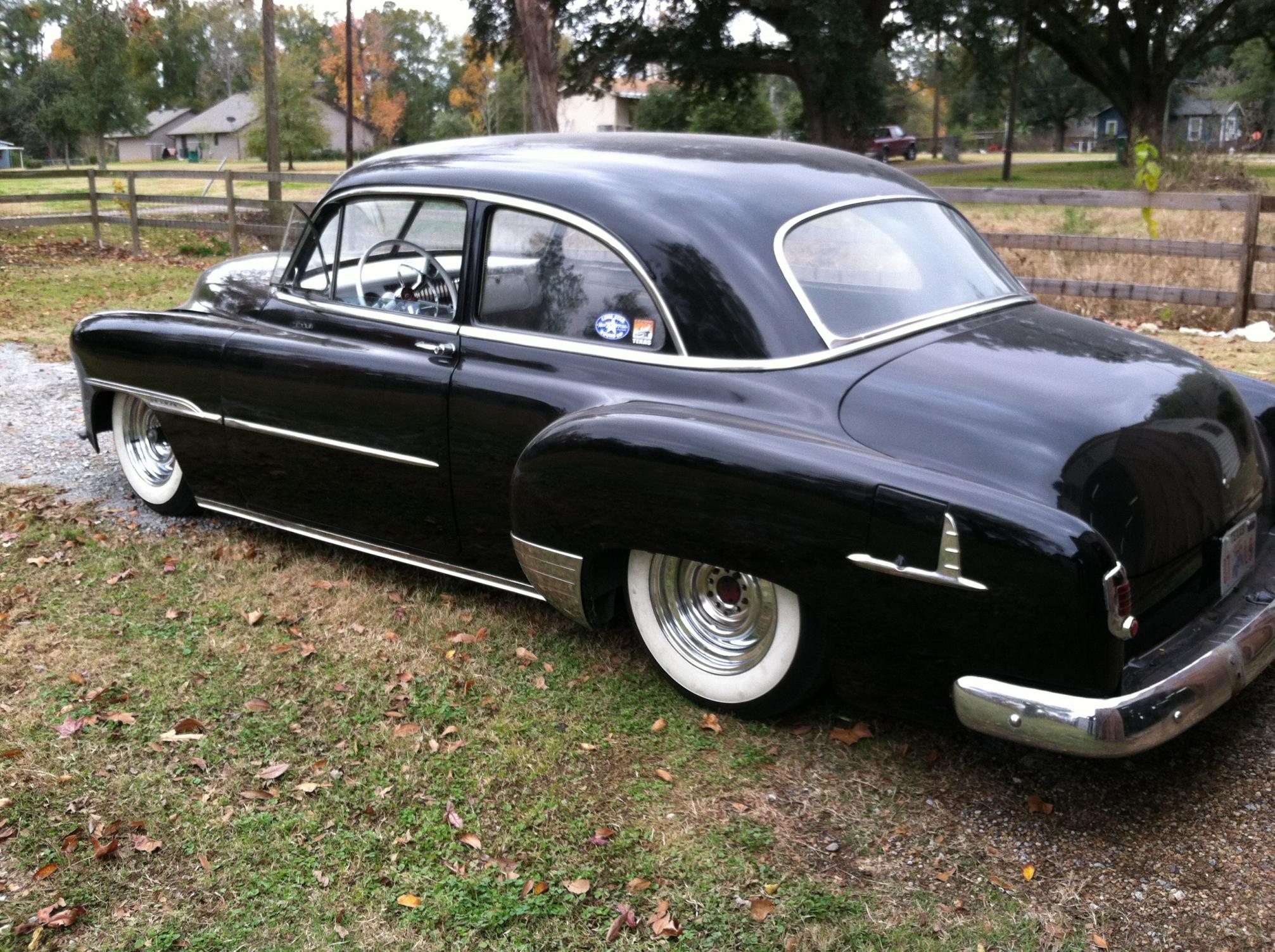

    She finally saw the light of day today!!!!!!!!! Got the new engine turned over ,started ,and drove her out of my shop for some good pics!I'm a little unhappy with the back , it needs to come down another inch or so. But also the back is dry no cargo in trunk or interior .whatcha think... We don't need no stinking bags! ImageUploadedByTJJ1324672199.888271.jpg ImageUploadedByTJJ1324672280.669759.jpg ImageUploadedByTJJ1324672369.366151.jpg ImageUploadedByTJJ1324672475.128057.jpg

    damn the lady is low!! i agree with another inch down in the back, but youve got one BEAUTIFUL chevy! We definately dont need no stinking bags!

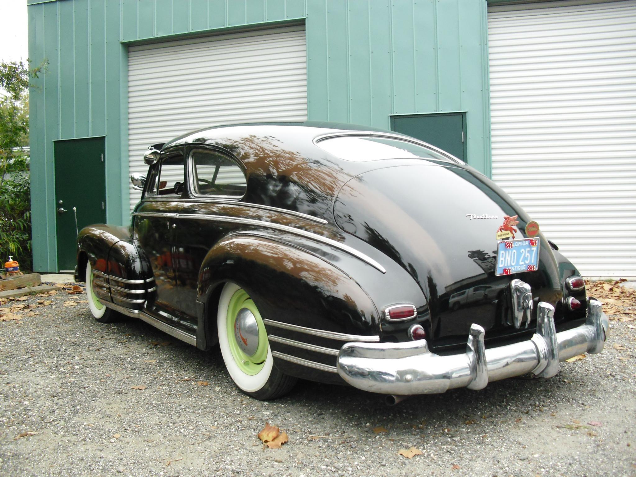

    Looking good Matt! I agree that the back could come down a bit. I always love Chevy's dragging tail at least a bit..Right now the stance is kinda like my 54 Buick...about as LOW as you can go on the roads around here without bags and pretty level*. If I remember correctly you are running 3" blocks with 2 springs removed in the rear and 3"cut coils with dropped uprights up front?..What if you went back to the stock uprights with the cut coils and left the rear alone? Whatever you do that is a really sweet Chevy.
    *Apologies for posting Buick in a Chevy thread but this is what I mean. 3" cut coils back and front. The Buick is a totally different animal to lower than my Chevy.

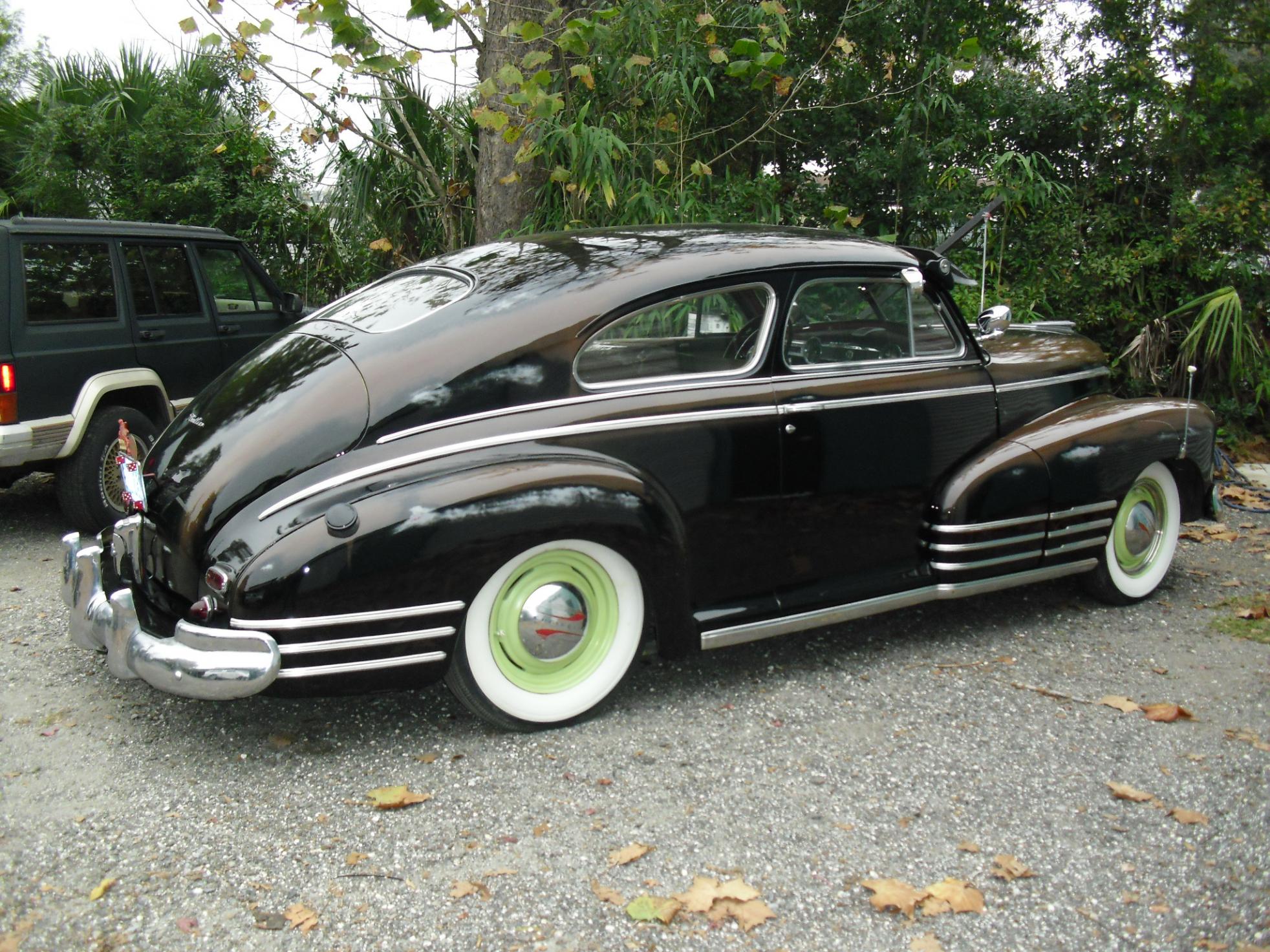

    I hope yall don't mind a '46 pic. It is bone stock other than the stance(and paint and gadgets). It has custom 4.5 blocks in the back and torched coils up front, it rides excellent, other than needing a notch, BUT I WANT IT LOWER it's not nasty low enough!!! I've owned several bagged cars and swore I wouldn't do it again, but I ordered a Gambino notch, and was about to order all the bag crap YESTERDAY, until I saw this thread, NOW I"M TORN, PLEASE HELP! SOMEBODY STOP ME!
    It will be lower, somehow, but I really didn't want to cut up this absolutely rust free beautiful stocker...................that's a whole other argument
    Any Ideas on how to notch the frame without cutting the trunk? I've got some 5" pipe I can cut in half, it's the reinforcement I need to get creative with.
    The 46-48 frame is basically the same as the 49-54. Thou shalt not baggeth thy car my son, shall thee or not?

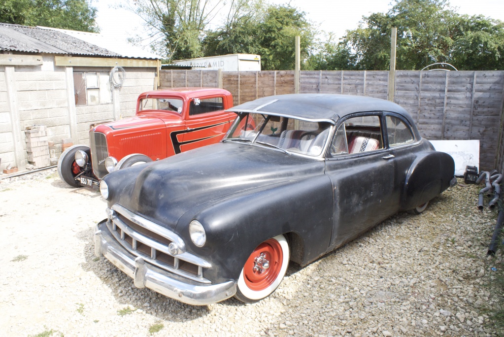

    heres mine from sunny England, also used Droplords guide for stepping the a arms and took 1 coil out. Rear has 2" blocks and 2 leaves removed, still needs more and id really like some taller tyres.
    Matthew Mcglothin what size wheels and tyres do you have? your car looks killer!
