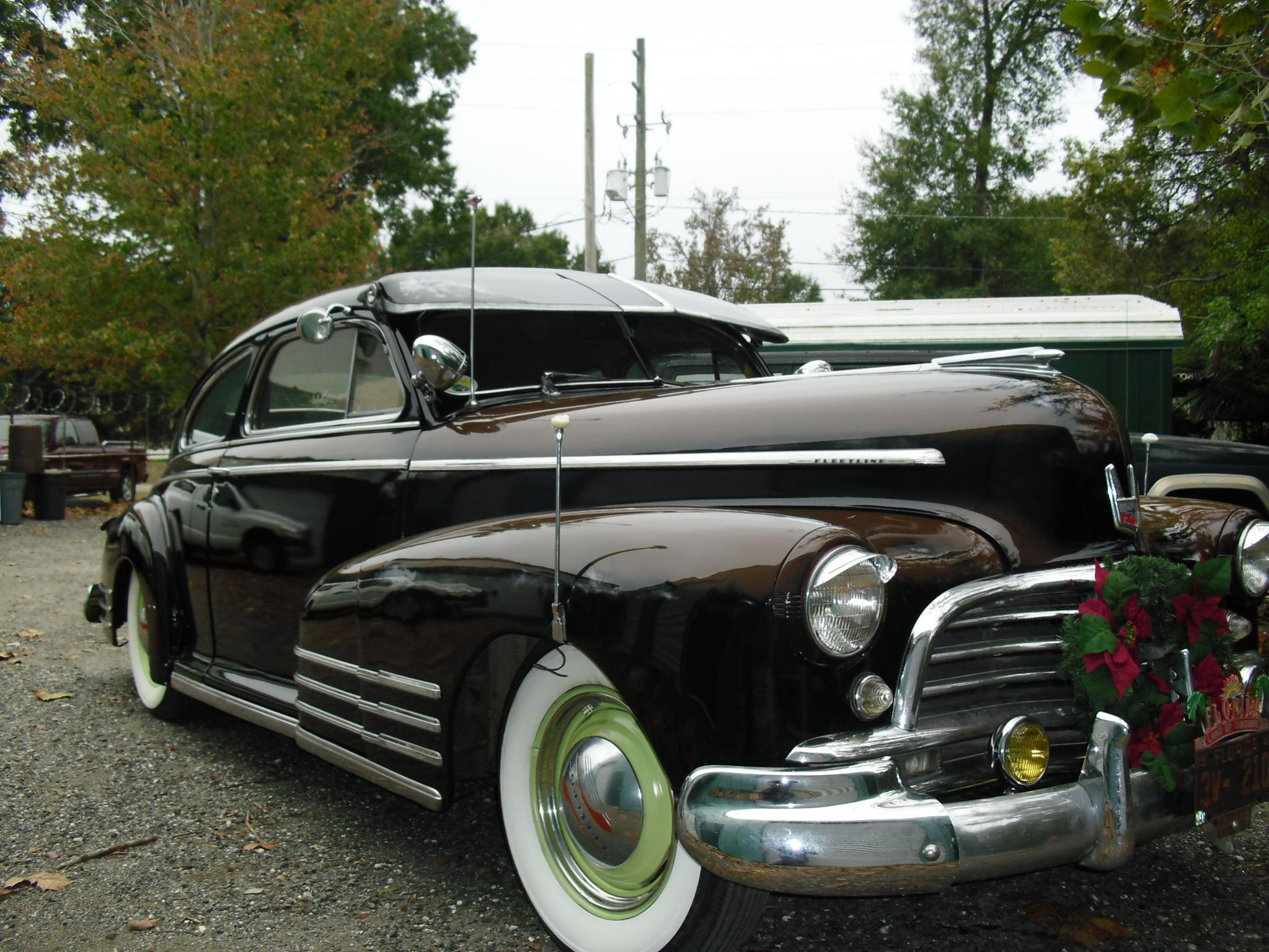

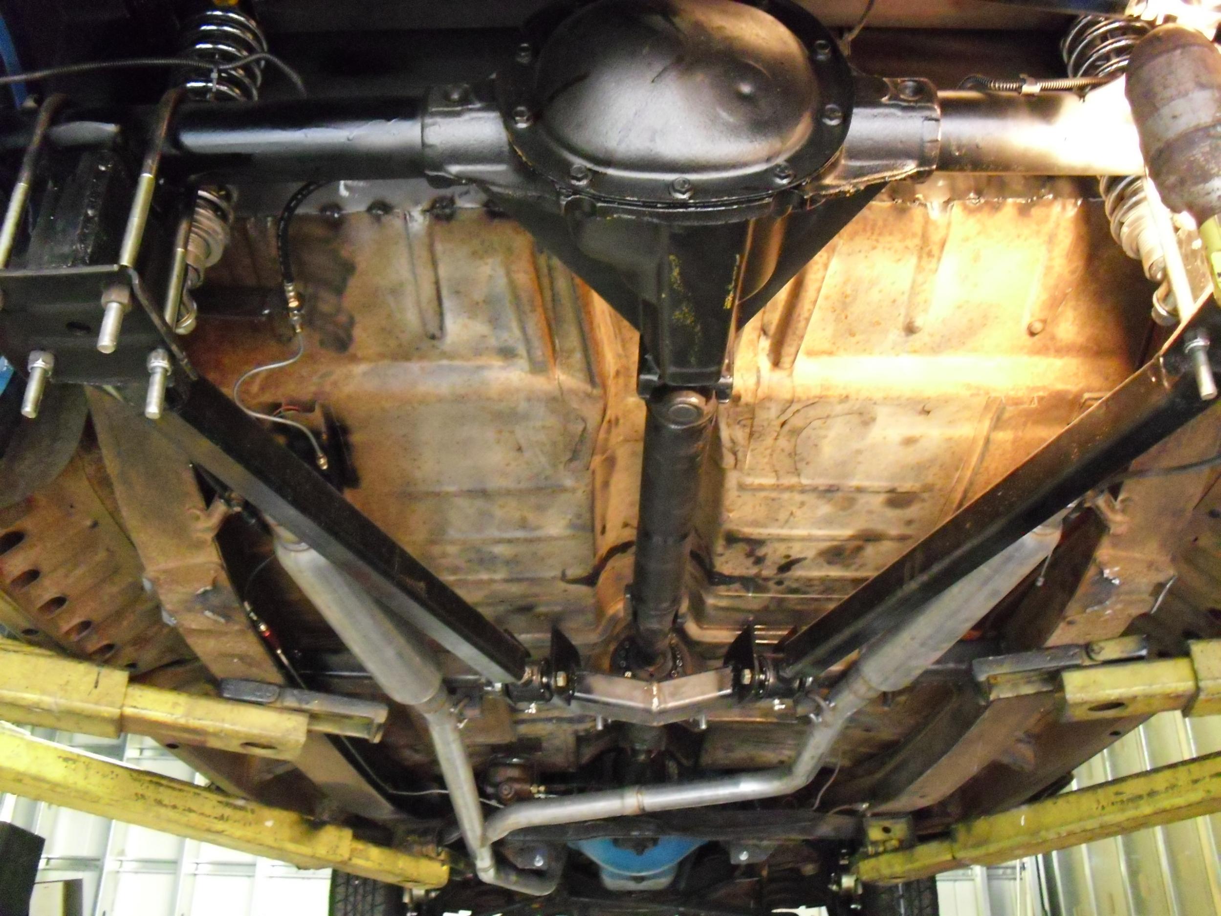

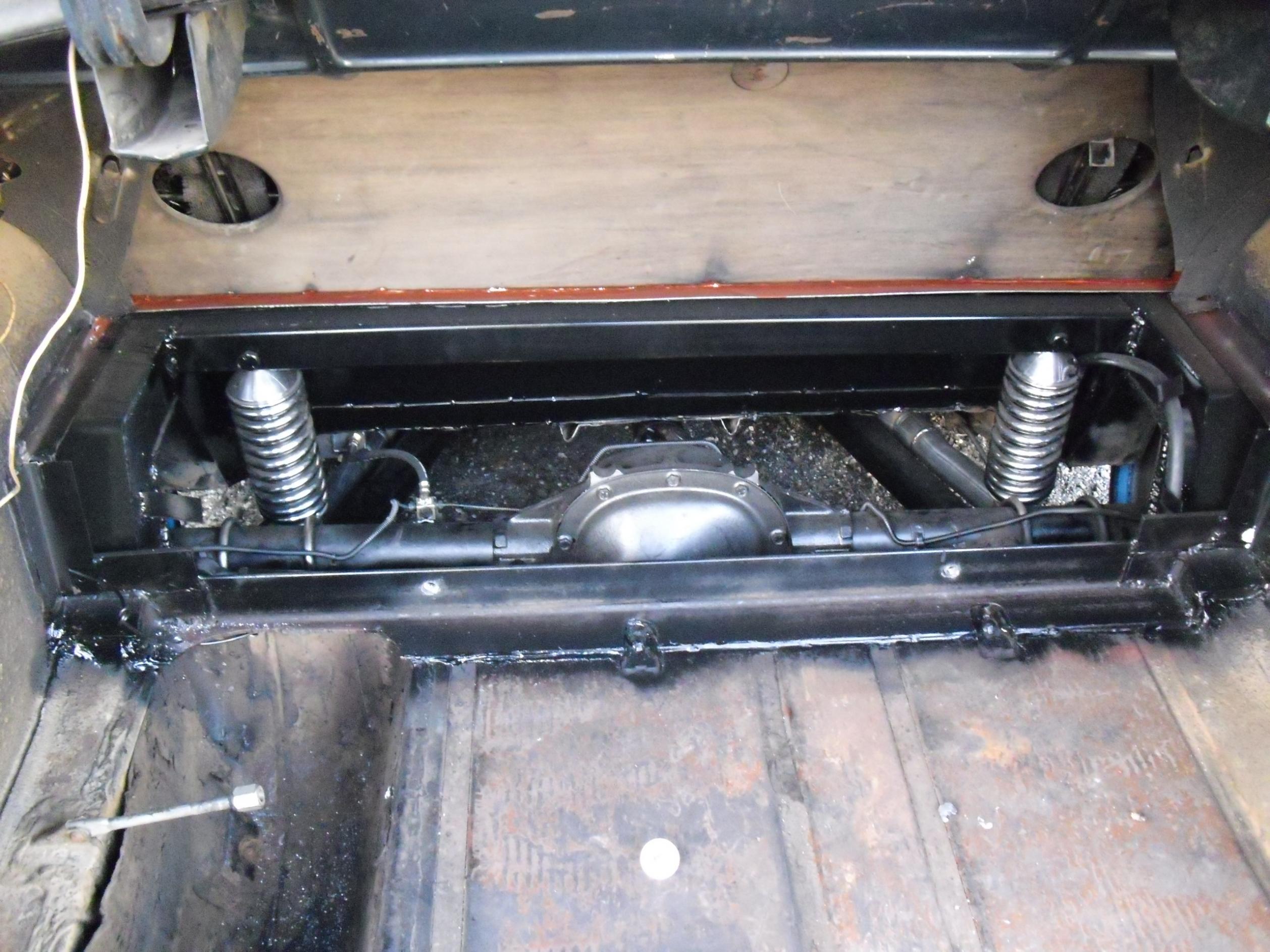

    I was having trouble deciding whether or not to "bag" my 46 fleetline. I've bagged several cars and thought I might want something different, it's nice just to get in and drive without waiting on a compressor, or fearing a line or bag failure. This thread made up my mind. I went with a nascar style 3-link and coil overs in back(handles and rides better than original!), dropped spring pockets up front.

    Sorry, picture of front was before lowering and wheel change(disc brakes) Here's snother

    Cruzer.. Your fleetline turned out awesome! Stance is just right. Great work

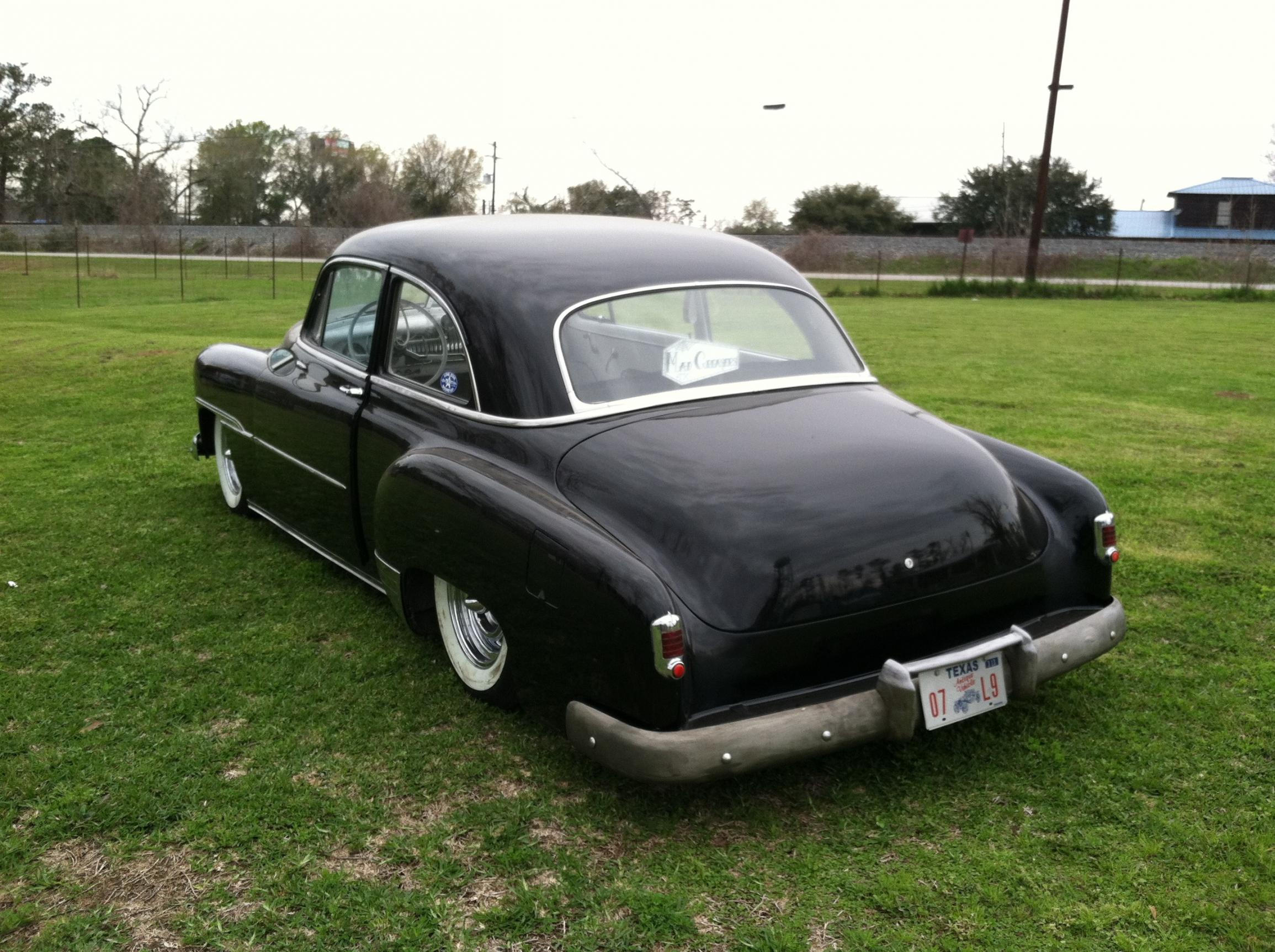

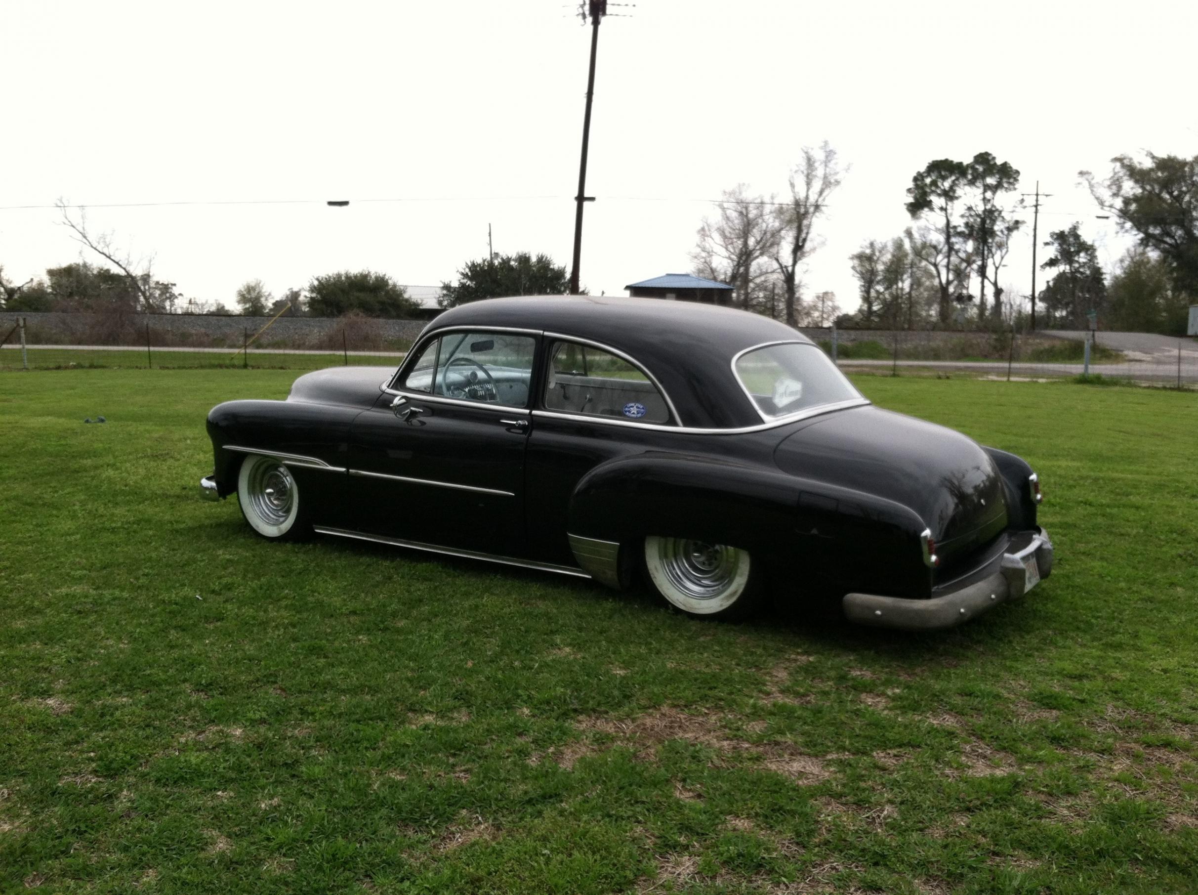

    Well here's some new shot from today. ( it was very cloudy today pics ****). I took her on the first drive in 7 months. Drives great except when you hit a large dip in the road I get a little rubbing at the top of the rear wheel wells. Other than that ride is awesome. I'll have to get the rubbing situation fixed before roundup

    matthew, that sits really nice, about where I want the rear of mine to sit (but I plan a slightly taller tire. I would like my front to sit a little lower than yours (I want it really low but on a slight rake). how much front travel do you have. Since you are rubbing when hitting bumps, I know I will be in trouble in the rear (maybe some airshocks to air up when on a road trip..
    how much gap between the top of the tire and top of the inner fender when not moving?
