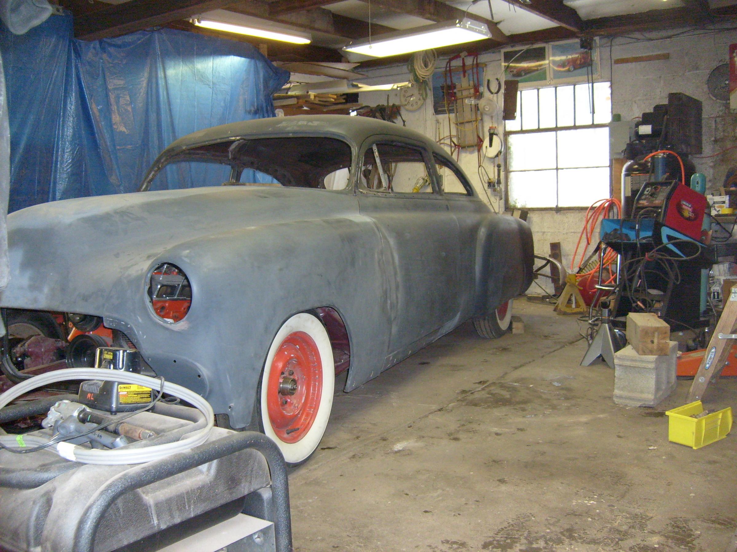

    Pics aren't great(lack of room to get back) but I just finished the 2" a-arm drop and put another 1" in the rear. While I was at it I added pwr rack steering and disk brakes. I need to let it settle out but I think the rear is going to need 1 more inch.

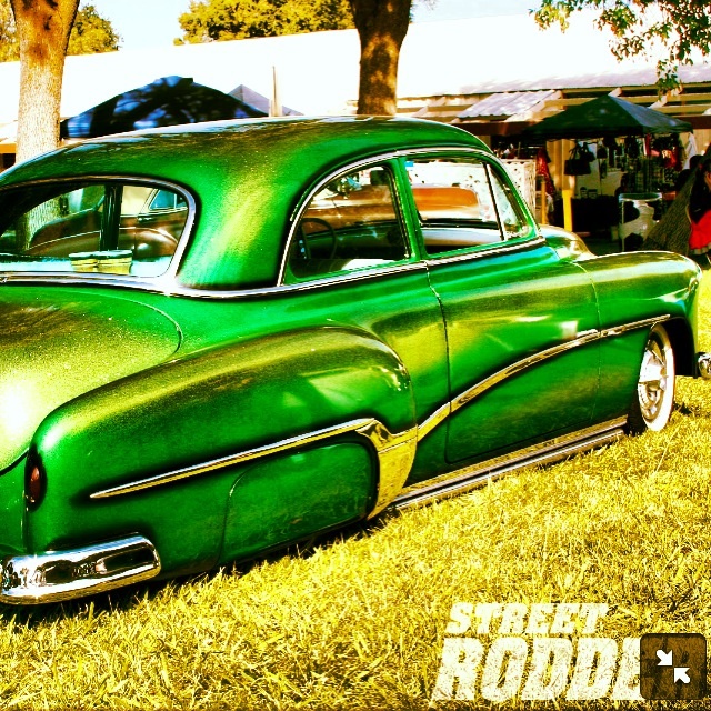

    atomickustom
    I don't know how anyone can go any lower than this in the rear without notching the frame and cutting into the floor pan. (I'm not opposed to either of those things, I'm just saying I can't get my rear any lower than this without doing both because I currently have maybe a couple inches travel and it will bottom on dips.)
    Posies leaf springs plus about 1.5 inch blocks on each side. (They are angled, so it's hard for me to say exactly how low the blocks are - they're 2 inches at the thick end and 1.25 or so at the thin end.)

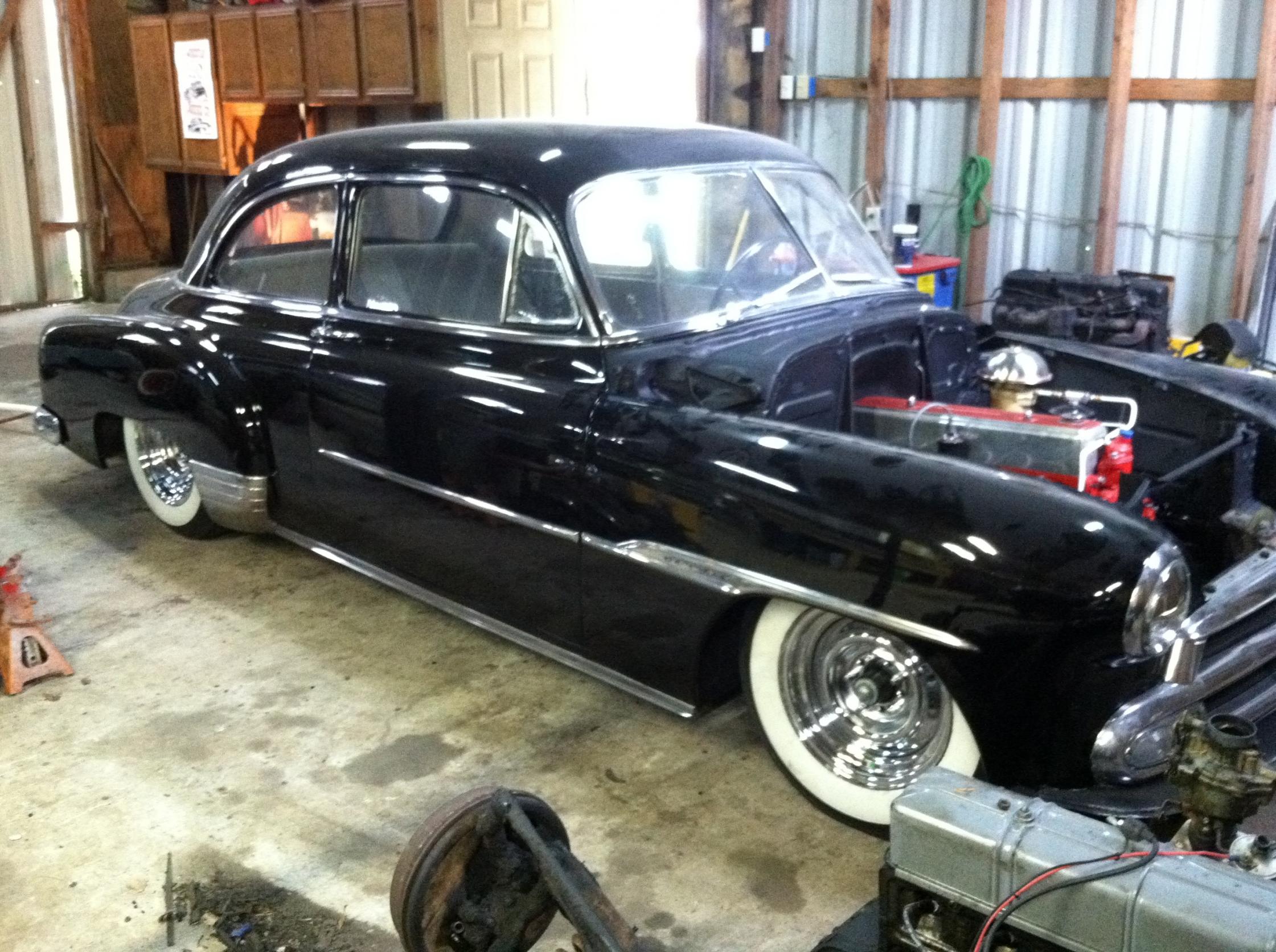

    Up front, dropped uprights with 3" dropped JAMCO springs. Rear is c-notched with dearched leafs and blocks.

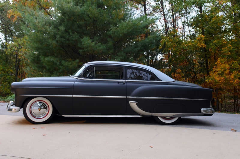

    Updated picture of mine pulled outside for the first time in 9 months under its own power..
    Cut coils in front and 3" blocks in rear..

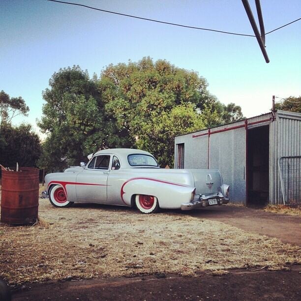

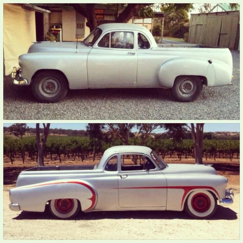

  12. Here's my ute, up front are dropped uprights and the rear has p***enger car springs (being a commercial vehicle they had a heavy leaf pack) anyway, rear is p***enger car springs with a leaf removed and one flipped 1inch blocks and air shocks, with low air in the shocks it touches ch***is on diff, this is full of wind in the shocks
