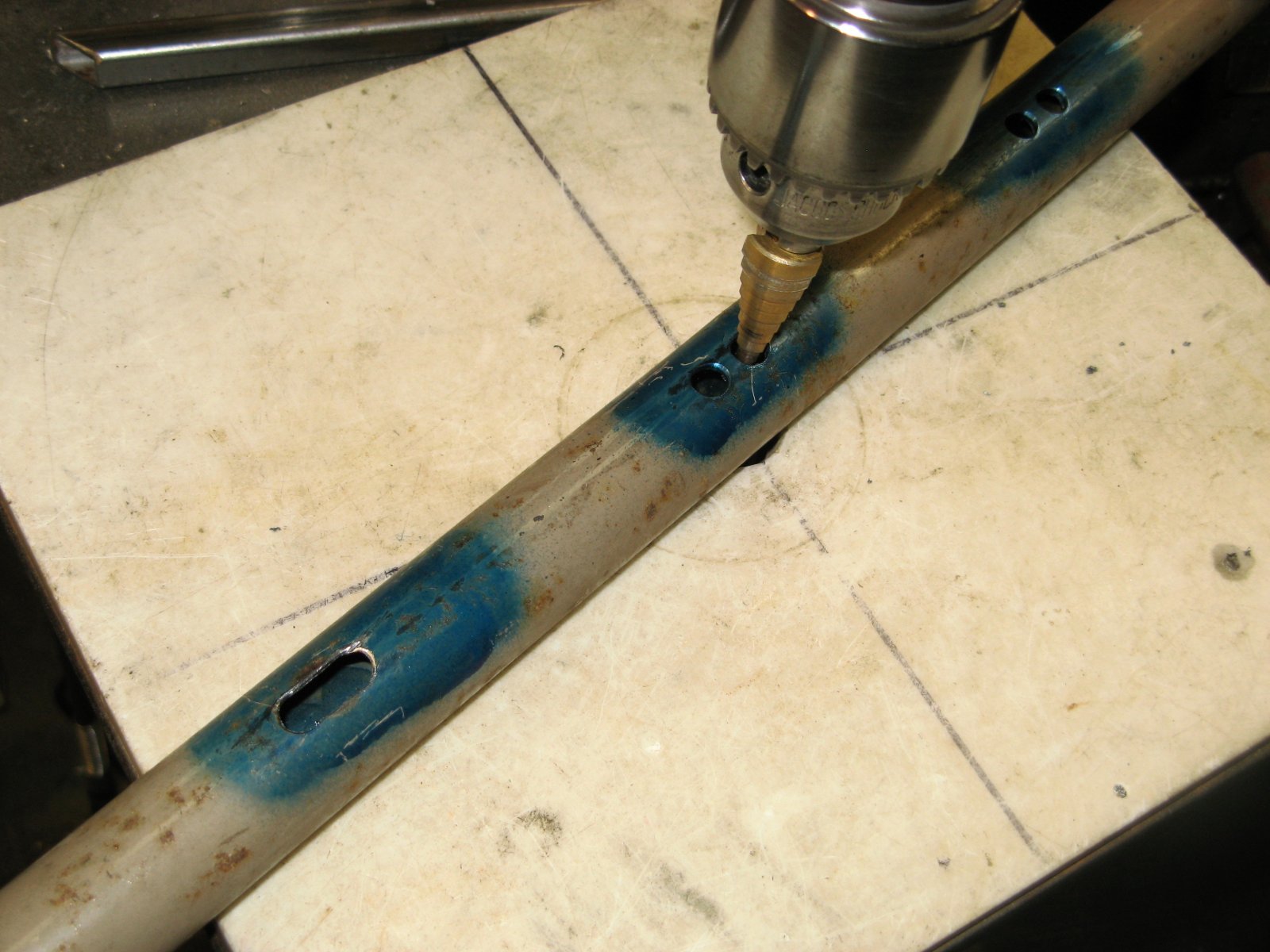

    I want to make a tapered tube for my twin cam inliner valve cover similar to this gently tapered cooling tube pictured. I've also seen tapered tubes like that to hold the spark plug wire loom. I like the look and think it will complement the look of my tapered exhaust manifold nicely if I use one to route my spark plug wires down the middle of the valve cover.. Does anybody know of a source for a thin wall, gently tapered tube like this? I remember an old bathroom sink we had with gently tapered plated brass legs - wish I'd saved one. The bottom picture is of the engine it is going on so something around 24" long 1 1/4" big end, 3/8" small end would be nice. Any ideas? Thanks.

    I thought I'd update this old thread since I started it and want to put some closure on it. I fould some old scrap table legs that worked perfect. I repurposed one into a spark plug wire holder.
