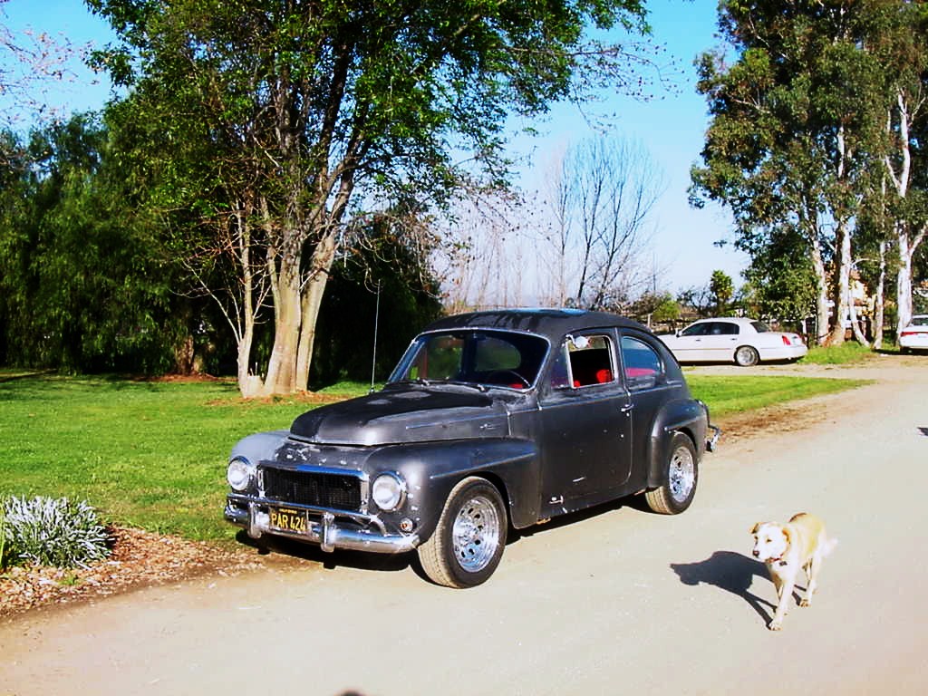

    I intend to install one of these engines in a Volvo 544.
    I know that I can get equal of greater Hp. out of a Volvo turbo 4 but only after great expense.
    I also understand the simplicity of the 470 Mercruiser. It is a 4 cylinder carburated engine with a simple distributor alternator and waterpump.
    No special wiring or plumbing. It will look like it was make for the Volvo.
    The only concern I have is in it's length. I may have to cut the firewall or move the radiator forward.
    If I have to move the radiator forward it will necessitate hinging the hood at the firewall and having a custom radiator made to fit just behind the grill.
    The main advantage of this engine in the volvo rather than a V8 is the weight reduction.
    I am going to install a WC T-5 overdrive transmission with a hydrolic slave cylinder behind it and will consider using some sort of independant rear suspension if I can find one that is narrow enough and will handle the torque.
    I have a Mustang II front suspension that I might use in place of the 544 front suspension.
    The advantages of the Mustang II suspension include the disk brakes and the availability of custom parts.
    I don't intend to make a rally car out of it but rather a sleeper and a driver.
    I think it will be fun to drive up beside a BMW or a Honda s2000 at a signal and dust them from the light.
    A 2250 Lb Volvo with 225 Hp. should be fun. The 1947 Ford look of the Volvo 544 will aldd to the fun factor.

    Not much to throw in, but I´ve always cared about those Volvo´s alot. Our bunch of carguys (JALOPIES Motorclub) has all used the Volvo´s as a way to learn about old cars before buying some old american iron. We have all kind of them in the group, original, lowered, slammed, chopped, mild customs and even racecars.
    Heres my latest:
  21. madmatt
    Joined: Feb 21, 2007
    Posts: 114
    madmatt
    from NH
    love it, any specs?

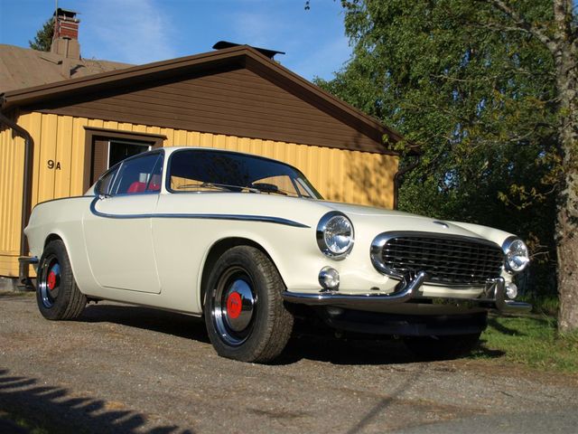

    Here´s the p1800s which I talked about. Don´t mind the "stock" outlook, but check the spec of the engine and see build pics:
    B254T 496hv/595nm
    http://kuvablogi.com/blog/951/8/
  23. madmatt
    Posts: 114
    madmatt
    from NH
    impressive build. clean.
    you say b254T, i am not familiar with that one.
    of course unless you mean basically a b230, with a 16 valve head and crank and pistons from a 2.5 penta, and turbo.
    i guess that would make a b254T:)
  24. Ilari
    Joined: Oct 30, 2009
    Posts: 191
    Ilari
    You got it, in papers it´s still b230.

    Impressive numbers. Are those at the crank or at the wheels? At what RPM?
    I have a B274T that made 461HP / 508 ft/lbs by 5600 RPM at the wheels. At that point the clutch started slipping.
  27. Ilari
    Posts: 191
    Ilari
    I´m quite sure it´s at the wheels, but don´t know details. The engine used to be in Volvo 121, before ending up into this p1800s.
