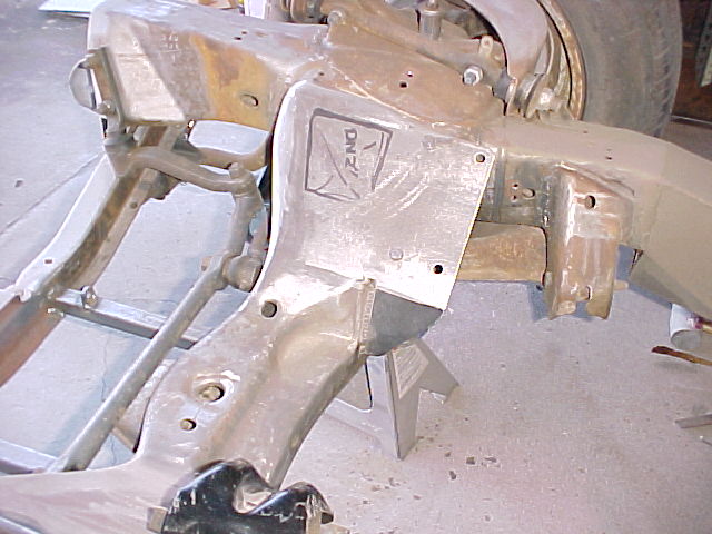

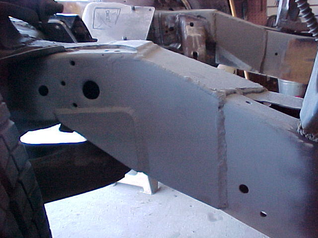

  10. Went home at lunch and took some pics of the monte carlo subframe on my 50 Pontiac. I live in rural New Mexico and wanted to put a front end on the car that had readily available, get em at any parts store parts, disc brakes, powersteering, and I found an 81 Monte Carlo here for $200. So I wasn't in it deep money-wise, but you have to pay with time to accomplish these things. Sorry I took the mock up motor out, but believe me the steering leaves plenty of room for just about any header / manifold setup you might want to use, and yes, the front-steer box intrudes into the core support a tiny bit, but that's easily cured with a little sheet metal fab.

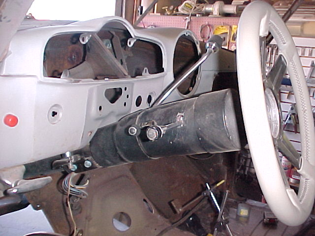

  11. I used the stock Pontiac frame horns and radiator mount parts to simplify mounting the front sheetmetal and bumpers, and with a little work managed to tuck the Monte sway bar up into the Pontiac radiator mount. I used a 77 Cad Seville tilt and telescope column, and a Borgeson U-joint and some 3/4 DD shaft got it hooked to the PS box.

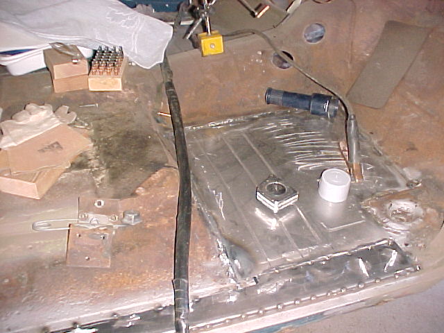

  12. Floor pan stuff....I made my own from 18ga cold roll, put some beads in, and plug welded the areas that were over the floor braces. While I was at it, the passenger side sill plate area was pretty rusty, so I replaced that area, too. Hope this helps.
