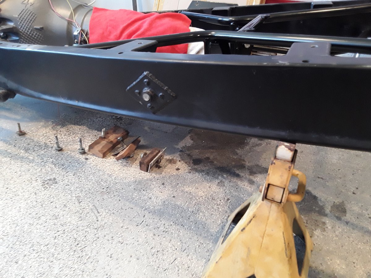

    Looking to fix this . 32 frame previous owner used ladder bar on the outside. I have changed the rearend so now the go to the trans CROSSMEMBER. Looking to cut this out and repair .Would like a little advice on how to go about . Any advice is appreciated. About 5inches wide by 3inches

    Break out the grinder, start with a cutoff wheel . less heat.

    Is it just welded to the frame? If so, grind the weld flush to the frame and bracket all around it, take a cold chisel and a 3 lb sledge after the weld starting at a corner.

    the first two pics could be fixed by using a tripod. :)
    3rd pic will require a grinder and ***orted cutoff wheels and some grinding. looks like some rivet removal and hole filling as well.

    I would grind the welds and rivets off and see how bad the frame looks behind it. It might just be some holes you can weld up and grind off and you'd be all set. I definitely wouldn't cut the whole thing out without seeing how it looks from behind first.

    I was thinking the same thing drill out rivets there is going to be a hole in the middle as well . I appreciate the reply..

    I'd say that he got it right. Cut through the welds what they are and cut the heads off the rivets if they are rivets and take the cold chisel and BFH and see if you can pop it loose.
    Hopefully that sleeve is just welded to the plate and not the frame rail.
    Looking at it you may have to grind that plate off if it is welded to the frame in the center. The frame looks boxed so does that tube/sleeve go clear though the boxed section? That might add a bit more effort to the challenge.

    There was a ball joint in the center the treads where messed up so I cut it off. The best solution is I can get the plate ground off is to be left with the rivet holes and the hole for the ball joint.. it is sleeved but on the inside of the frame before it was boxed. I appreciate your response

    You should be able to tell from the inside of the rail how much of the original rail is still there.
    As Squablow says, there may only be just a few small holes remaining after you remove that big ugly square patch plate from the outside.
    In that case, an angle grinder, a cold chisel, and some patience should leave very little damage to the original rail.

    I agree, but not for something the OP posted. After he pulled the piece out, he'd have
    1. The frame rail
    2. Rivet holes to fill
    3. Center hole to fill
    Versus patching in a new rail section.
    Unless the frame rail is rusted/damage, there is no reason to bring the sawlzall/torch/plasma cutter out for this job.

    Like other have said , cut weld with cut off disc , to see the hole behind square plate, if a torch hole , then round or square hole on frame , make a replacement path same gauge thickness, weld in , grind / sand ,

    I would start with the rivits first and get them out of the way. Grind the heads off and see if they can be driven out without too much trouble. If they resist, drill them and put a little little heat on them. See if they can be driven out again. If they still fight you, go ahead and drill them completely out.
    Then take a grinder and lightly grind the weld trying not to touch the frame. If you tack some steel strips to the frame around the welds it will help you not to grind the frame itself. When you have most of the weld ground away, remove the strips. Change to a thin cutoff wheel and you can control it better for removing the rest of the weld.
    You can just weld the holes closed or put a plate inside and weld thru the existing holes and weld the plate to the inside of the frame. This will help to insure that the frame is not weakened in the area. You may put boxing plates inside too, but for the most part the inner plate won't be noticible if you don't plan on it being a car show vehicle.

    Good job for a carbon arc gouge. Too bad most people don't have one at their disposal.
    Could use a wash tip on a burning torch. Wash that weld right off without putting a ton of heat in the frame. Have to know what your doing though.
    Cutting wheel right thru the weld bead (all the way around) You will see the parting line if you look carefully. Then get after it with a BFH and a sharp chisel.
    I'd hack the whole thang out and **** weld a patch in it and call it done. Lots quicker and once ground smooth nobody knows.

    I like this idea thank you. It's not a show car.
