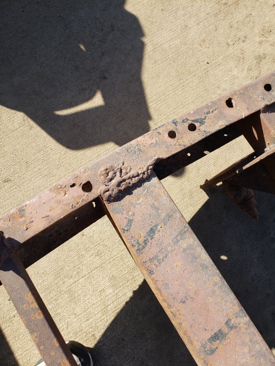

Technical Any advice on how to fix this?

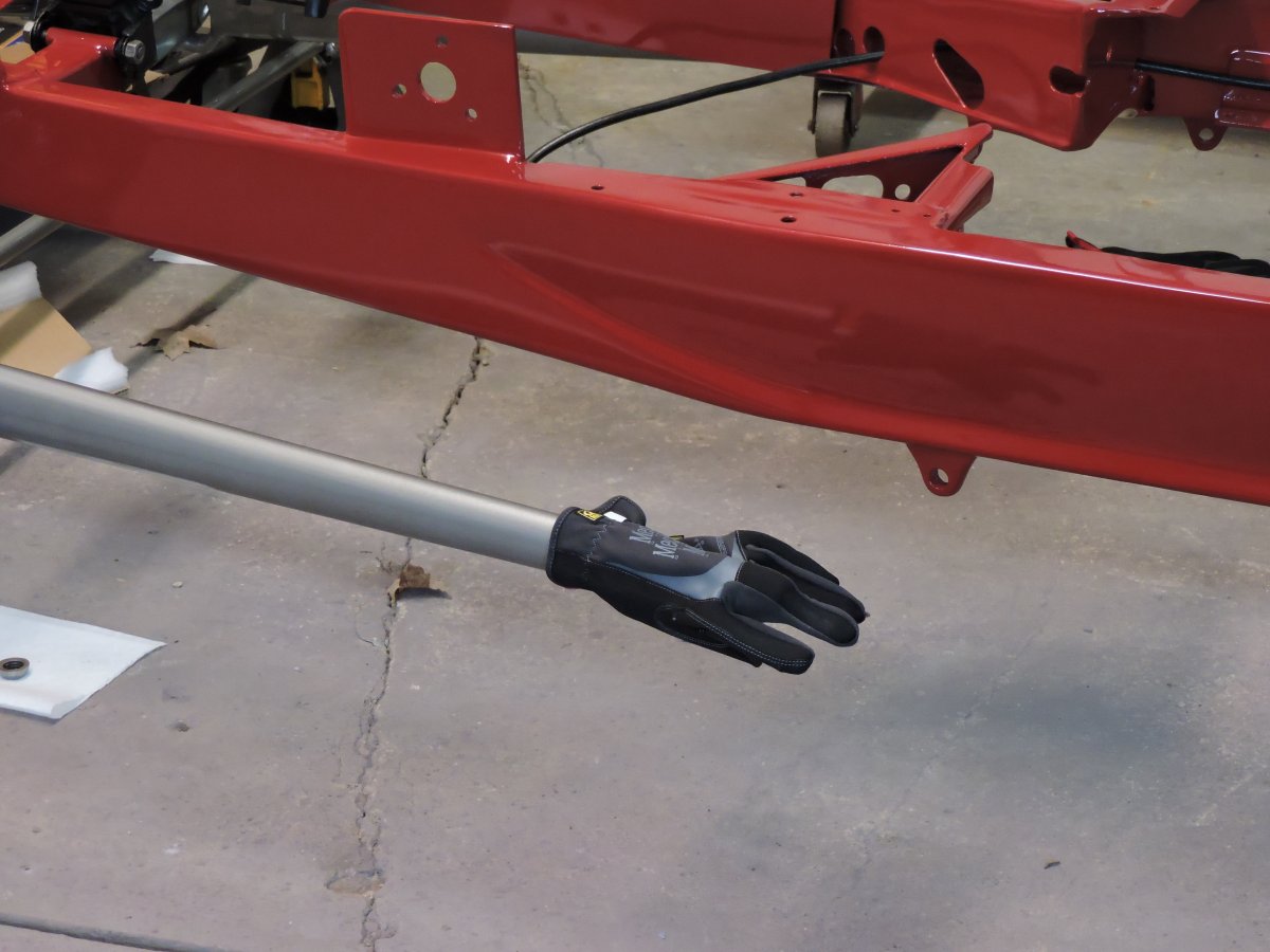

  2. One thing I forgot to say about the cut off wheel. I prefer using a medium size electric angle grinder with a 6" wheel. This gives you some ability to flex the wheel slightly as you grind after the plate is removed. It also allows you to use the edge of the wheel to slice thru the weld. parallel to the frame. The downside is that you can't use a wheel guard to protect your eyes, so you will need goggles or a face shield. I have found that I can control what I'm doing much better with this wheel. May have to make a small adapter to get the center hole to fit your grinder. If you use it on a large grinder it makes it a little more difficult to finese the cut because you are fighting the weight of the grinder as your arms tire.
    Someone mentioned that the rivits might be just phony bumps instead of real rivits. Just look at the inside of the frame rail to verify if they go all the way thru the frame.
    Here are the wheels I use and have had good luck with. I bought mine on Ebay. Bought 100 cost about $1 ea.
    Please do no do this. Cutting wheels are made to cut, not flex and grind. You want to cut using the edge. Never grind on the face of a cutting disk or flex a cutting disk...They can and WILL explode!! Yes there are many instances where they didn't explode but do a google image search on exploding cutting disks and it will give you pause to be very careful. Only saying this as I have 30 plus years in fabrication. It only takes an instant. Lots of great advice just don't want to see any Hamb member injured.

    However if a surgeon told me they would just cut an abdomen ( my abdomen) open and fix the broken somekindathingie then It gets to be a big deal . Not something I do everyday but that surgeon who has a big old iron wart on his 32 frame has got his ******* all wadded up. The surgeon isn’t going to explain how easy it is because it’s really not a DIY hobby. Even though he could do it drunk off his ***.
    So that being said, many here could remove that mess off your frame and even while being totally inebriated

    This. ^^^ Egg-zactly. Two of my gennie frames (both '32) had large holes in side rails, one from a previous owner moving the steering back 11". (?) Probably making an old 'dragster'...
    Other frame had a rectangular hole torch cut, drivers side, in the web of the rail. Right above the 'B' pillar.
    Unfazed, I cleaned up the torch cut, trimmed down some 11 gauge mild steel...V'd the sides of the hole, and welded in a patch...finish weld was ground and FILED smooth, inside of rail was also finished.
    Undiscernible repair, frame got painted BLACK.
    First frame, same thing. Plugs made (even the 1/2" bolt holes) welded and file finished.
    I didn't even HAVE to buy new repop rails...

  6. Leave it exactly as is and stick an amber reflector on it.
    Or........ grind the rivets and center wart down and stick a bigger amber reflector on it.

    Well we Z frames,,,,Repair rusted and cracked section,,,We install new body mounts and crossmembers so I think this small hole is no big deal....Just fix it .... I would....

    It can be patched, and be as strong as the original frame.
    My concern would be the level of workmanship. (Not meaning to trash anybody here.)
    I say this because I see way too many pics on the HAMB of guys mig welding parts that are still covered with paint, rust and other ****. You CANNOT achieve a sound weld when the parent metal is covered with ****. Sandblast, grind, whatever method you have at hand until the piece you're welding is bright, shiny steel. Don't use hot rolled steel for the patch unless you've ground the scale off it and it's bright and shiny too. Cold rolled steel or HSLA if you can get it is preferred, both are stronger than hot rolled. Whatever welding method you use (tig preferred) make sure you have 100% penetration before you start grinding welds. Use the same gauge or slightly thicker material for the patch.
    Personally, I'd rather cut out an area slightly larger than the holes and weld one rectangular patch in, rather than fill one large hole and four small ones. Less heat, less distortion, less cleanup, better finished repair.

    This is unbelievable , Cut it out and patch it , done deal

    As others have said, I'd just cut the welds and repair the hole. Do a nice job welding it and smooth it out. You should be body working your frame anyway, so nobody will be the wiser.

    Good advice and I agree everyone should work safely.......so let me try to explain a little better. In order to use a cutoff wheel like this on a medium size angle grinder you can't keep the wheel guard in place, so there is no protection other than a face shield and some decent clothing. Once you have made the cuts to slice thru the weld and have been able to chisel/pry the plate away from the frame, there will be a small "ridge" remaining on the surface of the frame. If it is still thick, use a normal "hard/thick" grind wheel to get close to the frame. When you are as close as you feel comfortable grinding with a hard wheel, change back to the thin wheel. You are still cutting with the edge of the wheel but the side does touch the frame surface lightly. The side touches lightly even when you are just slicing, so there is very little difference in what the wheel is feeling. The slight flexibility of the thin wheel allows a more deft application and it tends to slide across the surface of the frame while removing any remaining metal protruding above the surface. Its still basically cutting with its perimeter edge but it allows the builder a better method of preventing co**** grinding of the frame. It should be understood that you don't want to use a "heavy hand" but rather a little finese, and the slight flexibility of the wheel allows for that. Its hard to completely remove a weld from a surface with a hard solid wheel and not get into the base surface. I have successfully used my suggested method many times. It should go without saying that one should keep his face away from the grinder when doing this, and a face shield and leather gloves should be used. One other thing, I suggest that whether you own a welder or not, get a pair of Tillman "Deerskin" gloves and you will love using them on just about everything. Don't use em on greasy stuff, but all your fab and lifting and welding , they are great. Get the "deerskin", as I haven't tried the other "skins" like pigskin or kidskin. I usually pay about $12 for a pair at the welding store.....so don't get gouged . Try a pair of them and you'l love em.......and I'm not affiliated with them.;)
    https://www.amazon.com/Tillman-Larg...rds=Tig+welding+gloves&qid=1581622560&sr=8-95
    One other very important thing..........when you put this size wheel on a medium size grinder, the edge of the wheel will be very close to your finger and it will make one of those thin slices that bleeds like he**. Thats another reason for the gloves.

    You could also use a good quality plasma cutter in gouging mode with the right consumables and machine setting which will easily shave rivet heads off AND clean out the weld without damaging the original metal. It is a quick and very efficient way to fix this.

    I appreciate all the reply's. I havent done anything yet but I am going to cut it out and just patch it . I will post pics when I'm done . Thank you

    LOL!!! you guys kill me, This is baby ****! You should see some of the frames i have repaired over the years. My 5 window Frame (that went to New Zealand) was put together out of 3 rough original frames. Cut the damn thing off there and clean it up. the rear clip in these pics with all that extra **** welded on it. Is getting used as we speak. when I am done cleaning all that **** off there and filling the extra holes you will never know it was even there. rear frame (2).jpg rear frame (2).jpg rear frame (2).jpg

    keep in mind if that is truly the way you want to fix this that part of the rail is not flat metal. I would cut into the weld with a cut off wheel and knock the plate off and weld up the holes and metal finish it with a flap wheel and a final it with 40 grit disc on a DA.

    Have to disagree with using plasma cutter in this situation because one slightly wrong move will damage the frame. Better to proceed slowly .
    If you think you are just going to cut it out and replace it, why not at least try the method I suggested before you cut a hole in the frame? You can always cut the hole later but I think you will find removing the plate will work just fine. Nothing to lose by trying, and you may learn a few things from trying.
