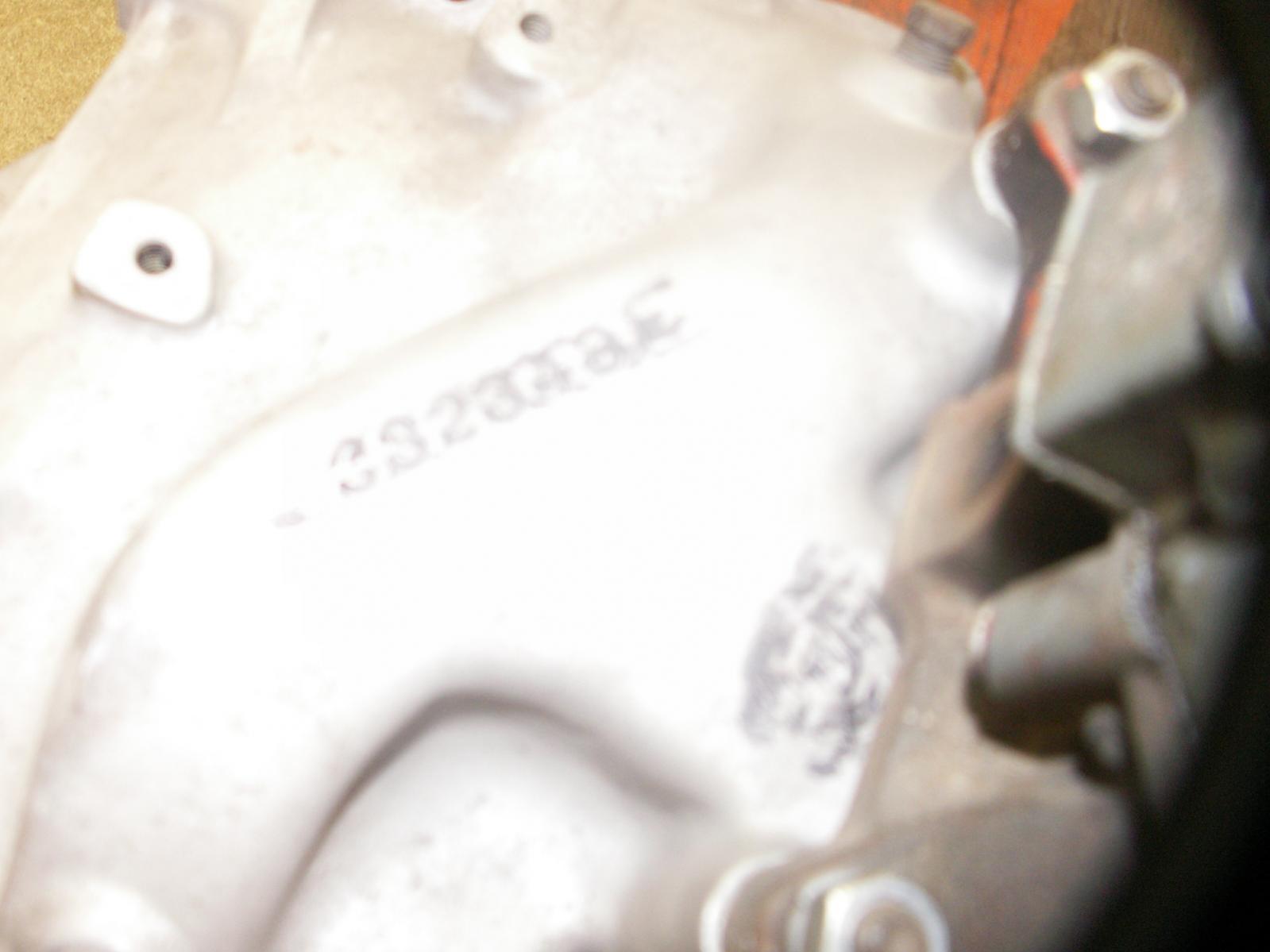

    sure, have several of the early iron intakes. P/M sent. Also have a GM aluminum intake, almost identical to the 56-57 iron single 4bbl intakes (4GC or WCFB), apparently manufactured for marine use. Cast 3923481. Will sell for $200.00. Jay 302.322.1833
