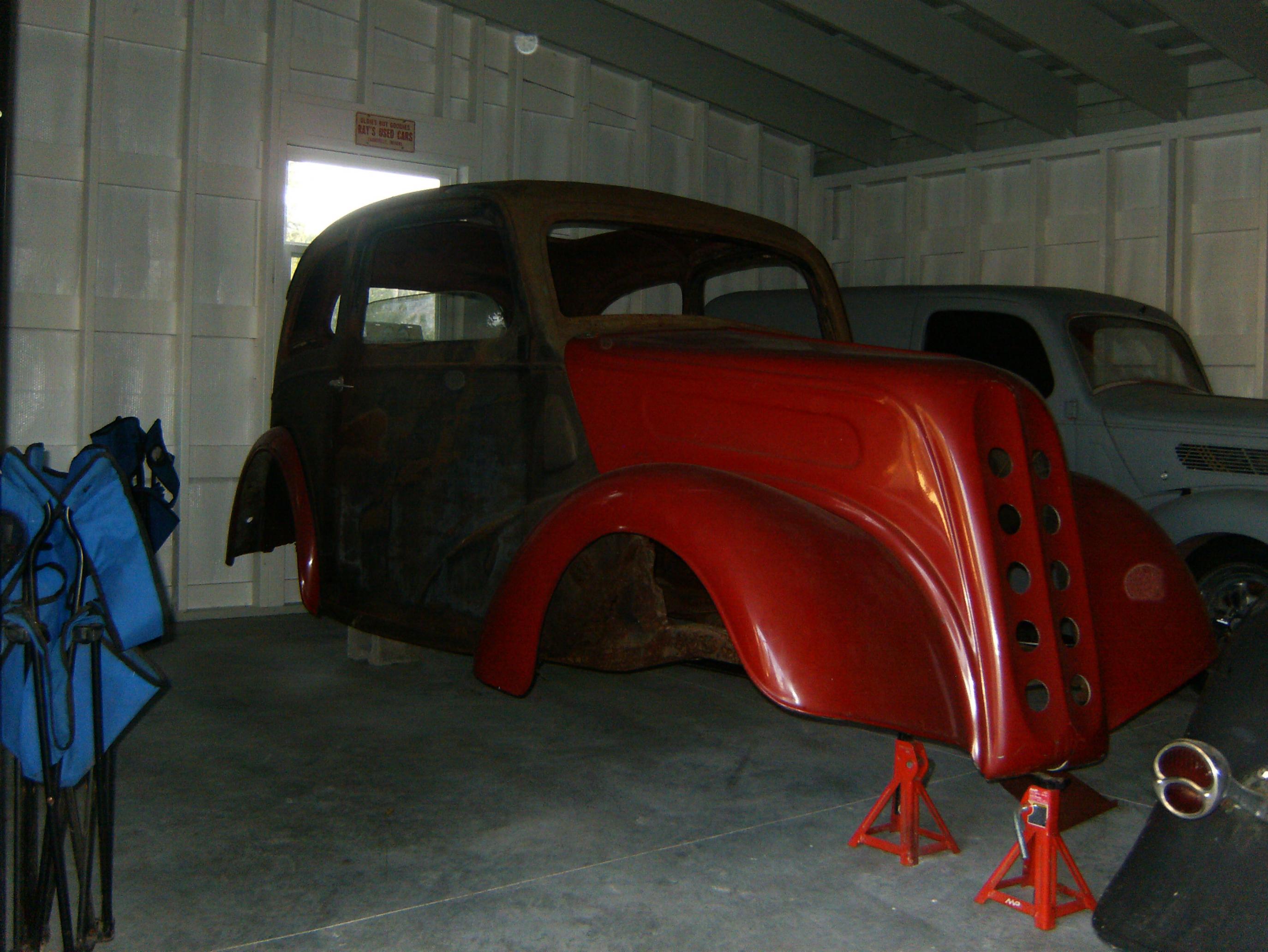

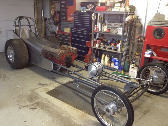

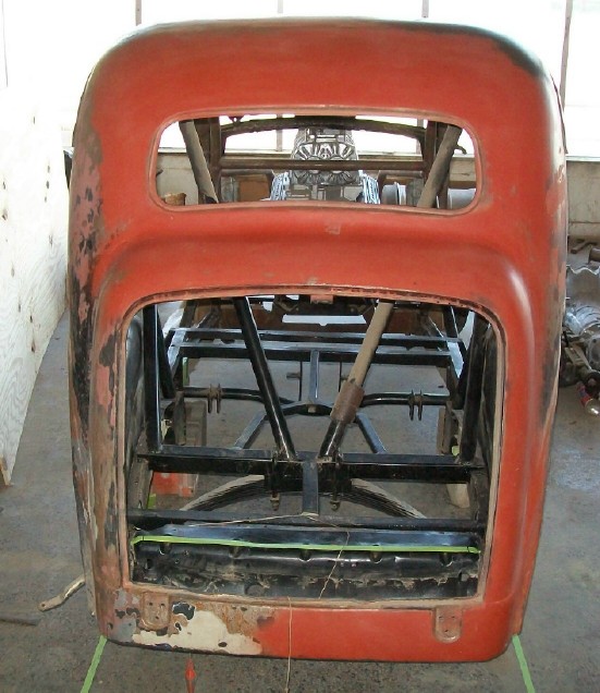

    here are a few photos of my anglia compition coupe dragster build.located body near my home the orange photo. putting it on my ch***is research modified ch***is. enjoy mike

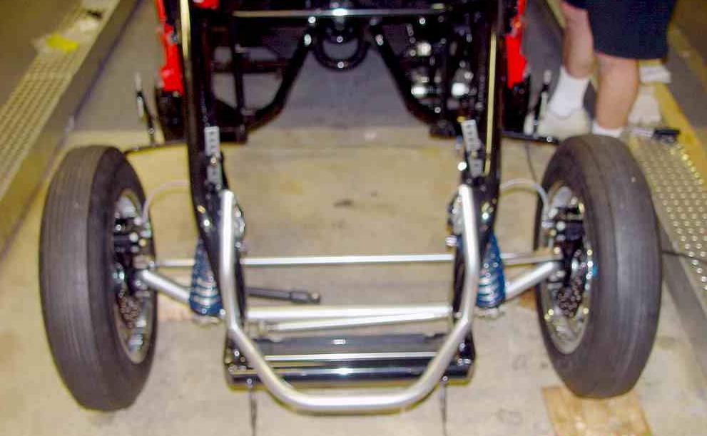

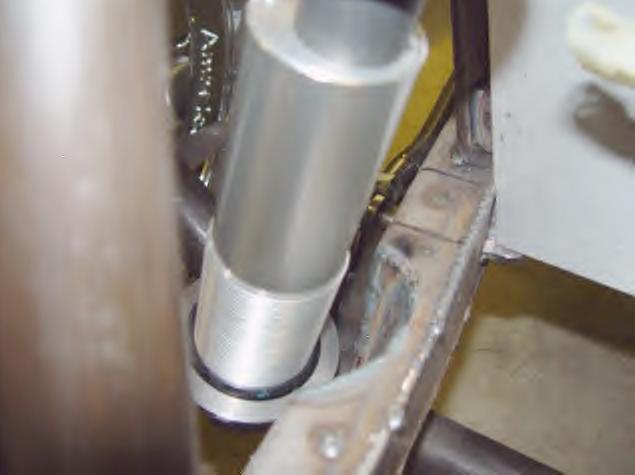

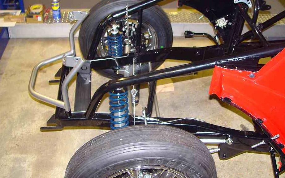

    Here are some pictures of a 4 bar setup with coilovers...

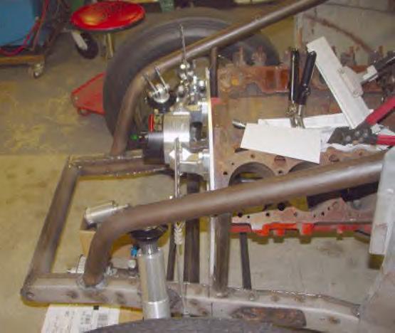

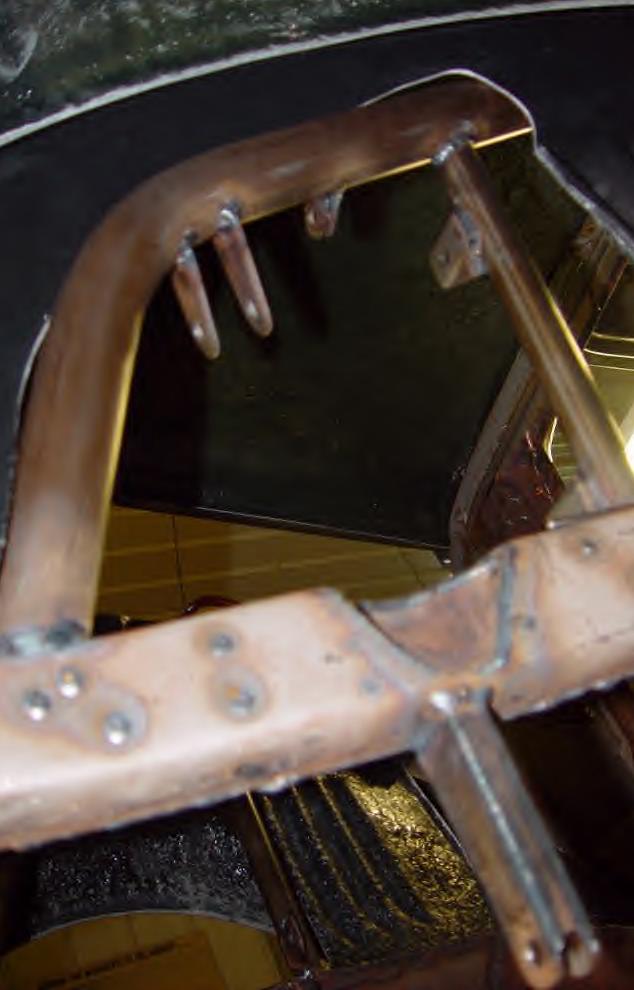

  12. I'm making a little progress on mine....

    Mike that thing is bad***!!!

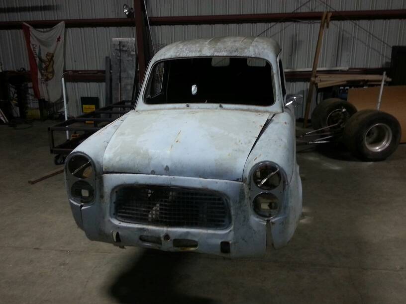

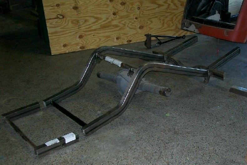

    Gathering parts for this project. Planning on using the back half of this ch***is with the stock frame in front. Still looking for a front axle set up if anyone has one.......
  22. Larry T
    Joined: Nov 24, 2004
    Posts: 7,921
    Larry T
    Have you rolled the back half up next to the car and looked at it? Looks like the frame kick up and the seat might wanna share space.
    Ask me why I looked.
  23. c322348
    Joined: Nov 28, 2007
    Posts: 343
    c322348
    That's why you don't want to fill the roof, so your head can stick out! :)

    Looks like you've got enough Anglias to measure, but I was messing around with mine and threw a tape on it to get a measurement. From the centerline of the axle to the rear door post is 22 1/2". That's with the CL of the axle moved back about 1" or so for tire clearance. Also my seat is set so that the back is about 12" behind the doorpost. I'm a little over 6' tall and need all the leg room I can get since the firewall is moved back for engine clearance.
