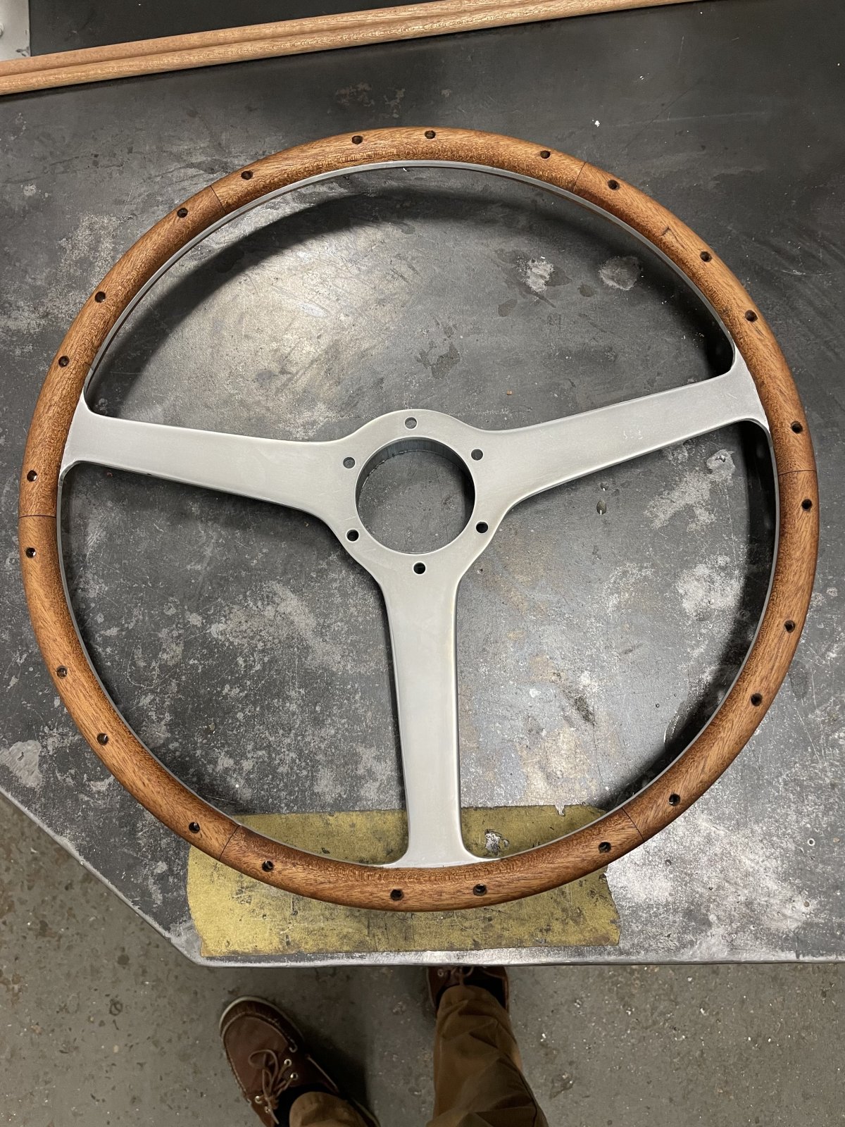

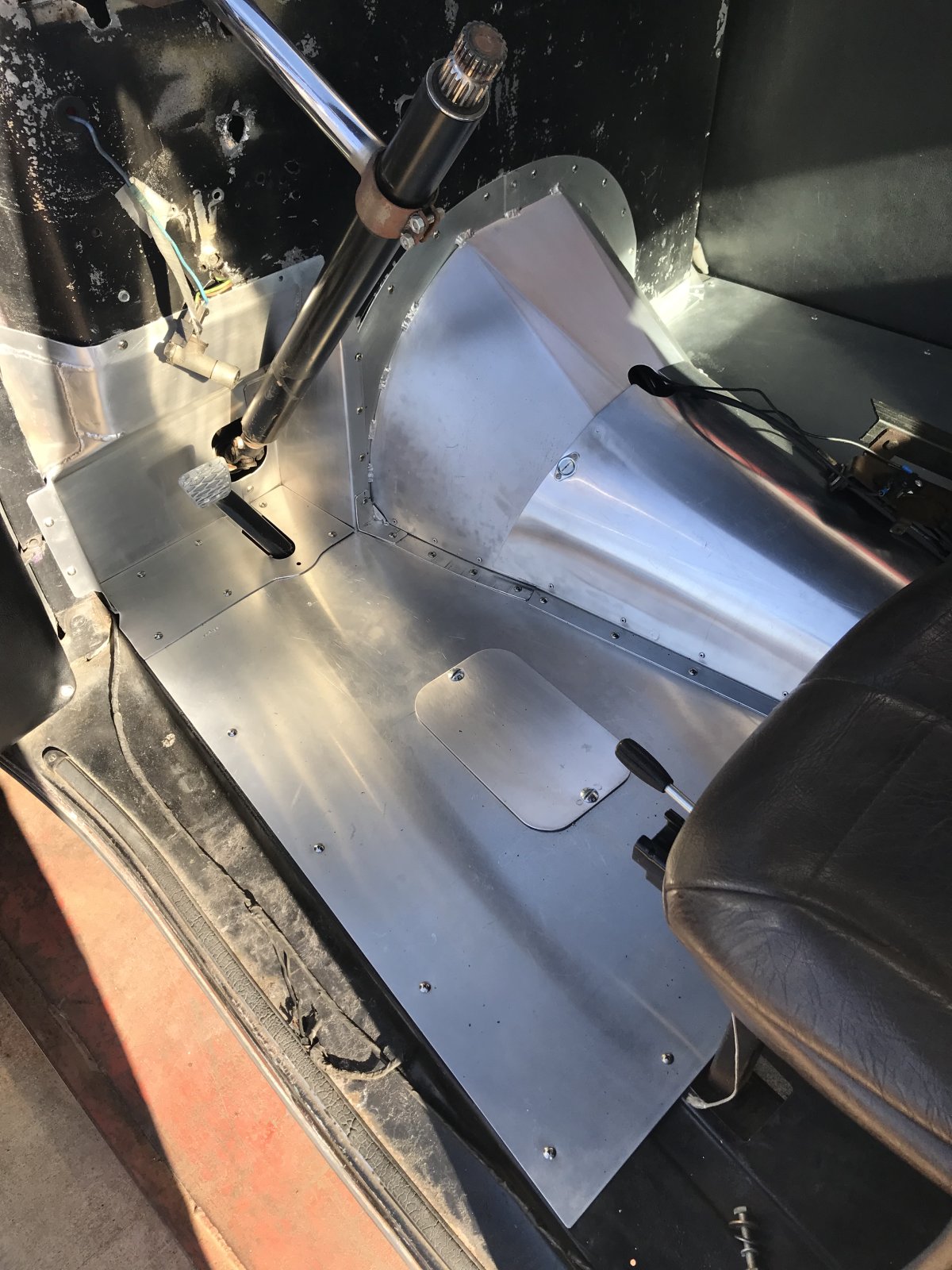

    fabbed this a few weeks ago for a 50s sports car l’m fabbing. hope this helps get the gears going.

    @Pat Pryor nice work ! Are the rivets steel or aluminum? How did you set them ??

    They are aluminum. Milled a half-moon shape in a 3/4 plate to use as a buck, put the countersink side of the rivet in the half-moon cut out, peened the other side. The half-moon shape also contoured the rivet.

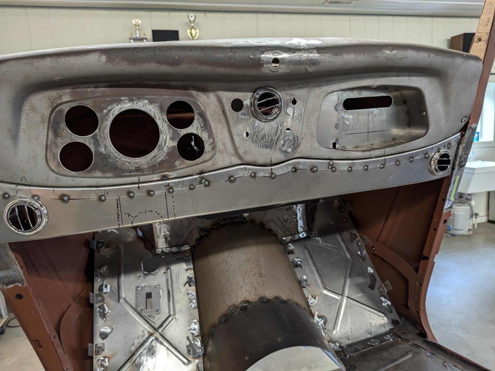

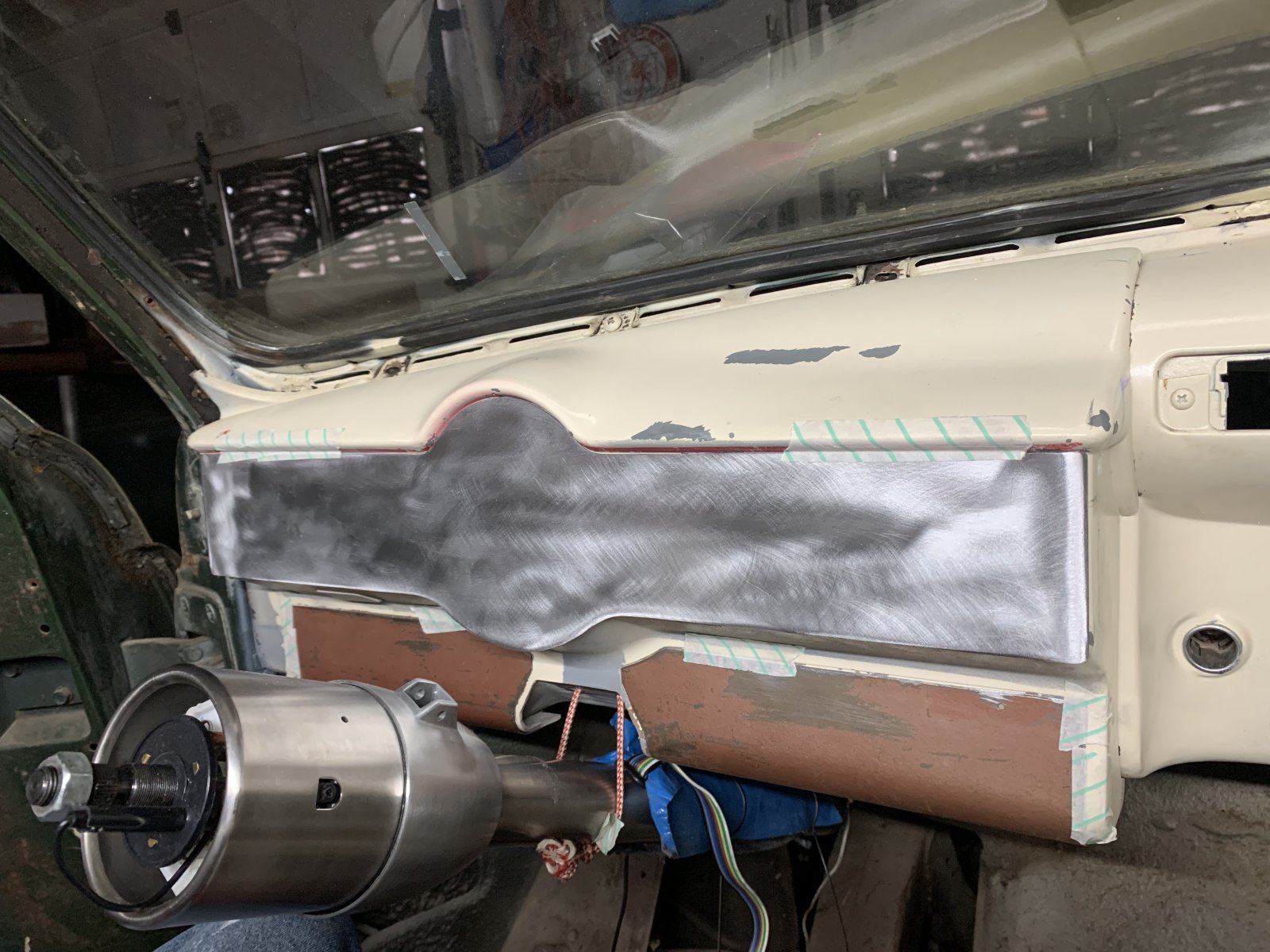

    I made this lower dash panel to cover my AC unit and provide a good place to mount the side vents in my 34 Ford. Fabricating is my favorite part of the build and there used to be a lot of it on the HAMB. Unfortunately, when it shifted gears to strictly traditional, lots of the good fabricators either left or quit posting.

    @Pat Pryor I got you, I did the same thing making rivets for my ak-47 builds ! Ended up making my own jig for that.
    @rockable OK that explains why when I'm searching alot of the custom fab work I find is old posts...

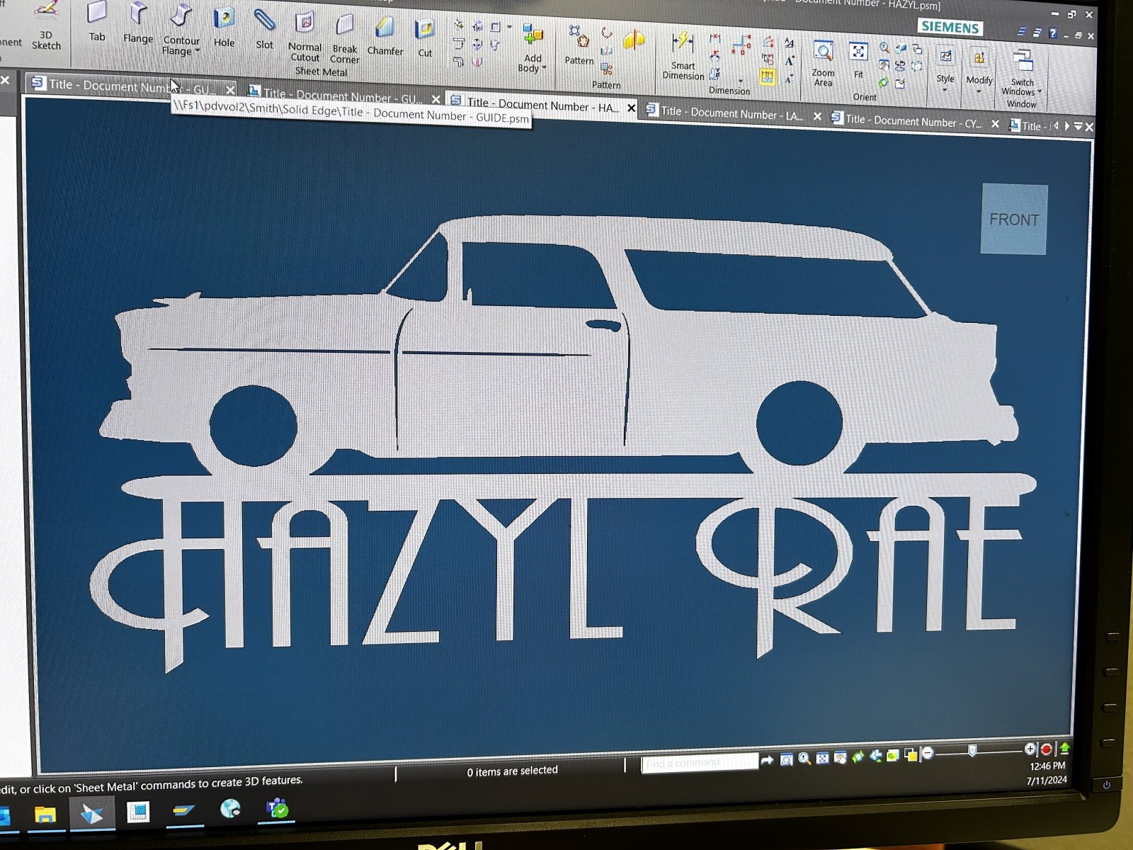

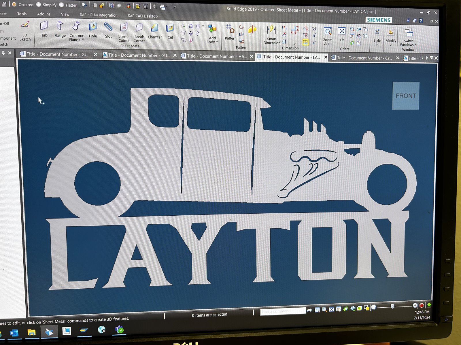

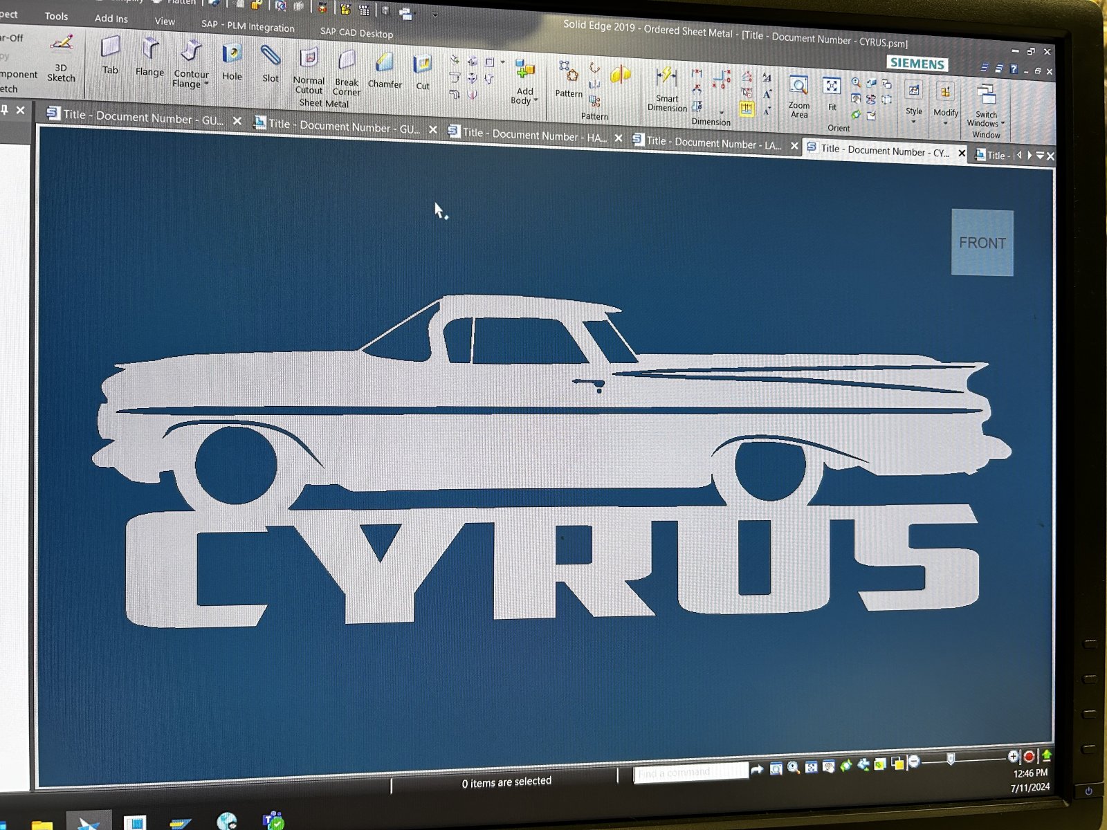

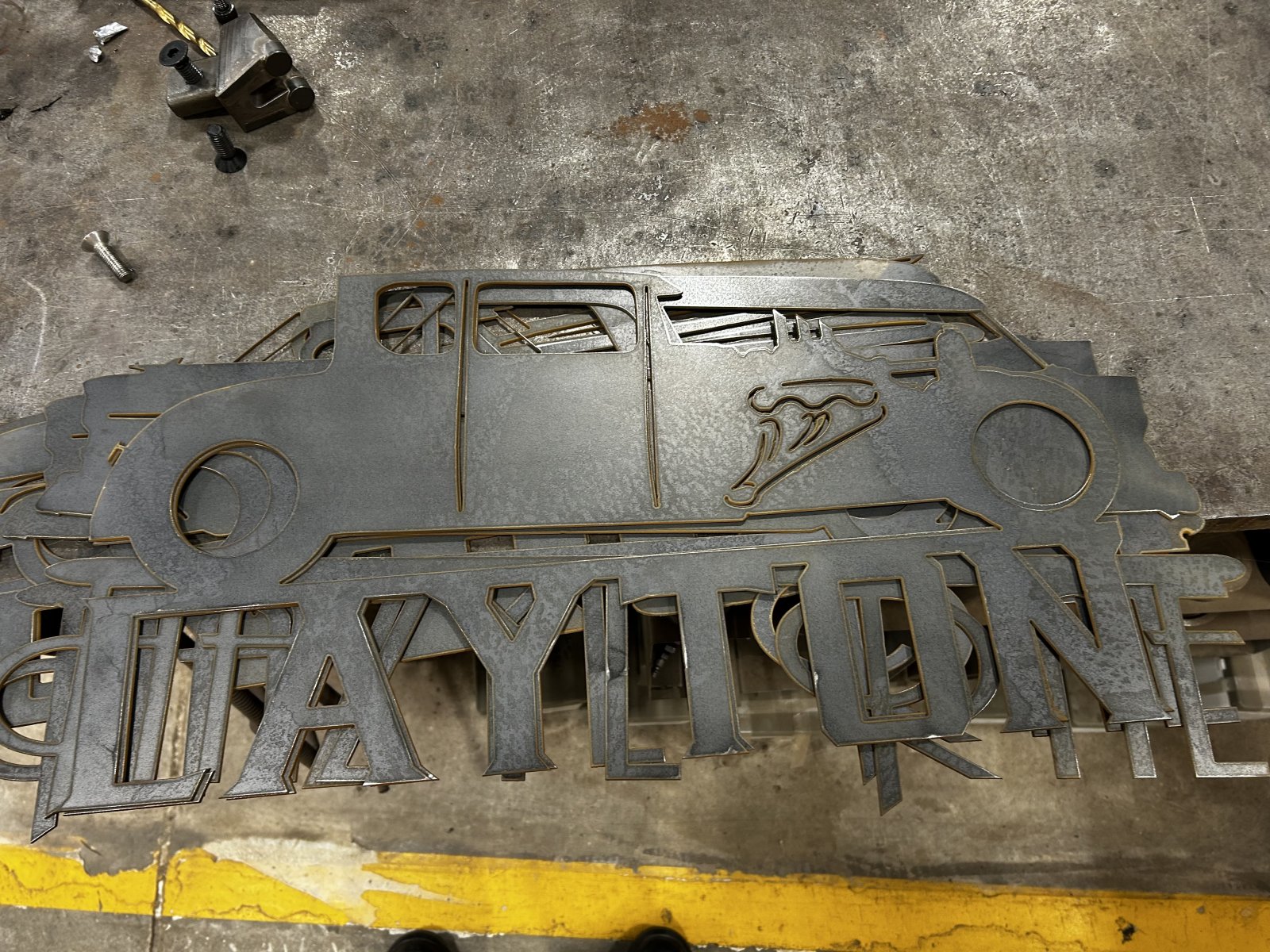

    What are we fabbing? I drew these up and we cut them on a waterjet this week. Does that count? They aren’t parts, but I make those too sometimes.

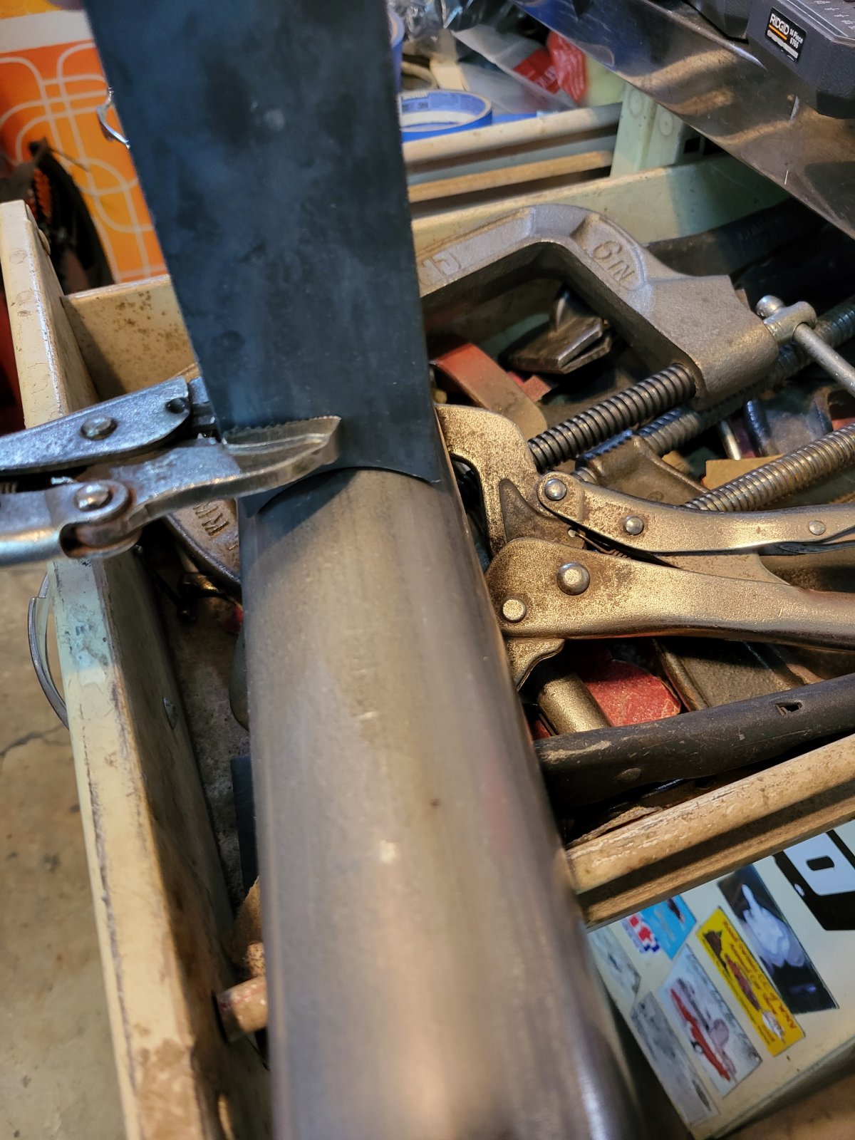

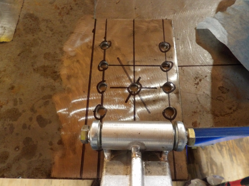

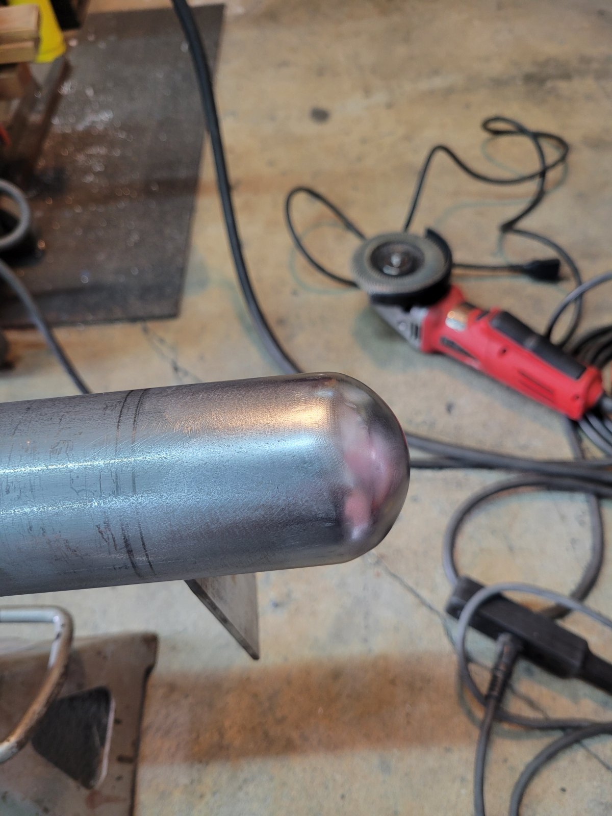

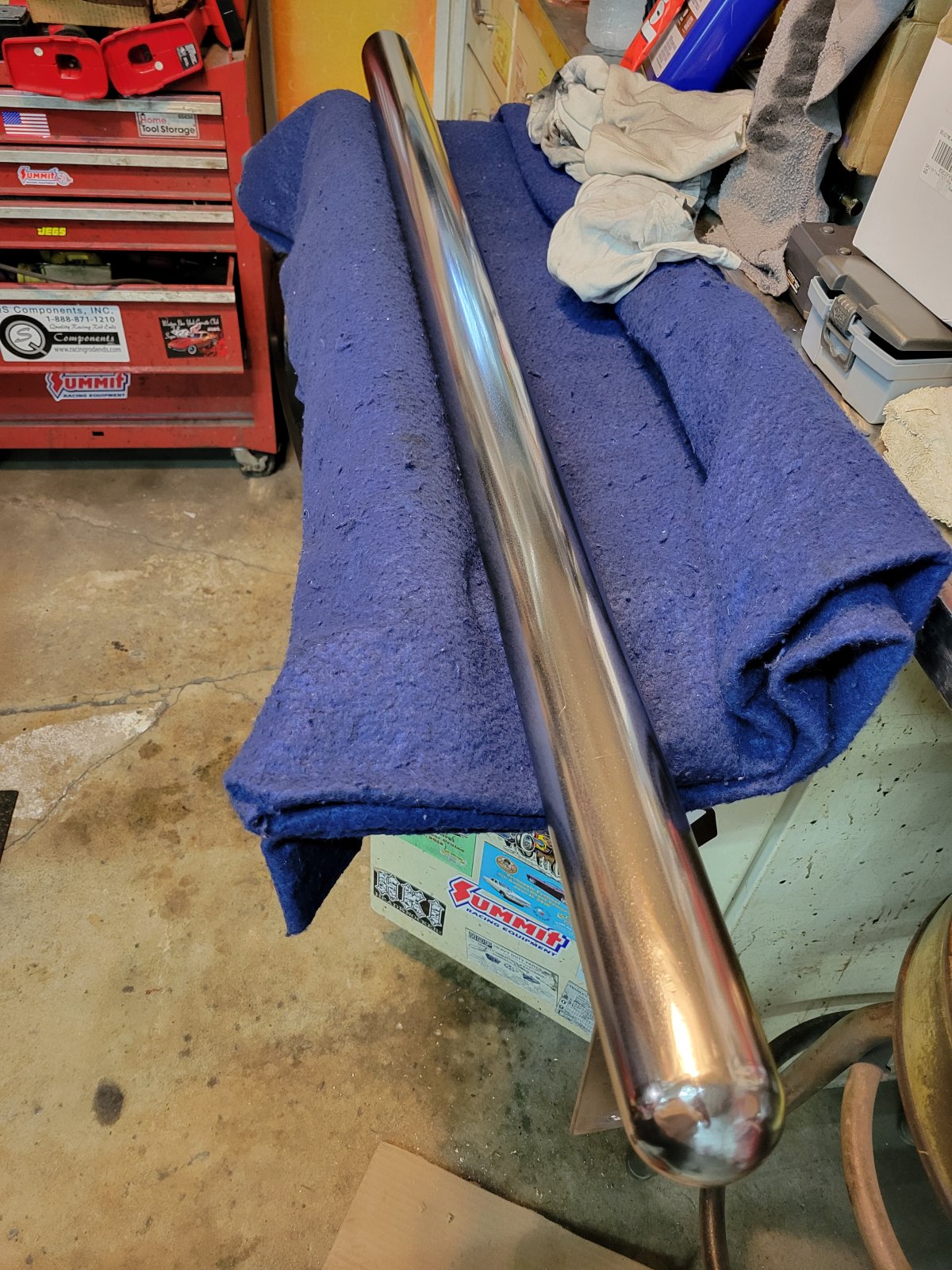

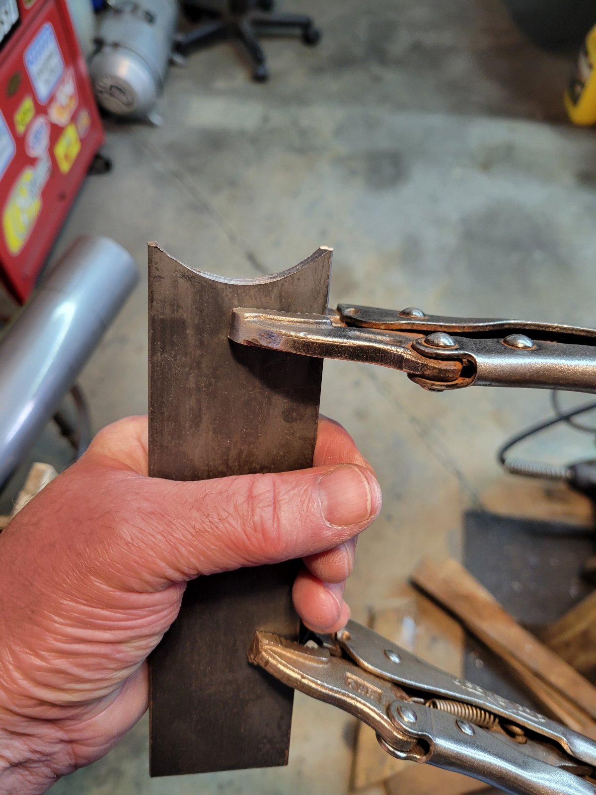

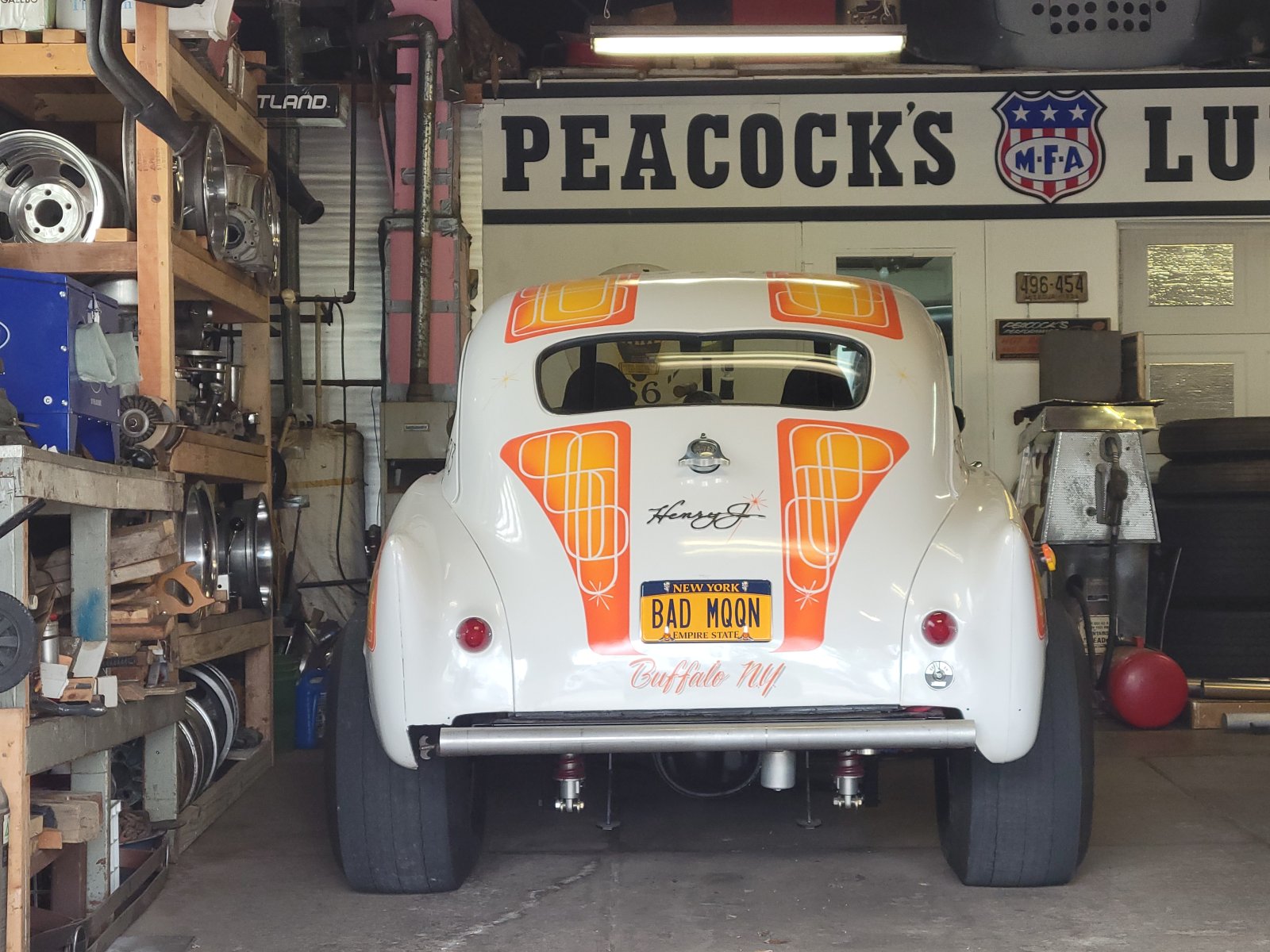

    I recently built this steel tube bumper out of 16 gauge pipe then polished it

    I found some press formed half round caps on Etsy of all places, I got to carried away with the welding and finishing with a flap disc and didn't take photos.

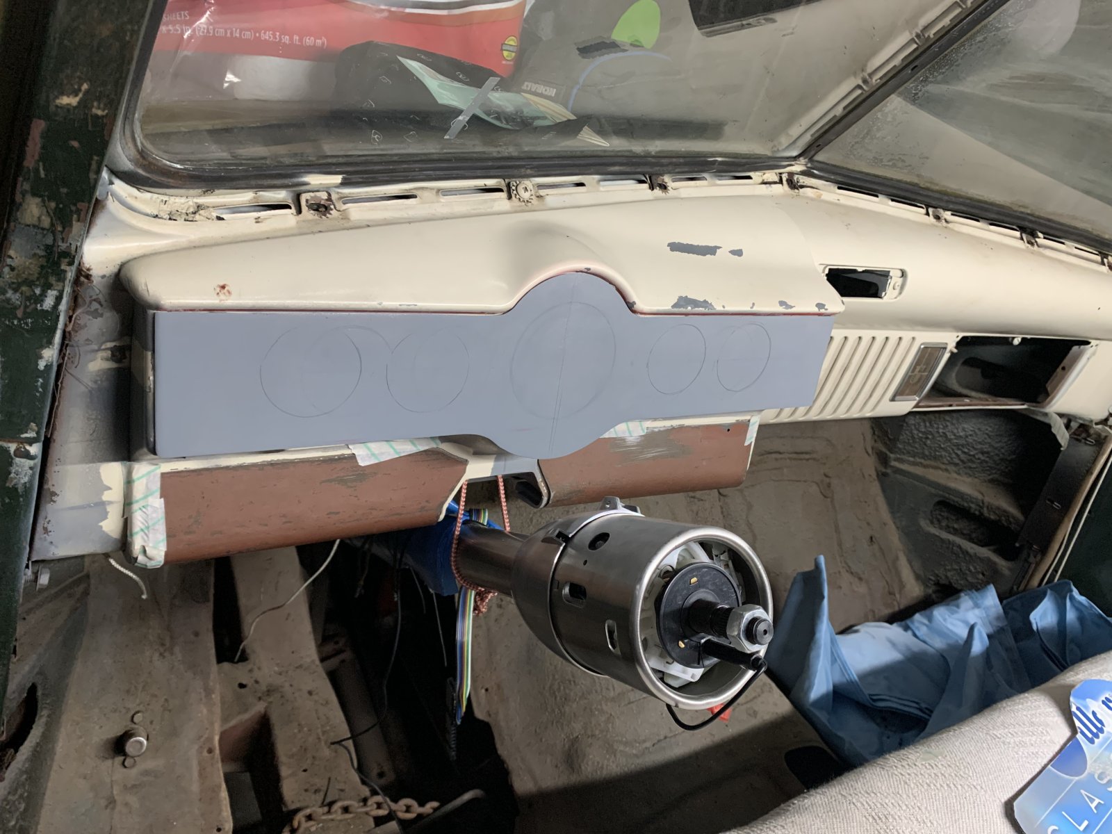

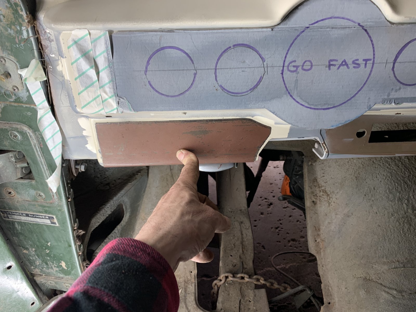

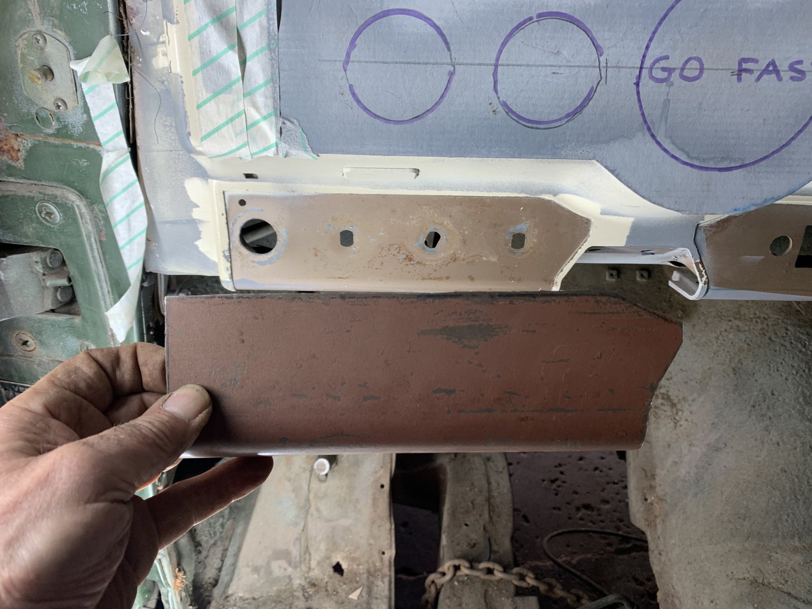

    I’ve been fabricating, but using C-clamps, angle iron and cardboard patterns isn’t really very innovative. I got the results I wanted.

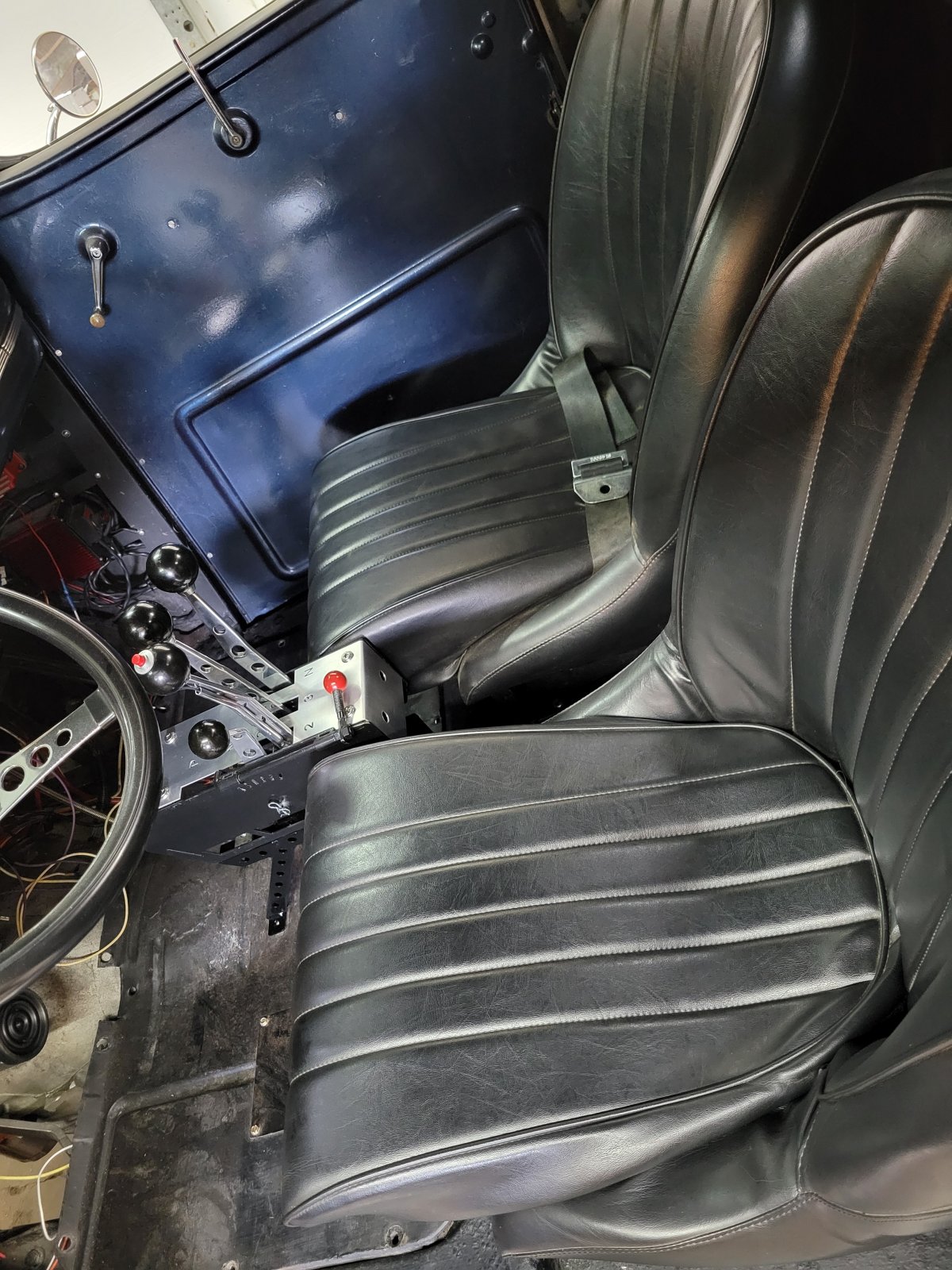

    I just re-did my 1x1 shifter bracket too, to hold the new shifter, drilled 43 speed holes in it to try and lighten it up a bit. New USA made Kilduff shifter is heavier and wider to fit all the Lenco looking levers, sure ate up the space real fast in the small cab confines.

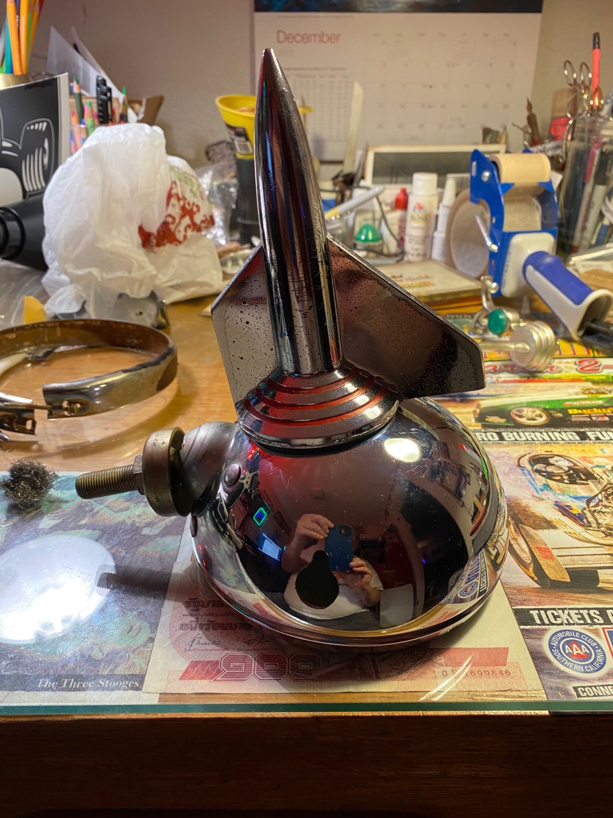

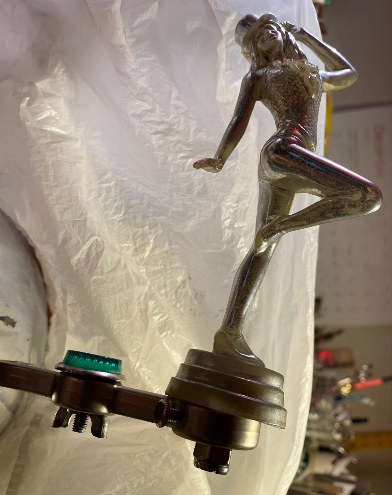

    Interchangeable mascots, for the back side of a Dietz, red lens auxiliary light.

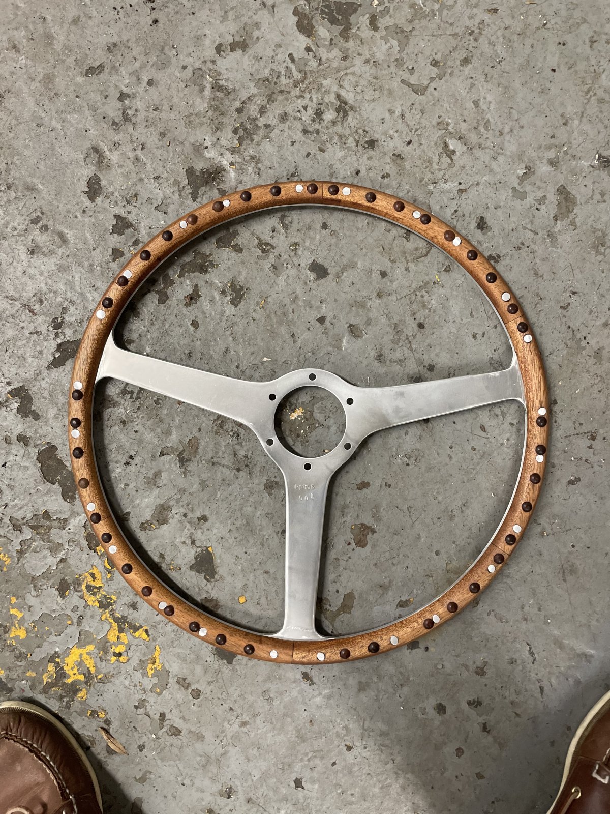

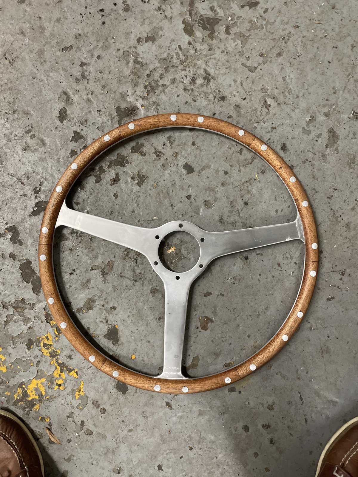

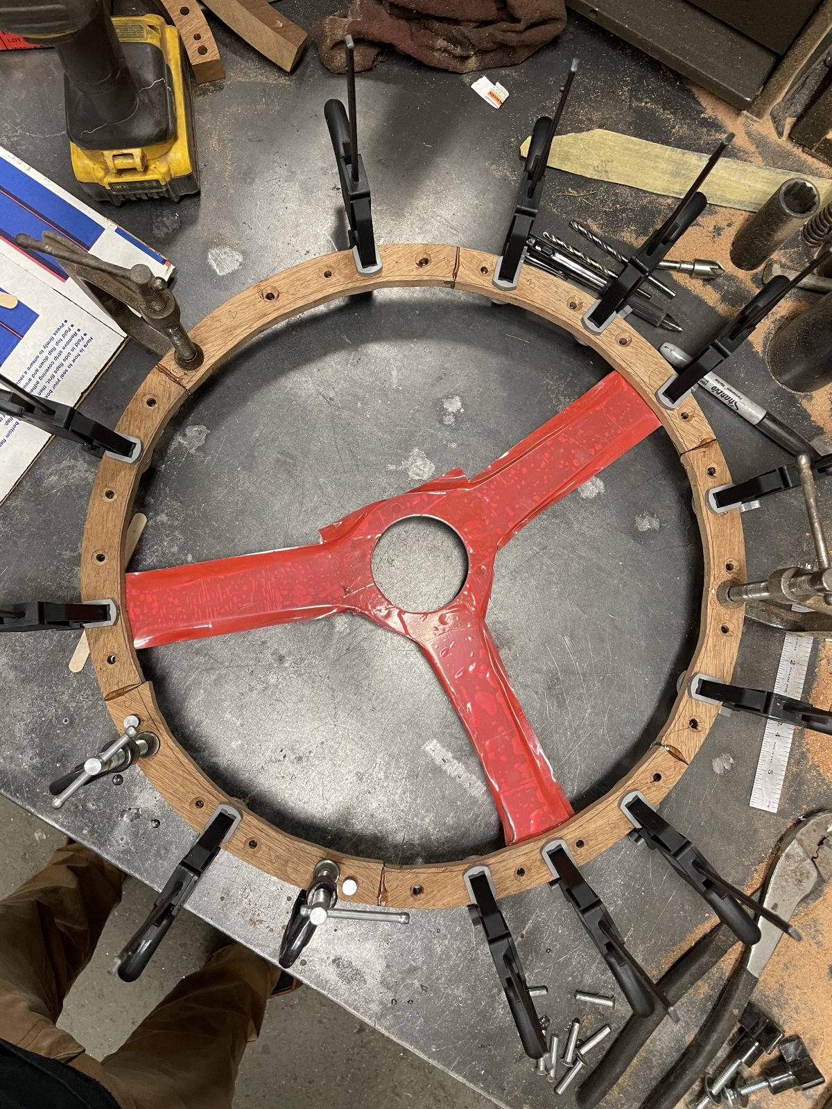

    Belly Tanks steering wheel was great fun to make. JW

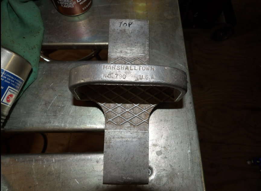

  28. I found this drywall lift s****ping and thought it would make a great throttle padel! Six hours of cutting, (built the steel mount as well) working at the drill press, the lathe, and T.I.G. welding I think it came out pretty good!

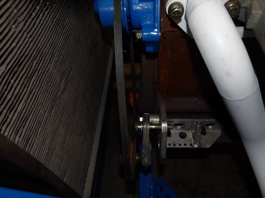

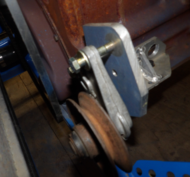

    I needed an idler pulley for the racecar. Being a purest and refusing to use modern parts I decided a Corvair unit would fit the bill and built a bracket to work on a 261 Chevy! I still need to finish the upper support.
