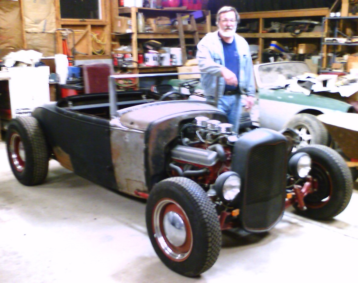

  1. Marty Strode
    Joined: Apr 28, 2011
    Posts: 9,703
    Marty Strode

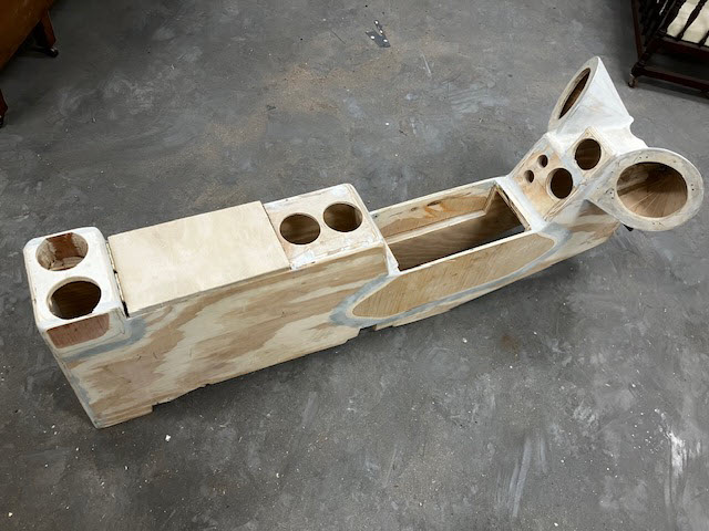

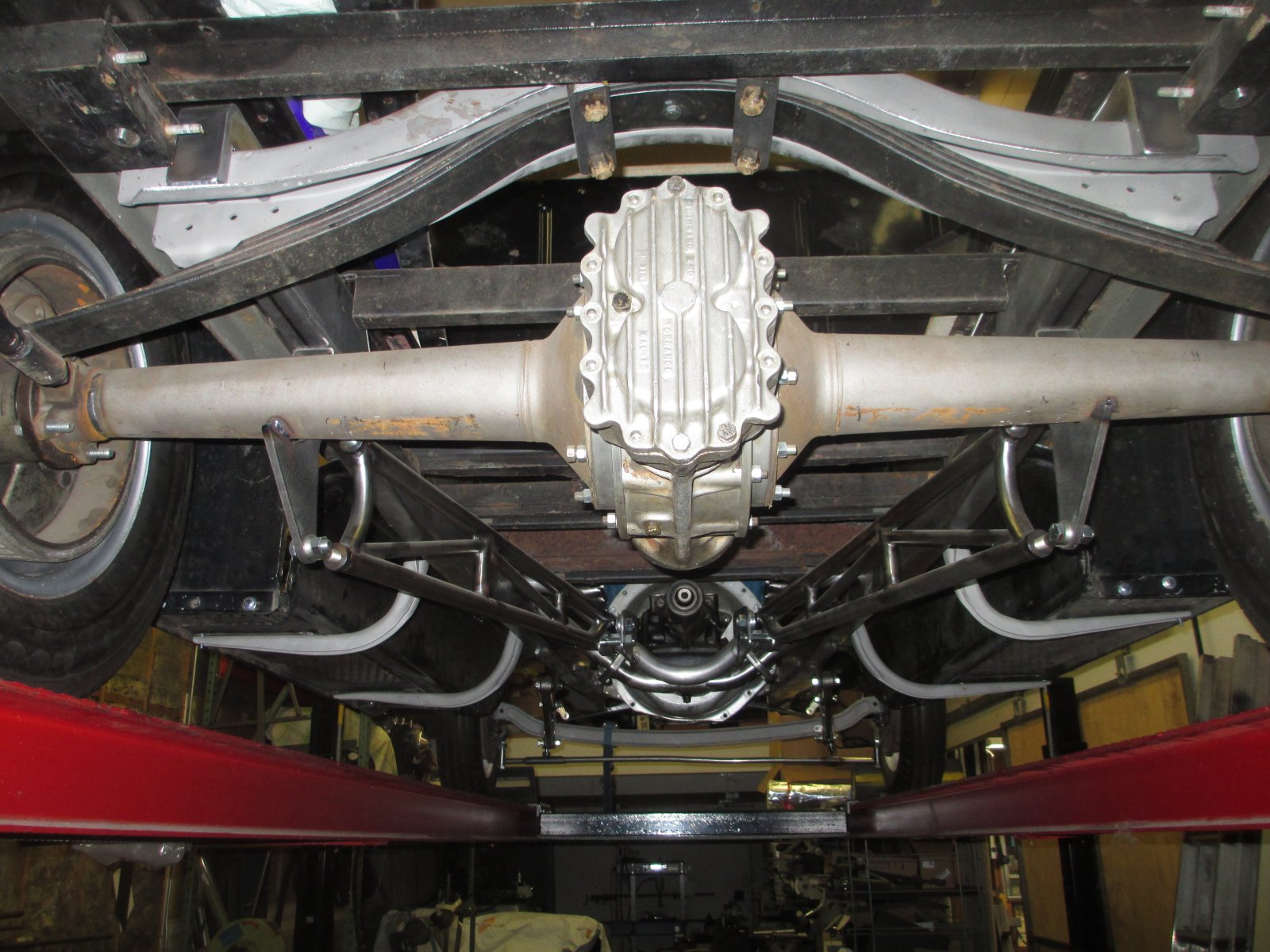

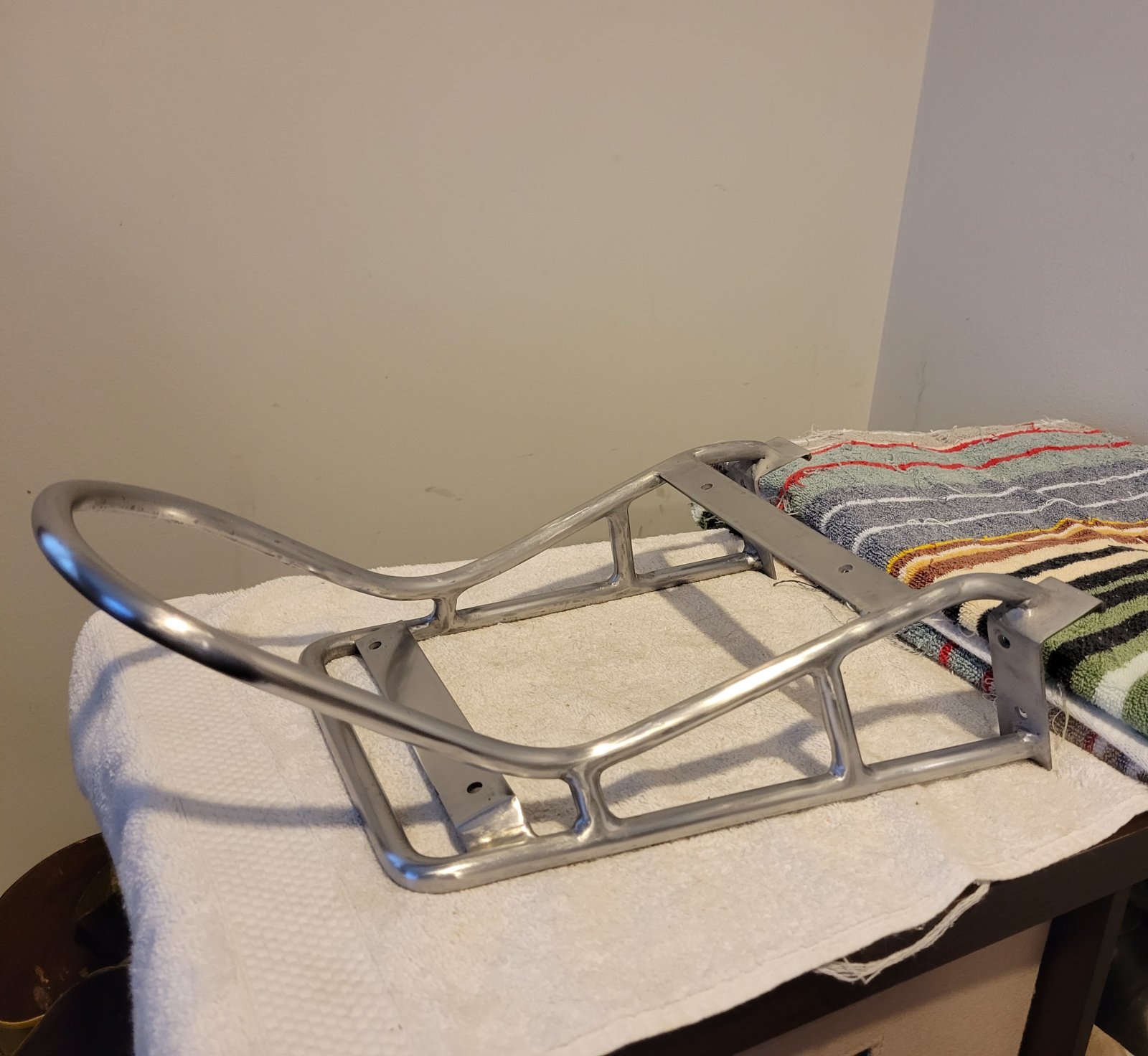

    @choptop40 that's looking good, again this is the kind of stuff I love.
    @guthriesmith that counts, love to have a plasma table myself.
    @gene-koning please never let negative opinions stop you, I have found I have learned more from those people due to the fact they seem to think outside the box more often, more creativity, different views that open up my eyes to learning. I believe if you reach 1 person, teach 1 person then it's worth it...
    @swade41 nice job!! Again this is one of those jobs that could be used for a bumper, smaller tube to make grab handle for a dash etc. Curious about the ends too but seen you answered it in a later post !! Nice job on shifter !! I'll post a couple pics at the end of this posts.
    @bchctybob again nice to see different ways to do the same job, using what's available and learning a new way to get to the same place!
    @41 GMC K-18 that's awesome ! And exactly what I enjoy! Thinking outside the box then figuring out a way to make it all come together.
    @26 T Ford RPU that's some nice fab work, starting from nothing and then having a complete frame ***embly. Love that steering wheel !
    @Robert J. Palmer love it ! Again having something in your hand but seeing something different then altering, modifying it until it does something totally different than its intended design ! Nice bracket too, I'm going to need to build some for my 440 31' tudor.
    @Marty Strode nice work as usual!!
    @Mitchell Rish I'll be looking them up !!

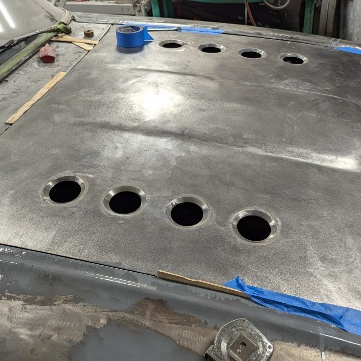

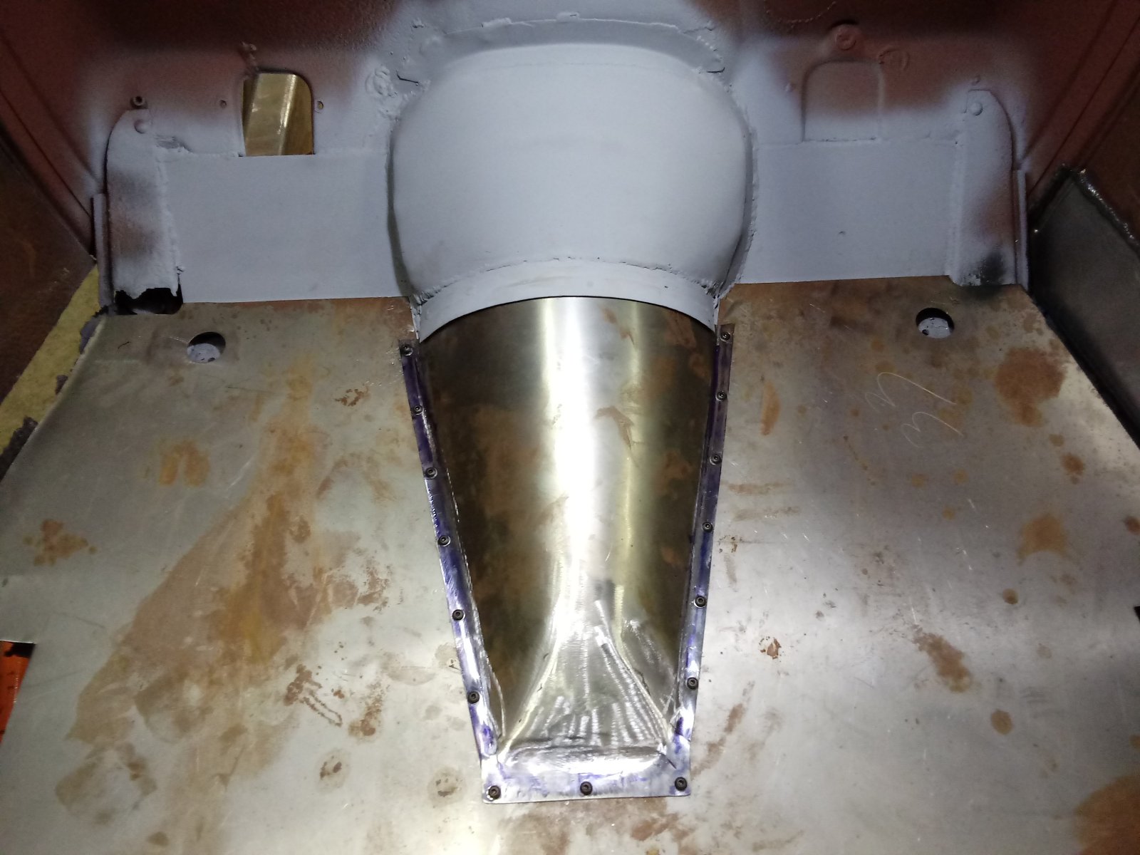

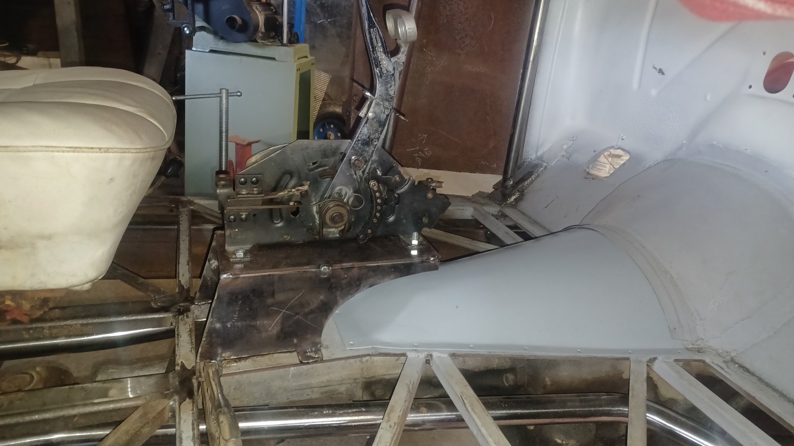

    A couple pics of my stuff, shifter stand, floor panels, just to go along with what's been posted !!
    20240312_182247.jpg 20240312_182127.jpg 20210729_200310.jpg 20211127_144828.jpg

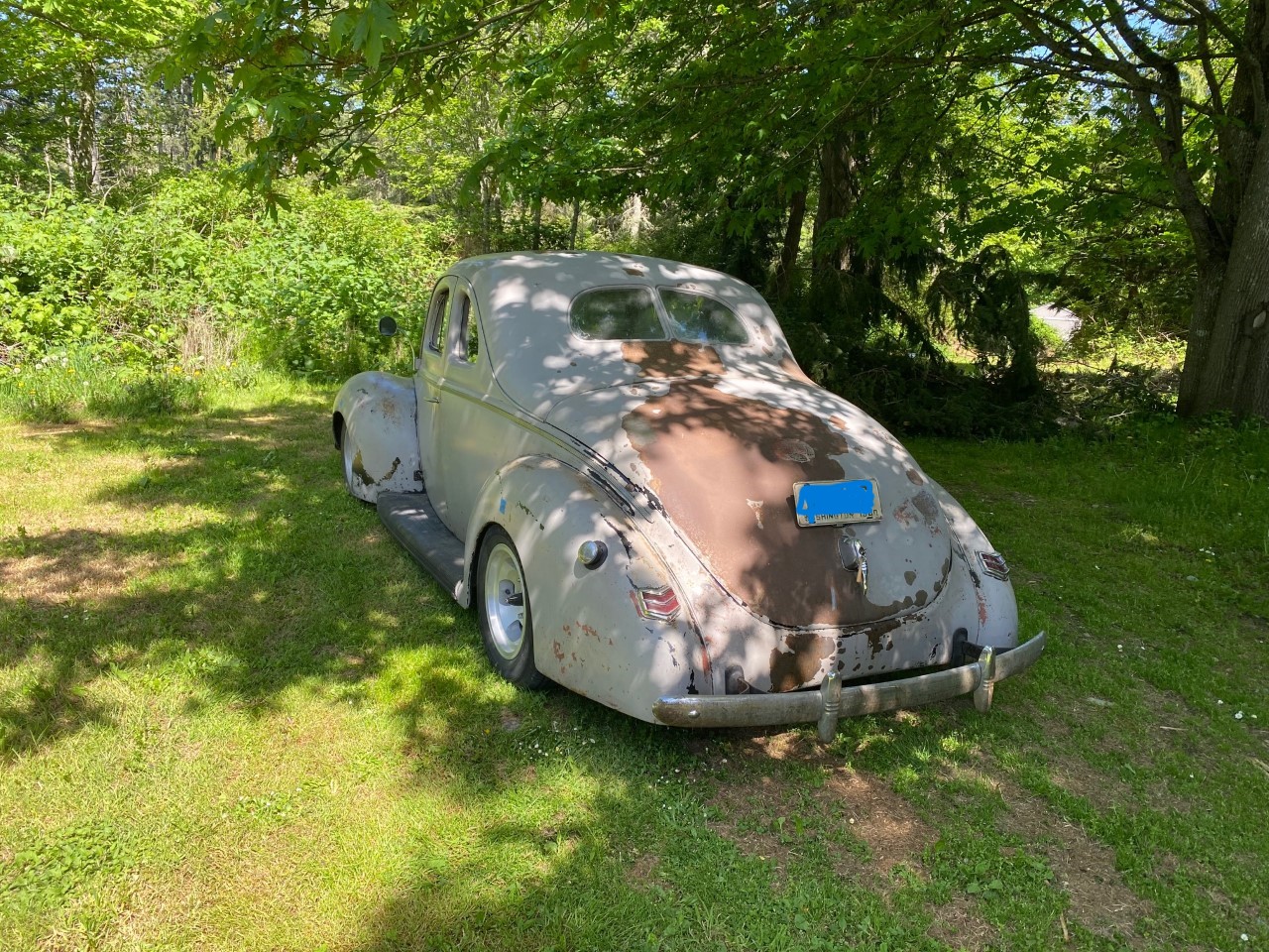

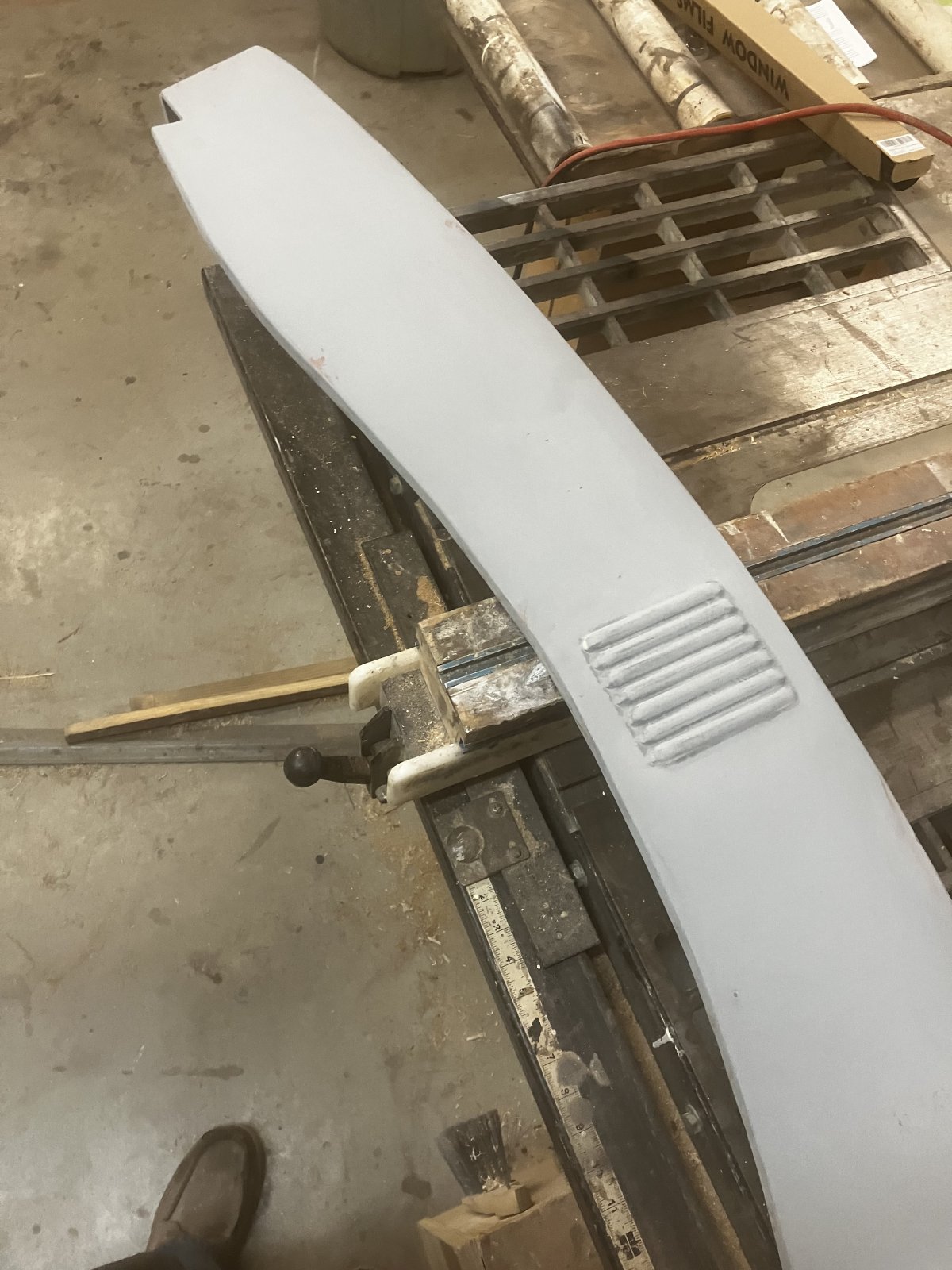

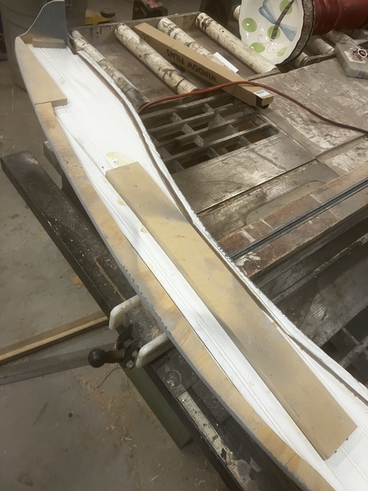

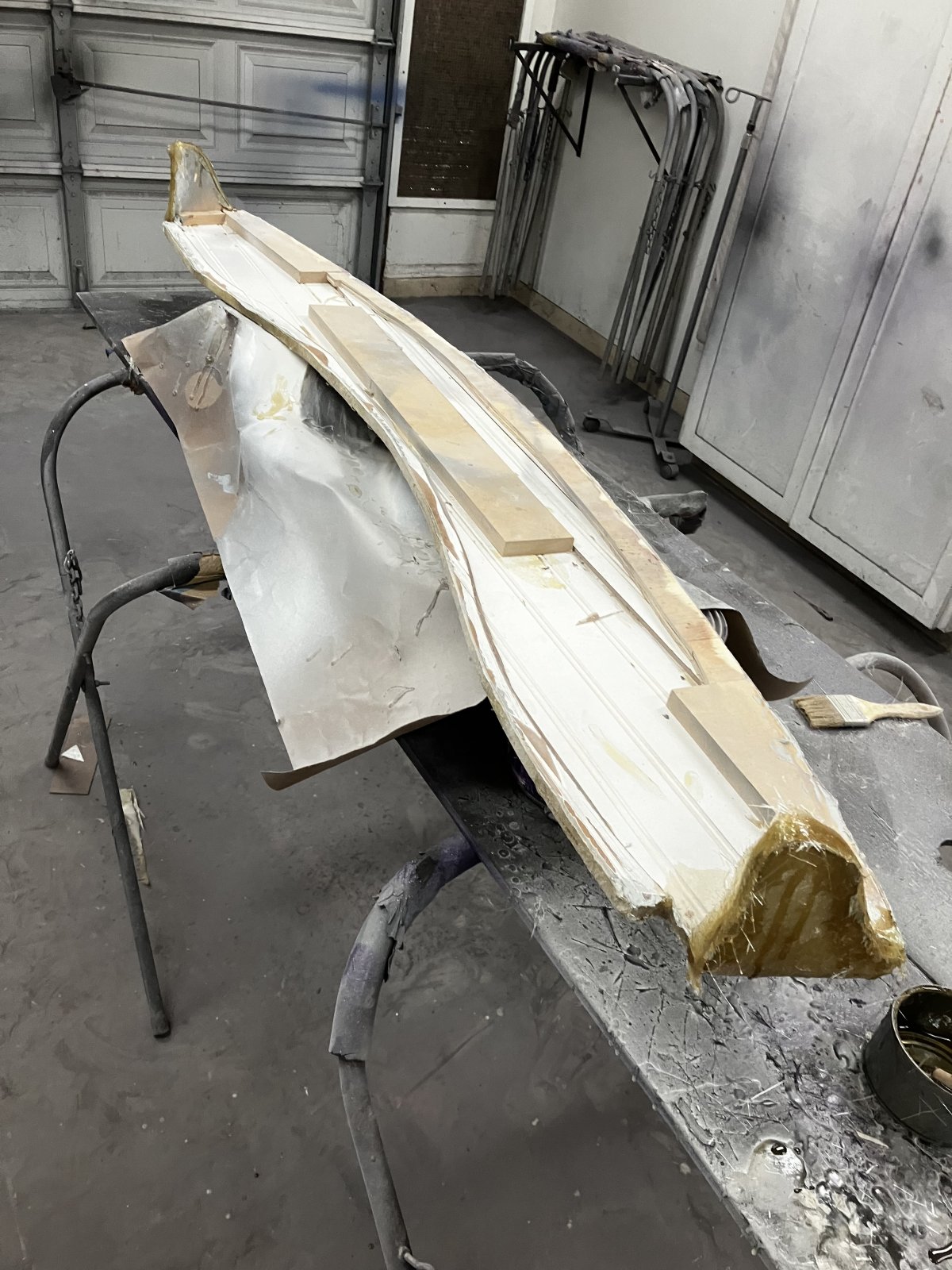

    Had to make a fibergl*** bumper skirt for the '40 Plymouth. Made Masonite/pine pattern, took a fibergl*** mold off that, then made the fibergl*** final part in the mold.

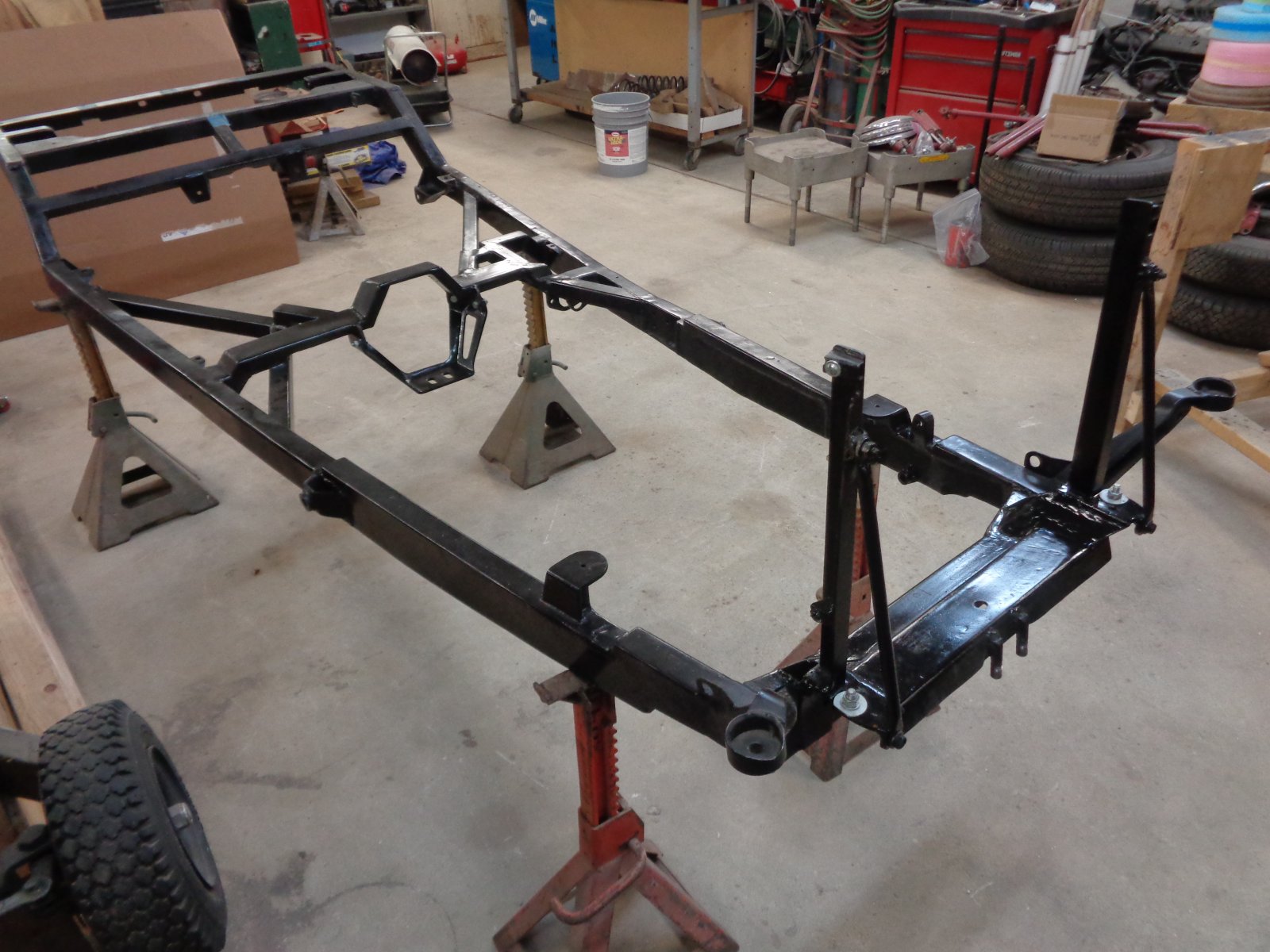

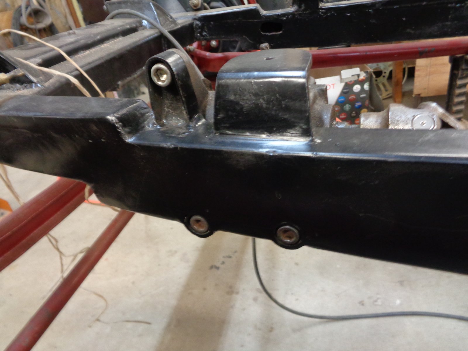

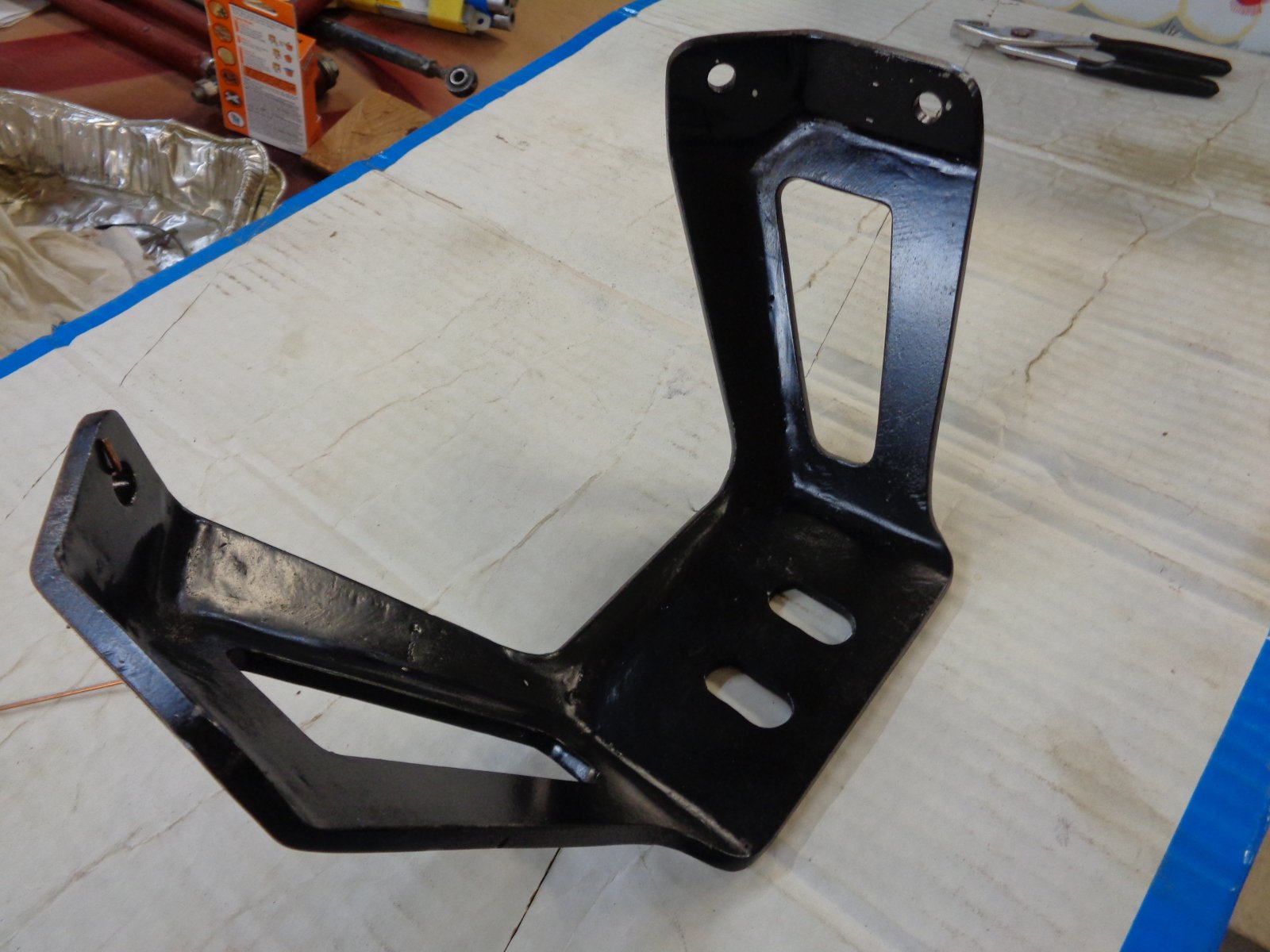

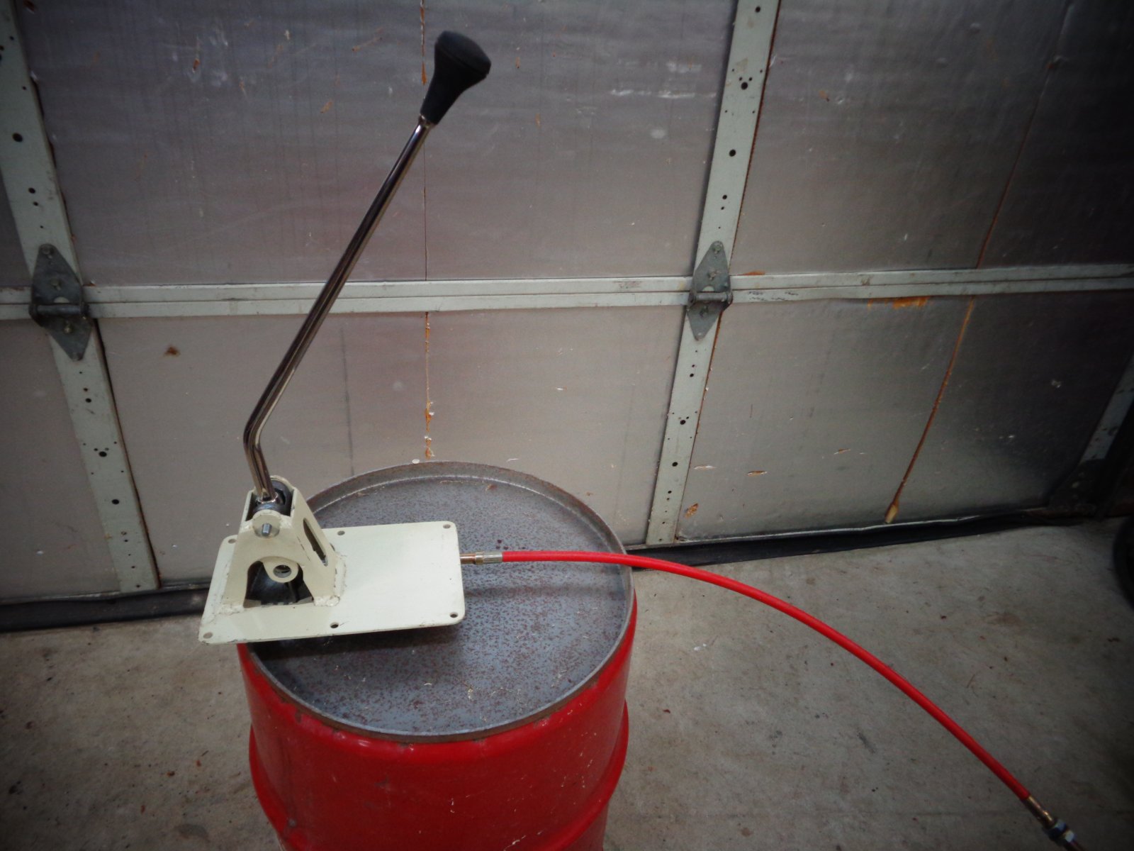

    I've probably posted most of these one time or another. To me the fun is in designing and fabricating stuff.
    Frame
    Rear shock mount and trailing arms for rear.

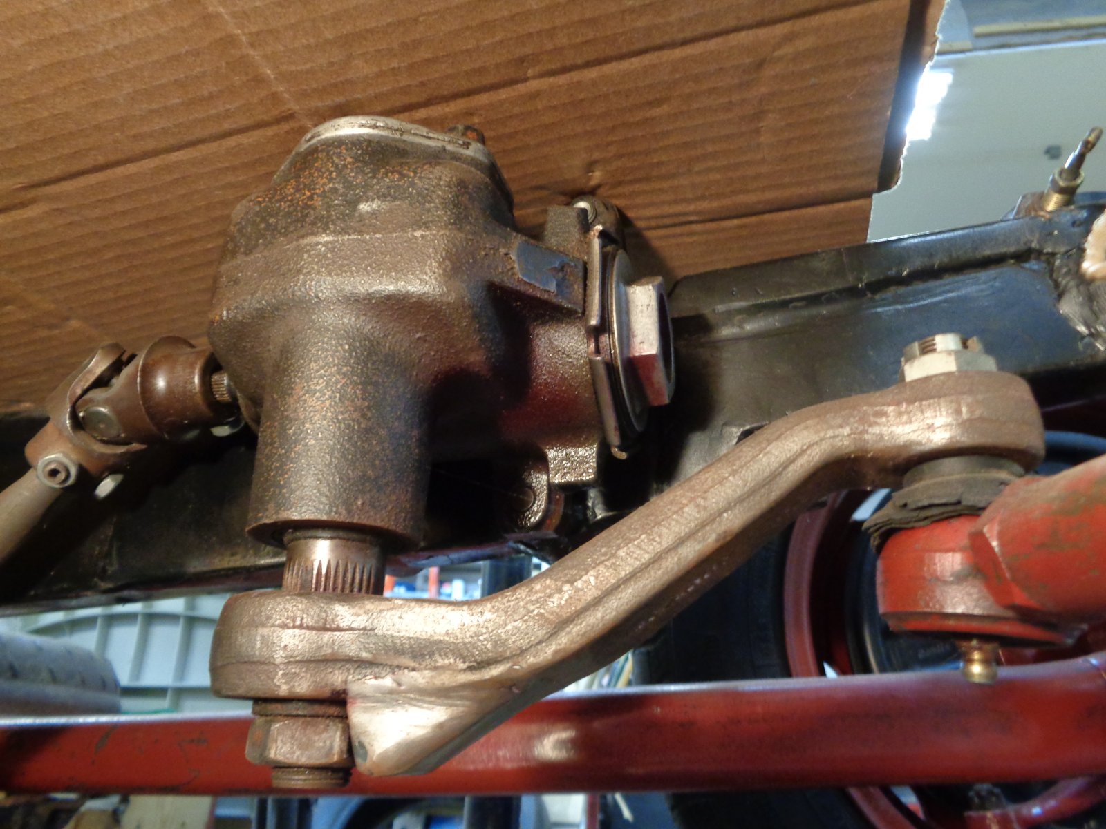

    Steering box mount and motor mount.
    Trans mount

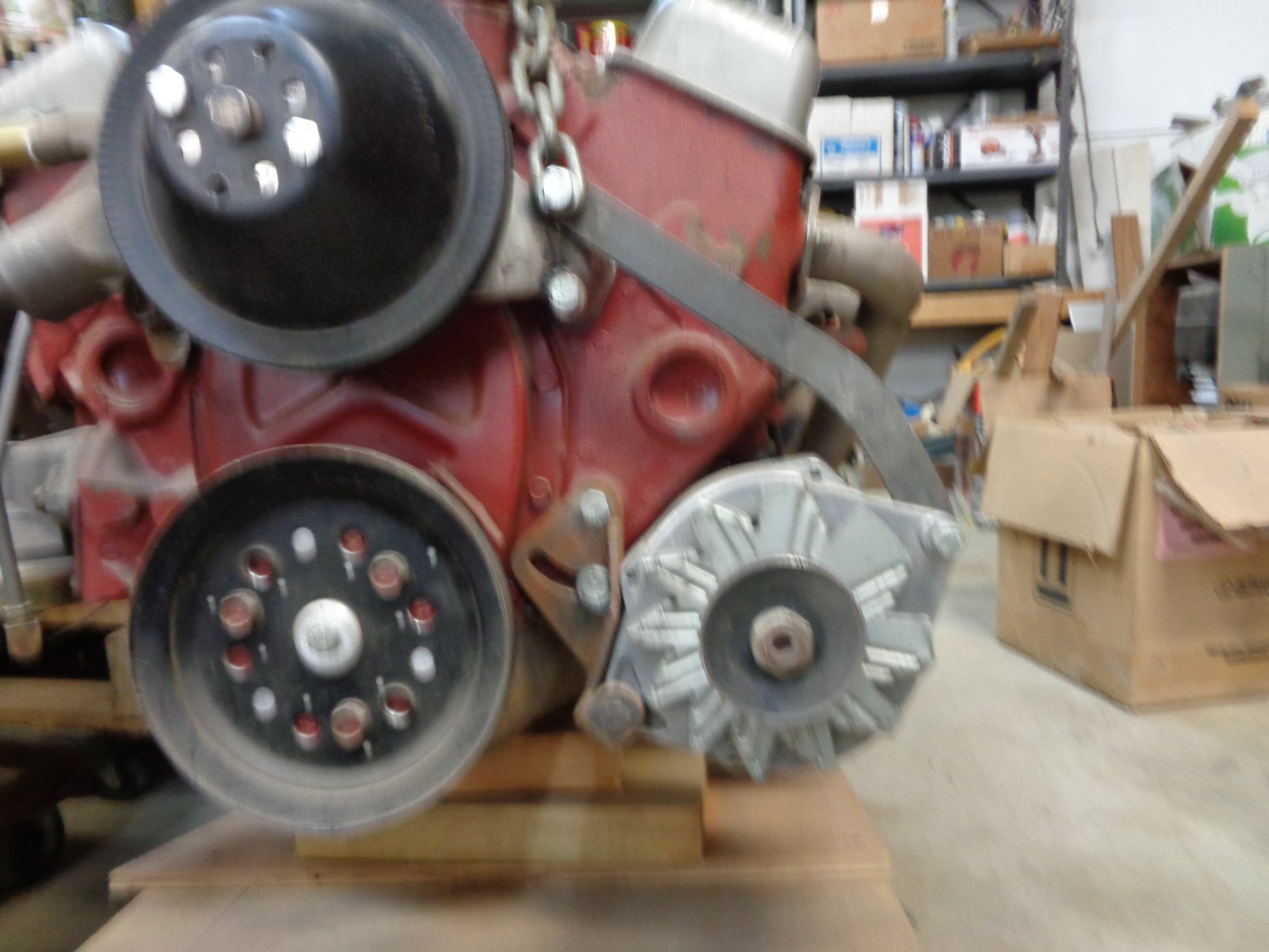

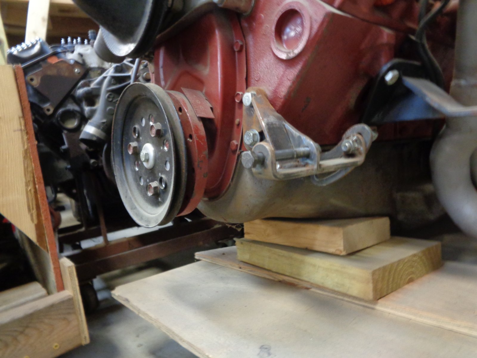

    Alternator mount with motor mount in background of second picture.

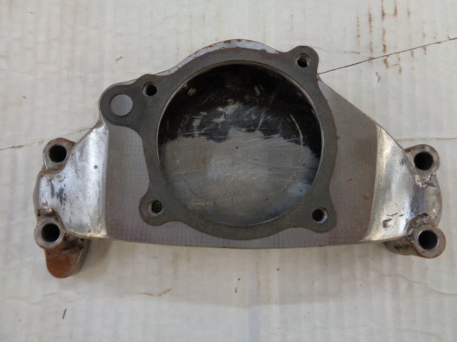

    One inch water pump riser
    Dash and coupster door cap.

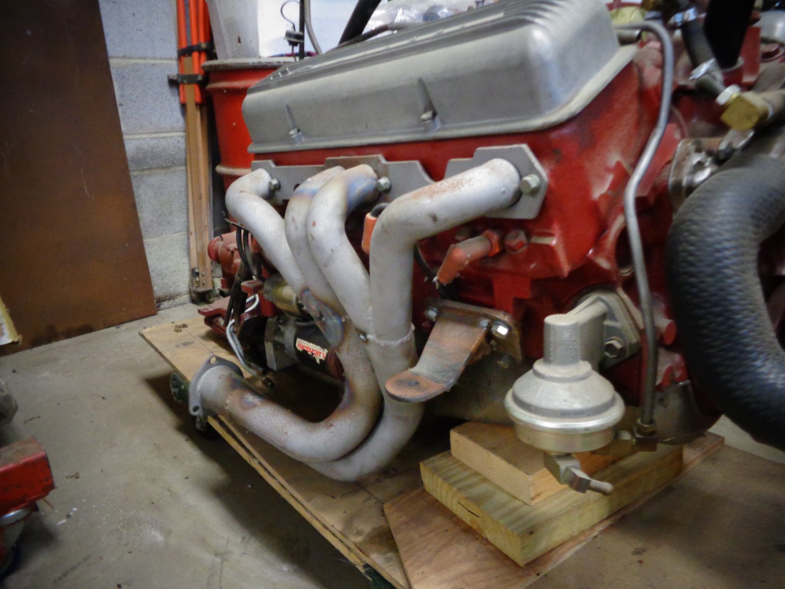

    Tri-Y headers.
    Powerglide shifter
    Neutral safety switch
    Detents

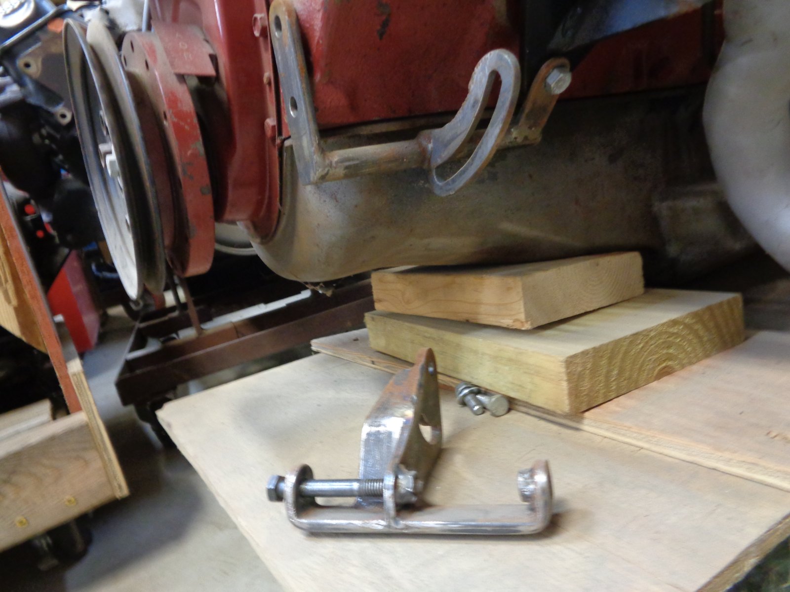

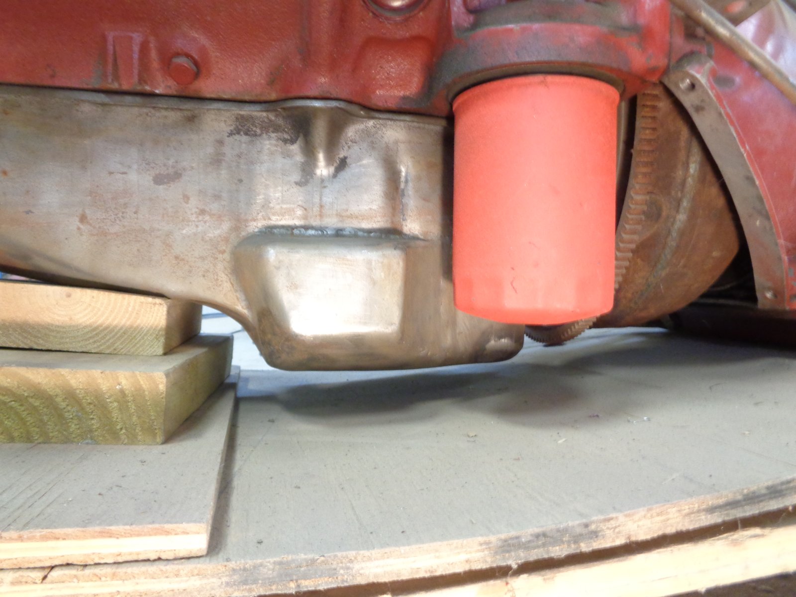

    Shortened oil pan with replacement capacity
    Pitman arm skidplate. (lowest part of the car)
    Decklid.
    hfh, Okie Pete, rod1 and 13 others like this.

    @X-cpe you do an amazing job, all in different areas, frame, brackets, panels, etc.
    Really dig that shifter! Love how you made detents too!

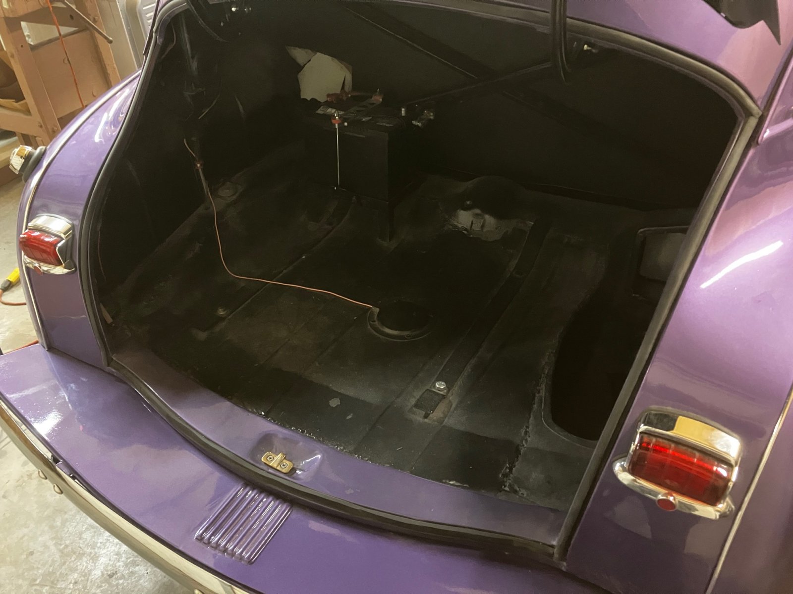

    Interior panels for '40 Plymouth.

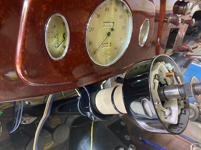

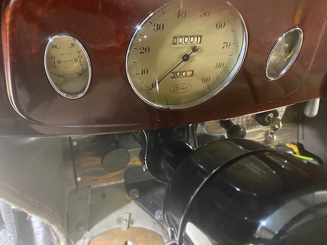

    In its former life a hunk of 14" pipe, met up with a shaft collar and became a column drop for my 34. clmndrp4.JPG clmndrp2.JPG clmndrp3.JPG clmndrp1.JPG drop2.jpg drop4.jpg

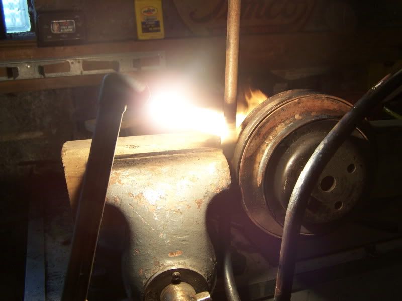

    I turned a $5 dollar swap meet tri-bar coupler for something into a filler neck and gas cap.
    Gl*** domed clock lense, the center of a wheel center cap (interchangeable) and formed the fill neck over a trailer hitch ball with a hammer/dolley lip.
    20230410_172913.jpg 20230413_165611.jpg 20230414_174801.jpg 20230415_175055.jpg 20230417_144734.jpg 20230413_163633.jpg

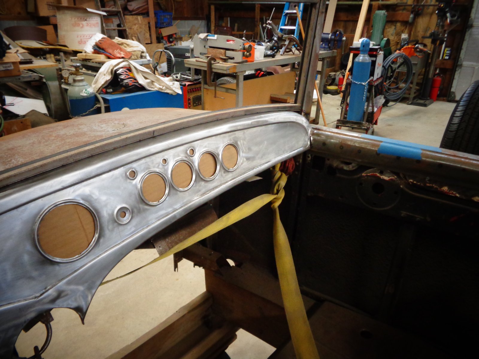

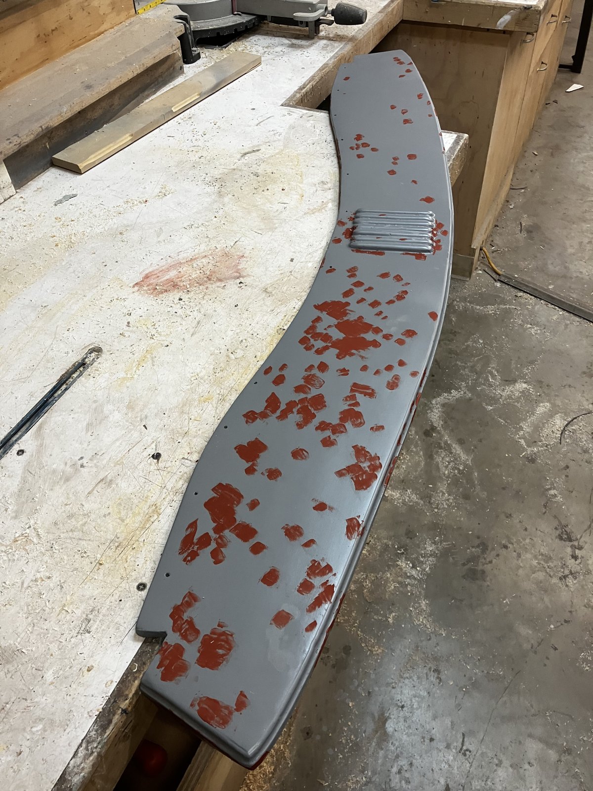

    For my T coupe. I took two closed car T dashes, cut the bottoms from both . flipped one to make a bottom and sectioned it. Then married them together.
    Yesterday I epoxied it

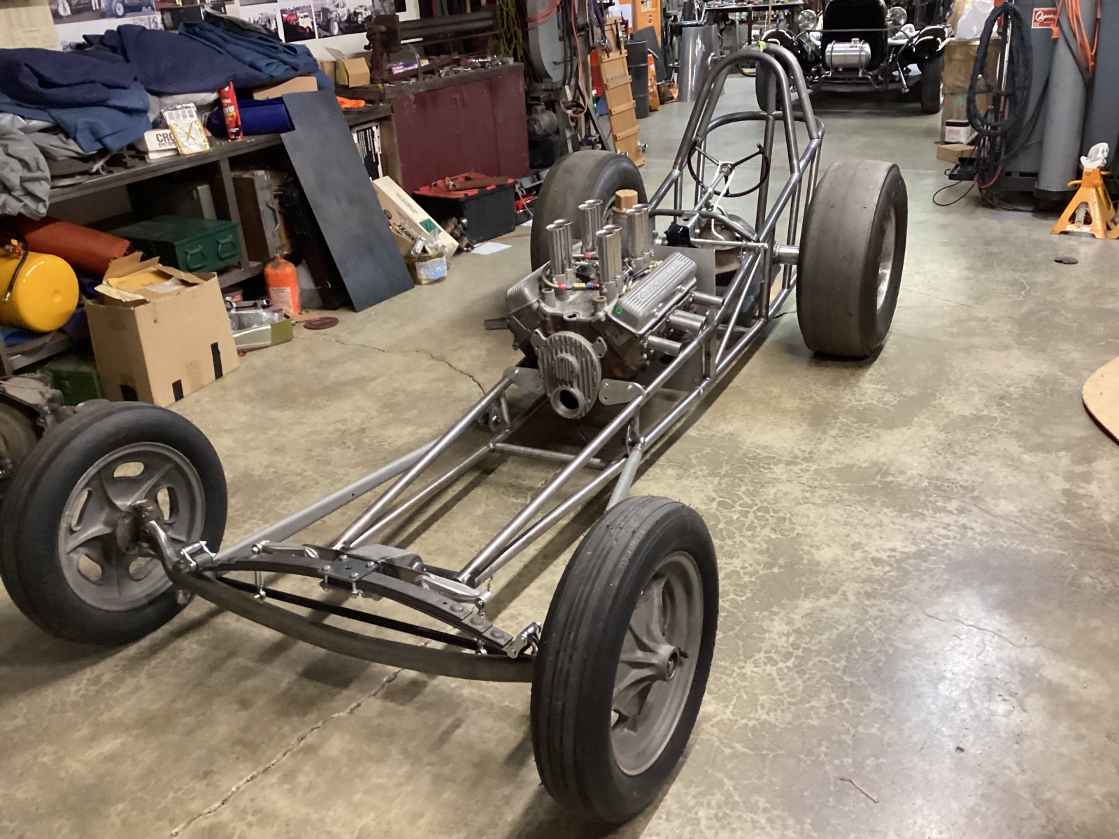

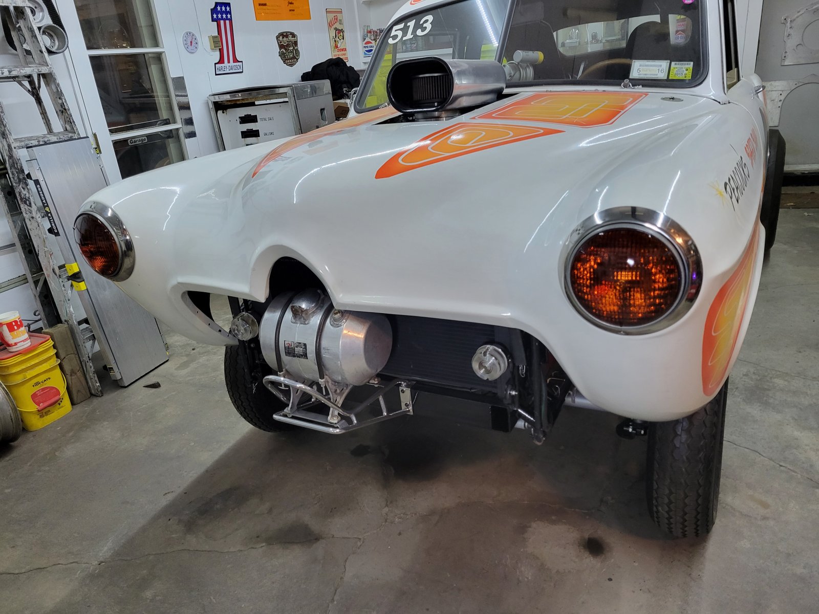

    My 29 RPU will be running Hilborn Injection, and mounting a Moon Tank on a Model A, can be difficult when retaining the stock front Valance. This was my solution. IMG_0620.JPG IMG_9021.JPG IMG_9024.JPG IMG_9025.JPG IMG_9029.JPG IMG_9032.JPG IMG_9035.JPG

    @lostone, thank you for the generous compliment. I thought shifters were supposed to have detents. It's a good thing I enjoy designing and fabricating things because there is almost nothing available to fit this car like I want it. The car is a channeled '30 Model A coupster on a stock wheelbase with 2 1/2" exhaust tucked up under the car and over the rear axle all the way to the back. The front corner of the cowl 7 1/2" off the ground without using a dropped axle.
    Like you, any post that shows fabrication has my full attention.

    Verry interesting post , nice work all you guys, Nice dash "rockable "

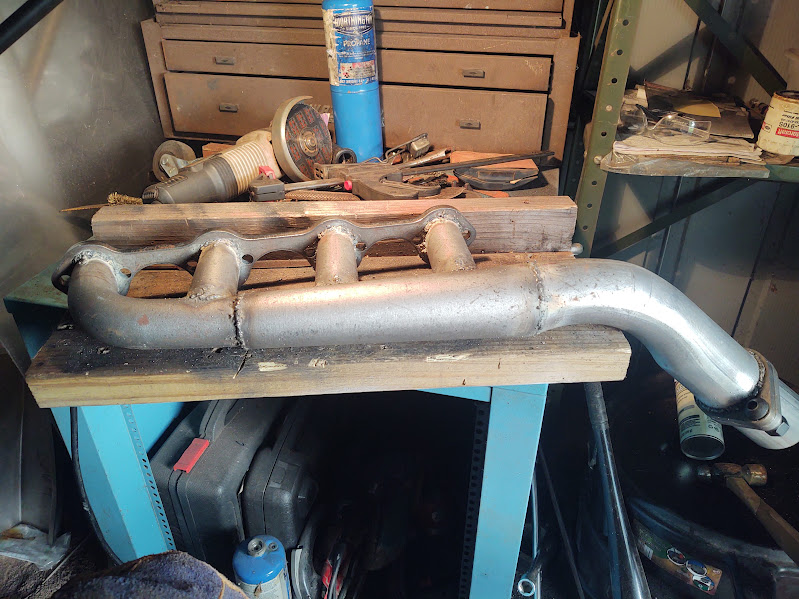

    I couldn't find any exhaust that fit so I ended up making my own. I don't think they turned out half bad for my first time.
    IMG_20210301_172548874.jpg IMG_20210328_164313501.jpg IMG_20210515_141708773_HDR.jpg IMG_20210719_090744340.jpg IMG_20210719_111054073_HDR.jpg

    @swade41 I gotta say that gas filler is just awesome !! It's a monumental accomplishment!! Gas tank bracket, again, very nice work !!
    @Marty Strode awesome as usual !!
    @48stude another awesome idea, I've looked at something similar but on the rear inner side panels on my 31'tudor. Turning one over and mating it to the original one in the car, this would give me a nice large panel and reinforcing the mounting areas would give more structure integrity and strength.
    @Johnny99 nice drop, infact I'm sitting here going thru designs in my head for building one for my 31'tudor. My problem is I used a 38'ford dash and it's taller than stock so I need to build a very very short drop but I want it to pivot too. Got some ideas I'll check out tonight....

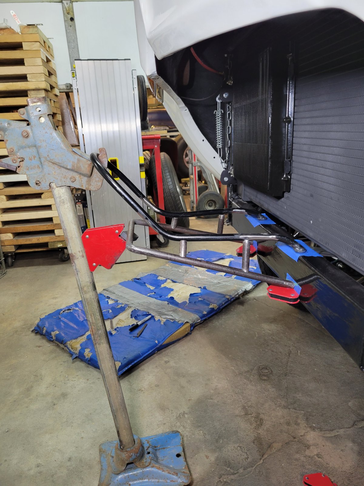

    Lets not forget this thread ! How about some ladder bars ? IMG_4599.JPG IMG_4603.JPG IMG_4605.JPG IMG_4609.JPG IMG_4613.JPG IMG_4614.JPG IMG_4618.JPG IMG_4619.JPG IMG_6883.JPG

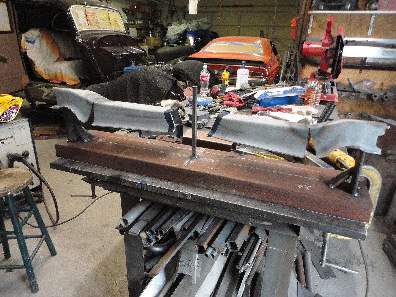

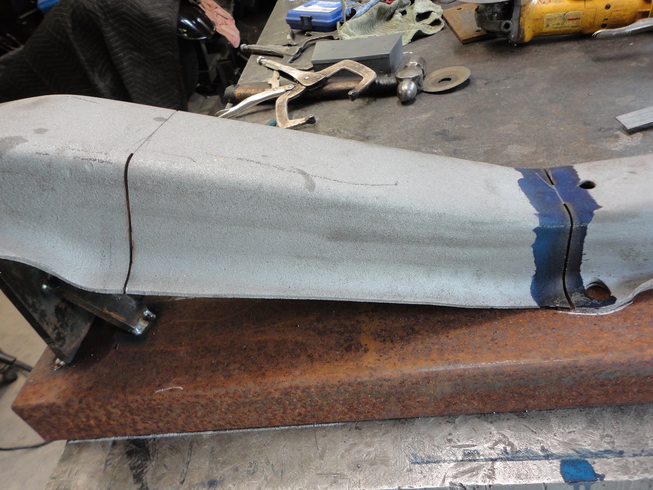

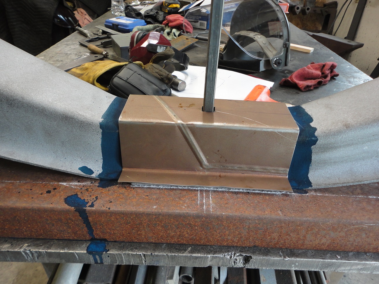

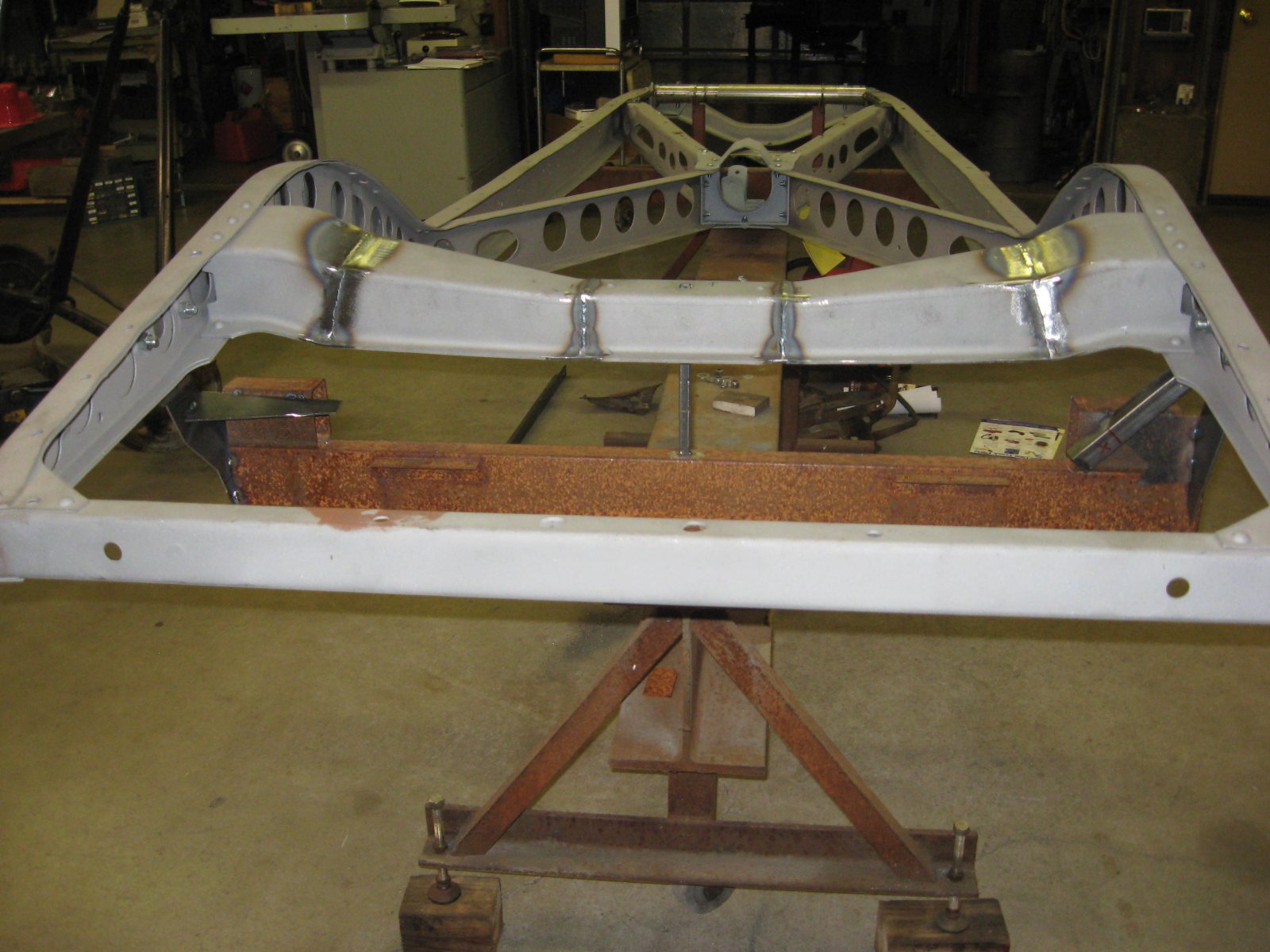

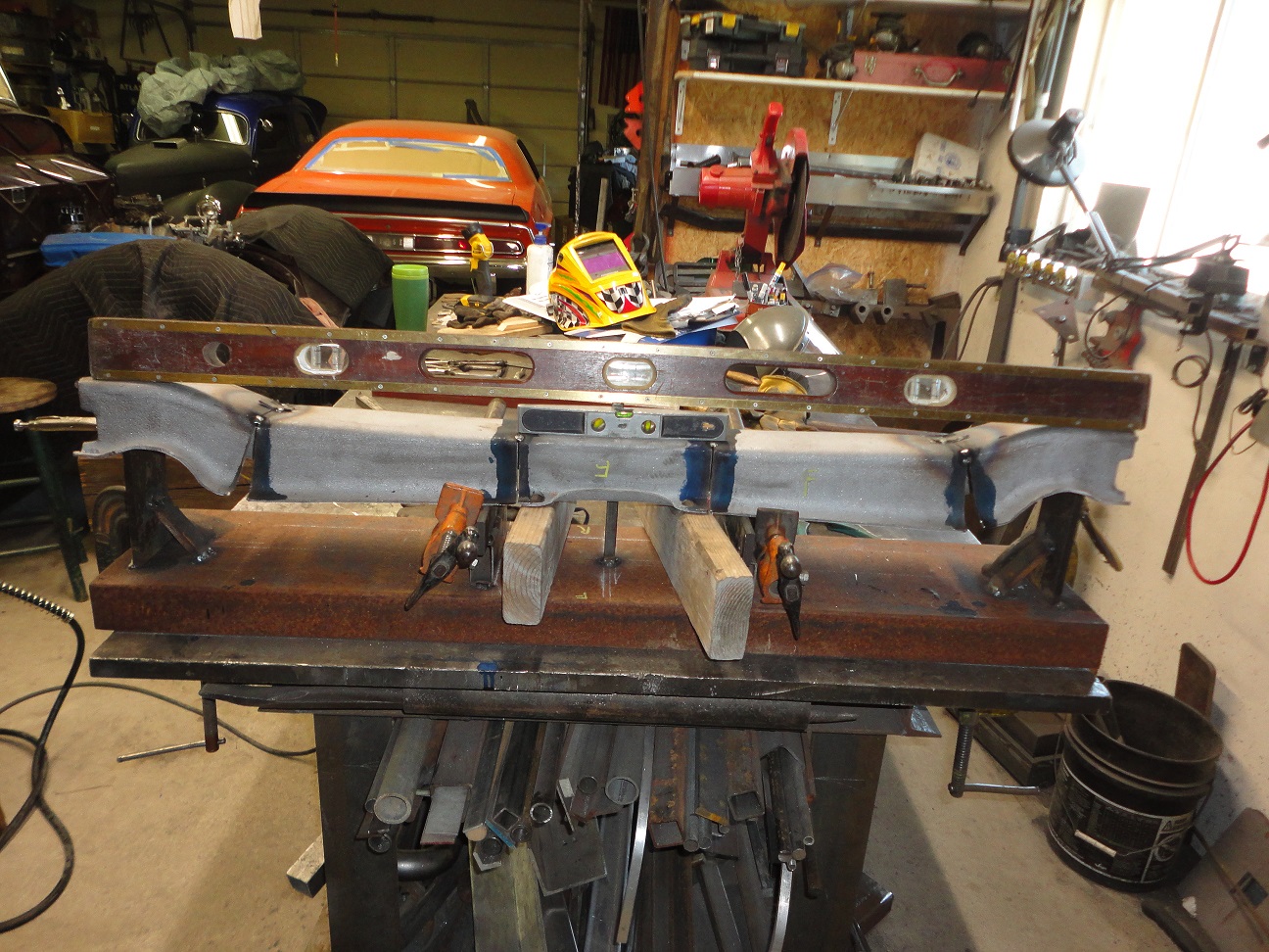

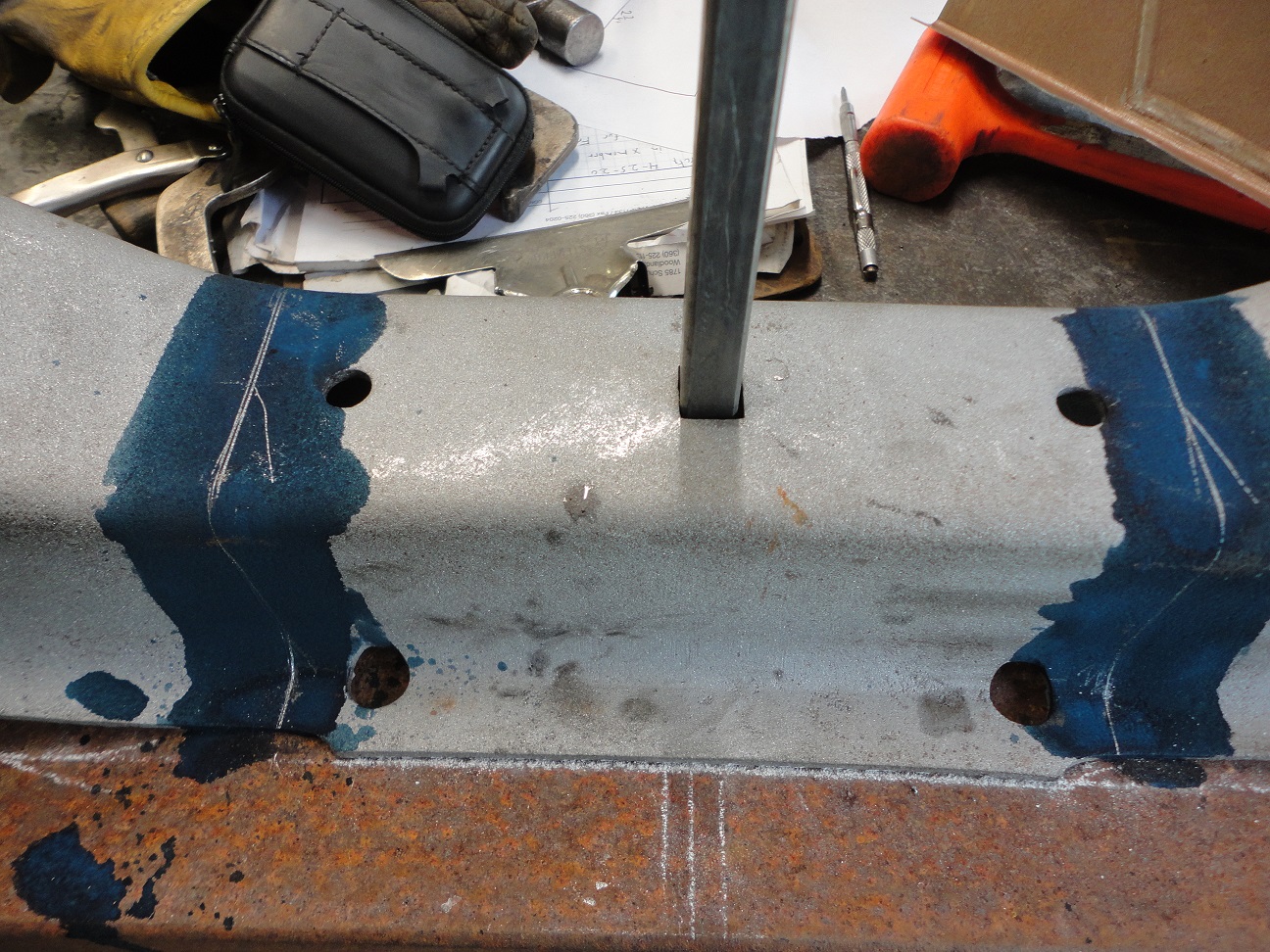

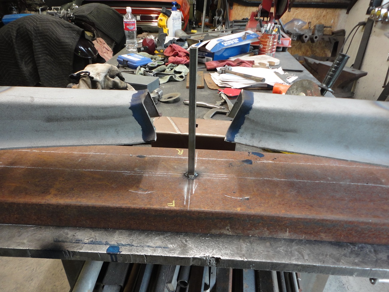

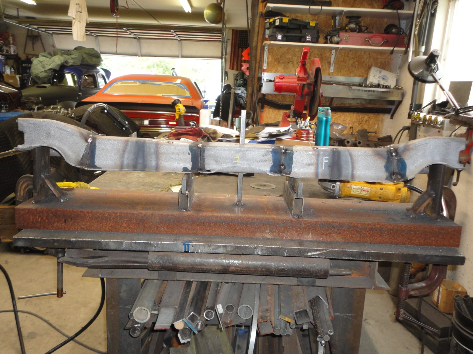

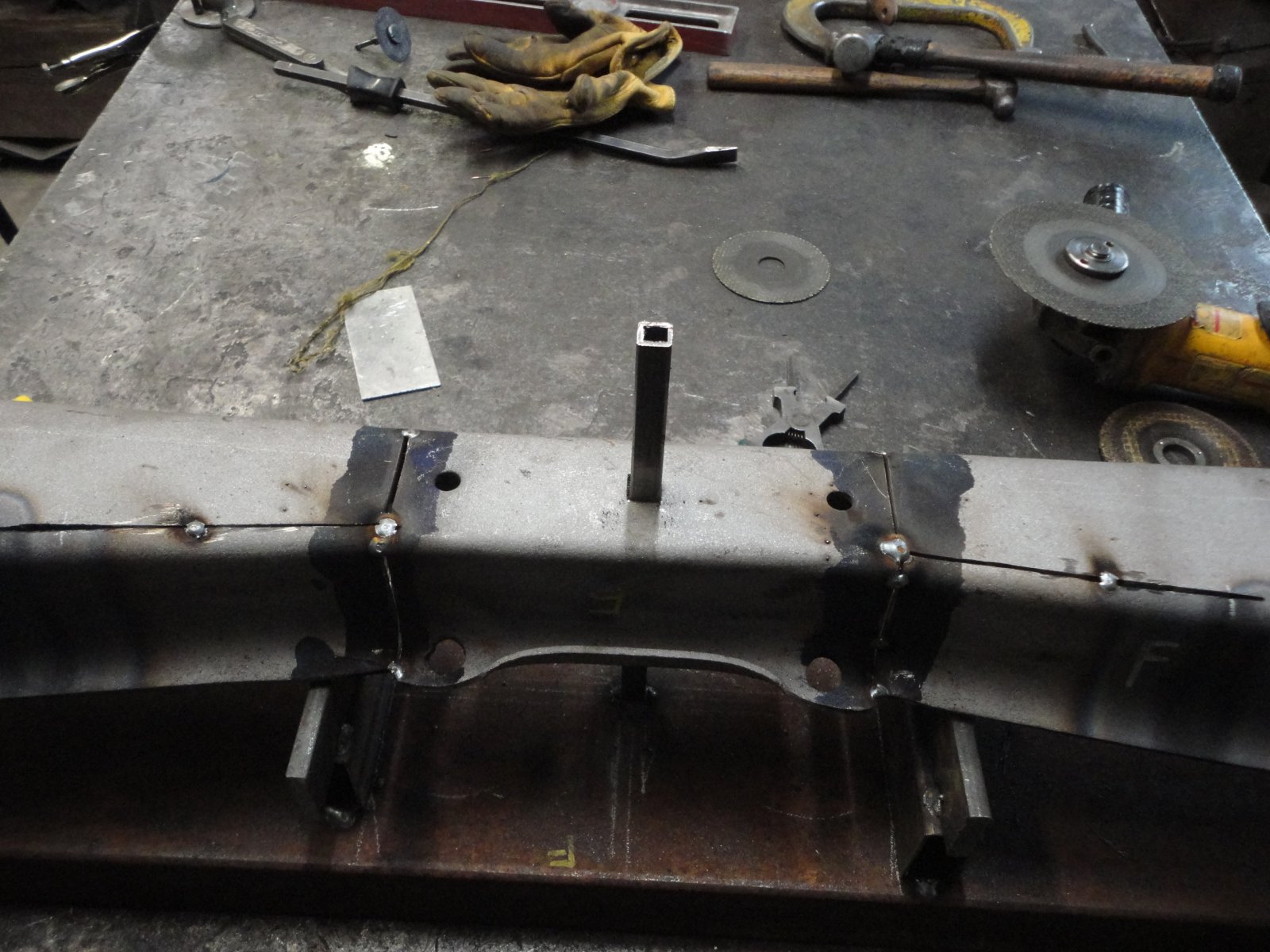

    Hotrod buddy Mike came to me, "Hey you want to flatten the rear crossmember on my 40?" Me, "Uh sure, never done one before but I'll give er a try". Poked around on the HAMB a bit and found Marty flattening a crossmember and plagiarized, kind of. Marty did his in the ch***is, Mike brought me a crossmember and I built a fixture on a heavy channel, clamped that to my fab table and started cutting. Worked out OK.
    cm1.JPG cm2.JPG cm3.JPG cm4.JPG cm5.JPG cm7.JPG cm9.JPG cm10.JPG mike4032b.jpg

    Great job John, you flattened it more than mine !
