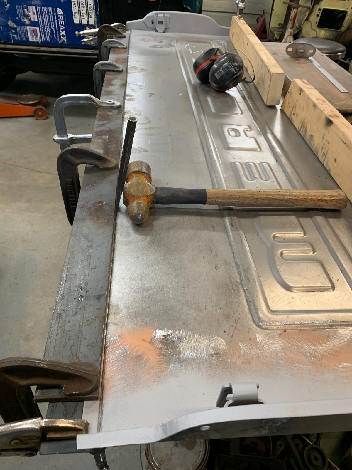

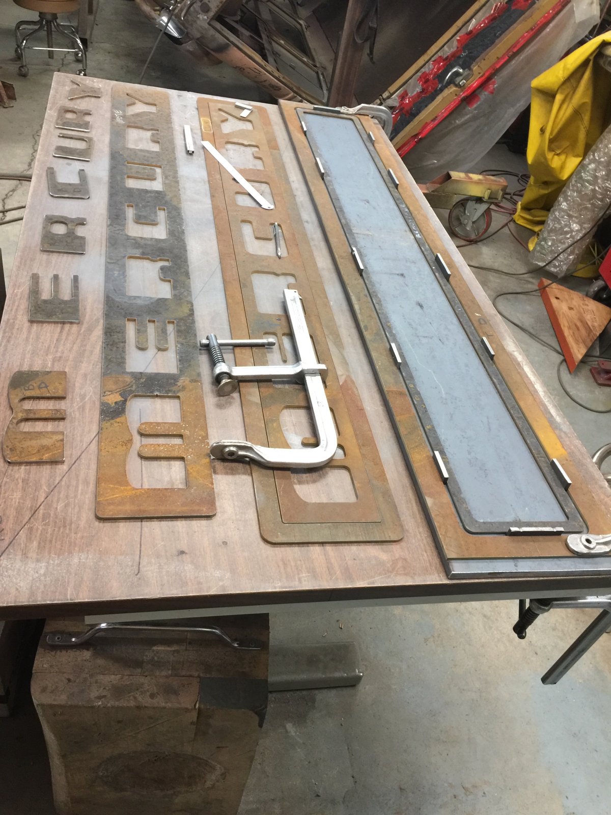

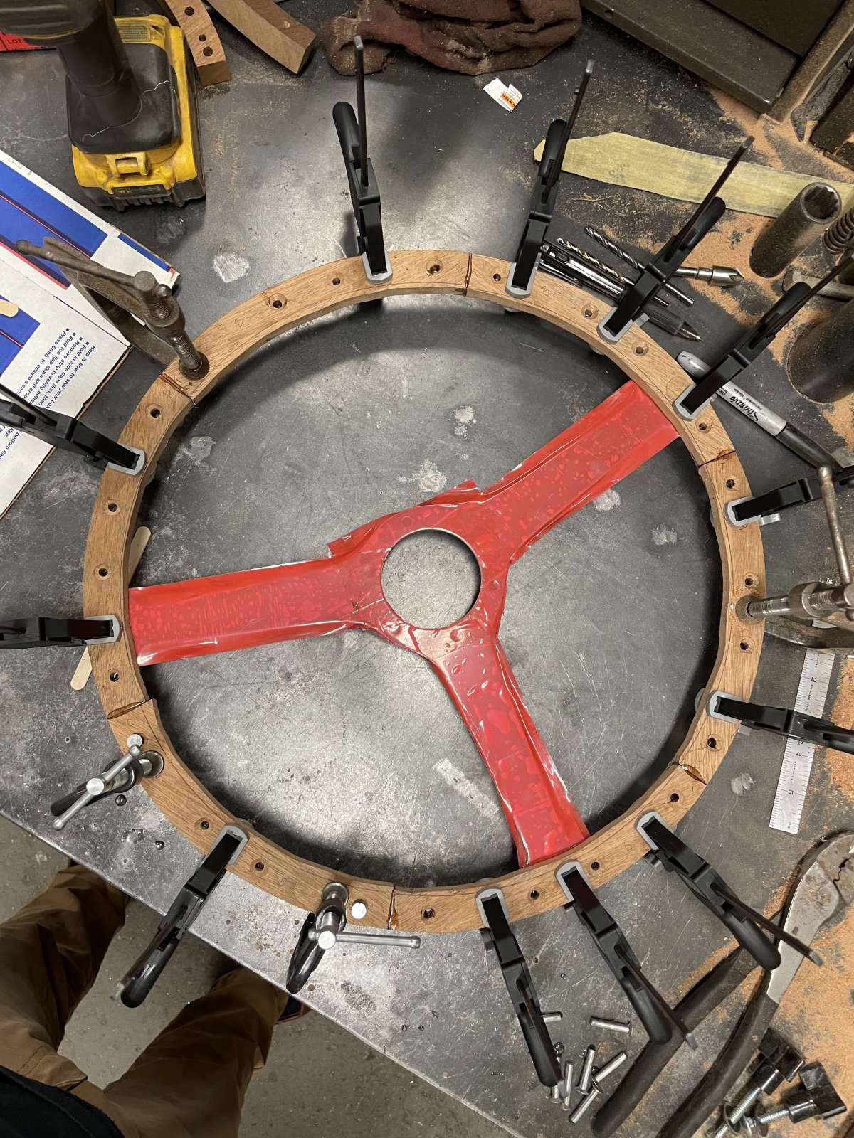

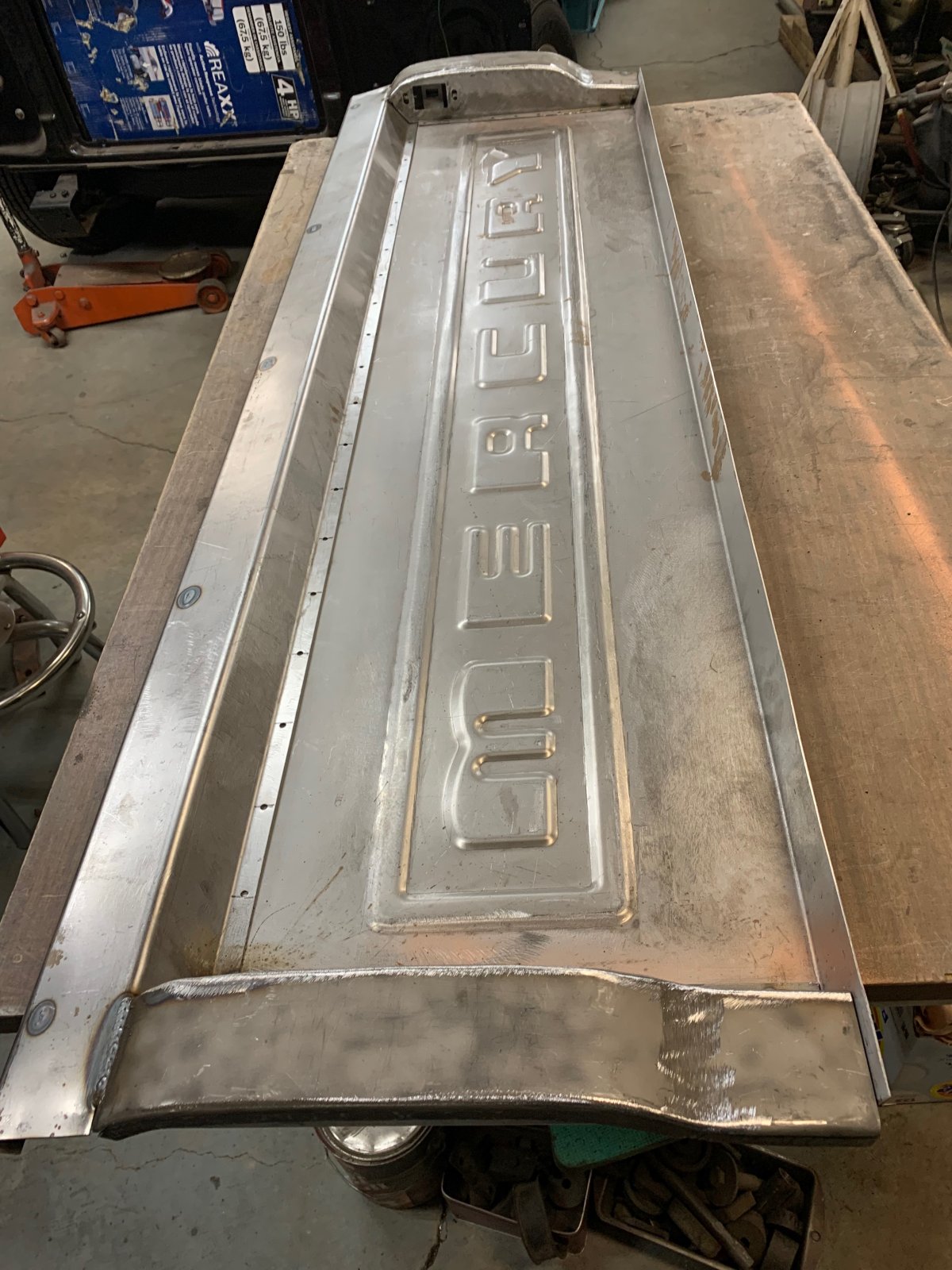

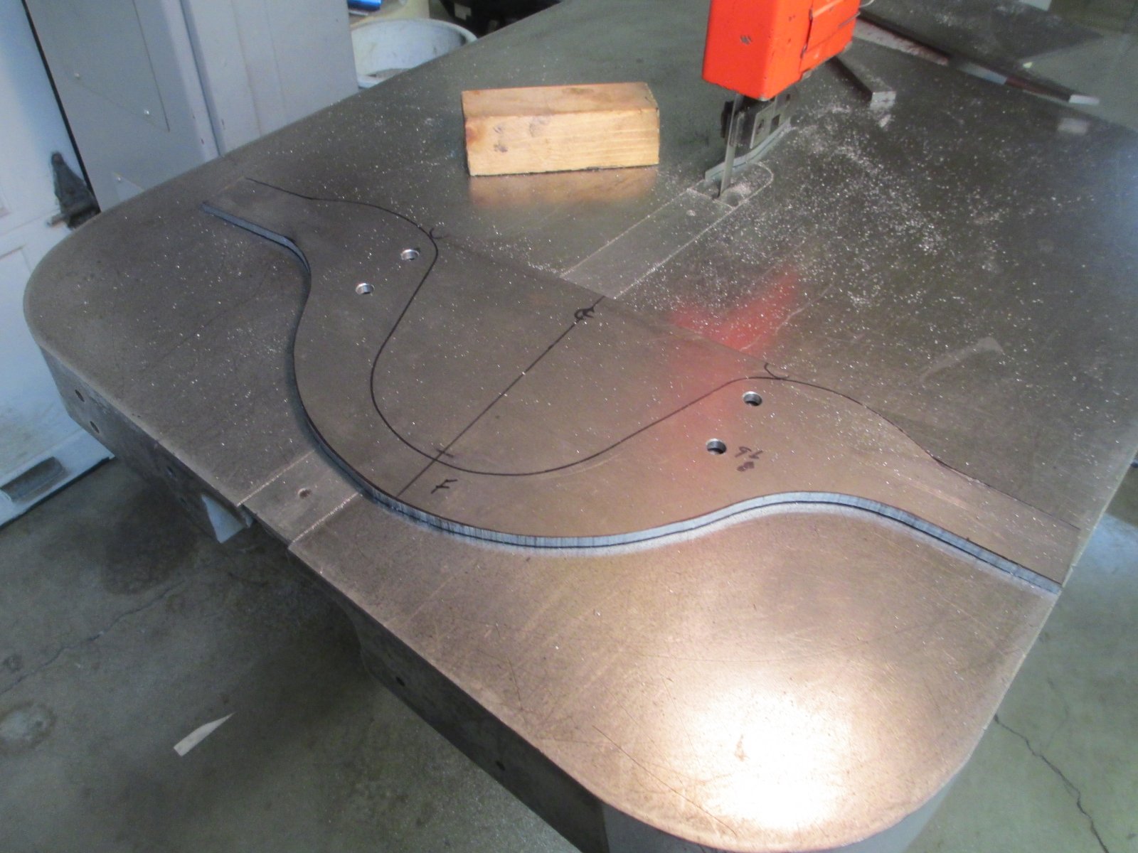

    Started by doing a digital photo of an old original tailgate, sizing it exactly like the original, transferring to a file that was cut by a machine shop with water jet or laser, can't remember.
    Drilled and tapped 156 1/4 -20 holes to hold all the pieces in place. Spacing was done with 1/4 inch steel and sheet metal spacers to keep it all even.

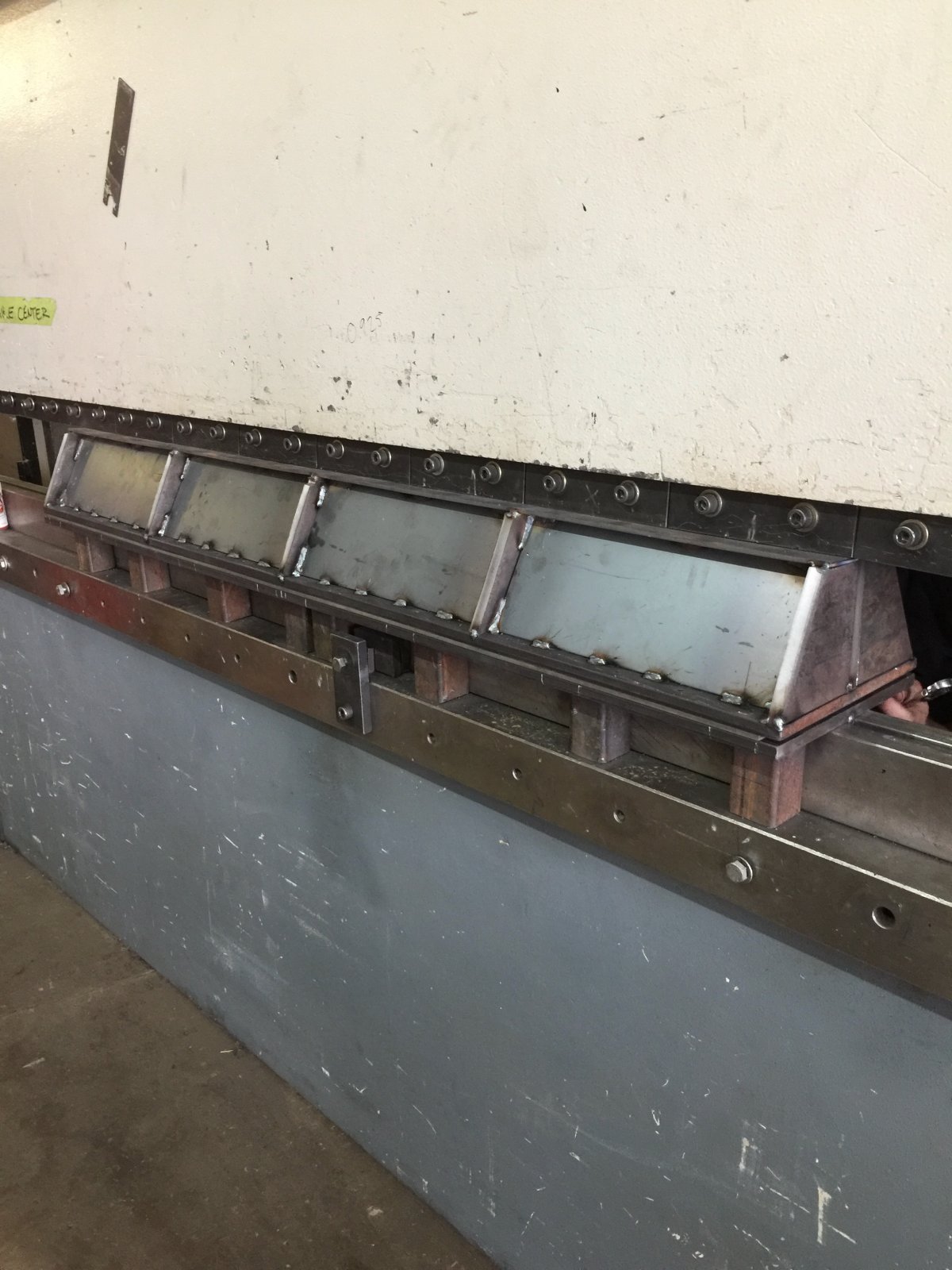

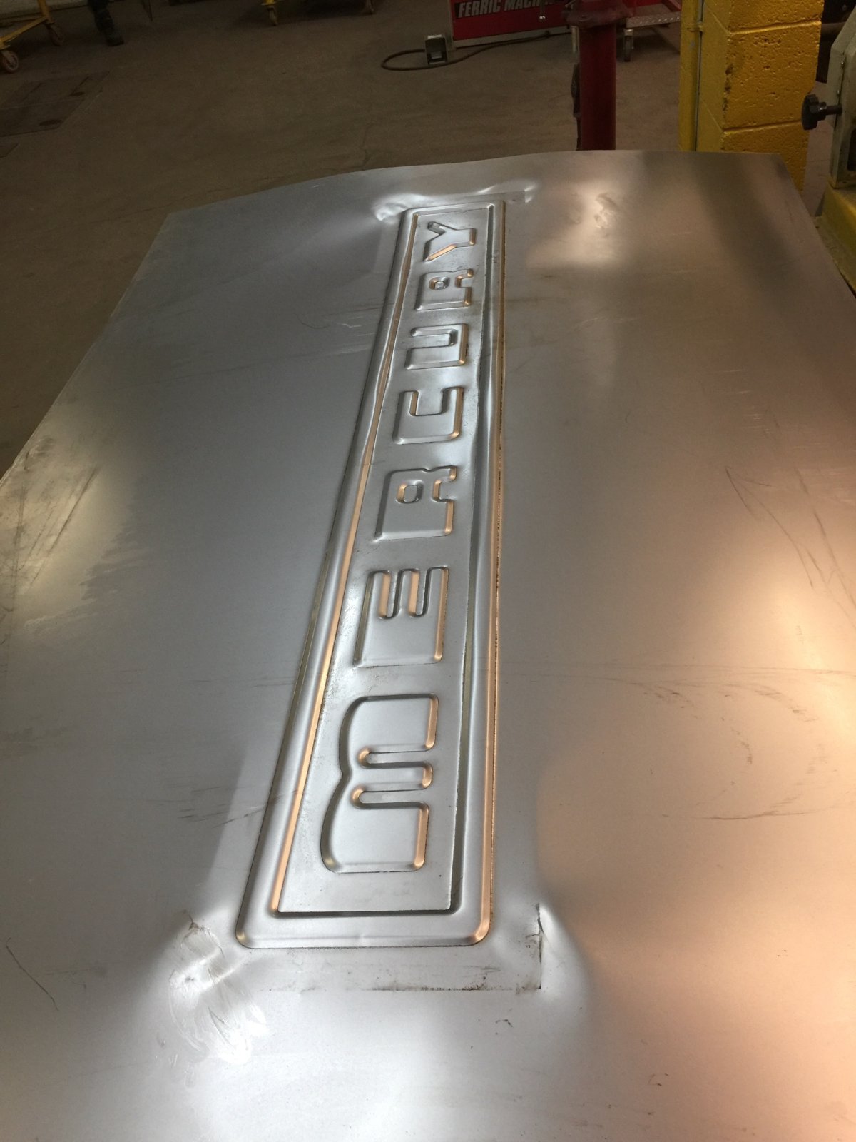

    Like all amateur presswork, the almost new brake didn't have enough tonnage to press it without any distortion. The metal shop owner was astonished that his brake maxed out the controls. He said it had never done that before.
    16 gauge cold rolled.

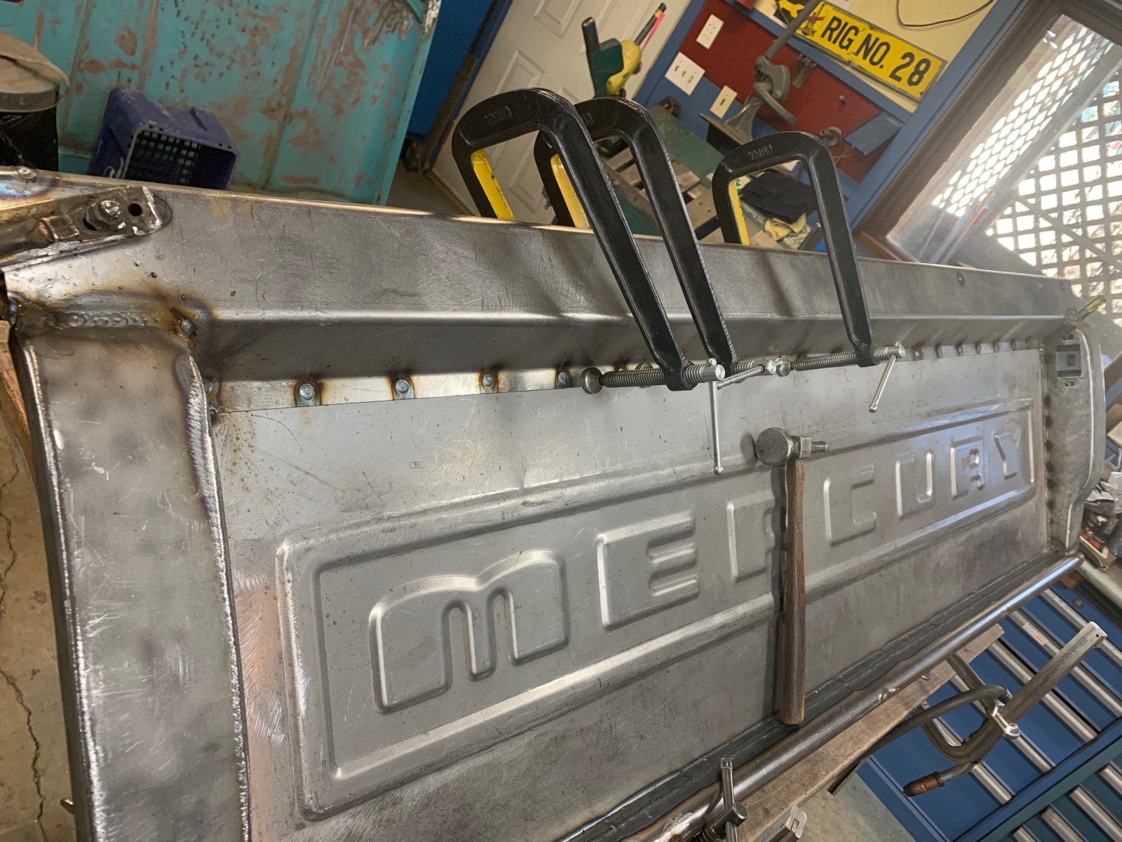

    Removing the distortion in the corners. I had to go over each letter one by one with hammers and chisels to crisp up the detail, as the press couldn't get the job done.
    Flange on left side of pic was hand hammered, as my brake won't make a flange that thin.
    Clamped to the table always to keep it flat, pretty much every operation.
    Some ***embly done.
    Here you can see how I wrapped the metal around the bottom hinge pipe. Clamp it tight, then beat the hell out of the flange with the brick chisel and mallet, then clamp a little tighter, and do it again, and again, and again till it is wrapped totally around the pipe to where I can do plug welds in the holes.
    The ends of the pipe have bronze bushings in them for the hinges to ride on. I put the pipe in my lathe to turn down the inside bore to fit the bronze bushings. Didn't take any pics of that.
    This pic you can see a bit better how the metal was wrapped around the hinge pipe. I had a sheet metal shop bend the bottom sheet metal to somewhat of an ohm symbol. Once it was bent to a half round shape, there was enough to spot weld one side, then clamp it to begin bending it around the pipe. Hpe that makes sense.
    There is a detailed thread on how I did all this on Canadian Rodder website.
    This is one of the only shots I took where you can actually see the detail on the letters.
    I had to make a jig to make the end caps for the tailgate.
    I ended up making a steel cap for this jig, as this wooden one did not hold up to repeated pounding.
    I may offer these end caps if there is any interest, as I have a good jig to make them, and its about the only piece that doesn't take so ****** much time to make that someone would possibly consider purchasing them.
    That's about all. As I previously stated, It seemed like a good idea at the time. I have a ton of time into this project.
    And I do have a couple extra panels left over, if there is any interest, but they aren't for the faint of heart.
    So yeah, there are still a bunch of us doing fabrication work.

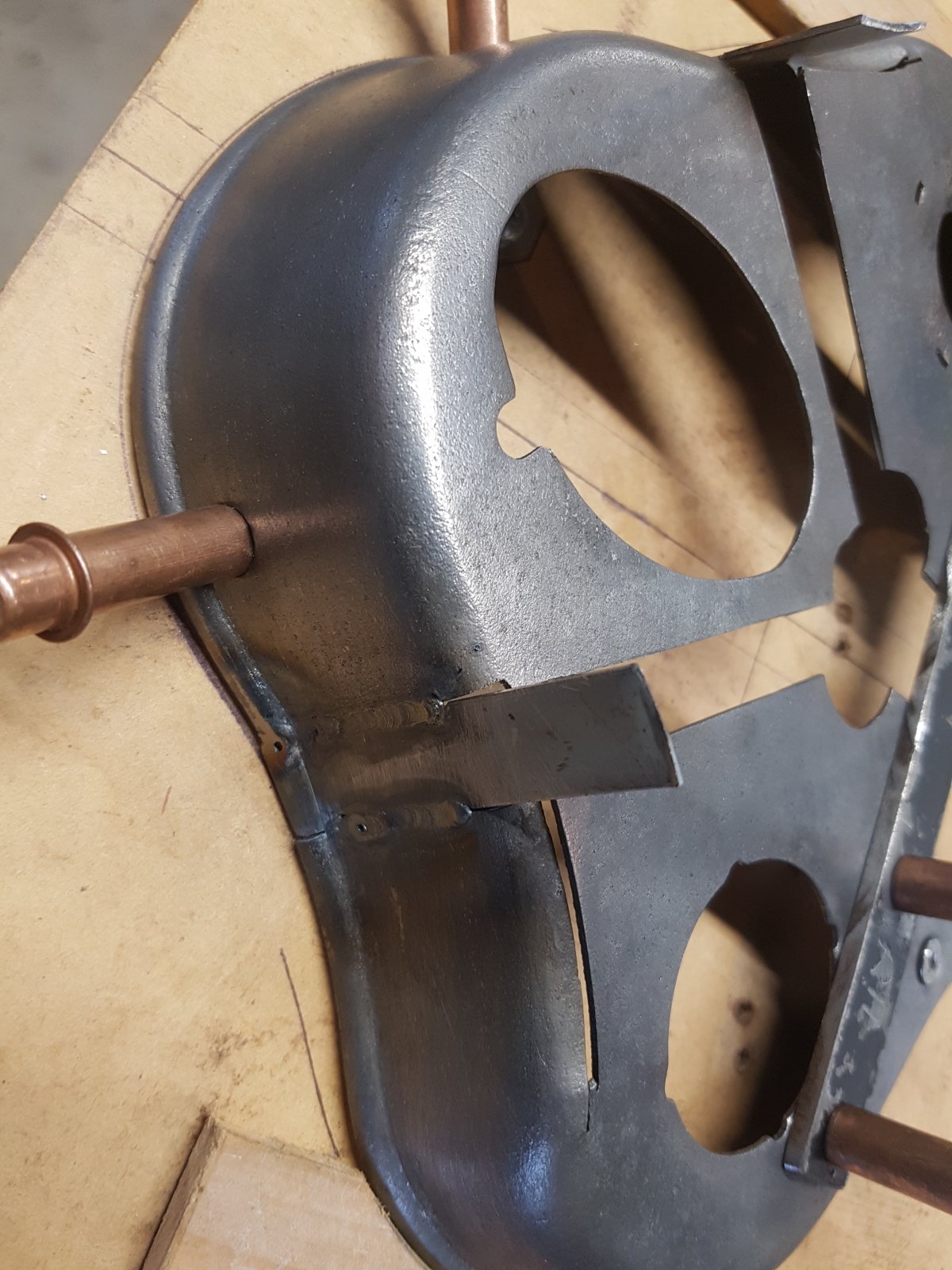

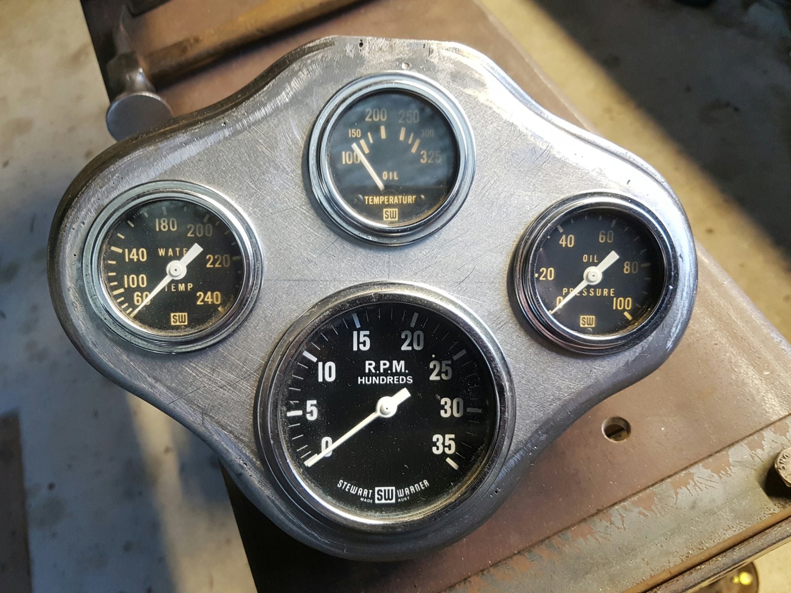

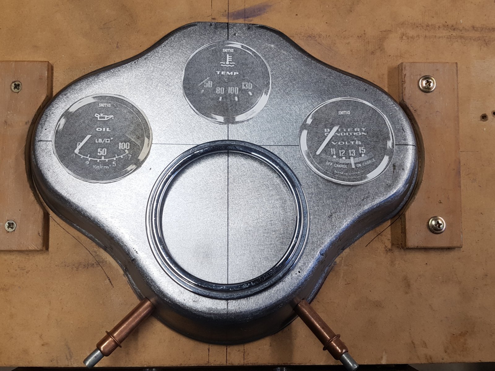

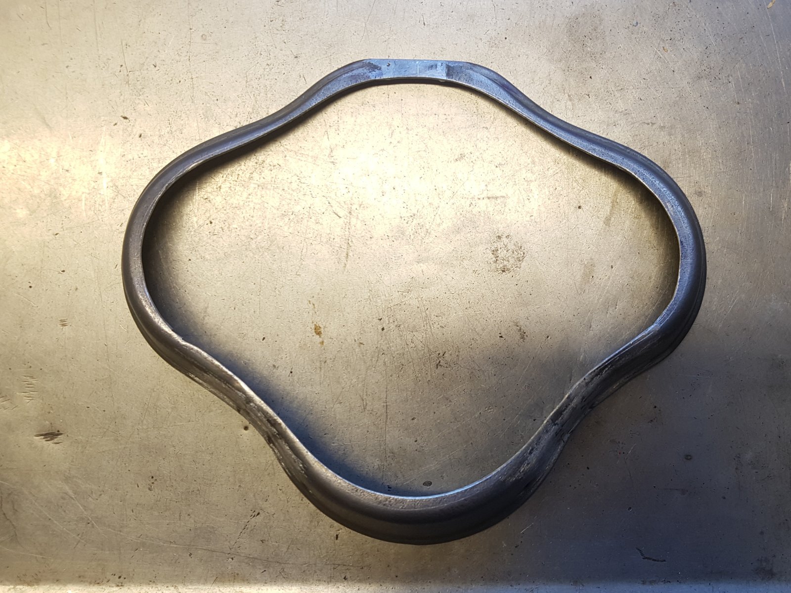

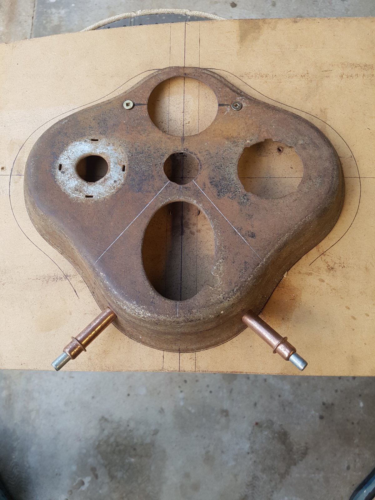

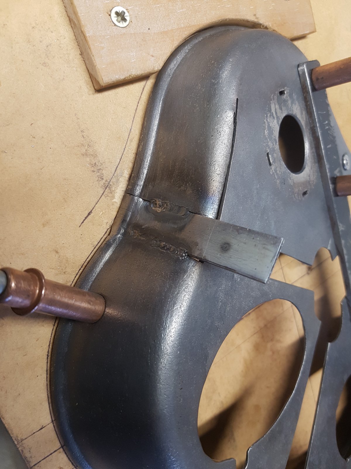

    This is a Model A gauge cluster that I stretched to make some SW gauges fit nicer.
    I ended up selling the car I was going to put it on, so didn't finish it, but I've got a flat-packed 29 RPU in the ba*****t it may end up on that.

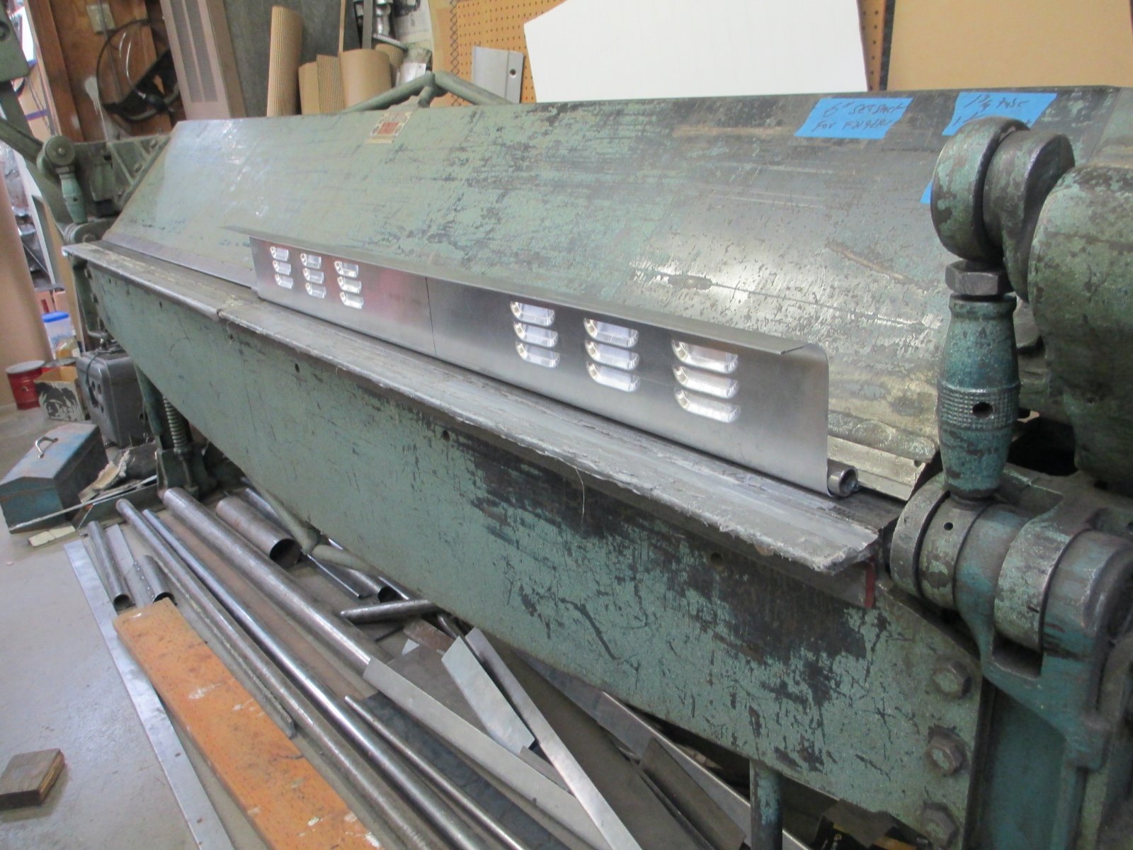

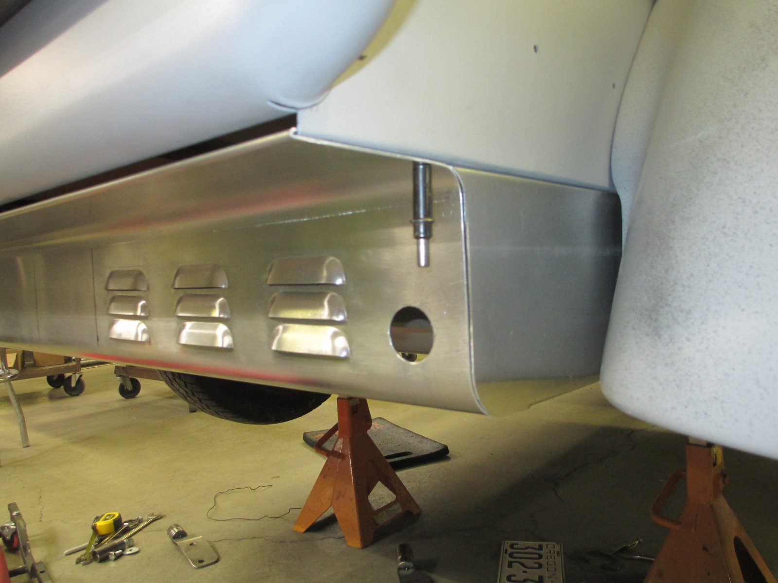

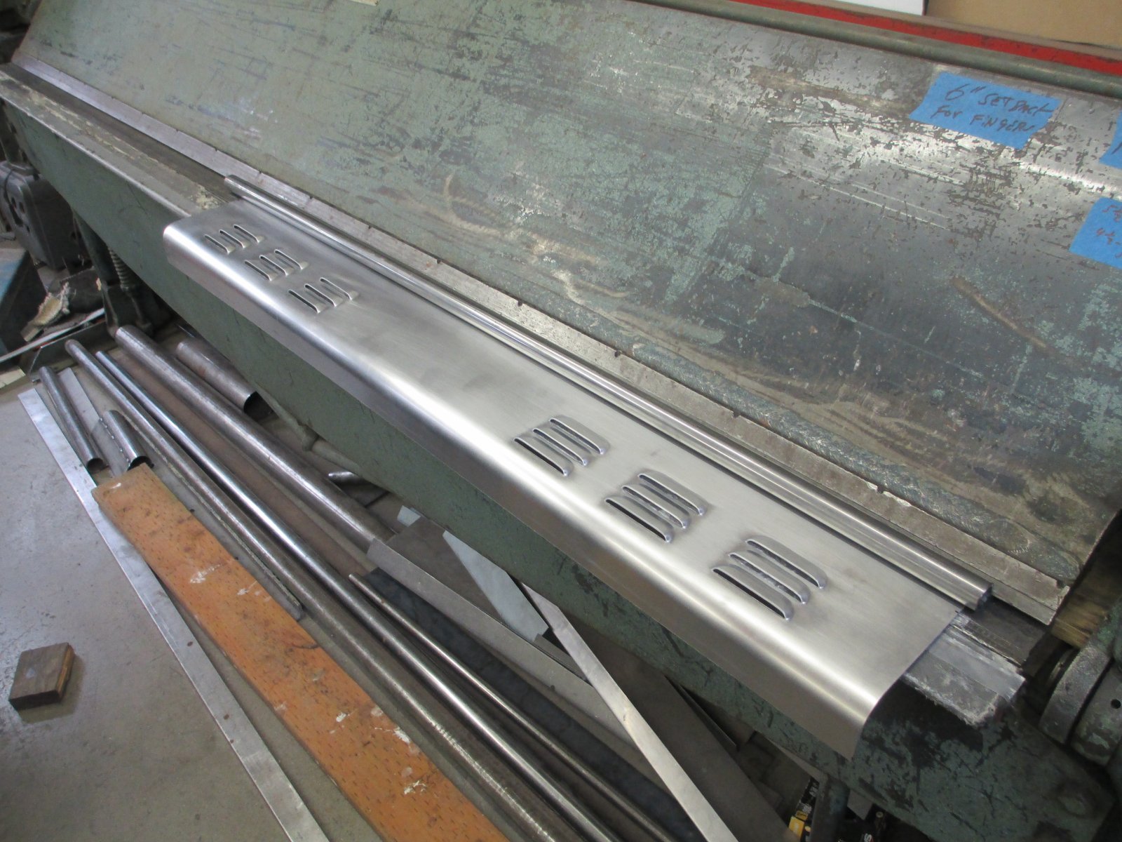

    Recently made a roll bar for my 34, plan is to do a full cage when ch***is work done. Last year I made a trunk lid and punched it full of louvers on my home-made press. Glen 20240617_123145[1].jpg 20240618_165311[1].jpg 20230828_171216.jpg 20230911_165630.jpg 20230912_145106.jpg 20231002_144401.jpg

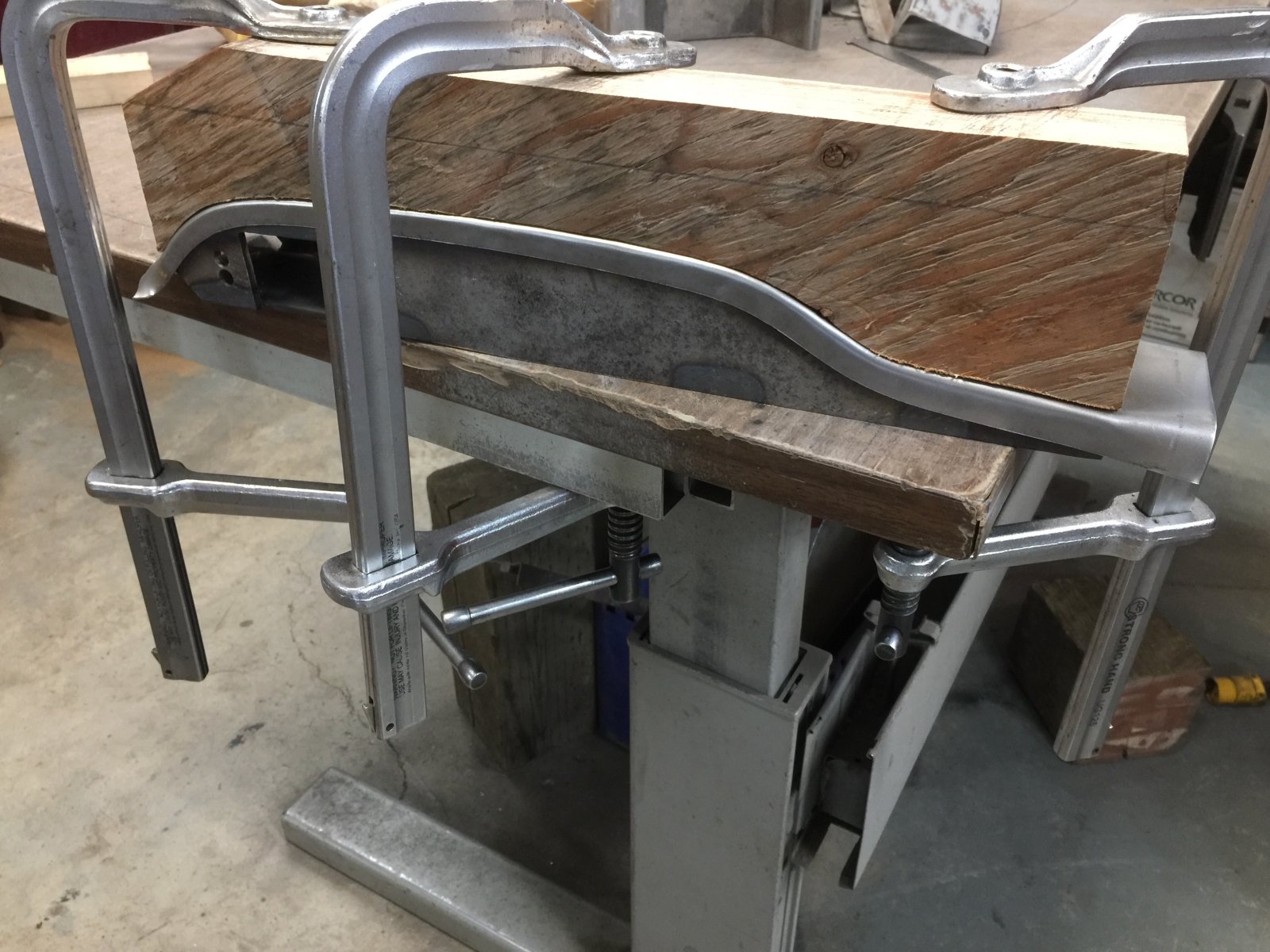

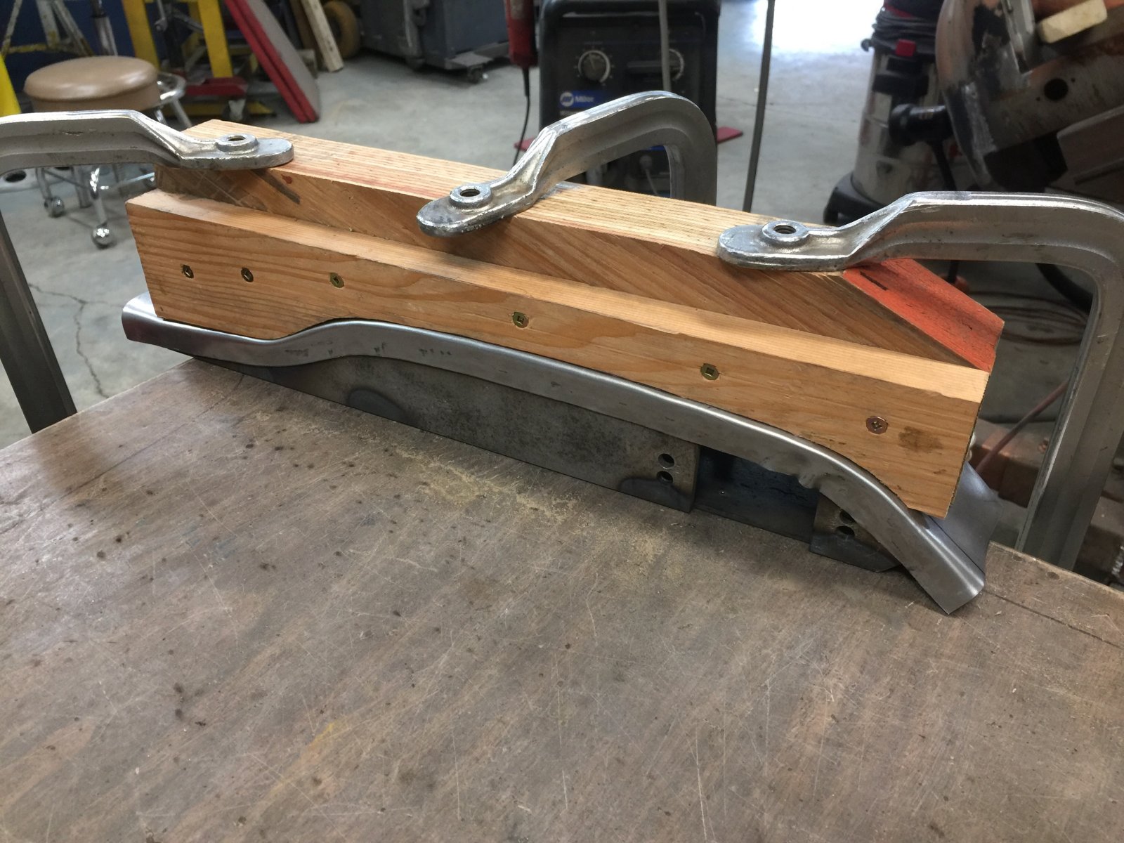

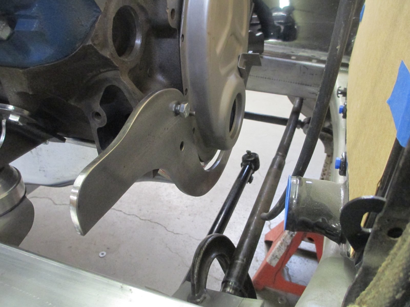

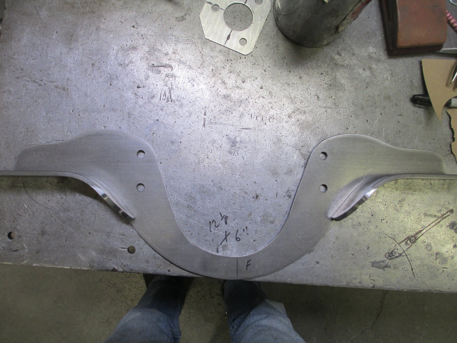

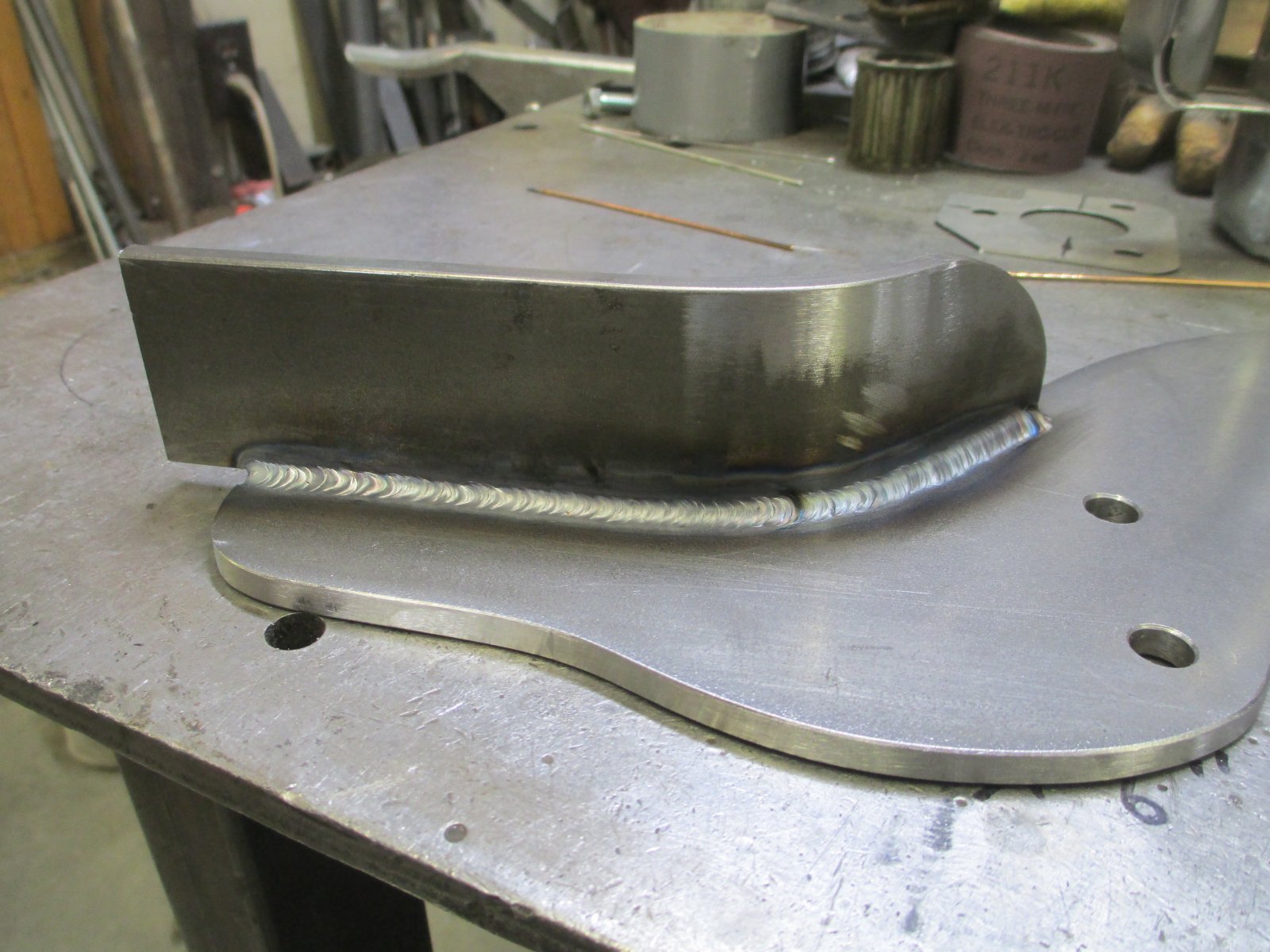

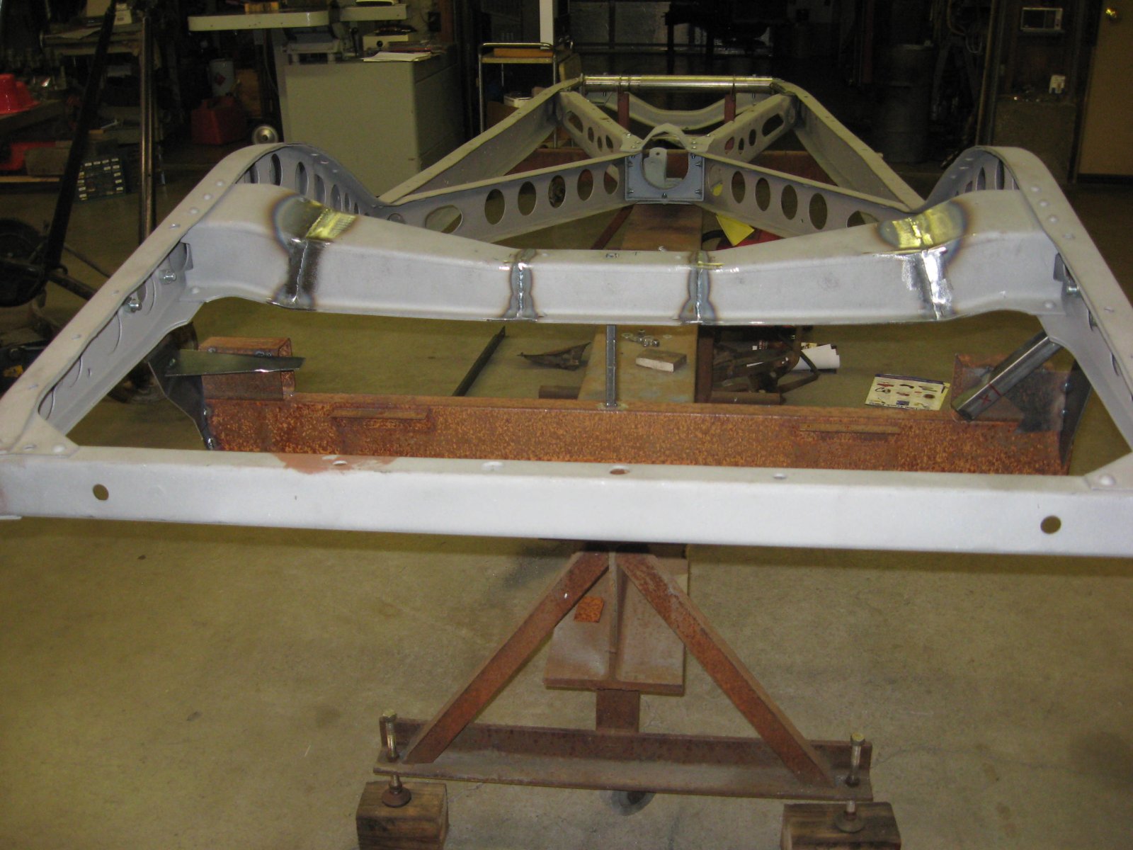

    I needed a Hurst style front engine mount for my '29, with a slightly different height requirement. So I built one, along with the frame brackets. IMG_8588.JPG IMG_8590.JPG IMG_8595.JPG IMG_8598.JPG IMG_8605.JPG IMG_8607.JPG IMG_8609.JPG IMG_8612.JPG IMG_8615.JPG IMG_8621.JPG

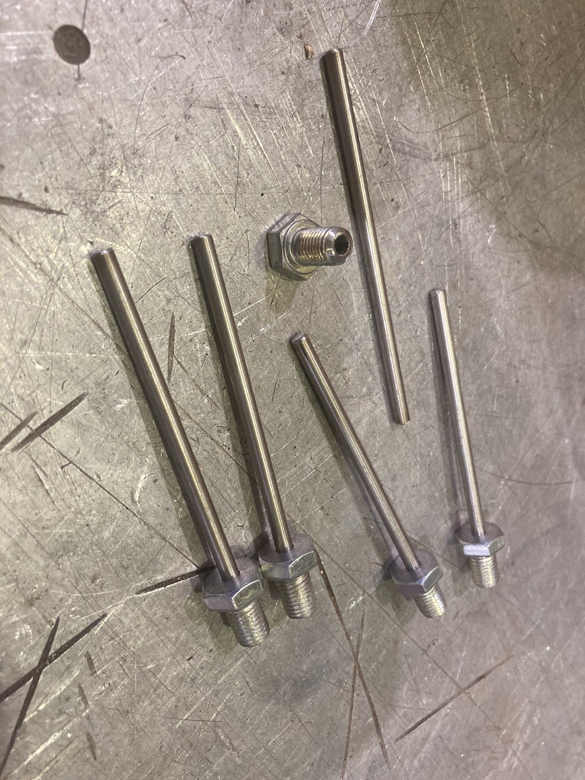

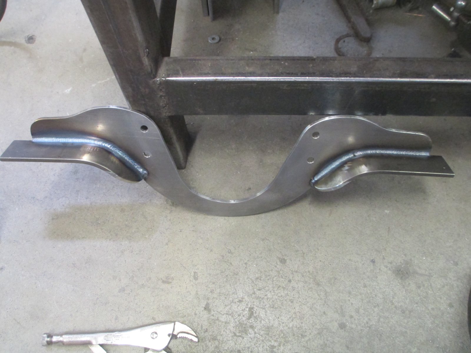

    Steering mount for the roadster I built for Pat Ganahl. Lots of fabrication in the entire car. IMG_6474.JPG IMG_6476.JPG IMG_6488.JPG IMG_7091.JPG IMG_7620.JPG

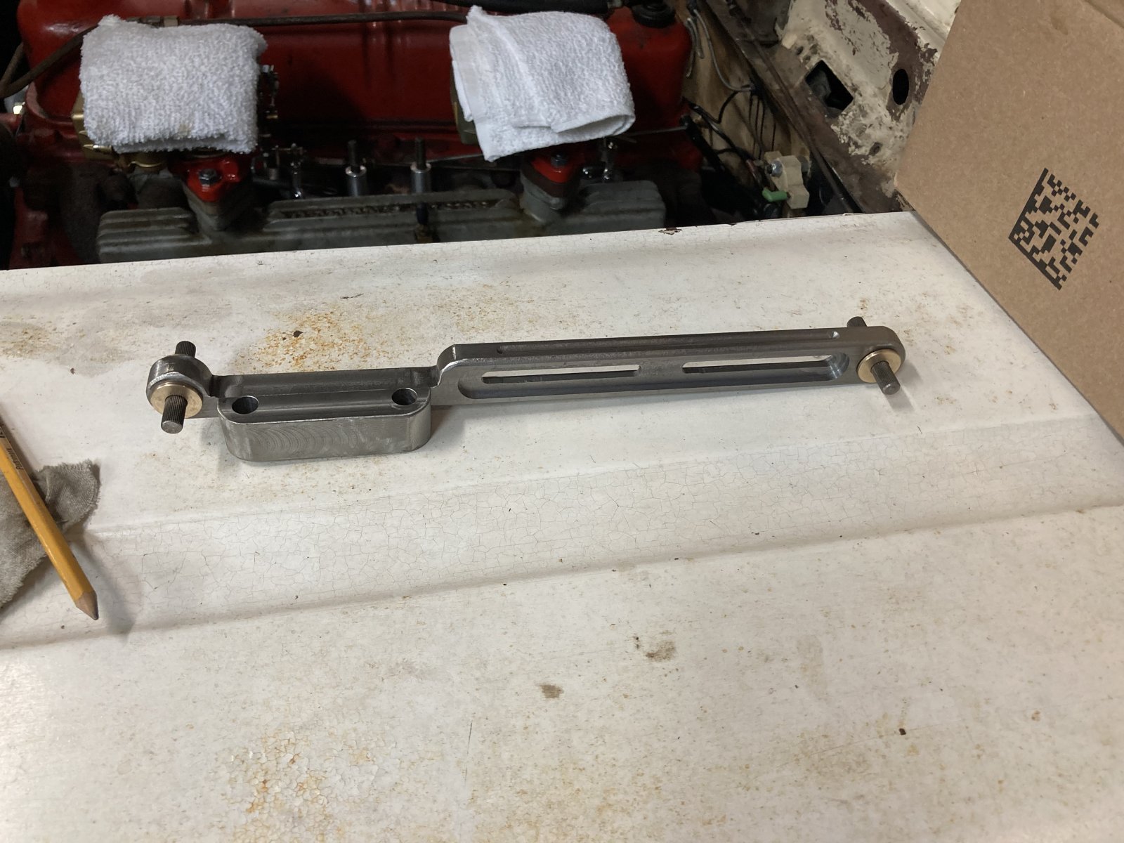

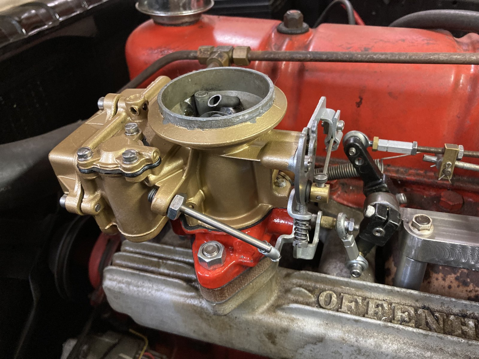

    Here’s the bracket I made for the carburetor linkage on my 59. I guess it’s cl***ified as machine work and not quite fabrication but here it is. The Offy dual intake setup was very rudimentary and had no provisions for adjustment. I picked up a bunch of linkage pieces from the swap meet, made up some oil bronze bushings and a carefully planned bracket.

    I wanted to add return springs for each carburetor but the 1904 has no provision. I decided to utilize the unused automatic choke boss as a starting point and ground a little slice into the tab on the throttle lever. This metal was super hard and would not take a drill, hence the ground slot. Then I took some 5/16 fine bolts and drilled a thru hole, welded in a piece of stainless rod and voila! Each carb has its own small return spring in addition to the main spring on the primary link.

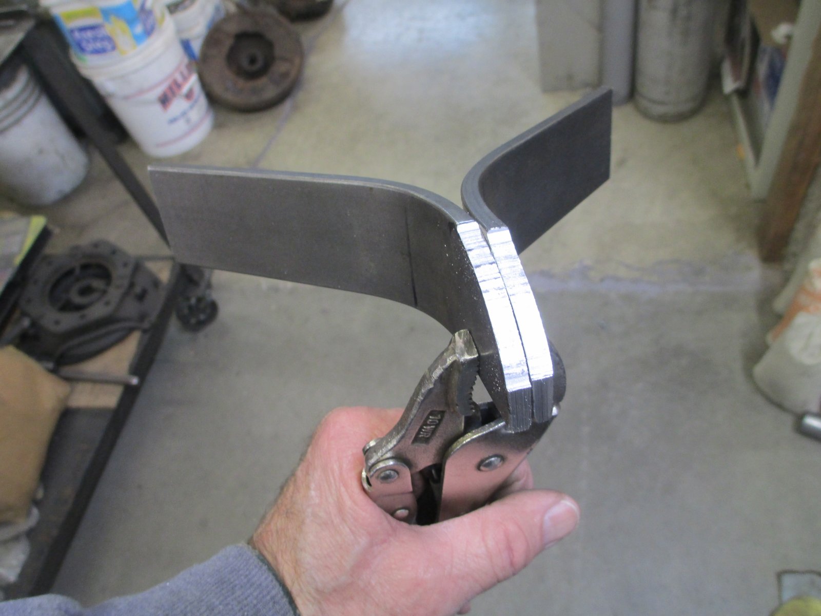

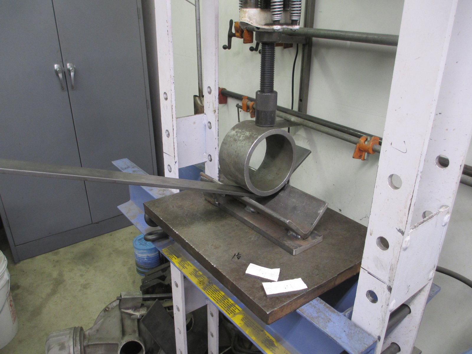

    Thats Awesome Marty:D My press at work has a giant pile of jigs we have built over the years to bend oddball stuff.
    lostone likes this.
  22. Marty Strode
    Joined: Apr 28, 2011
    Posts: 9,707
    Marty Strode
    Yeah Lump, if you build a wide angle bottom die, you can push a variety of sizes of round top die into it.
    lostone and lumpy 63 like this.

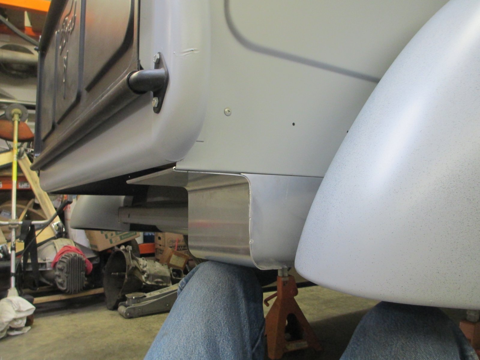

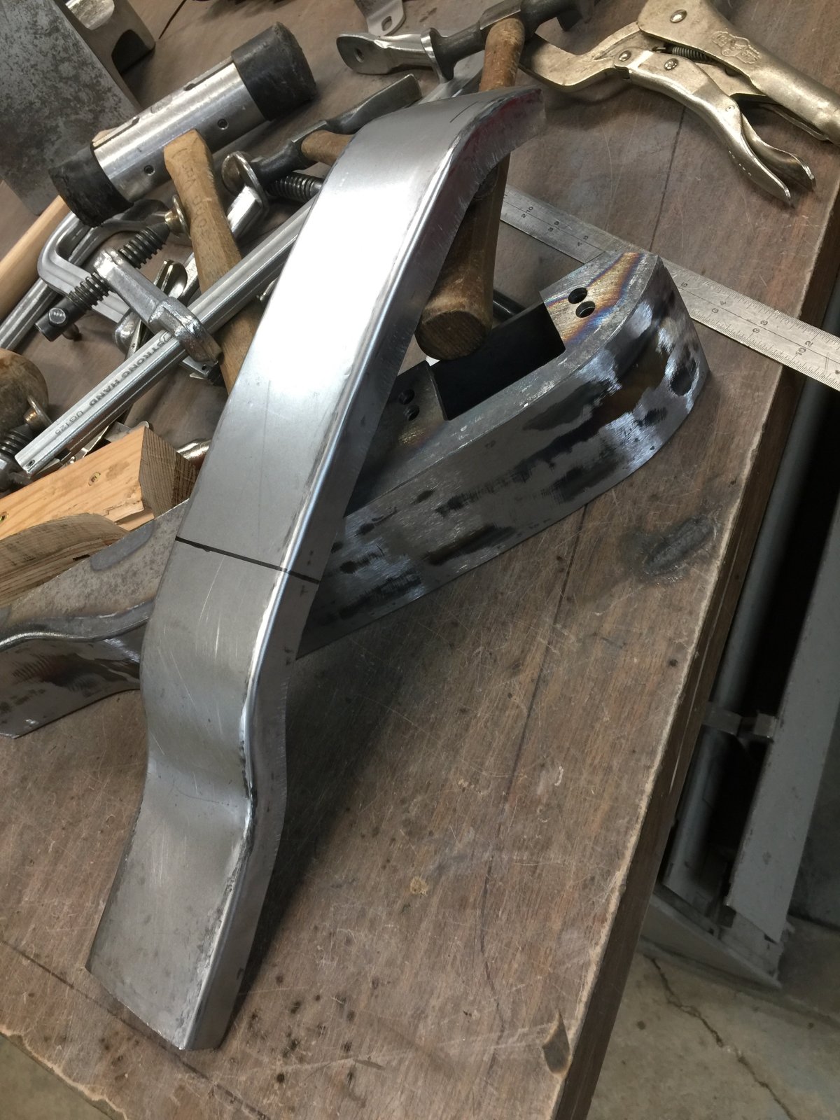

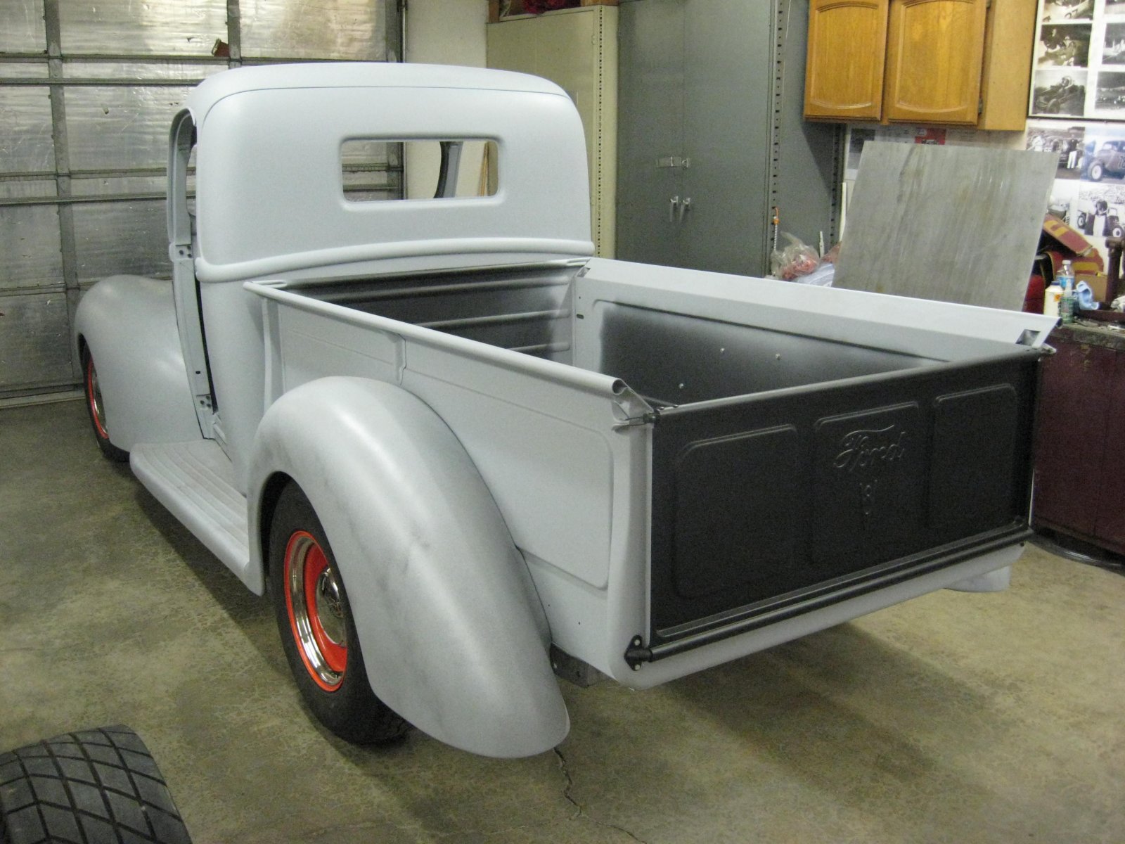

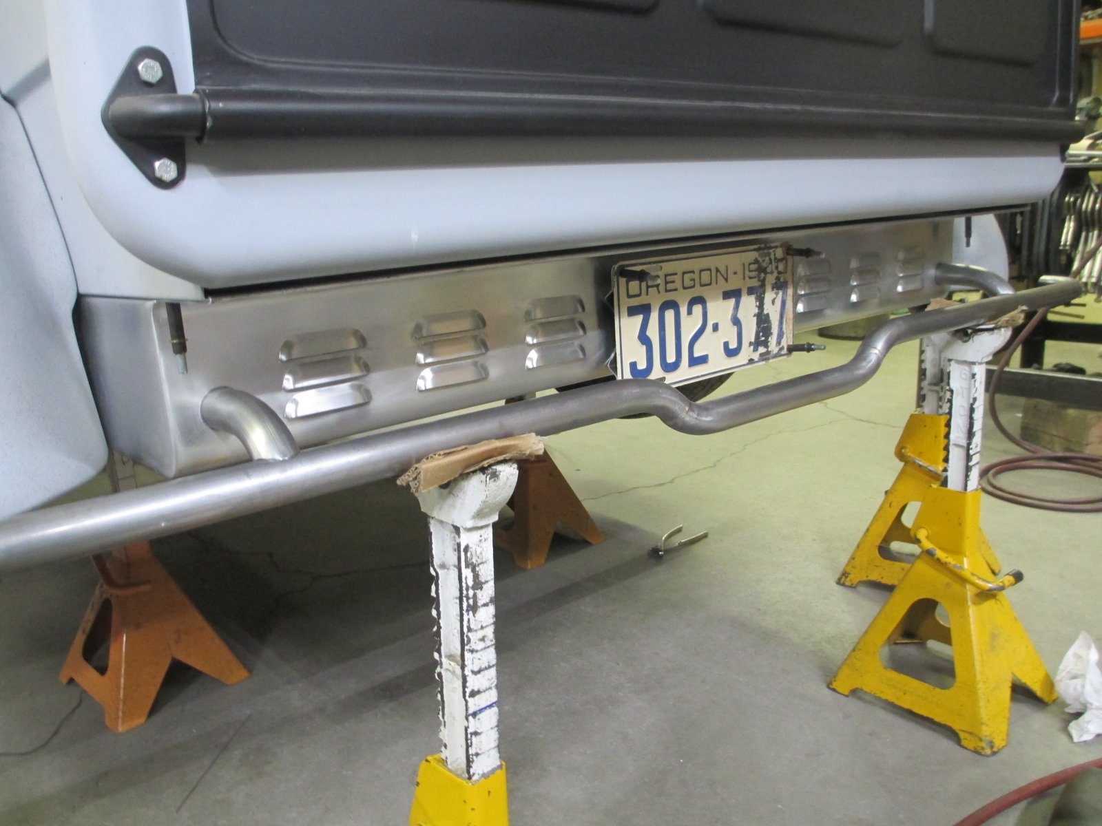

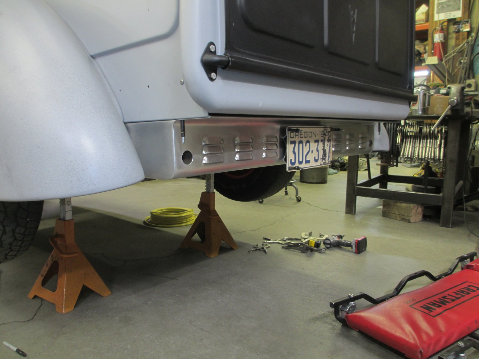

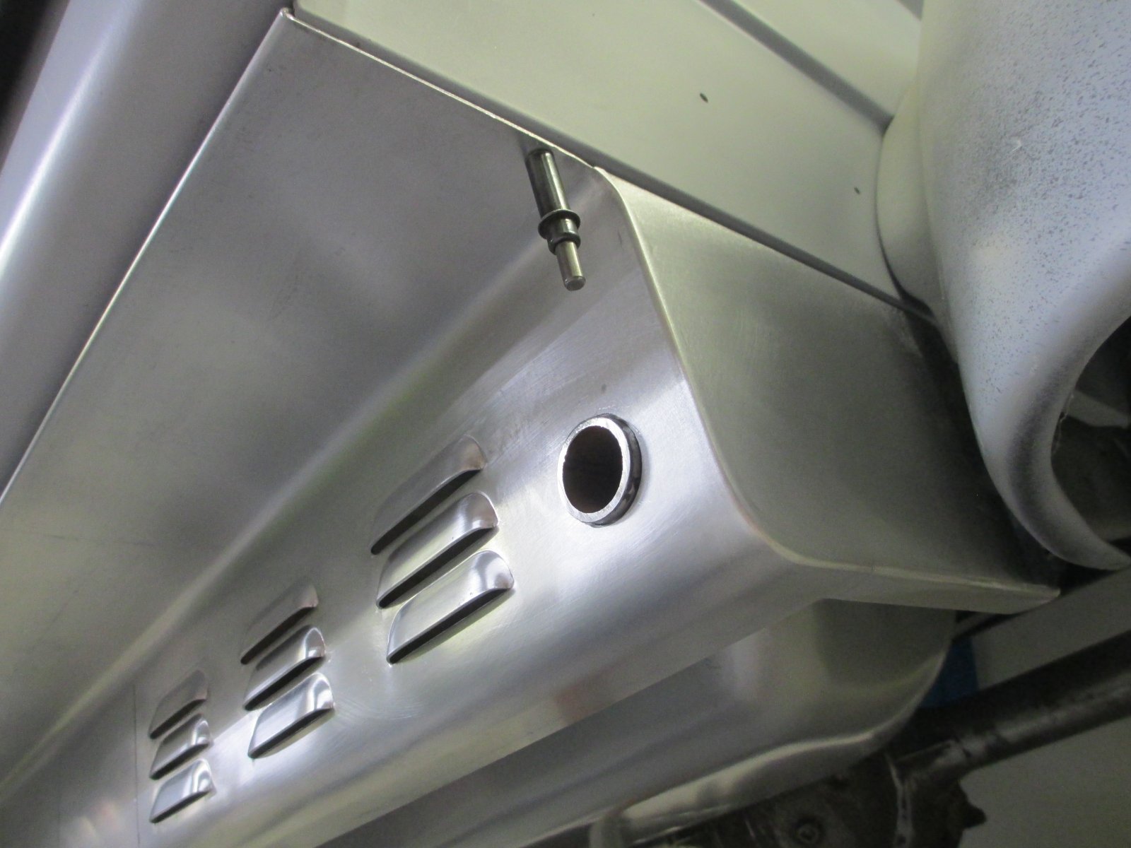

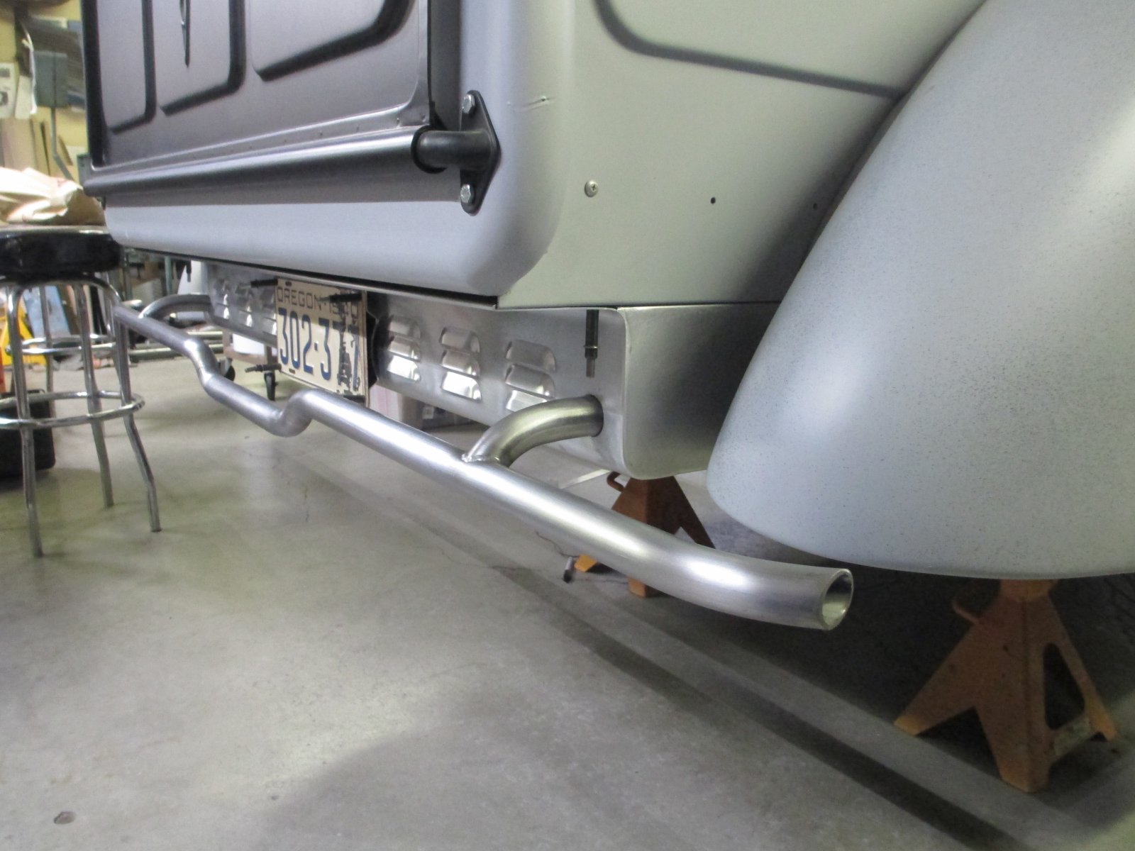

    For my '40 Ford PU, I wanted a rolled rear pan, and many you see are nearly flush with the tailgate, making the box look very deep. I made this one out of .063 aluminum, and set it back under, so the rear bumper doesn't stick out very far. IMG_3254.JPG IMG_3261.JPG IMG_3262.JPG IMG_3526.JPG IMG_3536.JPG IMG_3538.JPG IMG_3541.JPG IMG_3569.JPG IMG_3588.JPG IMG_5051.JPG
    jvo, 57 Fargo, Graham08 and 19 others like this.

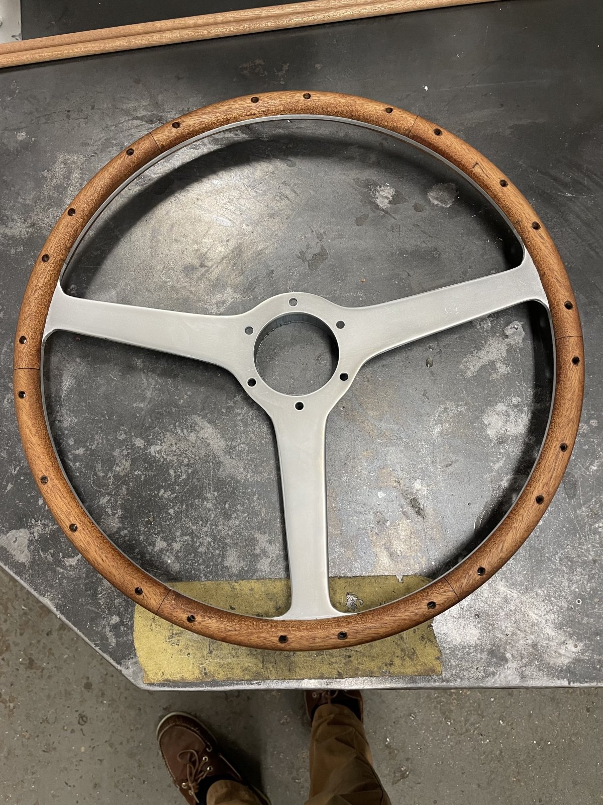

    killer nerf...
  27. Pat Pryor
    Joined: May 28, 2007
    Posts: 1,935
    Pat Pryor

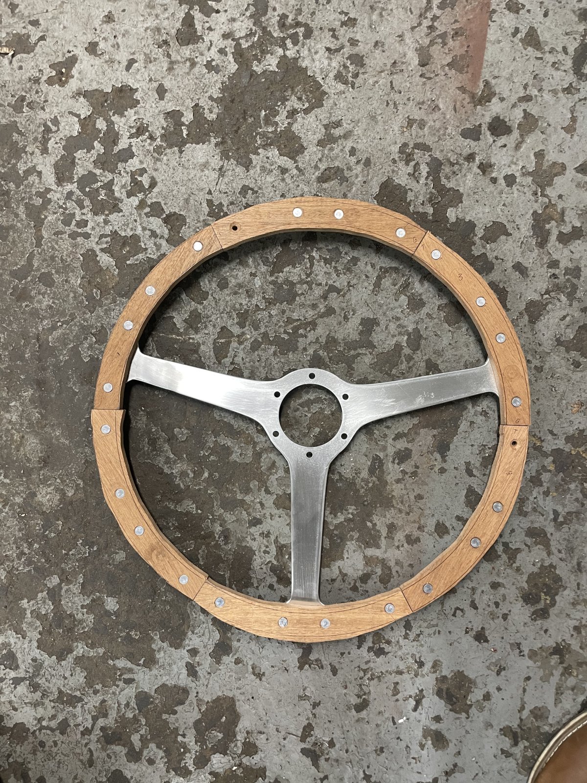

    Its mahogany.
