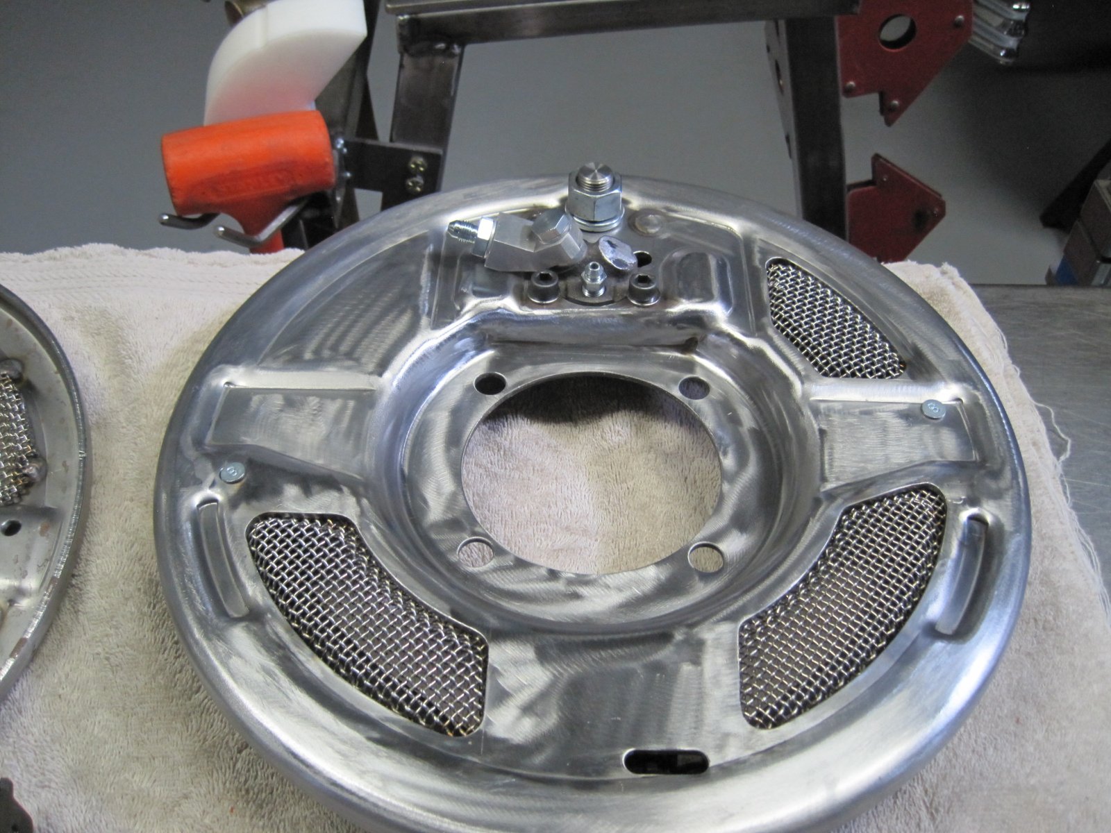

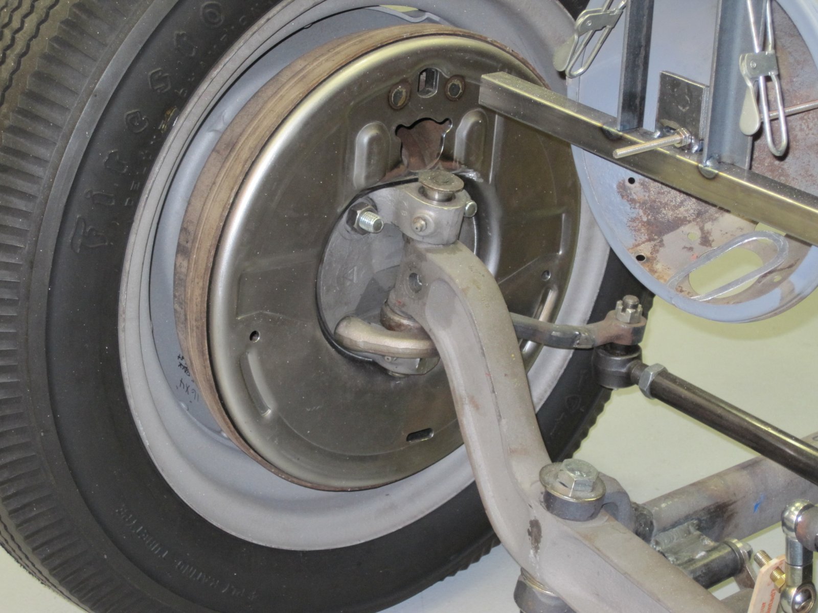

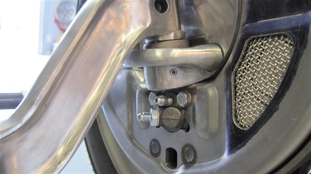

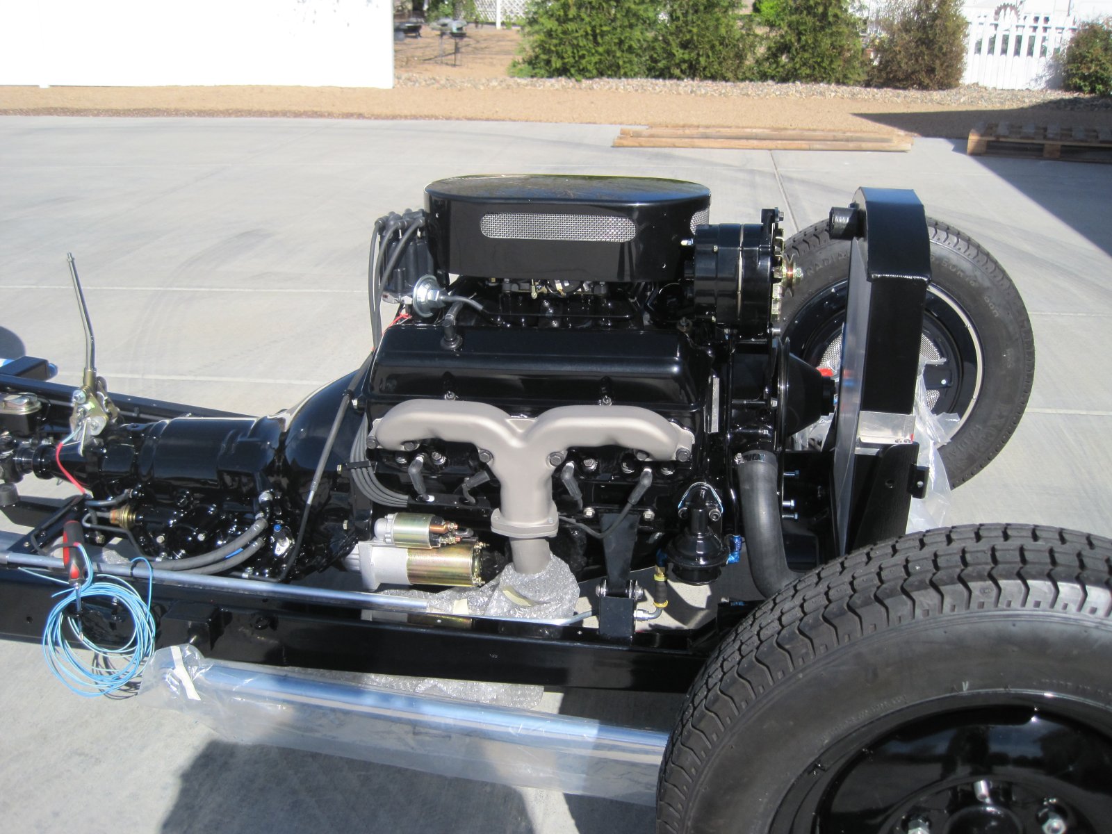

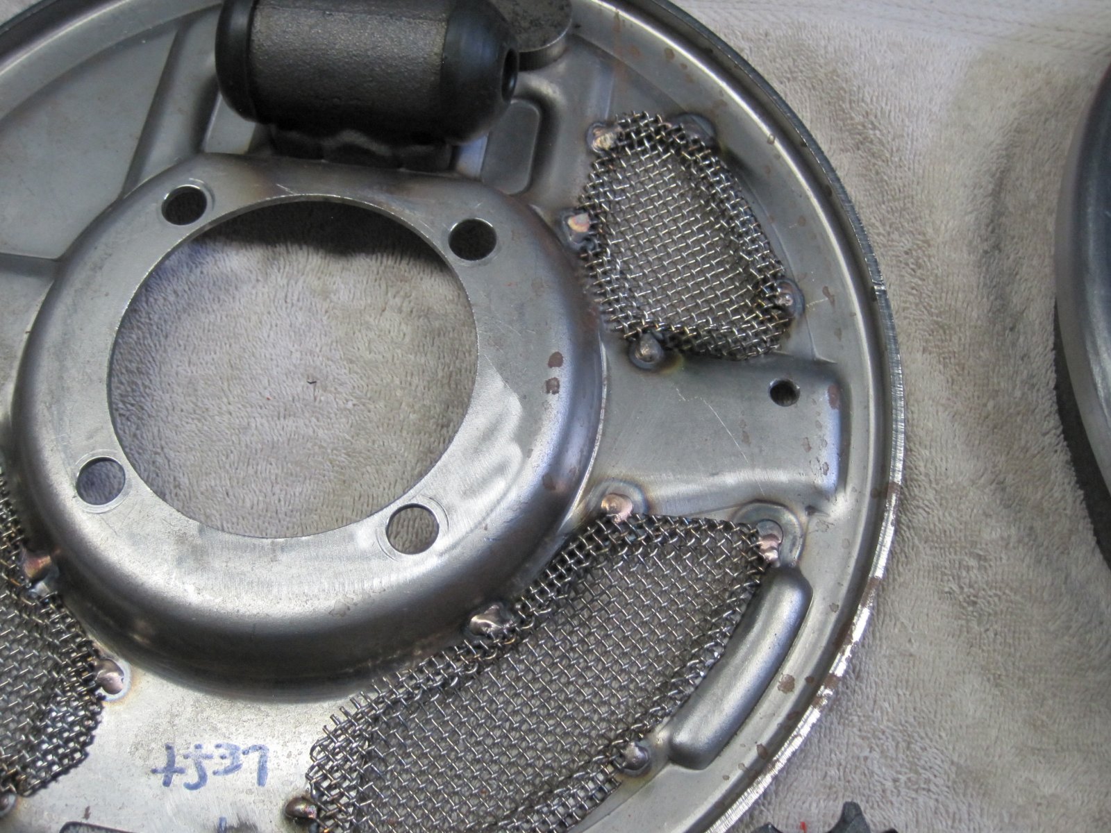

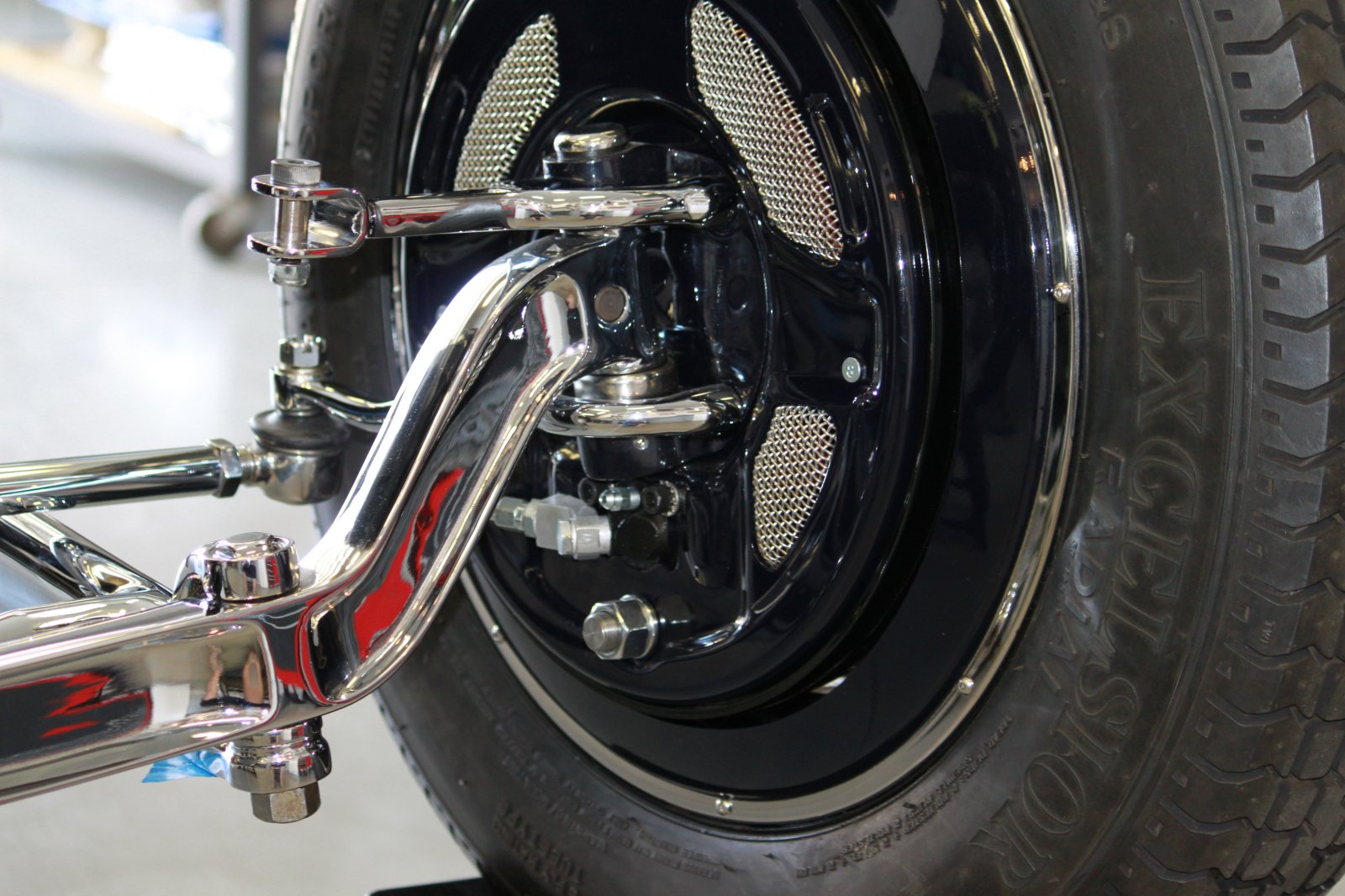

    I'm not sure this type of fabrication work is what you are looking for? But here is my effort to make some backing plate vents for my RPU. Simple way to use stainless steel screen. I also rotated the backing plate 180 degrees to place the wheel cylinder on the bottom, keeping the brake hose low and less visible. Because I'm fond of $$ screen I also used them on my air cleaner and hood sides.

    Beautiful work!!! Flipping backing plates brilliant!
    Can you post details on the screen and supplier?
    Thanks

    I purchased the stainless steel screen from McMaster-Carr, lots of choices. They sell small pieces, so it’s not necessary to buy a large amount.
    When flipping the backing plates, which places the wheel cylinder on the bottom. Make sure to install the bleeder valve above the the cylinder or you will not be able to remove the all air bubbles.

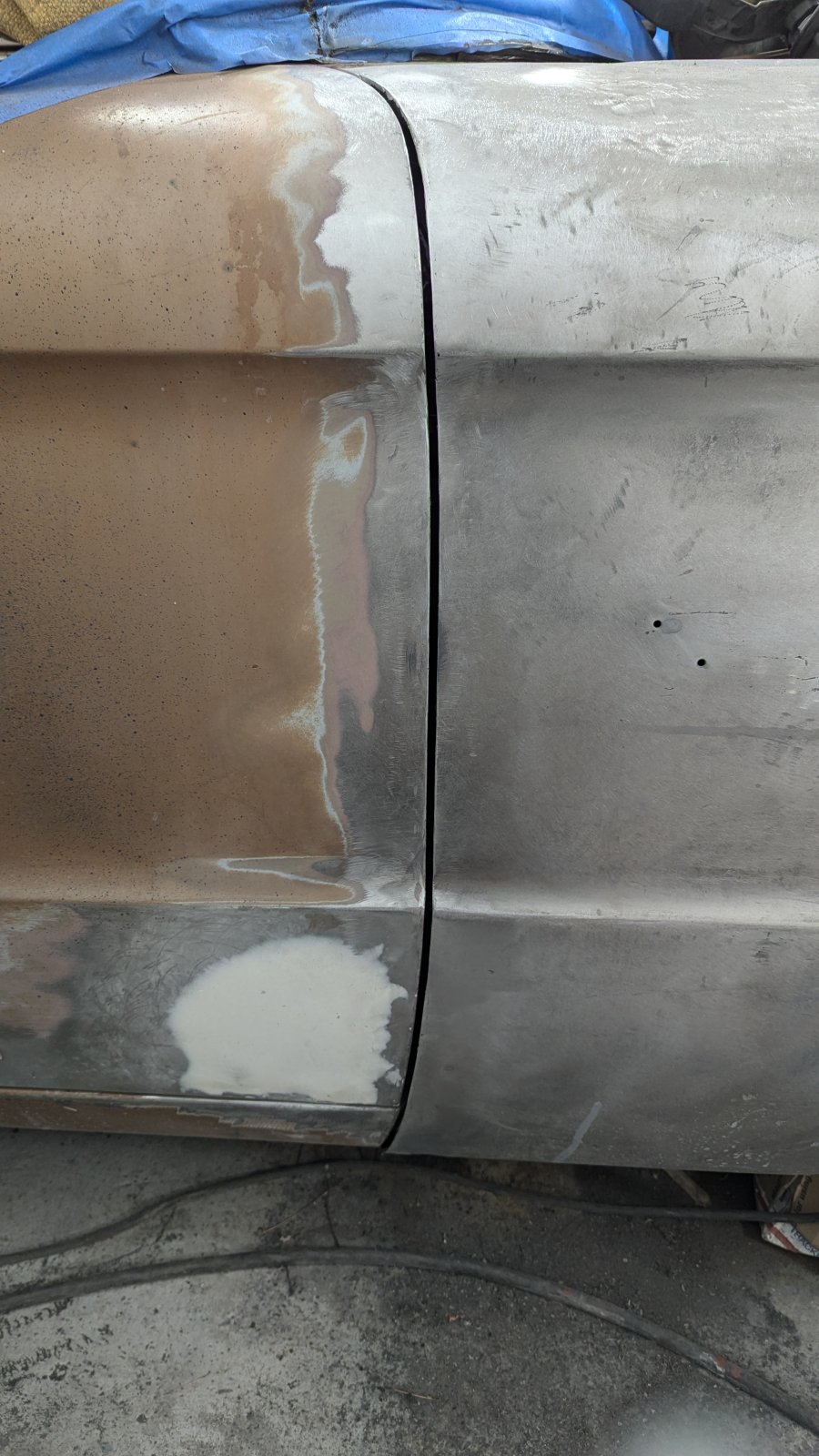

    Still fighting this fight.
    Progress is slow, but it is happening.

    Metal may have memory but I have force, and power tools.

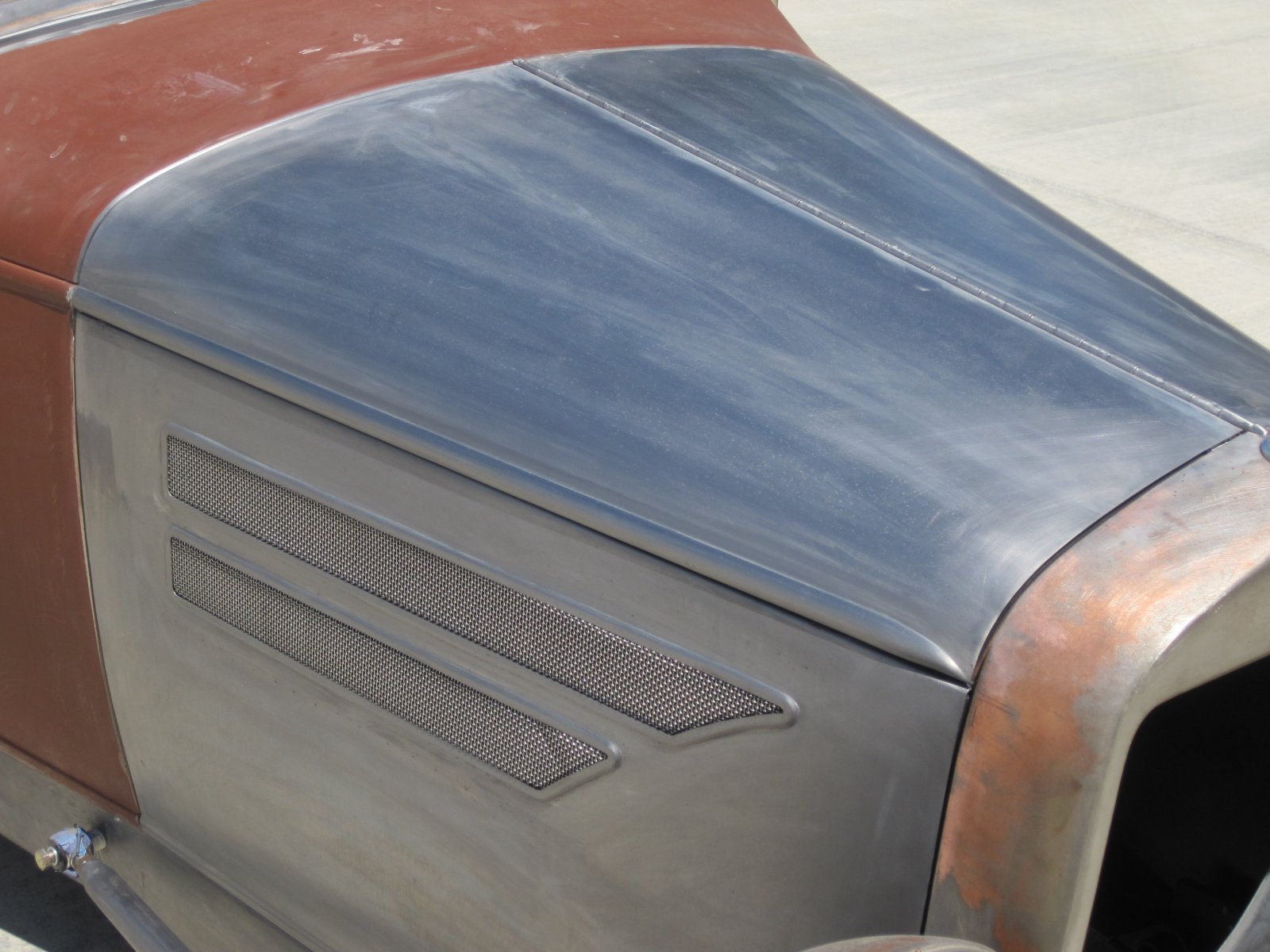

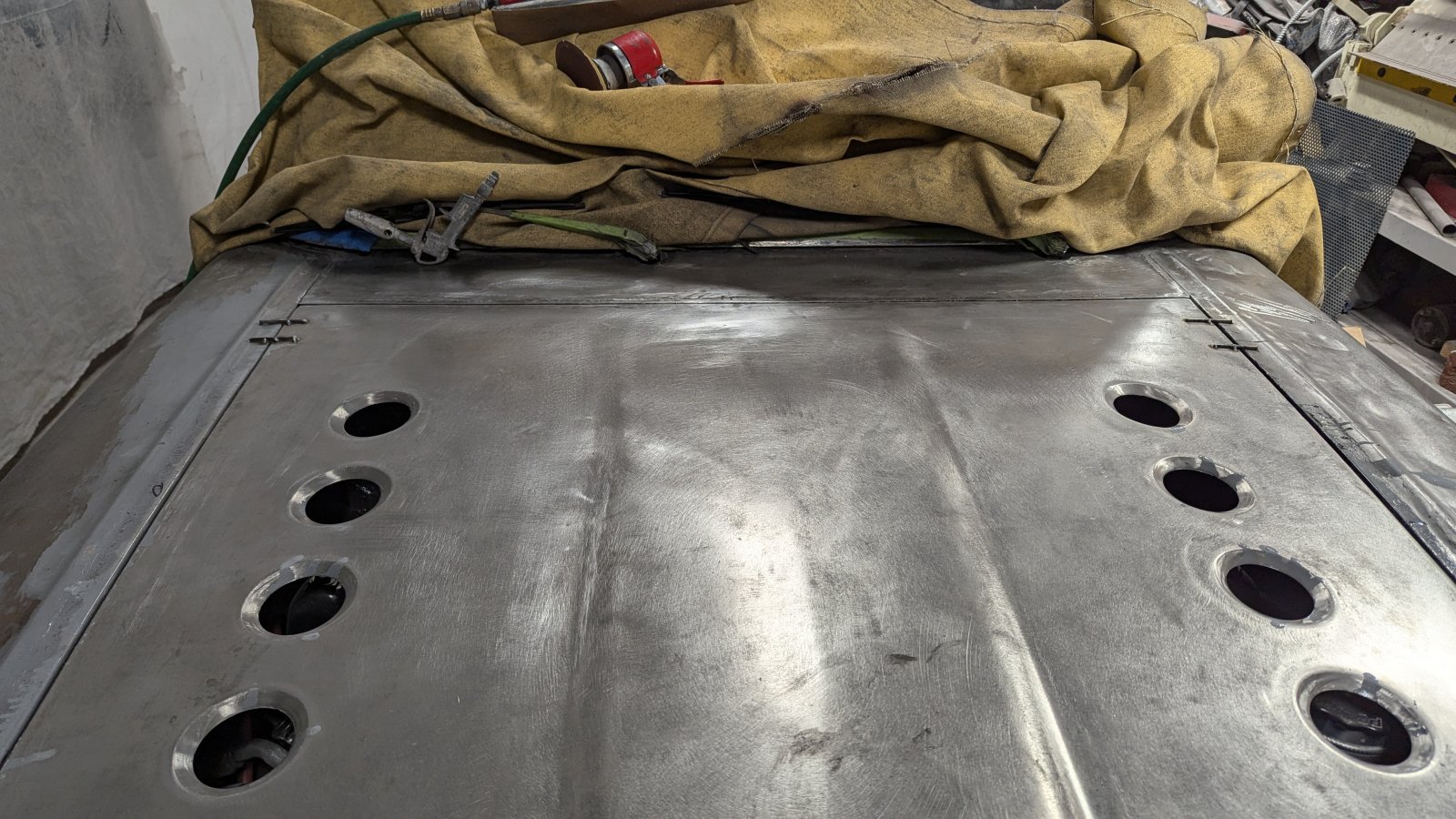

    @gimpyshotrods nice work ! Did you also add the bulge to the hood or alter it ? Is there accents going into the radiused holes also ? Or will they stay open as they are now ?

    That is the factory body shape in the hood, for 1960.
    The holes will get stainless mesh mounted from below. I am fussing over the hole size. I had he excuse of not having he panel alignment done, but I need to get a move on.
    I will experiment with doming the mesh a little, for style.
    If I can work it out I will see if I can get some press dies 3D printed to make all of the domes on a single piece, one per side.
