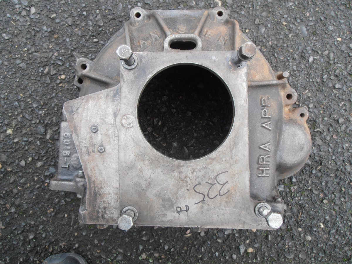

    Does anyone have any experience with this Southwest Speed bellhousing? I was just looking through the clutch explosion thread, and it got me thinking about all the stoplight launches and burnouts I have done in my heavy car, with factory aluminum bellhousing, and 60s vintage clutch parts. I really don't have the budget for a Lakewood, as used they go for over $400 (new closer to 7!) but now I'm nervous about beating on that car come springtime. Would they really contain an explosion well enough to keep shrapnel out of the interior? I see they don't have a bottom.
    https://www.southwestspeed.com/?sec=view_part&id=3175
    I have a tighter budget than ever, due to having a little one on the way, but for the same reason I am starting to give a smidge about safety. Would you trust one of these things? I will try to Budget in an SFI rated piece later on, but as it is buying this one for $200 would bump something else off the bottom of the list .
  2. My guess would be if it will pass tech it will work for you on the street.
    I gave 50 bucks for my Lakewood used here on the HAMB, yes I shopped and got a deal. It will probably not pass tech as it is used and has not been recertified. A new Lakewood is only about 500 and change.
    All that said if you are using a stock GM aluminum bell and are not launching @ 7K you are probably going to be alright. ;)
    Oh the logic on being open in the bottom is that if the clutch comes apart the pieces will follow the path of least resistance. That will not be acceptable with some sanctioning bodies. The reason I mention it is that a long time ago I was running a '64 Chevelle on an outlaw track with a corvette aluminum bell. The tech said that he would pass me if I removed the inspection cover because it would give my clutch someplace to go if it scattered. LOL
    Note: in the class ads they are running in the 2-300 dollar range depending on what you are running.
    https://www.jalopyjournal.com/forum/search/172701141/?q=scatter+shield&o=relevance&c[node]=47

    That's pretty funny about taking the bottom off! I guess I can see his thought process. The bell that is in my car now is a Corvette one like that, it came from a '64 that was resto-modded where I worked in AZ. I definitely don't launch this car at 7k!! I don't think this engine is any good past 6 or so... With the tires I have on there now (and it was open diff last summer) around 3,500 is the sweet spot. That said, I have got up into the 6k range while smoking tire.
    I guess they did use aluminum bells in all the factory hi-po stuff, right? Maybe it's just overkill for my app.
  6. A lot of the old scatter shields were aluminum.
    The thinking on it is along the lines of using Lexan for making bullet proof glass. The aluminum is soft and will trap the pieces or slow them down to the point of not being dangerous. A lot of older scatter shields were aluminum like this old Ansen unit for example.
    Clutch explosion can be two fold, RPM and inferior pieces. We had one happen at the HAMB Drags a few years back behind a 6 cylinder for example. The reason was probably because the builder got a little heavy handed when he was lightening the flywheel.
    Actually clutch catastrophes are pretty rare. They can be pretty gnarly when they happen but it is not an everyday occurrence.

    Porknbeaner, thank you, man. Kind of puts my mind at ease, maybe I will just save my bucks until I really need one. FWIW I emailed a place that sells those ones I was looking at, they said they wouldn't run one on the street because it's not 360°. I've been running my stock one without the inspection cover this whole time, is the issue there just road debris getting in there?
    What about at the track? If I went to a street-legal event would they let me race with a stock piece? I would be surprised if I went faster than like 14s.
    I am also looking at a vintage RC cast one on the auction site, it's got the bottom piece with it
  8. Chevrolet was the one with the most issues with exploding flywheels. If you go back and look at the early NHRA rulebooks, manual-trans Chevys were required to use one regardless of class, while 'other' makes didn't need one unless running in Super Stock or higher classes.
    I'd be leery of the linked bellhousing. It's advertised as 'light weight' which makes me wonder how thick the steel is. Any flex in the bell and you may have issues with clutch operation and excessive wear in some bearings. It doesn't appear to be 'approved' either. If you don't already have one, investing in a SFI-approved flywheel and pressure plate may be just as cheap.

    I also found a '70s era Ansen stamped/hydroformed steel bellhousing, would one of these be considered safe? It looks similar to a Lakewood 77-150 in that it doesn't appear to use a block plate. Being behind an SBC it's not really the end of the world if the block cracks as long as it keeps parts out of the inside of the house car.
  14. The Lakewood 77-150 style is not SFI approved, but if you don't need the rating, as in track use, you should be fine with it. It is a definite step-up from the aluminum ones, which I don't use. I have an iron one from a '55 Chevy with the forged truck fork behind my 355. The cast iron housing is another option and they are easy to find.
