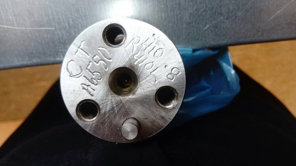

    Got this old small block chevy roller cam and trying to find out the manufacturer or the specs. From the engraving and measuring the lobes I've confirmed it's. 410" lobe lift but don't have an old block to check duration or LSA. I think the letters CT point to the manufacturer but have so far come up blank on it. Any help anyone? DSC_2498.jpeg

    Perhaps a Circle Track grind...?
  5. If it was a custom grind about all you can do is measure it...
    You asked this question a couple of years ago too.

    .410 on the cam would be over .600 with 1.5 rockers. Anyways, wasn’t, isn’t there a company called Cam Technique? Google ****s on my phone so can’t confirm or not

  9. Cam experts? We all claim to be. :D :D :D
    This is pure conjecture but I would guess that given that it is hand lettered and not stamped that it is most likely a regrind. Nothing wrong with that.
    I would ***ume that you also have no access to a lathe. I can probably come up with a block but shipping is gonna be a bear. LOL

    Google the numbers. Lots of flaky sites. It does look like that grind was used on Harley cams too. 90% of the hits are yours though. Mike

    The reason I asked is to send you to someone local,most cam companies offer a service where if they 2 lobes Intake and exhaust they can cam doctor the cam for you.

    A free block.....I'll be round later [emoji16] just done a comparison and some meauring with another cam I have and it appears this has a small base circle which points to either a regrind or for a stroker motor I think. Didn't know you could check lsa or duration on a lathe...tell me more.

    Fit a degree wheel to the cam and divide by two... Hadn't thought of that.

    HI,some info on Cam Techniques ****ord CT. then FLA. David Generous. Very Smart guy. Was engineer at Crane, told me he wanted to be close to home. very successful,small shop, clean , very helpful. . his gig was custom cams. he was into fixing the cam that didn't work. very big on 1600-2300 pinto motors for racing. I installed many of his cams so i recognized the etch.. i still have one in my chevelle, from 1982. he moved to fla. p***ed away 2018.

    If you find someone with a cam doctor they can read the camshaft, if it was a custom grind Cam that usually in grave the numbers in the end
    Sent from my SM-J737T using The H.A.M.B. mobile app
  19. Hire a machinist.
    The cam chucks up in a lathe and you turn it and measure. Just like you would in an engine block with a degree wheel. Only more accurate.

    Most cams I’ve seen are etched.
    Those look like like lobe catalog #s to me. -8 is likely the lsa(108°)
    So, I would ***ume intake is cat# 410
    Exhaust is cat# 410L
    Lsa cut at 108°
    Most cam companies have lobe catalogs on line to search through. They “name” the lobes with a number/ letter . Usually based on lift. The catalog will give duration numbers based on the lobe name/ designation.
    As stated, most cam companies have a machine that will “read” the lobes and locations and print a spec card. If using it is the plan go this route.
    Are you concerned with the mechanical characteristics of the cam, or more concerned with providence? Don’t take that wrong... some people want to have parts with history or a story with markings as proof. Hope this info helps.

    You can put it in a couple of "V" blocks. Then attach a degree wheel. Probably need to be near the end of the table so the degree wheel can clear. Then get a magnetic base and a dial indicator.Hopefully a 1" travel indicator. That should let you check the cam accurately and quickly.
