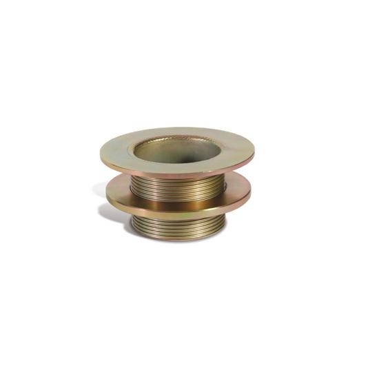

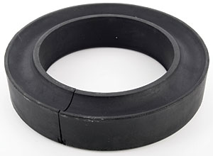

  18. have ya tried something like this?

  19. Rusty O'Toole

    Rusty O'Toole
    Thanks Anthony I was going to say that. The illustration shows a rubber shim used to raise the front of cars with air conditioning.It goes under the spring. Will lift the front of the car about an inch.

  20. I am considering using something like this to dial in an older twin I beam on my daily driver
    it has about 2 inches of adjustment
  21. bobss396
    Joined: Aug 27, 2008
    Posts: 18,752
    bobss396
    We used these in a "stock" stock car cl***. Paint 'em black and impossible for tech to find. I like the rubber ring ones, easy to toss in or toss out...

    38Chevy454
    I was going to suggest just put one of these spacers in, and use your orig springs. Although you stated you want to stiffen it up some, so searching the Moog catalog, in the back specifications section, you might find something with a stiffer rate like Russco recommended.
