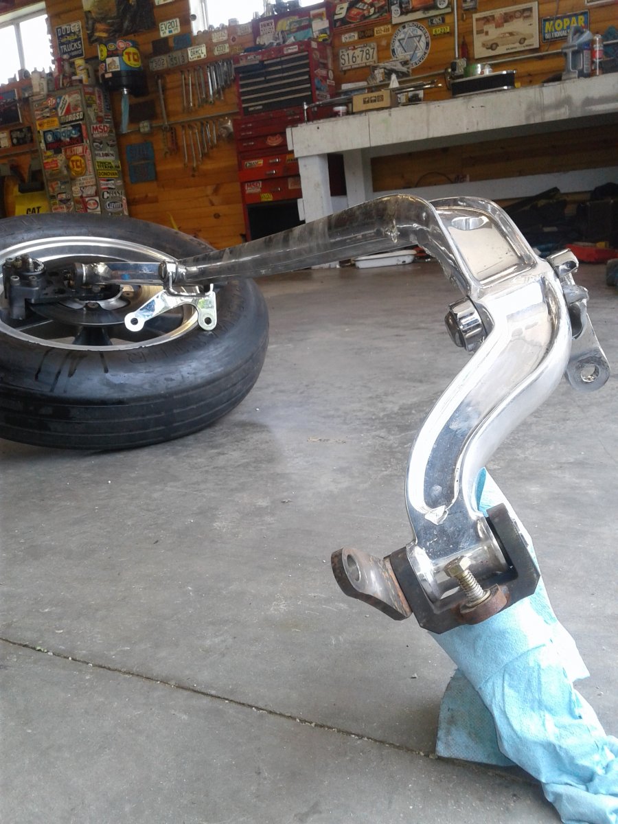

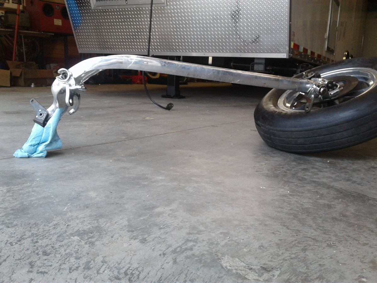

  14. heres a machined aluminum one that I wouldn't be scared of from Johnsons rod shop

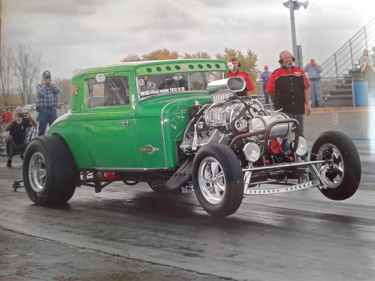

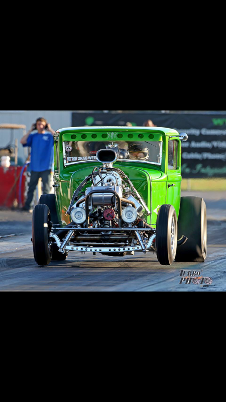

    I’ve had an Aluminium Super Bell (oval holes) under my ‘32 3W for about 10 years now, with about 55,000 kms (34,000 miles) on it. And they have been hard miles of driving on some of our lousy roads in Australia.
    More than happy with the Axle, would definitely buy another one if needed.
    Only drawback is the cleaning & quick polishing of it, to remove the road grime.
    As for failures, never heard of any breakages or bad reports about them.
  27. Theres alot of comments from those with no real world experience using a super bell axle. The material used is the same thats on viper and corvette suspensions. The axle wont break on impact. It will bend just like a original ford. In fact the super bell is stronger than the original ford. Im probable the only one on this thread with real world hands on experience crashing a race car with a super bell. Aftèr i repaired the car i put in another super bell because im that impressed. If you are ever at pete and jakes ask to see my old axle they use it for display purposes now. Im very comfortable street driving and racing my car. I do drag week with the car so that requires driving with a trailer. We stress every part of this car to the max. The only thing to fear is fear itself. The challange has been made what do you have for hands on experience that says they are bad? 20170716_171420.jpg 20170717_133205.jpg 20170717_133151.jpg IMG_1994.png 20161101_085815.jpg
    nitro_rat, invada, clem and 5 others like this.

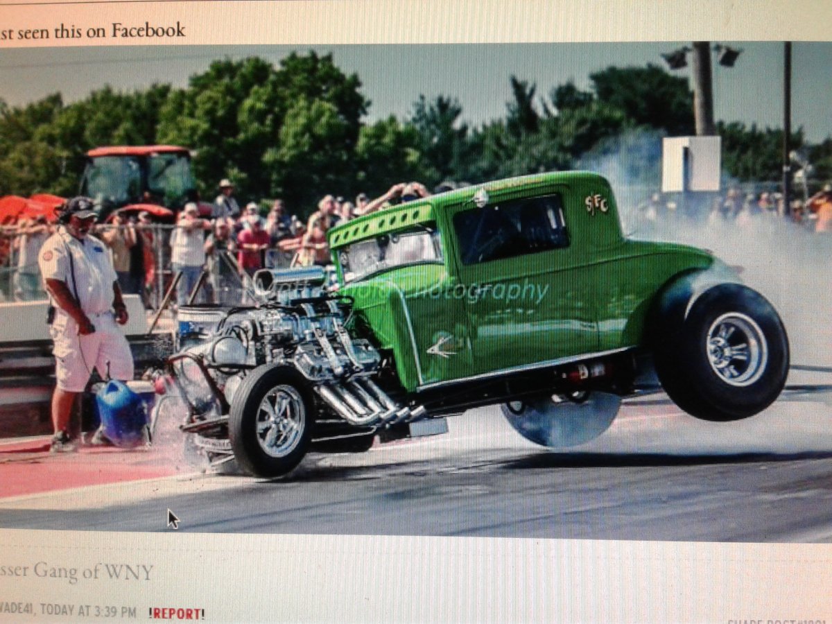

  29. Mount a go pro on the front of your car. Then tell me your steel axle doesnt flex. To think someone posted they are concerned about going 65-70 mph. Try 200 mph. The axle doesnt even cross my mind.
    invada and Dave Friend like this.

    The use of a heavier axle may help keep those tires from hopping off the ground like that.:cool:
