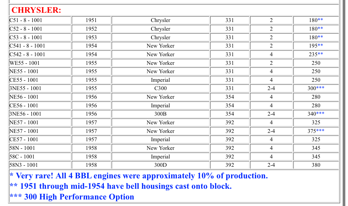

  6. Black Panther
    Joined: Jan 6, 2010
    Posts: 2,373
    Black Panther
    from SoCal
    1958 New Yorker (and other models probably) 392
    Sharpone and Deuces like this.

  11. 73RR
    Joined: Jan 29, 2007
    Posts: 7,342
    73RR
    The block casting number, 1673729, says 392. The 'modified' engine mount ears will cause some grief...:(

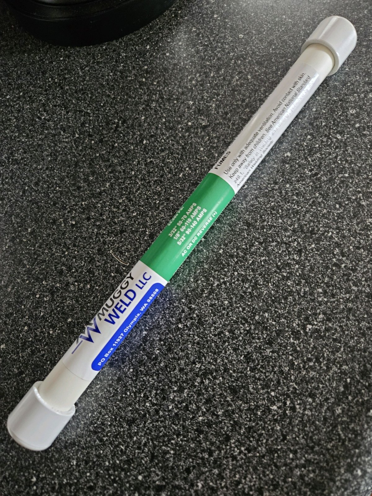

  25. We repaired broken ears on a Dodge LA block, by welding the sawed off exhaust manifold outlet pieces, from a 3 bolt SBC exhaust manifold. Pre- and post heat was used in the welding process. Happened about 20 years ago, long gone, no pics.

  26. wheeldog57
    Joined: Dec 6, 2013
    Posts: 3,845
    wheeldog57

    Even though they say that rod doesn't require pre heating or slow post-weld cooling, you are going to have much better chances of success by using normal cast-iron welding procedures.

    Depends on what you plan on putting it in, but I would probably go with the front motor plate.
    Unless that muggy rod has improved over the years, I would spend the extra money on real nickel rod and pre heat and slow cool the block after welding the ears on.
