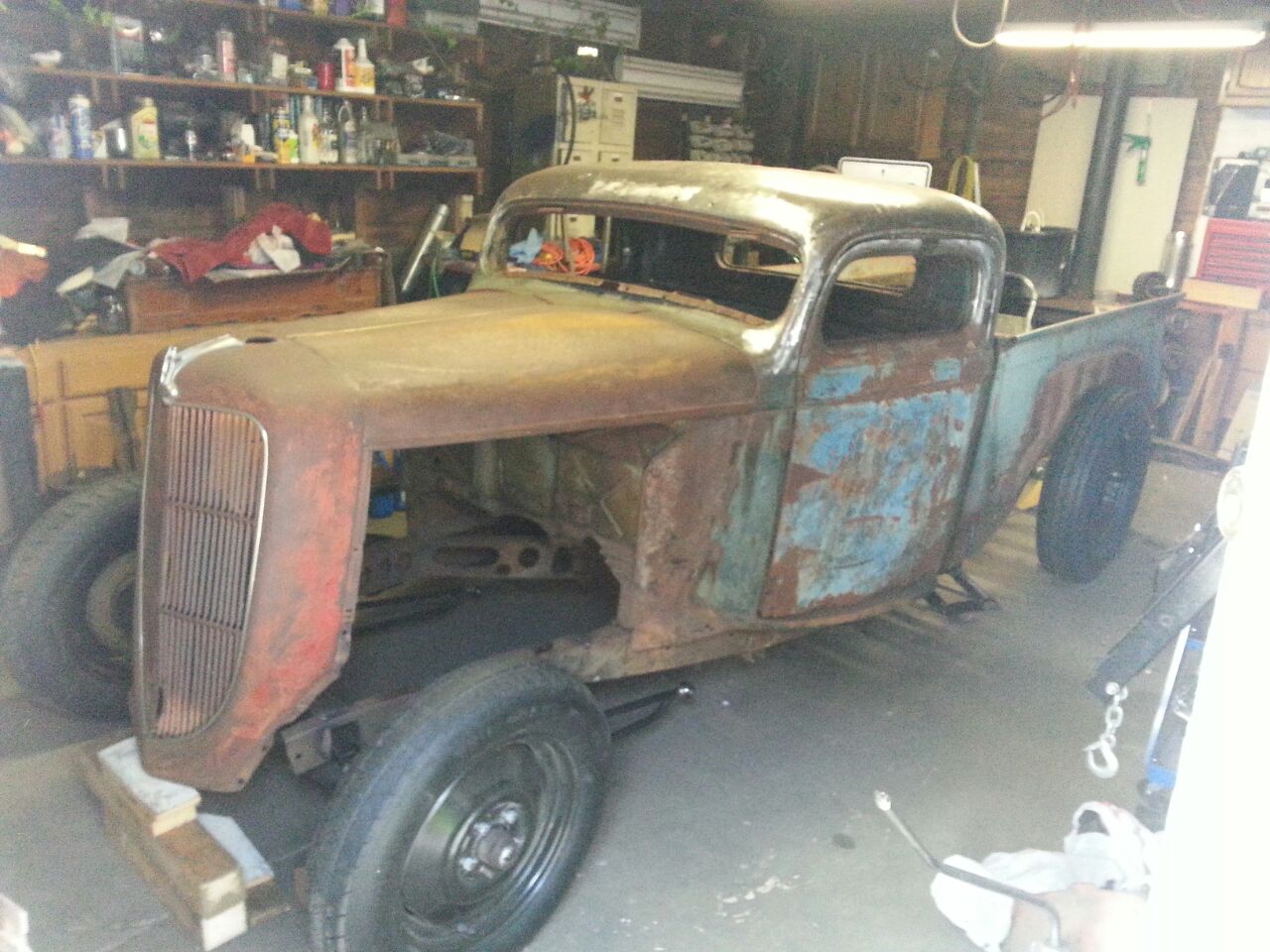

    Short wheelbase, keep the axle close to the engine looks best on these type builds. I dont know about the 32 grille, a 35, 36 or even a 37 truck grille would look great on it, your doing a nice job, keep the pics coming.

    F-6Garagerat
    I did a 48 in this style which is not exactly the best cab for it. Still, if you pick the right parts and watch the proportions they can look pretty cool. Mine was cool enough for someone to buy it from me for 9K+, lol. Yours is looking good man.

    What are you going to do about the A pillars? when I chopped my 48 cab we quartered the roof and added metal through the center so we could pull the front section forward to line up the A pillars, rather than lean them back from the cowl up. Theres a reason the windshield was on the angle it came out of the factory with. IMO, just keeps the proportions better, which is everything on a vehicle that really never gets done "fenderless". It's a lot of extra work but, probably no harder than getting those pillars to line up the way you have them now.

    we are just going to split the difference 1 in. at most both ways...

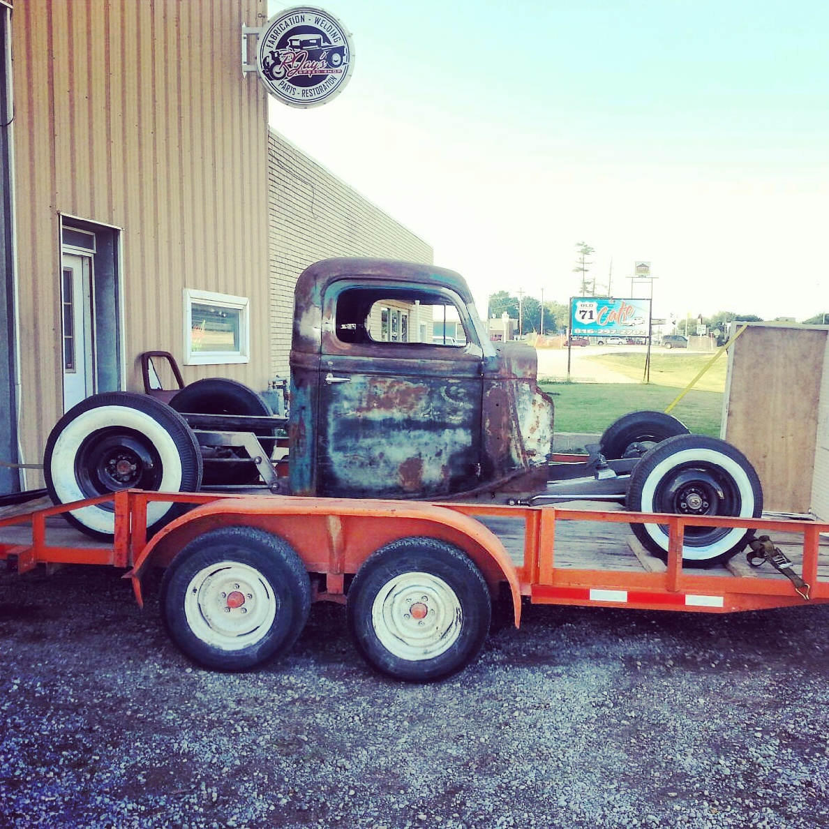

    Chop done . on its way to greaserama
