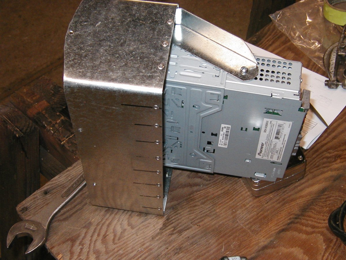

  7. So here is some Food for Thought. I just did this on my 51 Ford Convert project (not my first time). Screw aftermarket plastic shit, build it yourself. It's apx. 3" deep and plenty room for a map and flashlight. Then I mounted a fiber optic cable so the remote can transfer the sig, back to the new unit and the stock radio on off switch turns on the new units power. I'll glue some black felt in it before it's done.

  10. I think there's plenty of room to do what I did and leave the vent in place. It's just a piece of Tin and a little time. Screw hanging Shit under the dash.

  16. Well I believe Crazy Steve is confused with the pre 57 Ford heaters. The fresh air vent is a stand alone unit and has nothing to do with defrost or heat. None of my 57-58 or 59 Fords have factory air so I can't answer anything related to that. Measuring the space for a simular product like the photos I posted there would be more than enough room for me to install the same unit in my 51 into the same space in my 57 Glove Box. The numbers you posted say your trying to work with a Radio almost as large as a stock 57 Ford one. My advice would be to try a smaller unit.
