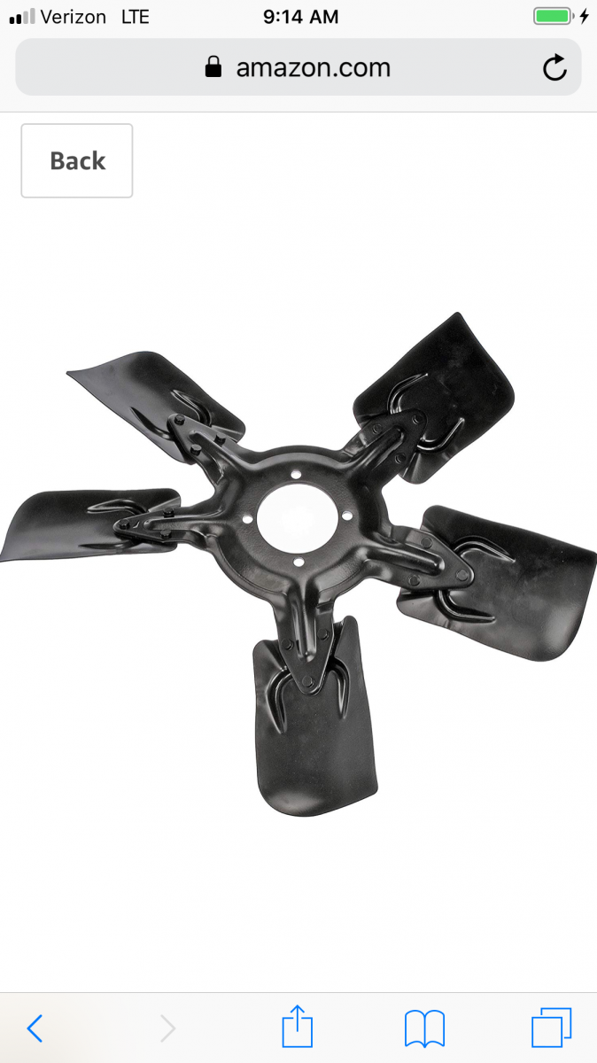

  9. There’s a lot of crazy fans out there CC4A8D8B-F178-402B-8659-60A5566D7FBE.png

    The odd looking fan spacing is done to break up harmonics that occur during operation. This reduces chance of damaging components like the radiator - similar to avoiding a natural frequency vibration. It will also be balanced as well.
