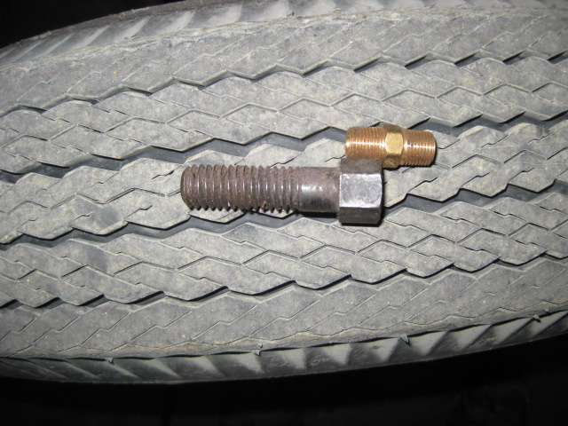

    thinking some more, i would start with an old high head bolt. that would give a place for a wrench, and the high head would allow room for tapping a hole for the 1/8 pipe elbow. cut 27 straight threads up to the head allowing for the jam nut. i can do that. need to get out the book and check major/minor sizes, i think a 1/2' bolt to start, drill 1/8" thru the center

    like this, thats a 1/2" high head old time bolt, minor size is .410, so it would clean up to around .400, which is i think major size you need, havnt got the book out yet. and the 1/8 ****** is there to show there is room for 1/8 threads for the elbow. this will work? IMG_0717.JPG

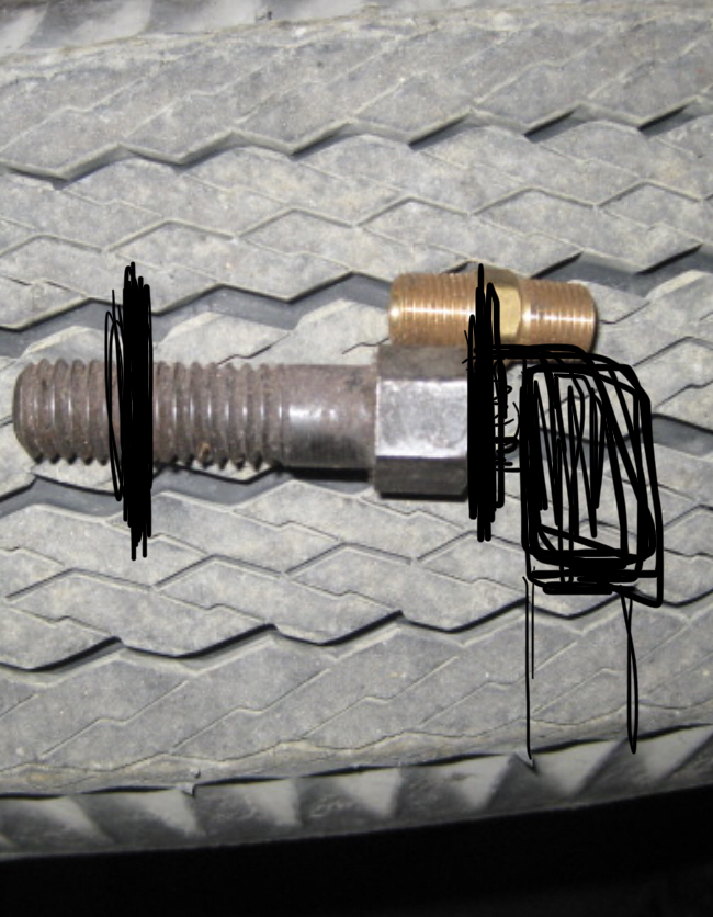

    Yes I believe it would I could jam Nut and o ring on the case and what you be great if if the bolt head side was cut for 1/8 -27 NPS and I could bolt that stock 90 on there with that O ring and seal against that head. I have a coupe of those fittings Than I could screw the metal line into that stock 90 fitting

    Like this

    Can you draw what in needed blueprint kinda with length and sizes needed thanks. If one is going to machine this part why not just put a 1/8 taper male on the one end for the trans and a 1/8 female for your 90 degree adapter.
    The reason I say this earlier you quoted that lots of c4 transmissions are messed up when folks jam a straight thread into the hole why not use a taper end

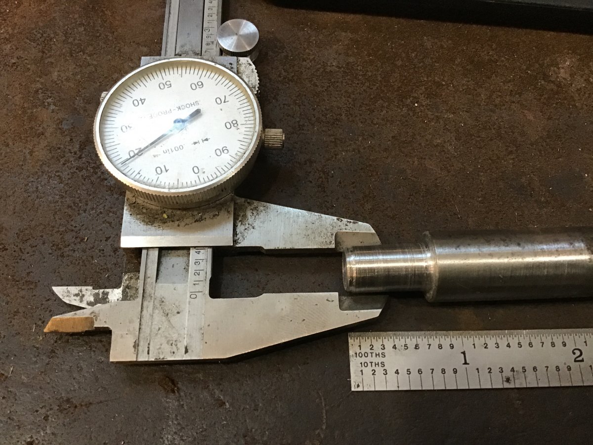

    How long do you need it and what size hole thru. As you see the one end is machined for a 1/8 taper .415 and you can run a die over it. I also machined a lead-in to help align the die. image.jpg

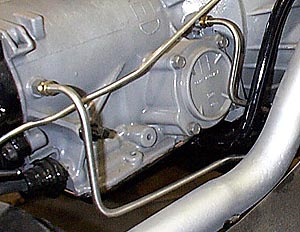

    AUTCOOLERLINES1.JPG Ok I dont get it why the fancy adapter are you that atached to the hard line that is there that you cannot bend a new one to reach either the straight or 90 that is avalible

    I just went back and looked closely at the pics..
    Out of the case , hard 90 degree turn , into a 5 /16 hard line..
    Please confirm...
