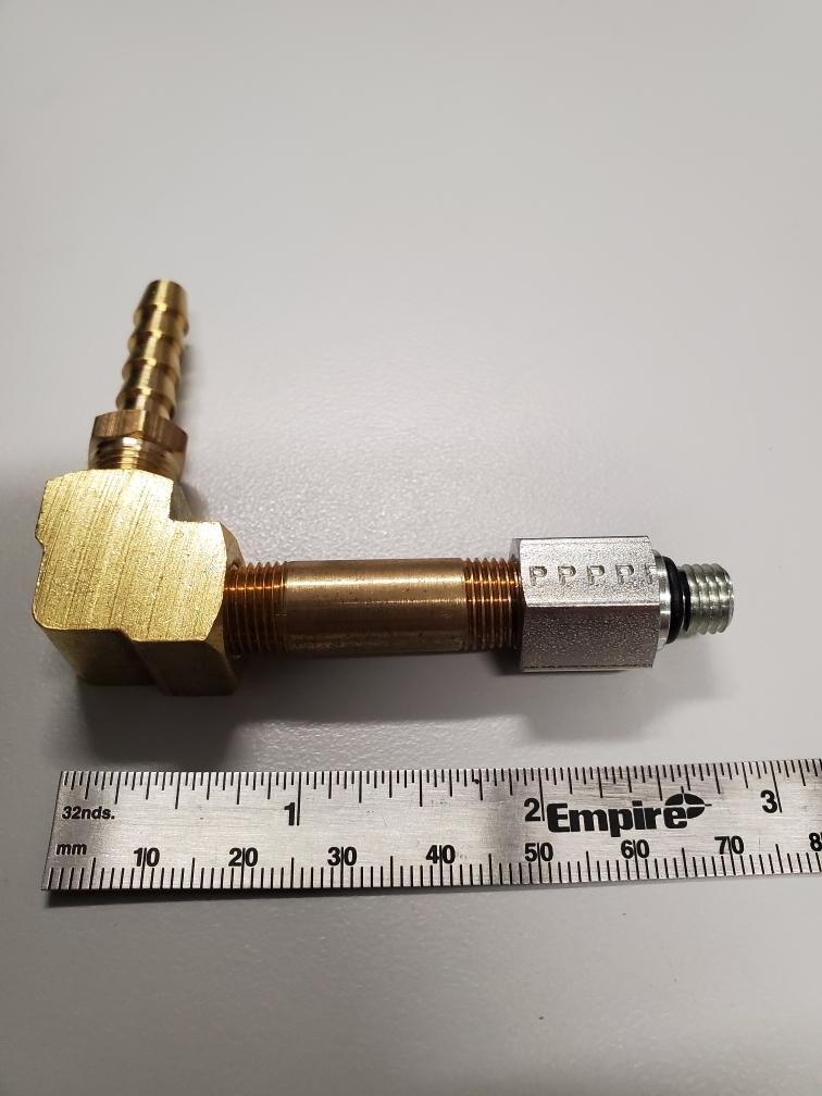

    Let me tell ya...all of you...Thank You all....I’ve got a neighbor that retired from Ford Dyno...he was able to put this together for me..should be in my hands
    by Friday..I think this will be perfect. I’m gonna try the hard line first..if it gives me trouble, barb fitting and a section of rubber line it is...

    That's perfect man, that will work and give you no trouble.
  12. Looks like you've got it! Not exactly what you initially "ordered" but it gets the job done.
  13. 2OLD2FAST
    Joined: Feb 3, 2010
    Posts: 6,062
    2OLD2FAST
    from illinois
    As long as you can " clock" that , it should work ...

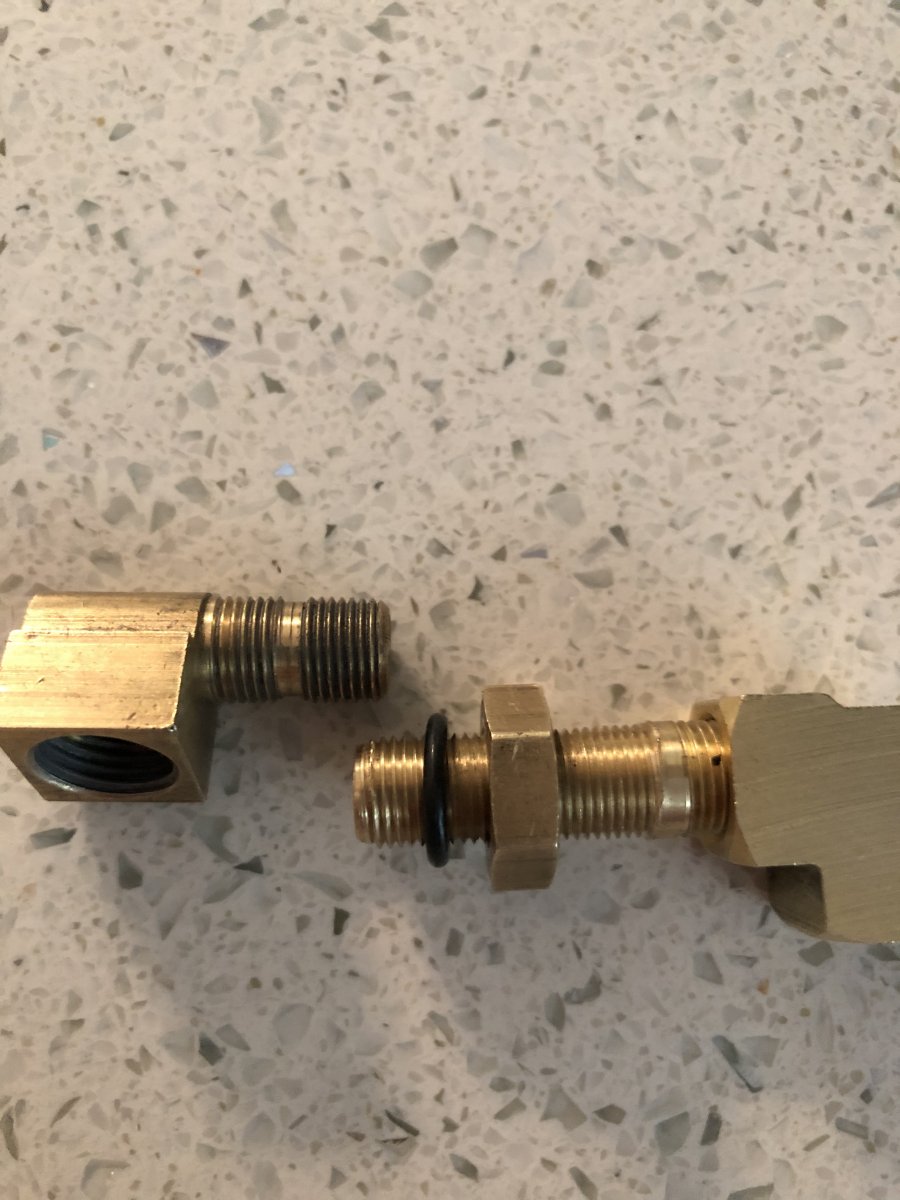

    7B8BBEE9-83E5-4A0C-948F-9F11DEB5232C.jpeg So...the guy had to tweak it a bit due to the wrong size fitting...so my question now is..this o ring isn’t going to stop this from leaking will it?? It needs a groove to sit in..1 step forward..10 steps back...
  15. 2OLD2FAST
    Joined: Feb 3, 2010
    Posts: 6,062
    2OLD2FAST
    from illinois
    Hmmmm , no way to seal those straight cut threads .....

    Countersink the br*** nut so the O-ring sits into the nut.
    Tman likes this.
  17. 2OLD2FAST
    Joined: Feb 3, 2010
    Posts: 6,062
    2OLD2FAST
    from illinois
    Still won't seal the threads ...

    Thinking O ring, washer and screw it in the case..

    Go back and take a second look at post #44. Clean and simple.

    Well...I went for it today..I found a washer that fit between the o ring and the jam nut..I used some Teflon tape and it went right on and fit like a glove. My ground down wrench did the trick for the jam nut. I’m crossing my fingers it doesn’t leak...

    Bonded washer (Dowty seal is a brand) will seal what that o ring won't!

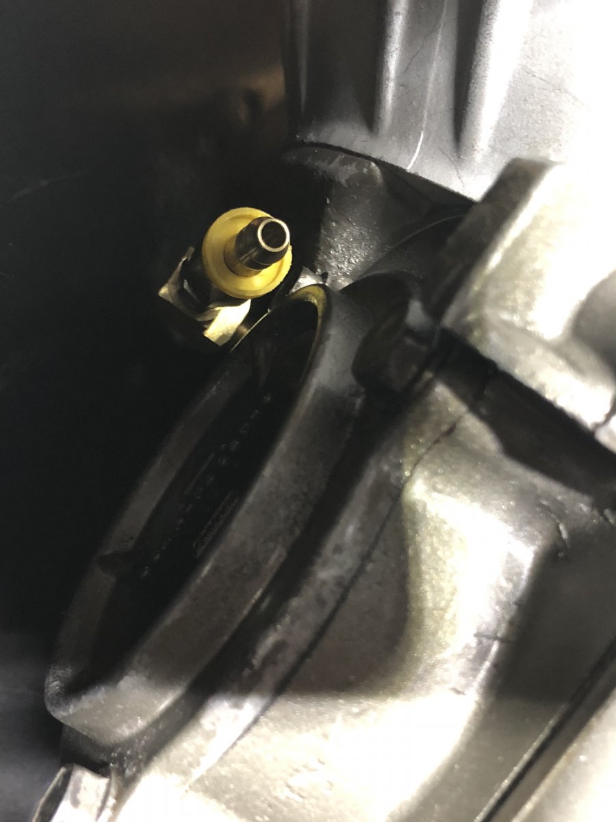

    On my pan fill C4 the fitting goes in on top of the servo cover. I bought pre bent lines , Made lines, no way I could get a Line over that servo cover due to headers, tunnel, basically you would be working blind and if you can tighten a nut up on top of and over that servo cover..you are way better than me..lesson learned..next time the trans lines will somehow go on prior to the trans going all the way in.
    basically what I needed was a way to get the fitting into the case easier and a way to get over this servo..now all I need to do is run a piece of rubber line to my hard line and it’a good to go

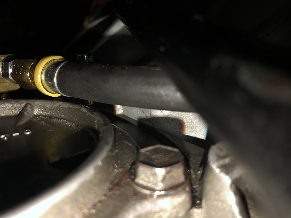

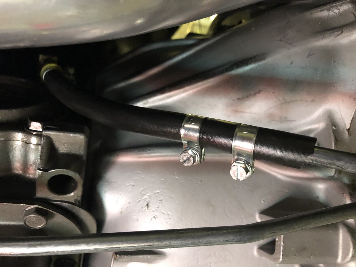

    Went together like a dream...I didn’t wanna fire the motor by myself...hoping it all holds together and doesn’t leak... 4FDAD256-D844-4FAB-8668-FD0F2E96FBD3.jpeg 7F940CA0-E981-4731-871A-F65BBADA0398.jpeg

    Do you have a bulge in that hard line with the two clamps on it?

    Turn one of those clamps 180 degrees from the other and they'll clamp better.
