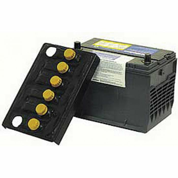

    Wrap it in black shelf liner and put decals on it and a fake battery topper.

    @DDDenny , When I moved the battery to the trunk of the 442 I bolted down an empty batt case and a fake topper (complete with posts and cables that dont go anywhere) to the original batt mount. I have a couple quarts of oil in there, a funnel and a rag.

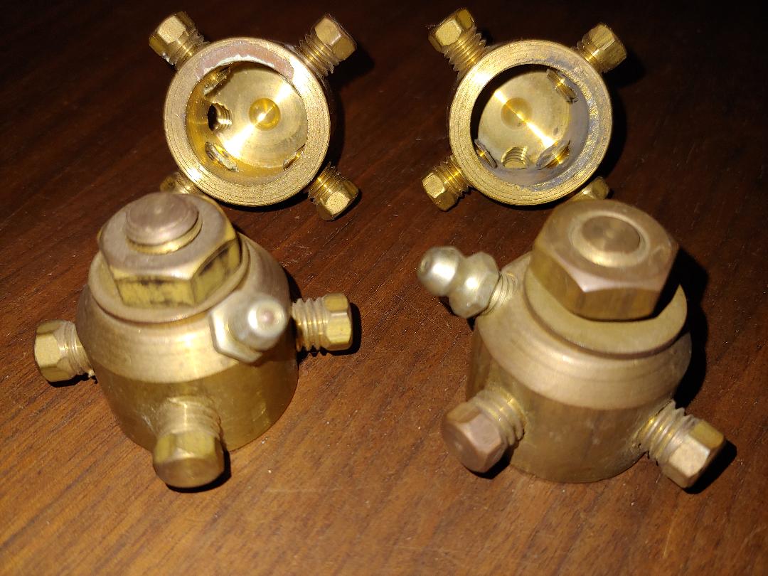

    These are the only things I've seen prevent corrosion on battery terminals. Yeah, those are grease zerks.
    batteryterminalgreasecaps.jpg :D
