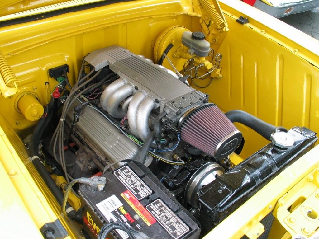

    I put a SBC TPI in my 62 2dr wagon......... with a mustang IFS. Looks/works great!
