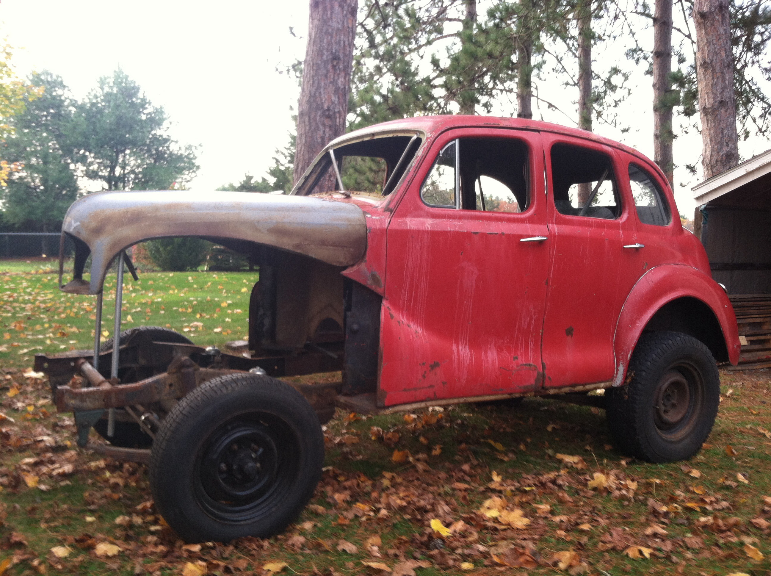

    I have a A40 4 door , been on my to do list . But to many other projects have ****ed in line. I am thinking I should sell it to one of you young guys. Leon

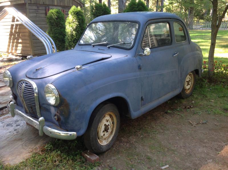

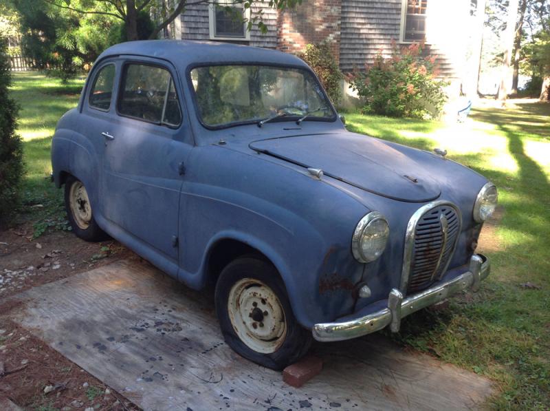

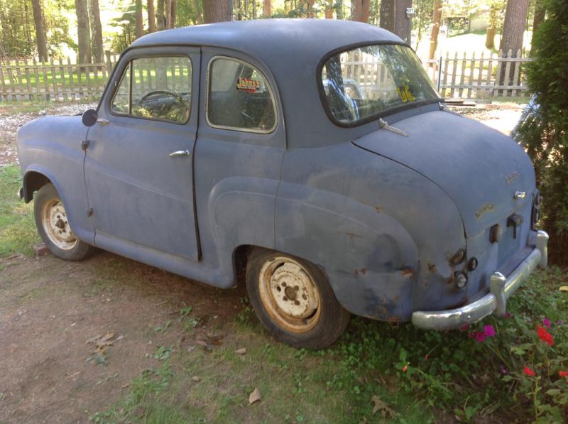

    I bought this one for a project, but don't know which way the build will go, so I haven't started a build tread as yet. May not end up H.A.M.B. friendly, you know?

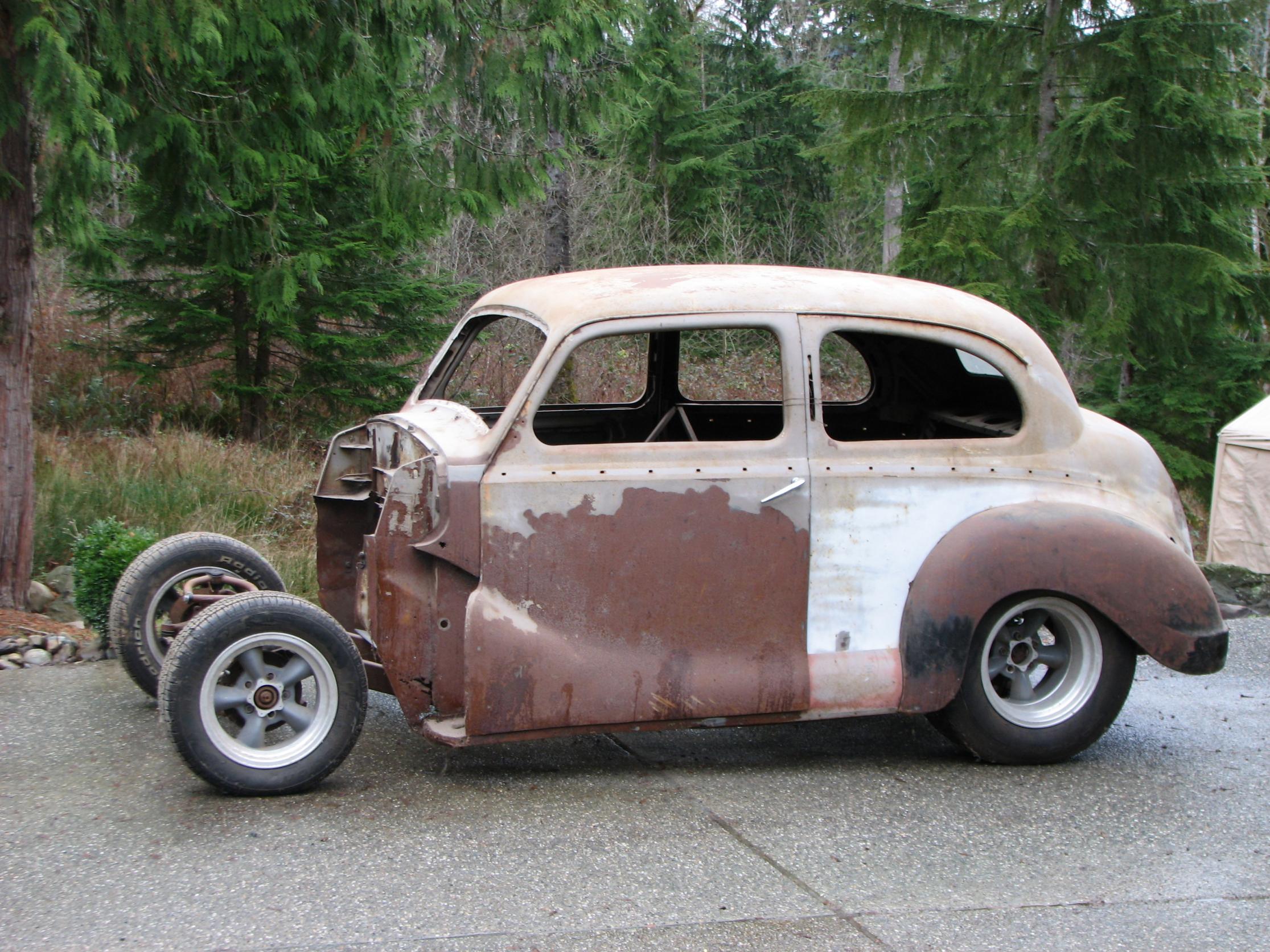

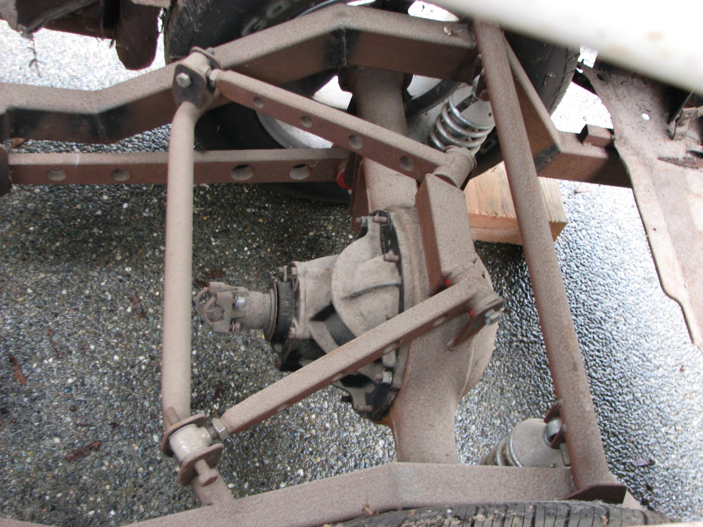

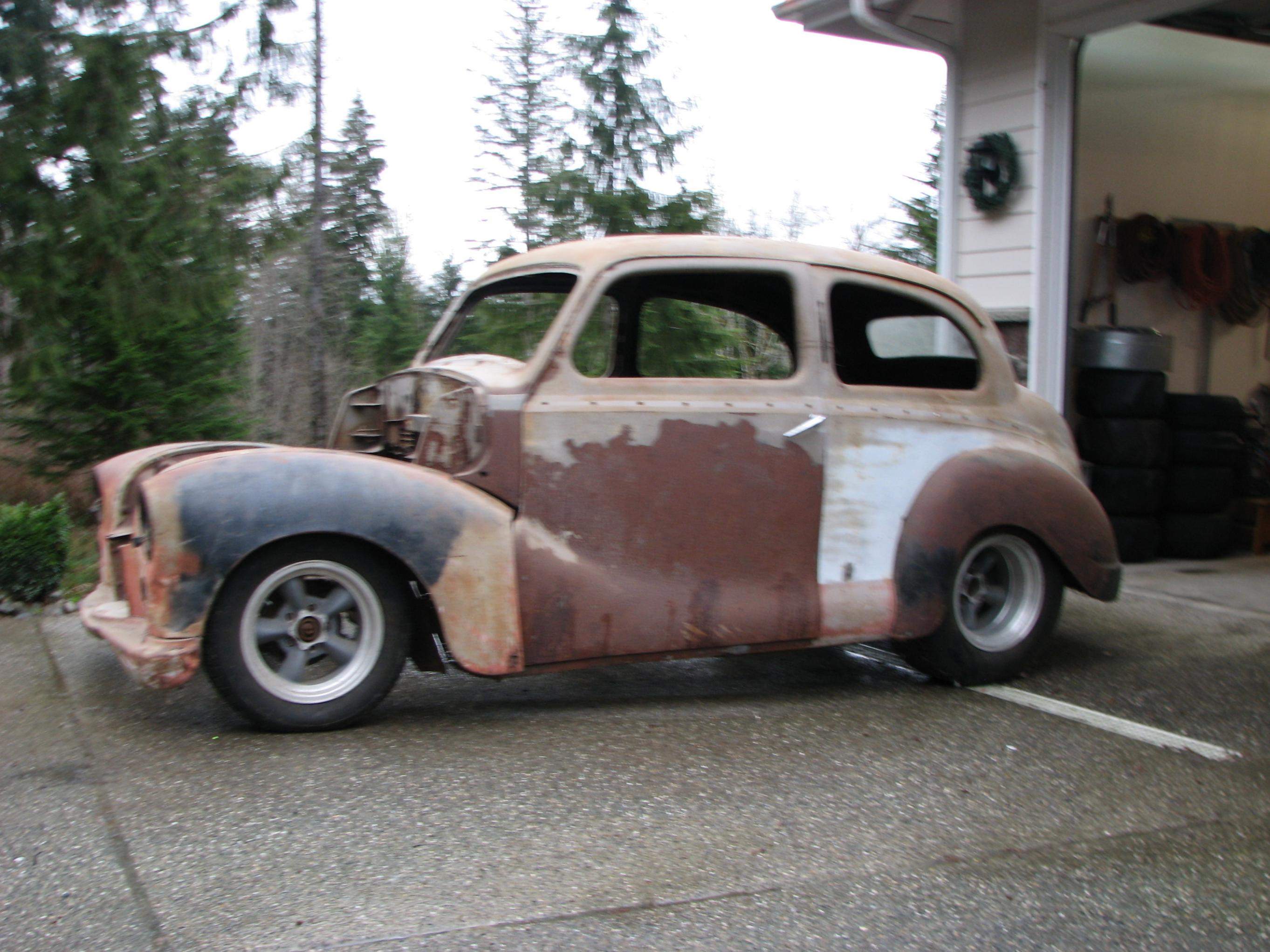

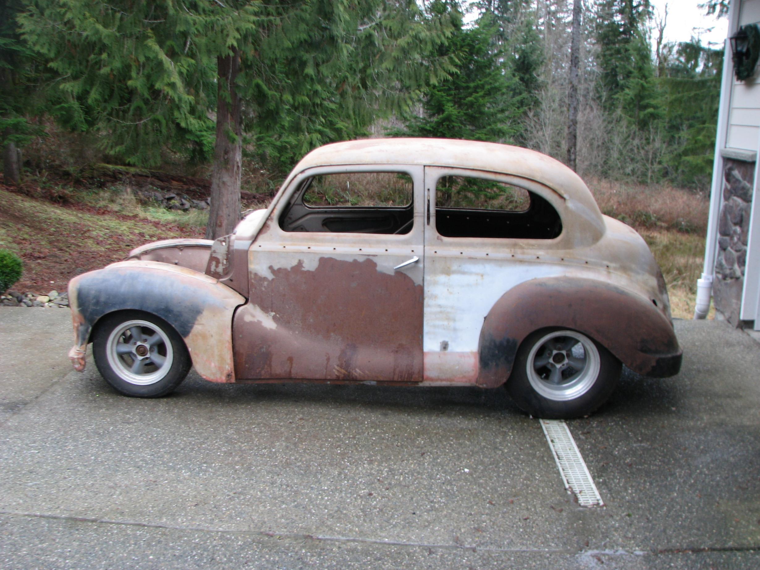

    Here's my Dorset. Project has been on hold for a number of years. Time to get going again here real soon on it. 2x3 ch***is with a arm front (one offs) narrowed Pinto rack, 9" with triangulated 4bar and coilovers. Setup for SBC/TH (going to switch to PG though). Planing on 10-12 pt cage with FC hoop. Thinking injected 406 for power. Nice clean consistent bracket car.
    Would love to trade though for a similar shape/stage tube axle A40 Dorset or PU.
    Just putting that out there!!!!

    Here's a few more pics. A couple with some front sheetmetal on it.

    Love this one as it's soooo small! What year and model is it?

    "Love this one as it's soooo small! What year and model is it?"
    I love it too ! My parents had one all throughout my childhood, same year, make, and model; even the same color. When I bought it and had it delivered, opening the door and smelling the interior just flooded me with memories long forgotten.
    It's a 1958 Austin A35.
    Since first posting, I've picked up an early Ford engine and four speed transmission, along with a narrowed Ford 8 inch rear end for it. I guess that it WILL end up being somewhat H.A.M.B. friendly after all, but I don't think that I'll be able to turn it into a real full-on G***er. Kinda depends on what I can gather up extra to spend on it, you know?
    Thanks for you interest/comment !

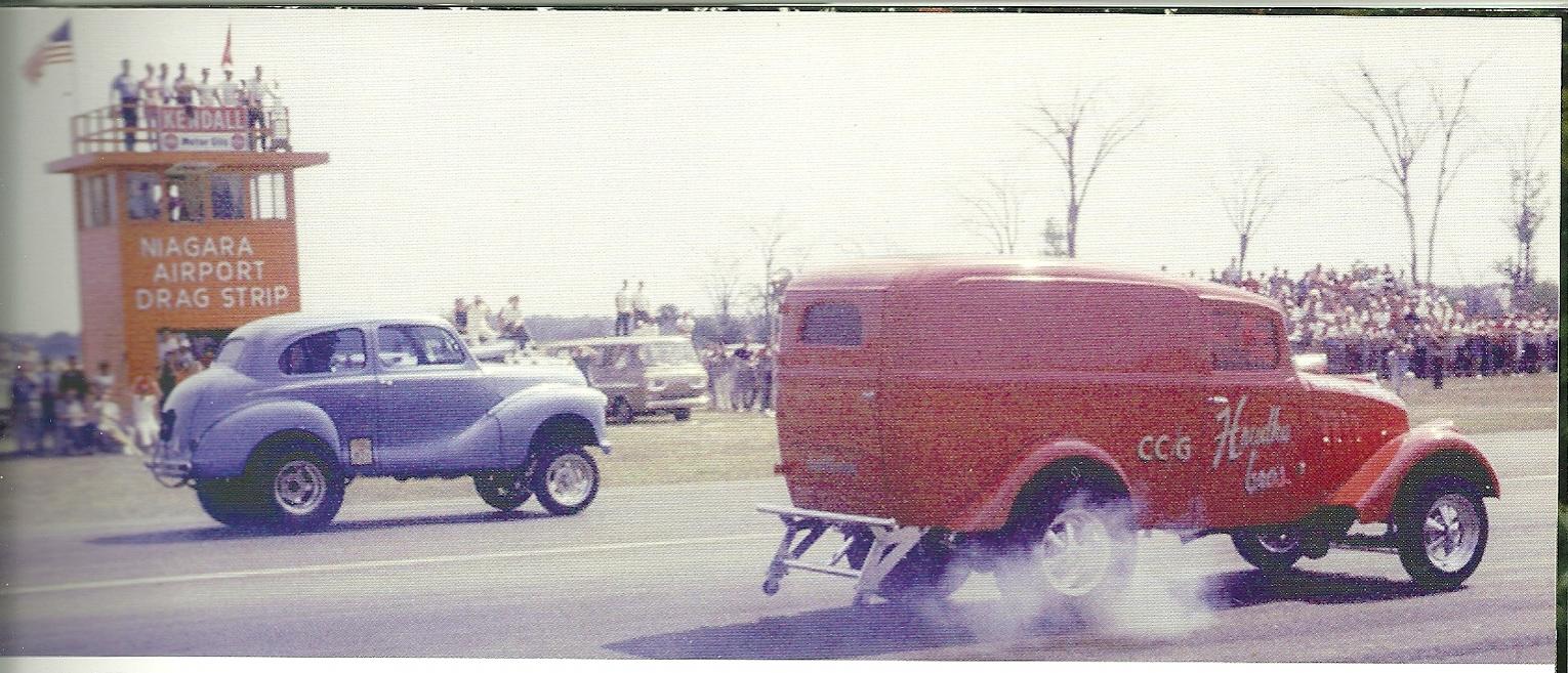

    Okay, I don't have one of these.... Yet. But I have to say that an A40 is high on my list of serious wants. Ever since the issue of Rodder's journal with the Oddy car came out, this picture has made feel strange yearnings... Really strange even more so, 'cause I'm not a "g***er guy", I usually like stuff low and able to corner hard.

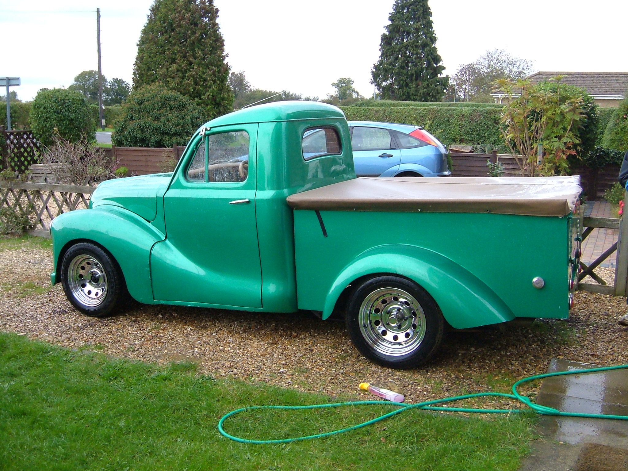

    Well 5 years later starting to make progress, building to run in the G***er circus in UK. Ch***is is now built with 40" ladder bars to 9" on coilovers, 40" wide tube axle being made over xmas as original willys too wide. Found that my Pontiac engine has water damage to bores but scored another freshly machined block, and a blower. Got a build thread going on UK NSRA site seh 002.jpg seh 003.jpg

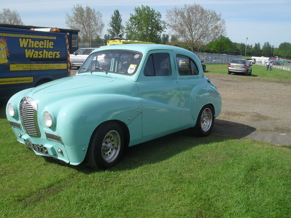

    Heres a pic of my near niegbors Austin somerset, been given the cl***ic UK hotrod treatment with a Rover ( Buick 215" ) V8 and a Jaguar back axle. Also has a steel flip front. SDC11483.JPG
