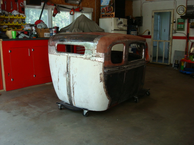

    Here's one I'm building. Front half of a 2 dr sedan already had been cut when I got it. I had a pair of '29 sedan quarters that had been given to me, used these to make the extension, and a PU rear panel I picked up. Set it on an AA frame so the back fenders would look right and also will support all the bed and allow me to put a back bumper on it. Will run it full fendered. Don't look at the engine. Joe.
  21. I' ve never seen an extended cab pickup body done from a coupe or sedan I really liked, although the above one doesn't look bad.
    If I was going to do one, I'd get a 4-door sedan body, stretch the front doors 10-12 inches, and cap the back the same way they did in the '40s with the back piece to the body. We had a '31 Plymouth tudor someone made into a pickup, the doors were a lot longer, and even though it had sectioned itself with the rust over the years there was still plenty of room for me to be comfortable in it - which I wasn't in my complete stock AA on the stock seat.

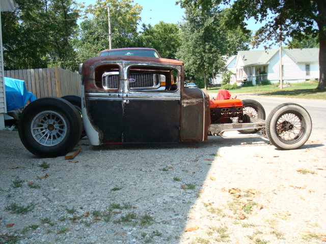

    not the best shot....
    it was a 29 coupe, the back was cut off ( the 1/4 s went to a good home)
    the 1/4 window was shortened, and a new back was fabricated.

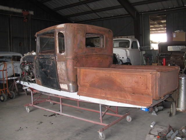

    A fordor is a lot easier to do than a coupe. This is our TR but an A would be no different.[​IMG]

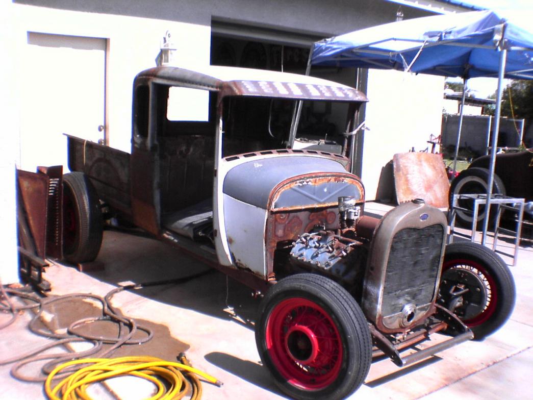

    Here is my take on a 5 window pickup, it is from a pile of parts aquired from some of my hamb buddies. A 31 model a cowl, 4 29 briggs body doors, some crappy coupe quarter windows, a 51 ford sedan roof for the back half and a 67 mustang gt hood for the roof. I have been schemeing with Plowboy on a wild bed!! I have more pics in my album, i might just start a post with the step by steps, hope ya enjoy,
