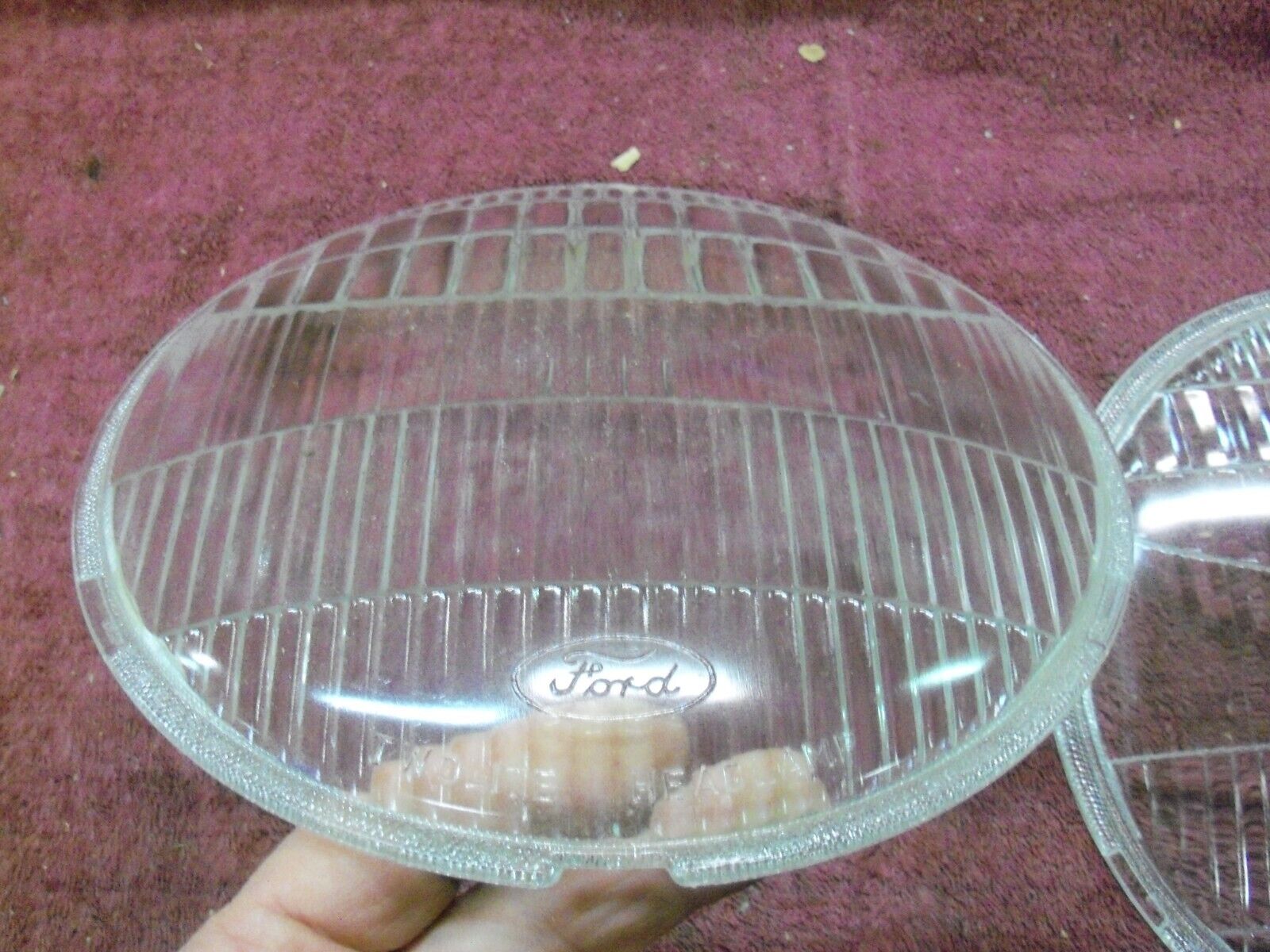

  12. Not sure about the buckets but original lens will have Ford on the lens. HRP

    Thanks all. Seems my question has been answered by the lack of Ford script on either the buckets or glass. Helps me describe them properly. Didn't want to improperly claim them to be original if they aren't. Not sure what that does to the value.

    yes, and they are glass, where as a lot of aftermarket ones are a type of plastic/resin ?
    If you can’t tell if they are glass - do what I did to my one and only spare one a few weeks back.
    While taking it very carefully out of the attic, I put it on the shelf and as I turned around, bumped it and it smashed to pieces on the concrete floor…….….….….…:eek: …………yep, 90 year old glass shatters quite easily !
