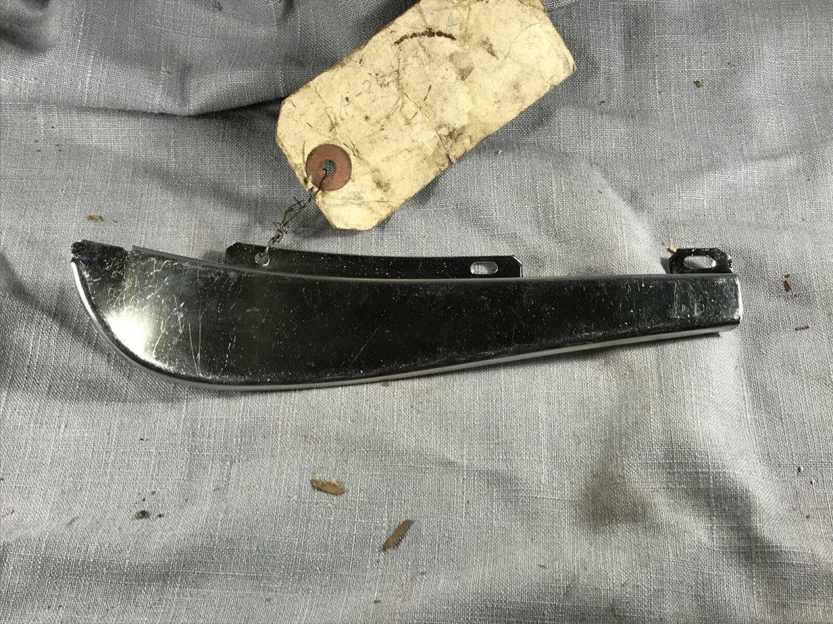

    Since we had a unusually warm day and there was no rain in the forecast we decided to leave the shop & drive the '54 wagon to Dillard, Georgia to use a gift certificate to a upscale restaurant our granddaughter gave us last Christmas, we drove a little over 150 miles, I had the drivers window down and to be honest I haven't drove the car much with the windows up or the vent window closed.
    On our way home the temperature started to drop when the sun started to set and when I closed the vent window the whistling started, oddly enough the passenger side makes no noise at all.
    When I was restoring the car I installed new pivots along with all new vent window rubber, anyone else have this problem and have you figured out a cure. HRP

    Dana, the car actually came with small screw on deflectors and when I was restoring the car I chose to leave them off, I just thought they distracted from the looks of the car but it might worth he effort to find them and give them a try, they may very well be the reason Ford installed them in the first place. HRP
