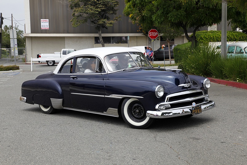

    Joined: Feb 12, 2009
    Posts: 75
    Johnny La-Chingas
    Drive it till the wheels fall off than replace it with a 235.. My 216 in my 51 coupe won't die so I just stay in the slow lane, they are good motors!!
