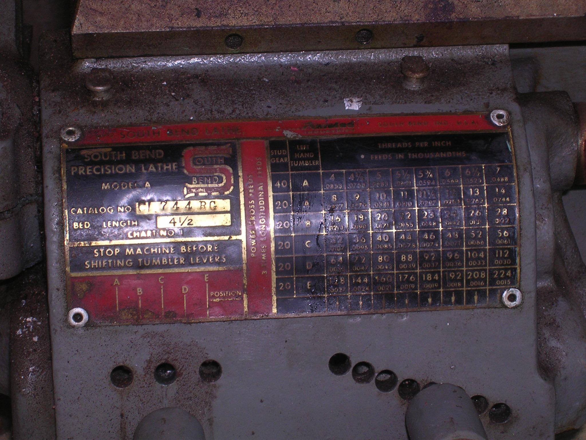

    I put up some pics. One shows the chart to make threads. The first row in the chart says to use "Stud Gear 20 or 40" depending on which thread-per-inch. Then use the quick change.
    Can anyone tell me which gear is the stud gear? Pic of side gears shown. There are 2 gears stacked together at the very bottom where that cleaner nut is; the outer gear is doing nothing and is 40 teeth. A 20 tooth would be just over an inch, so i am lost....and in the spare gears, there is no 20.?

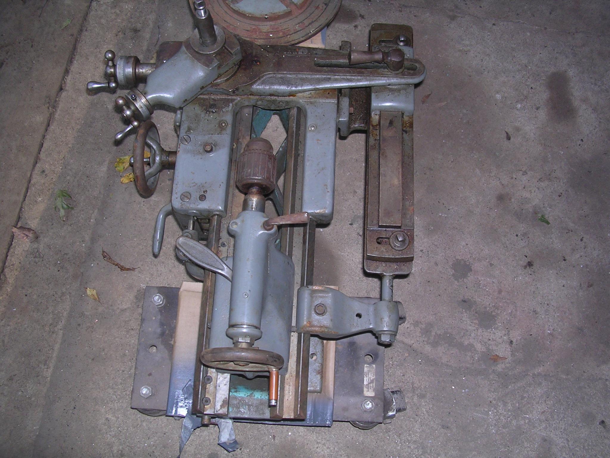

    Also, it has a taper attachment that I know nothing about.:confused:

    see the two gears at the bottom? one is in use (the 40 tooth), the other is not being used (the 20 tooth). You just swap these gears, and slide the idler towards the stud gear, to change them.

    The stud gear is the outer one one the forward/reverse lever the contacts the next gear lower on the banjo. What is the spindle bore on that lathe? 7/8 or 1-3/8th ? The normal gear on the input to the Q/c is 40 teeth. Just have been working with this putting a Q/C back on a SB light 10.

    Thanks HAMB, I am all set now. Time to make some chips :)

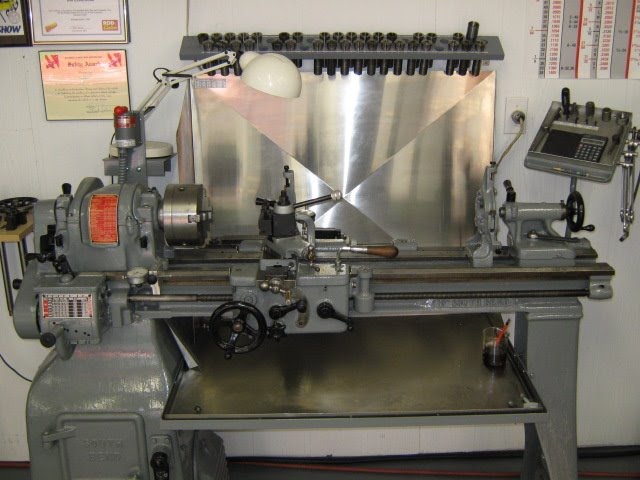

    Here is a picture of my Heavy 10.
  15. squirrel
    Joined: Sep 23, 2004
    Posts: 58,536
    squirrel
    There's something wrong with that lathe. The chip pan is empty :)
  16. baker53
    Joined: Jan 17, 2003
    Posts: 329
    baker53
    If there was one thing I learned from a tool room machinist I knew it was to keep the shop and tools spotless and I have never failed that lesson. The stuff in the shop gets used a lot, but it is always cleaned after a job. I know lots of folks can't or won't work that way, but I'm not one of them.
