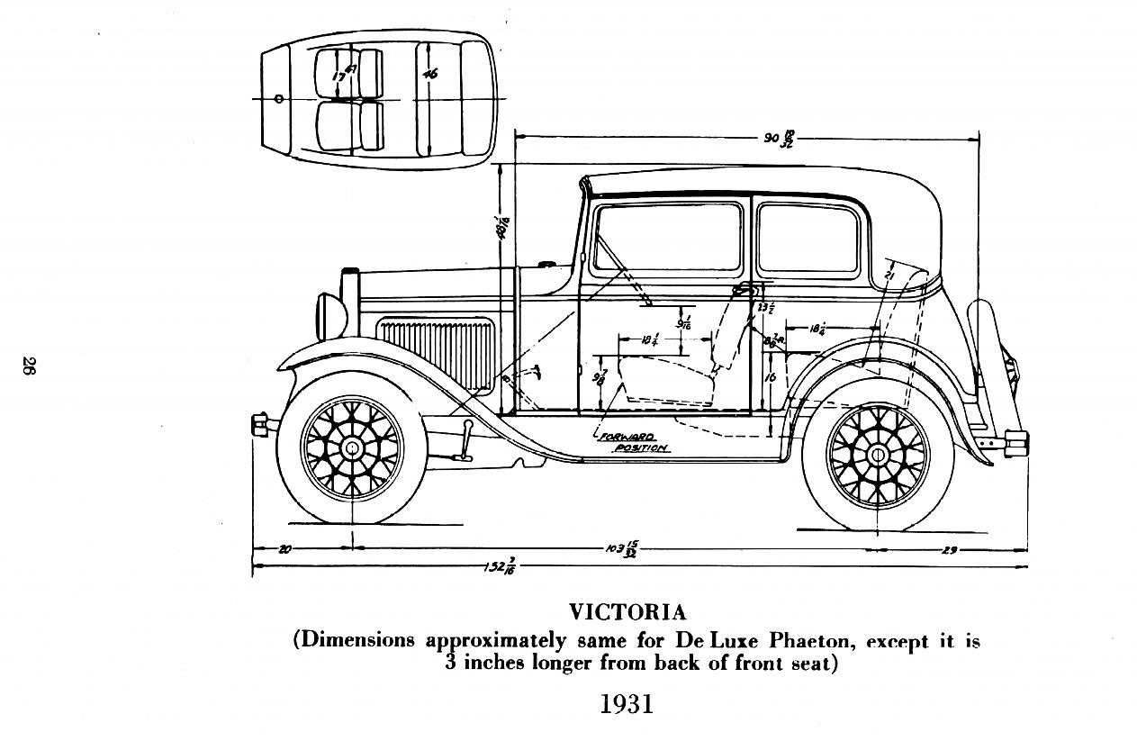

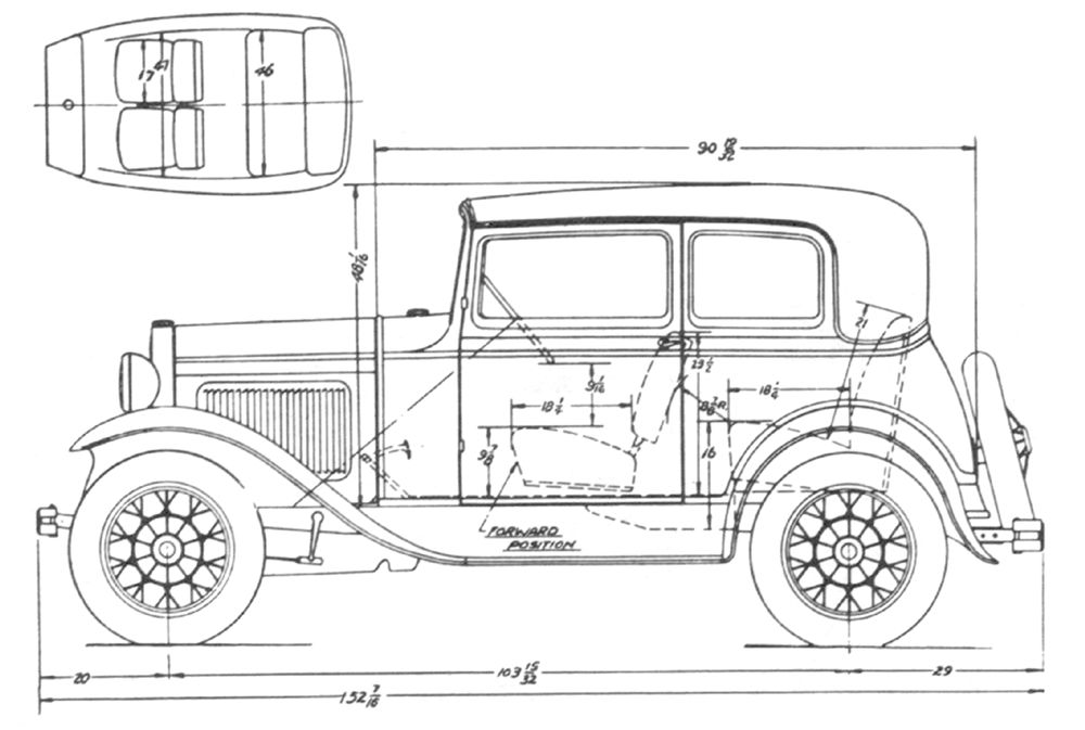

  8. You did say without modification then you are limited to a FG TP body if its a bolt on your looking for.
    Let me qualify my earlier statement, Your TP chassis is actually longer than a Model A wheel base, dependind on which TP chassis you have, it could be up to 11" longer.
    The "A" frame is the same no matter what body style it was under, coupe, vicky, 2d, 4d, and phaeton. The Vicky fits on the TP chassis, I chose a different route but it fits,
    That NEWER TP body the tangerine one has the same seating position as the vicky,
    I know that the 31 vicky fits on the tp chassis, and if all a frames are the same then I can tell you that anything from 31 down to 23 will fit,
    THIS IS NOT BOLT ON but the dimensions are extreemly close and in line.
    Start measuring your frame and see,
