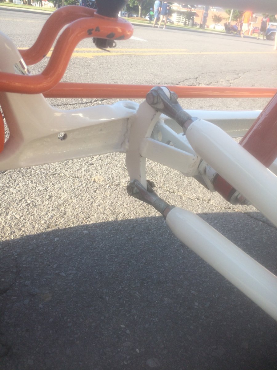

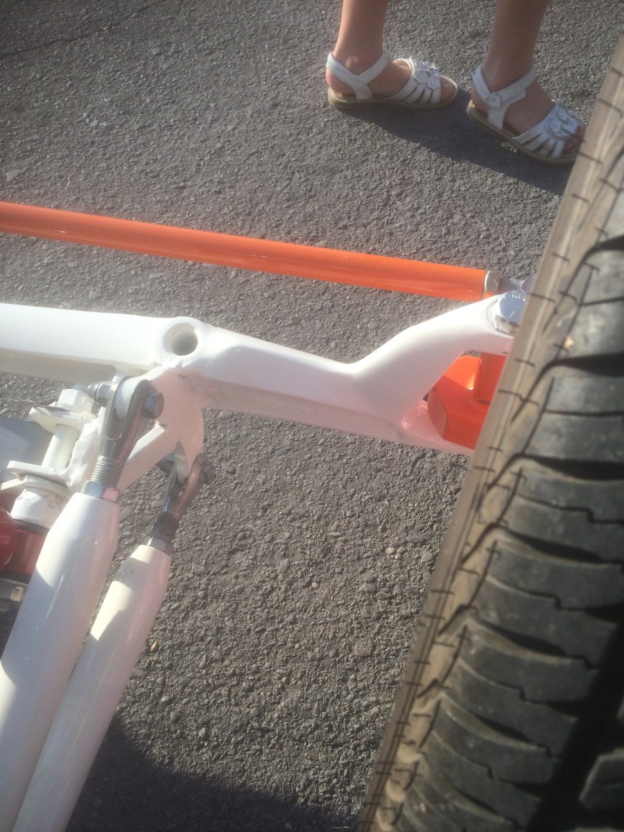

  1. Seen this modified T axle
    Any thoughts?

  3. Interesting...................
    I wouldn't trust my life on that weld. Just sayin....

  6. I didnt want to flame the guy, he seemed cool but there is a serious safety issue here
    the car is neat and I like the T axle
    being a teacher, I use things like this for instructional purposes
    we are planning to set up a straight axle this fall
    a simple batwing mounted through the spring perch would solve this safety issue

  13. Batwing, yes over and done and everyone sleeps in their own bed.
    Cool, maybe,,, if he's cool he should accept a wiser opinion.
    I'm going to go out on a limb here, your hope isn't going to make anyone feel better, mend 'em up, heal 'em or bury 'em.
    I hope you say something, like ,,,,,, this is really neat, I like your vision on this and I'm going to guess you haven't ever seen one off these, (shows a clear pic of a bat wing set up). Here's how they work blah blah blah.

    ^^^ Obviously the owner has a lot of confidence in either his or someone else's welding and fabrication skills. I imagine that Ackerman angle wouldn't be correct either?
    lothiandon1940 and loudbang like this.
  16. yep
    ackerman is the least issue here though
    Mr48chev, lothiandon1940 and loudbang like this.

    The first thing that comes to mind is *********** welding as my Dad called it. The second thing is the song from The Mickey Mouse Club. I hope some one brings up the safety issue to the owner in a kind and gentle way before there is a bad accident!

    This fits nicely in the my friends been doing this for years or my buddies car drives just fine, or that's how it was done back in the day......obviously the owner knows nothing about hot rods, or the technology used in building one safely, it would have been a great thing to have explained to him why it was dangerous and how to fix it.
    Scares me that someone would even think for a minute that this setup would be strong enough to not endanger those around this car on the road.

    Does the dazzling "engineering" include
    custom spindles and spindle mount wheels ?
  25. nope
    stock looking T hubs with no brakes
    man I hope he upgraded the bearings

    imagine what would happen if that front axle had brakes
