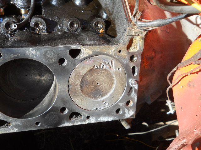

    That picture reminds me what I did years ago. I was swapping a new rebuilt quadrajet in My daily and it was running great and smooth Until I took off down the road and then bam bam. Turns out when I took off the old carburetor the bottom screw in the middle of the q jet dropped in the intake and it sat there until I went down the street. New valves and cleaned up the piston.

    That is a 500 Cadillac piston and the marks were from a screw out of a Quadrajet. I don't remember what screw though.
