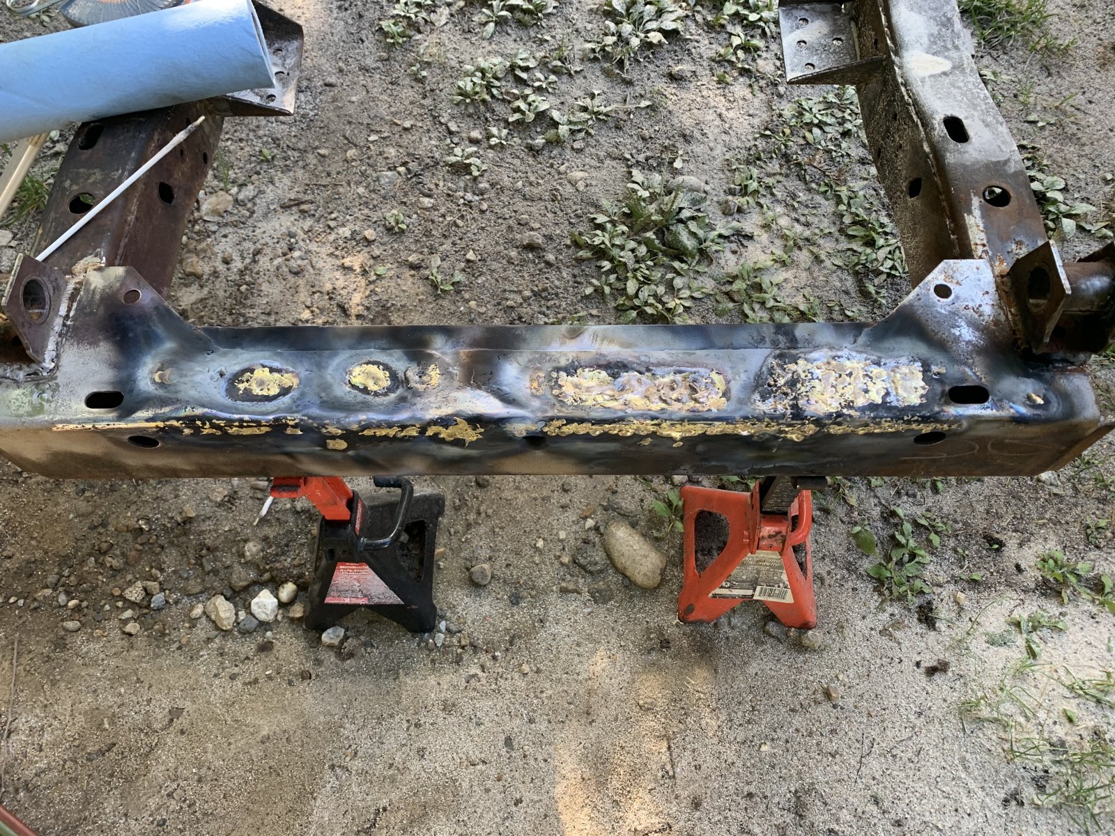

    I’m trying to fill in some heavy pitting on an area of a frame (front cross member) using some brazing rod. There is quite a large area with minor pitting, and it is proving a bit difficult to get the material to flow easily. I’ve sand blasted the area yesterday, so it was clean. Initially, I used my hearing tip thinking it would introduce less heat, but a section still got warped. Today I switched to a #2 tip which offers much better control of the heated area and puddle. There is also some pitting on the vertical surface which is also a challenge, but I have managed to get the braze material to stick without pooling into globs. The area which was previously warped, warped even more (long narrow low spot), and I’ve been adding more material to level it out which to have seemed to work. I think this area must be really thin from corrosion which caused it to warp like that. So far, I’ve gone through 4 rods and am wondering if there are tips folks can share. The reason I’m doing this is the owner of the shop which is going to blast and paint the frame said I couldn’t repair this area up front with body filler as it wouldn’t take the heat from his oven. He also won’t do any type of work to fill in the pitting. He will use epoxy primer and a top coat which I’m guessing will fill in most of the minor pitting. Is that correct?

    Gave a quick pass over with a flap disc this morning, and noticed the cross member is now about 1/8”bowed in two directions. This has now gone from bad to worse. Damn! Going to try to pull it out with the winch on my truck using a bit of heat as well. Although I have practically zero experience brazing, I’m really surprised at how much the cross member had warped. It looks to be about 3/32” in thickness. I will call the metal shop tomorrow to see how quickly they can bend me up a section so I can replace the affected area.

    The 11 ga patch panel should be ready this Friday. Also spoke to the powder coat shop owner. He said that he has had lead based solder melt when doing fuel tanks. Not sure if that is the same as body lead. He thought it would probably melt. Said oven temps are between 400F - 450F. He also said having braze material is fine as the epoxy primer sticks and the powder goes over.

    Cut out the affected section. It was actually pretty bad and had “caved in” about a 1/4” from the heat. It is no wonder that I had to keep adding more braze material. Thanks guys for pushing me to do the right thing. The stuff inside the frame is sand from the pressure wash sand blast attachment.

    Got it welded in yesterday afternoon. Patch panel wasn’t exactly 90 degrees at one end, so a bit tricky to get it to line up with the two surfaces. Will finish it off today. Frame is being picked up on Friday.
    All welded in. Added hole like original but couldn’t tadius it.
    After first pass with flap disc and some extra welding to fill in some of the uneveness.
