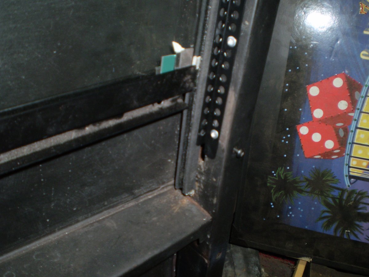

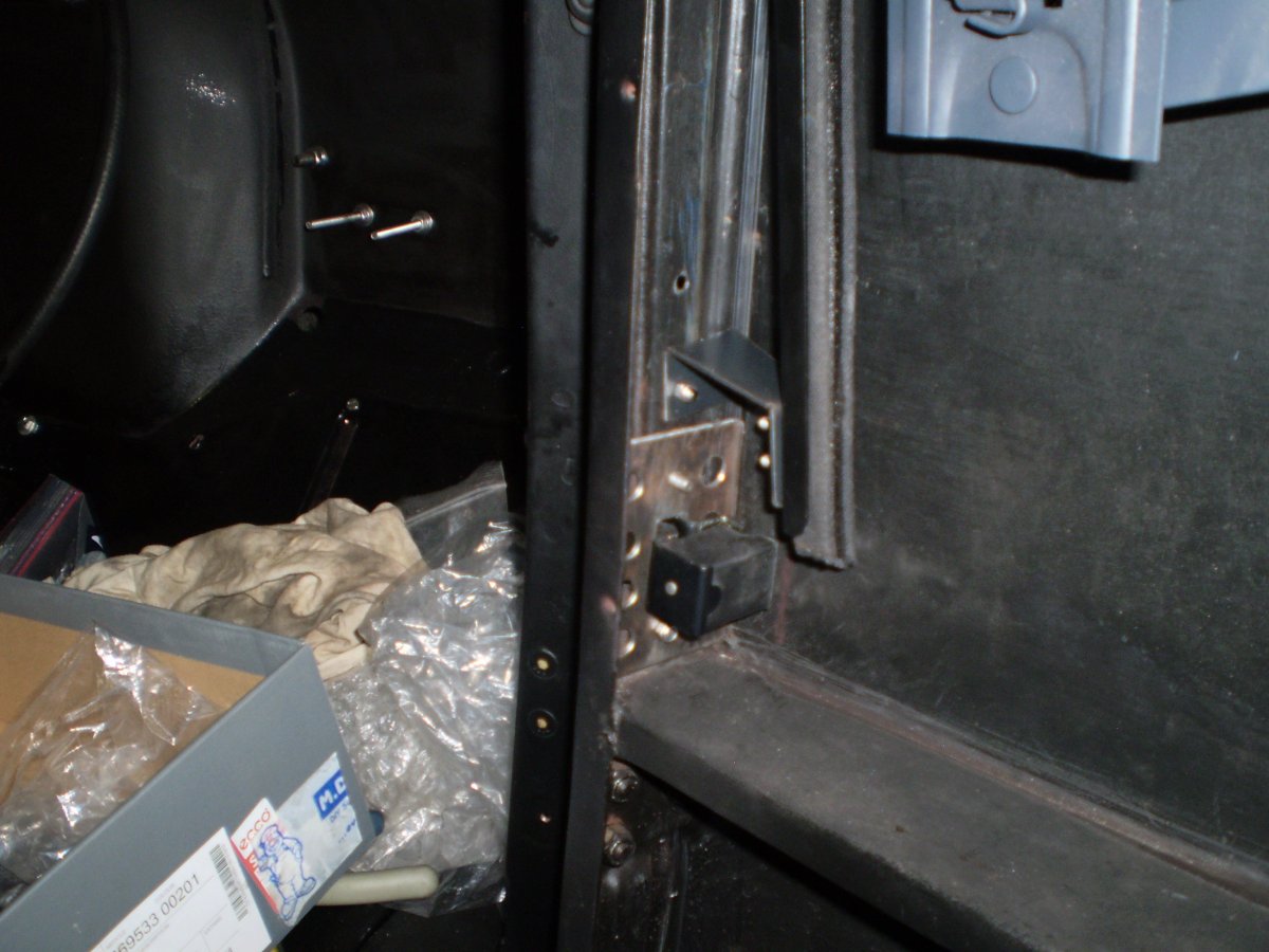

    door tracks pass side 001.JPG door tracks pass side 002.JPG well I had a fresh look at the set up this morning it soon came apparent what the problem was..i was trying to mirror image the drivers side door track.,the passengerdoor sustained damage where the door strap had pulled through the door and damaged the front of the door.i plated the opening on the inside and cut out an opening for the door strap tooperate and mirror imaged the bracket holding the track off the door.instead of mounting the bracket to the door I mounted it on the plate bringing the bracket an extra 1/8 forward making the opening too small for the glass..at the back of the door one of the tabs for holding the felt in place was broken off, I make a little bracket and riveted it on today I drilled out the rivets and pulled the felts away from the door.put the narrow piece of the glass into the front felt and fitted the rear of the glass into the felt.it fitted in easy.alls well that ends well.my tip forinstalling glass is if you are duplicating window tracks get it right
