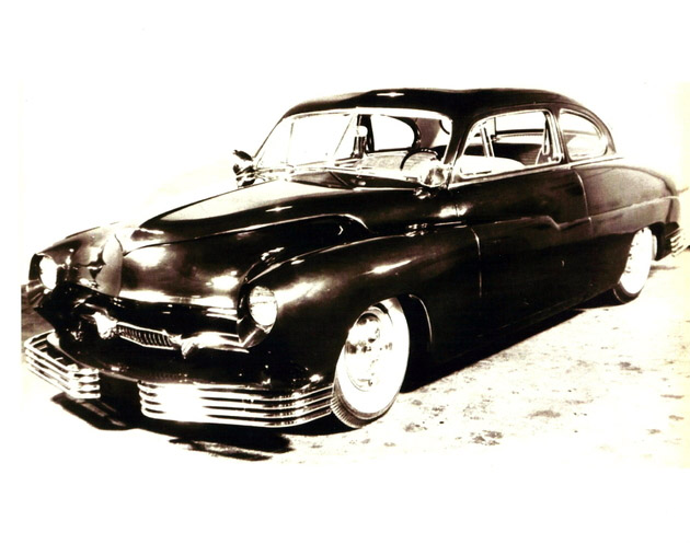

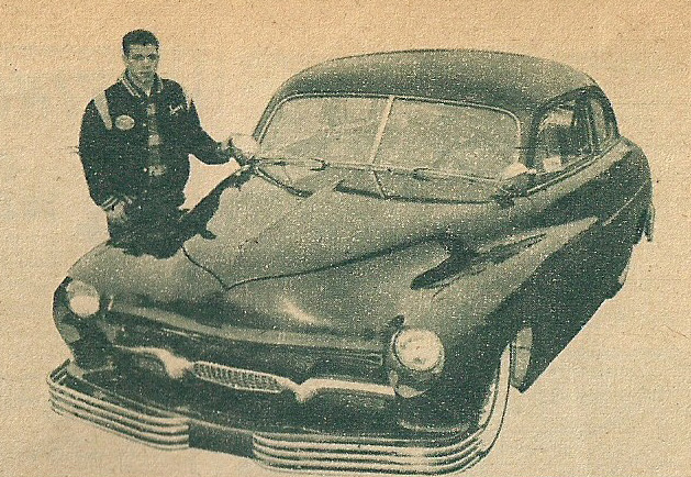

  12. From Kustomrama-
    Sonny Morris' 1950 Mercury
    1950 Mercury
    restyled by Bailon's Custom Shop for Satan's Angels member Sonny Morris of Hayward, California in 1956. The car is also known as The Blue Mirage, and it featured bumpers made by quadruple round-rods. Custom Cars September 1957 defined Sonny's bumpers as nerf bars, The rear bumper terminated in a pair of 1949 Fordbumper guards. 1956 Buick taillight lences were mounted horizontally in the rear, giving the Merc a totally new look. The car was shaved for handles and emblems and was push-button operated. The hood was peaked and a new Pancake opening was made. Heart shaped brows were welded on to the frenched headlights. The grille bar was from a 1956 Plymouth. The Merc was dropped by cutting the coils 1 1/2 inch and by installing 6 inch lowering blocks. The side trims were removed and dual Appleton spotlightswere added. Sonny swapped the stock flathead with a 1952 Oldsmobile engine connected to a Hydramatic transmission. The interior was done in blue and white Naugahyde by San Leandro Seat Cover Center of San Leandro, California. The body was painted Mirage blue once completed

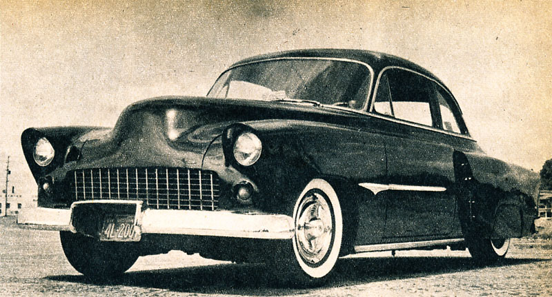

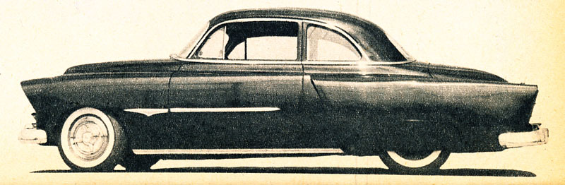

    Dick Katz' 1949 Chevrolet-
    1949 Chevrolet Sport Coupe restyled by Dee Wescott of Wescott's Auto Restyling in Portland, Oregon for Dick Katzof Dalles, Oregon. Dick's Coupe is a great example of a late 1950s custom built on a early 1950s car. The hood, deck lid and door handles were shaved and operated electrically. The side trim originated from a 1953 Packard. Dee extended the front fenders, and stretch the rear fenders as well. The taillights were from a 1955 Chrysler, slightly tunneled with parking lights located beneath. Aerials were placed on top of the fenders. A hand made bracked was molded to the split bumper to provide the needed opening to have room for both the license and club plate. The unique scoop in the quarter panels featured teeth from a 1954 Pontiac grille. Up front, the headlights rested under the shades of the extended fenders. A custom grille opening was made and fit with a 1955 Chevrolet grille. The license plate was deeply frenched by using the stock overrider. In order to get the right stance, it was lowered up front with dropped spindles and reworked A arms, and it was C'd in the rear. The car was also quite fast, sporting a 1957 Oldsmobile Rocket engine with Hydramatic
