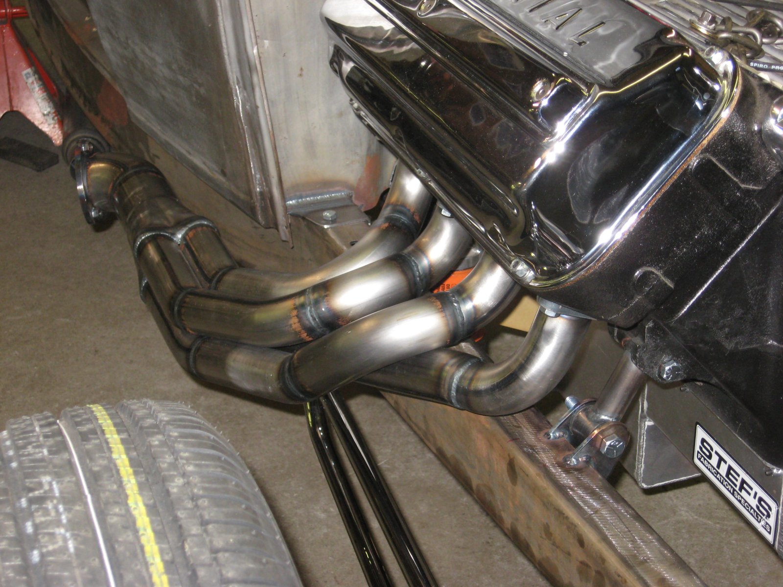

    I take it by Hemi, you mean Chrysler, as the early Dodges mounted off the timing cover. Here is a set of mounts with urethane insulators. Custom mounts like these could be fabricated with the ears welded to a plate and bolted to the boxing plates on your frame. I would form a 1/2" flange at the top of the plate to rest on the top of the rail, drill and weld 4 threaded bungs to the inside of your rails. Done properly with a Tig welder it could be done without burning the paint on your rails. IMG_0879.JPG
    RICH B and clem like this.
