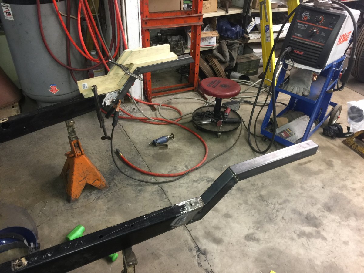

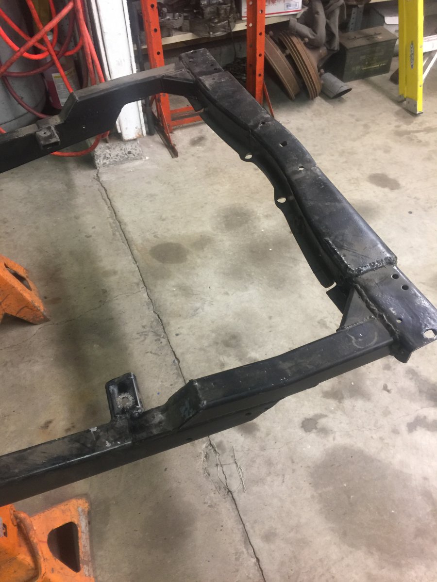

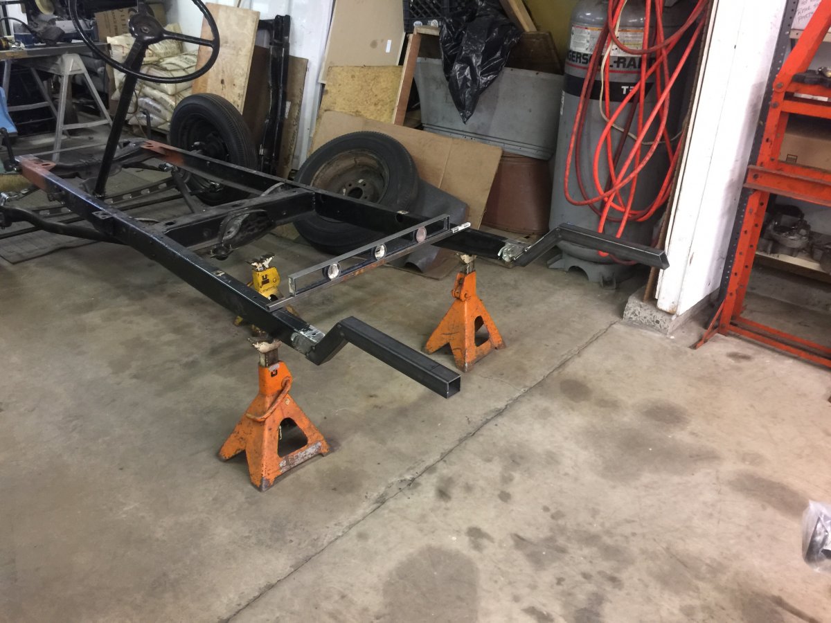

    Well, it wasn't the weekend but with the state closed because of the storm I worked in the garage all day yesterday and got a bit done.
    Since I don't have a frame table and needed to replace the rear section of the frame because of previous changes is was a good day.
    I made a jig to attach my frame sections to so they would be the same side to side. Leveled the frame and checked it for squareness through out the whole process.
    It's all tack together and ready to knock apart and weld up.
    Flattened 32/34
    Cut and cleaned.
    Jig on the left side.
    Mirror for the right side.
    I bolted in the transmission and rolled the complete rearend ***embly forward with the crossmember installed.
    I checked for square and straightness and tacked it in too.
    I have 5 1/2" between the axle and frame now, enough for suspension compression without the axle hitting the rail.
