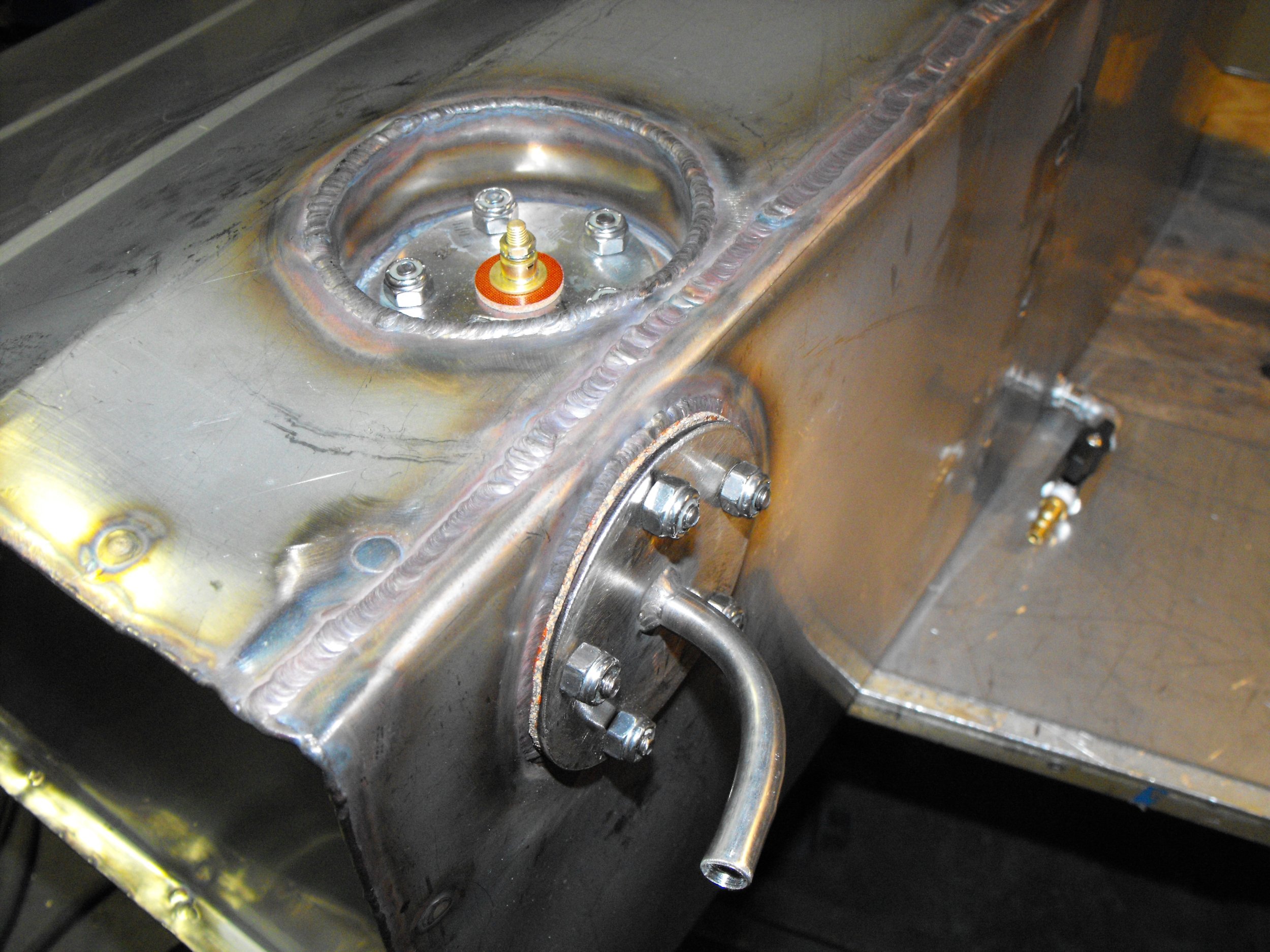

    A home made tank is typically flat sheet, folded, and edge welded. Definitely TIG weld as would produce the least amount of porosity (potential leaks). Working with galvanized sheet would cause trouble with the welds. Best to use bare sheet, and check into having it galvanized or sealed after (I am not a fan of sealers).
    I have made a couple aluminum tanks and they hold up wonderfully. This one is bout 20 years old and still looks brand new on the inside. A little trickier to weld, but basically the same amount of effort

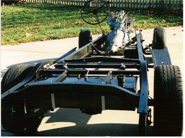

    I made this tank to fit in the rear of my Model A. I believe it is 18 gauge sheet metal, the same I used for body panels. I built a simple buck to fit it around. After I had it all built, I used a POR 15 fuel tank kit. It had a cleaner and then a sealer. It's been in the A for about 5 years with no problem. IMG_1457.JPG IMG_1458.JPG IMG_1459.JPG

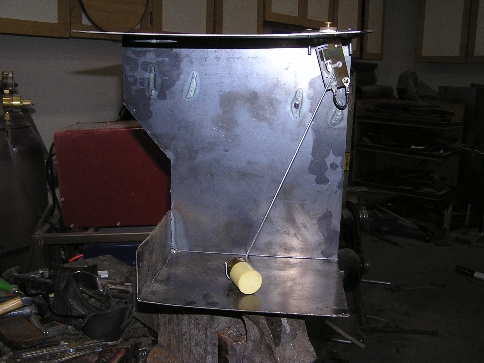

    I built a small one for the Mysterion project.

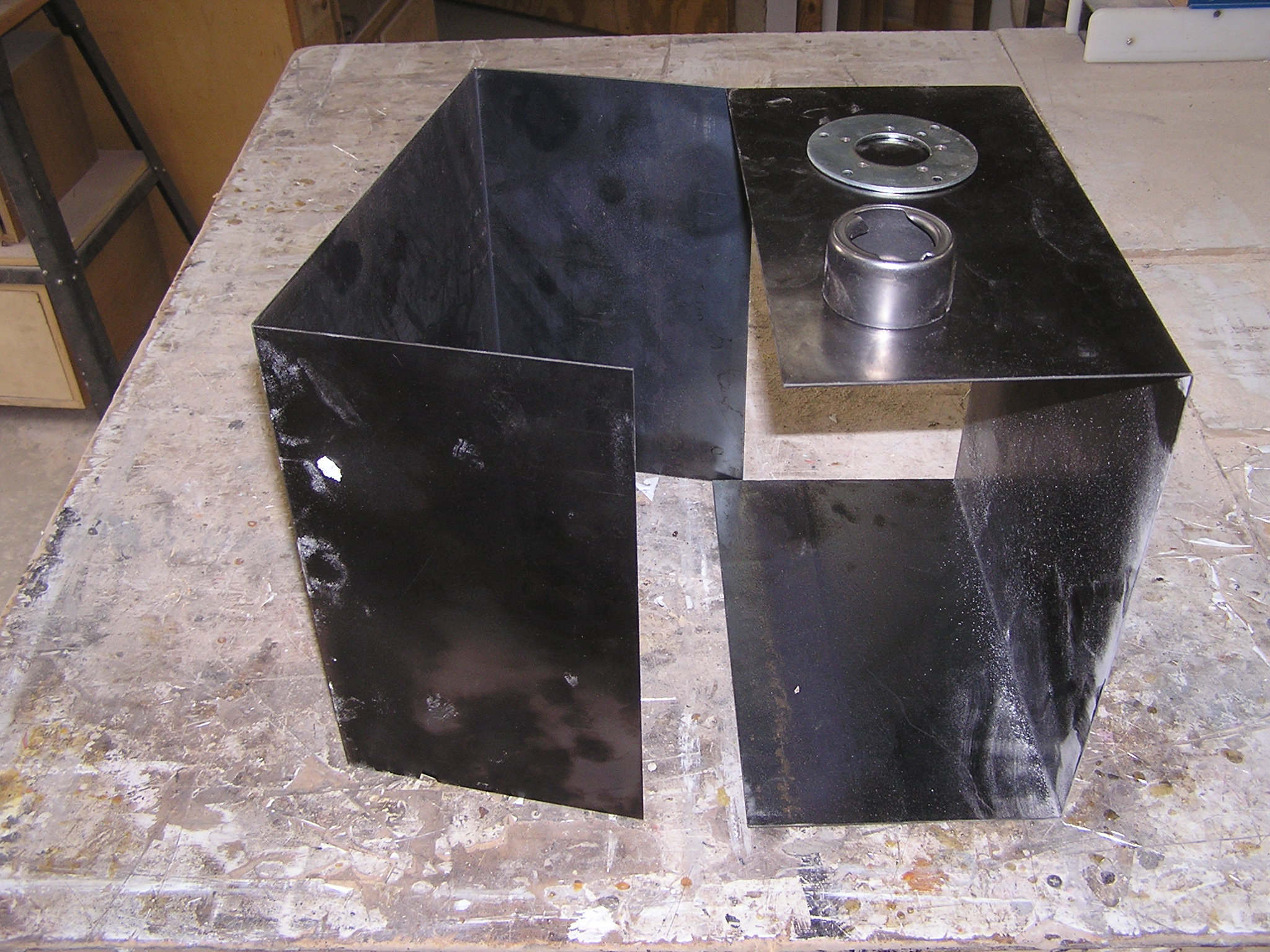

    I made this one 25 years ago, 14 gauge plain old steel, mig welded, 18 gallon. No problems with rust in the fuel, filter is always clean. Heavy enough steel to take a hit I hope. Filler is in the bed floor. I had to stand on it while tack welding the shell together, and even then I wasn't hardly heavy enough to hold it down, 14 gauge is really thick! Two baffles inside splitting it into thirds. Pressure tested, holes marked, welded, pressure test, etc.... till it held air over night.
