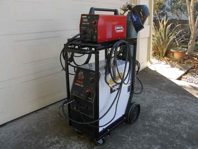

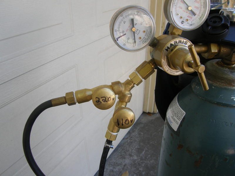

    I wanted to save my Hobart Ironman for heavy welding. I use .035 wire in it. I bought an Ebay 110 Lincoln and run .023 for sheet metal. I installed a 'Y' valve so it's just a turn of the knob to switch gas between welders. Works great!

    @evintho I run the same exact valve on my setup, but I just leave both valves wide open. The solenoid on the welder that's not being used is closed anyways, so it's the same as manually closing the valve. As long as you purge both welders at the same time when you swap a tank you are good to go.
    To the OP, one option you could consider is a second tank as a spare. Especially works good if you stack the welders and have them share a tank. I spent the money and got a second tank of the same size so I always have a spare on hand. Expensive for sure, but it beats running out of gas Friday night and having to wait till Monday morning to get more. The theory of this hobby being a money saver went out the window a long time ago, so whatever tools makes it more enjoyable / easy is usually the route I go.
