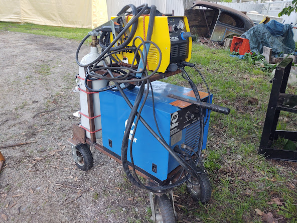

    My Miller is setup for .030" wire, and I weld everything from thin sheet metal to heavy steel and just adjust the temp and wire speed to do so. Never used .035 or .023 wire, and never felt the need to do so.

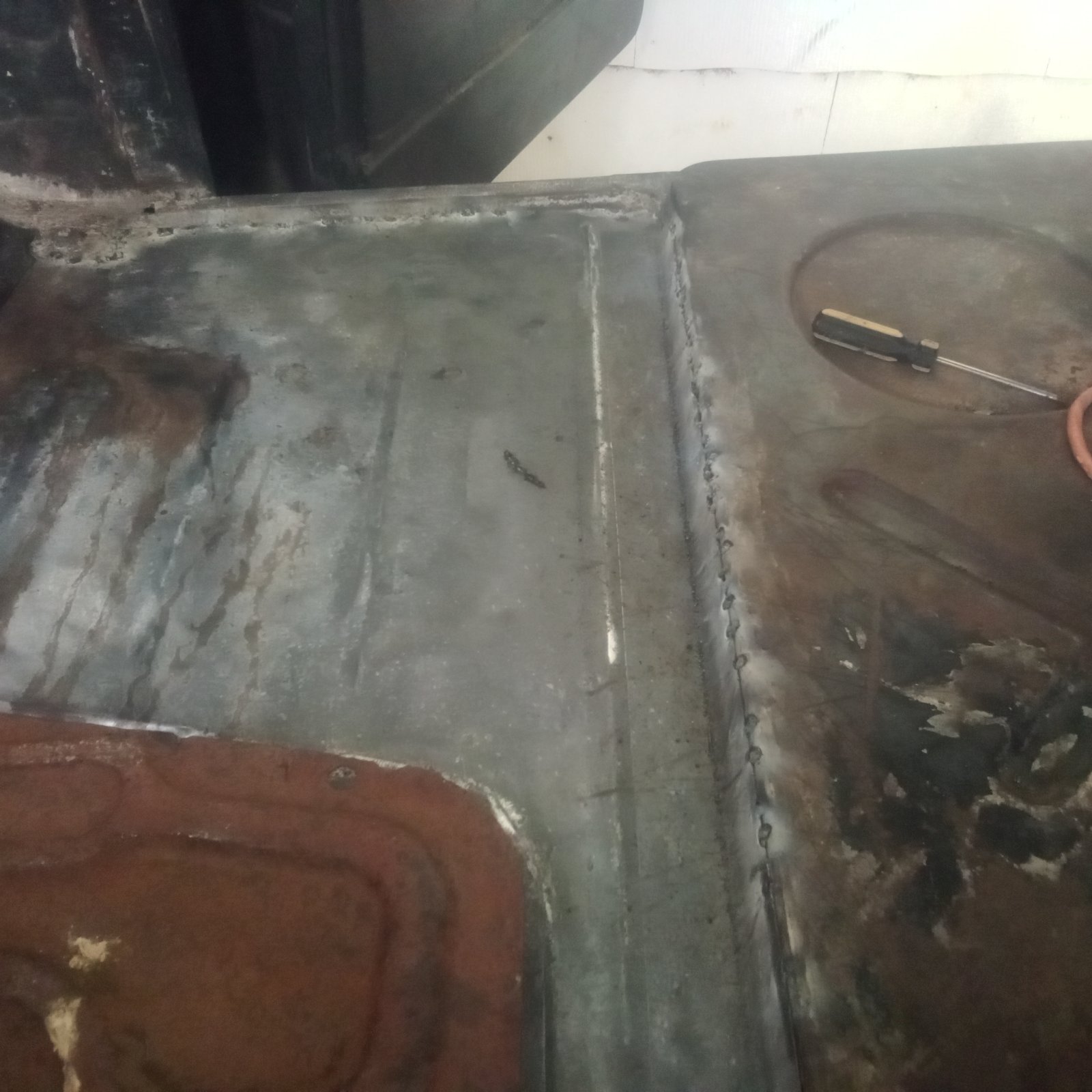

    I have a internet friend, he bought a cheap welder from amazon. I know it could do both mig & flux.
    It never worked when he got it & had to return it .... no idea how it all worked out in the end.
    One welder I never hear about is Forney. They are American made for more then 100 years. Parts are available.
    That is what I bought on a clearance sale .... making room for next years model.
    Because I never owned a welder or knew how to weld, I had problems with bird nesting.
    Totally my error.
    I called the service department, they were great to talk to & worked me through possible fixes to try.
    They took my problem very serious & opened a ticket on my machine & setup a return label for me to send back the machine so they could repair or replace it on their dime.
    I thanked them & let me try your suggestions before sending the return label.
    I fixed it by adjusting tension .... forgot about it. A week later they sent me a email inquiring how I was doing ..... all was fine so they went ahead and closed the open ticket on it.
    I call that excellent customer service.
    So I'm just throwing Forney out there as a possible machine.
    Earlier I said I like fluxcore, I weld much better with gas. Gas is a better weld.
    The Forney I set my digital heat at 17, wire speed at 14.5
    I think this floor pan is 20 gauge .... thinner then 18 anyways. I am only getting the pan tacked in place And ran out of wire here. I have not burned through, it leaves a brown soot & tiny little ball all around.
    .030 wire takes more grinding. Gas is better! IMHO, the Forney is a good machine, I can set it wherever I want for what metal I'm working with. When you're working on a Dodge, flux is good enough!
    To be fair it will be finish welded, seam sealer both sides before paint, then insulation & carpet.
    I have a small 55 CF bottle of gas set in the back room for when I need gas .... jobs like this I do not.

    13 yrs. ago I bought my Miller 140 Autoset for $700 which included a cart and a full tank of 75/25 80 size. I don't get my tanks refilled and returned, they simply swap them so I never have the issue of tanks getting too old.
    If I'm building a car I go through a lot of wire and gas. But my welder sits a lot between cars. If they swapped me a tank that was too close to being out of service I'd pass on it, as I wouldn't want to end up having to buy one again! But they've never looked at the dates when I swapped for a full tank, so not sure how that happens?
