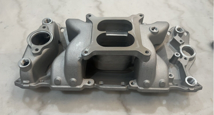

    Has anyone tried one of these generic "jewels?" Yes, I performed the due diligence to search for previous threads. No manufacturer is listed so, it's probably chinesium. This is on eBay for $177.00 +
    It sure does look good, but so does bait, hence the post (more due diligence).
    I'll probably end up getting an Edelbrock. I was just wondering if anyone had tried this "too good to be true" offering and what their experience was.

    Fitment would be the only issue for me. See in the photo you attached, how the threaded coolant ports aren't centered in the casting pad? That would be my only concern.
    I've used some chinesium intakes on previous vehicles, both carb and EFI, never had an issue with fitment, and they are usually direct copies of a major brand intake/model so the flow is usually quite comparable.

    Looks okay, except for the (fuel injection?) bosses on each runner.
    That would be a deal breaker for me.

    It's more than likely a Professional Products brand manifold which is pretty much a Chinese rip off of the Edelbrock design. I have one of these on a 350 in my 56 Chevy. It was on the car when I bought it. It works fine (seals up and the engine runs fine). I understand the attraction of a cheaper price as the Edelbrock intake is now $345.95 at Summit, but the Motor Trend Engine Masters show tested this manifold against the Edelbrock and Weiand manifolds and it was down about 10 horsepower from the Edelbrock, which was deemed the best.

  18. My friend bought an imposter air gap and the aluminum was so porous it weeped oil between the carb and distributor. When he replaced it with a real edelbrock air gap, the engine had better manners, better vacuum signal and actually got a couple more miles to the gallon, plus he wasn't chasing an oil leak.
    Personally I'd never buy one, you can buy used real deal intakes for less than the cost of that offshore junk, they make less power when compared to the real deal and it's doing nothing to support the people and country you live in.

    Looks like it's for them vortec heads. The four bolts next to the heat riser in the center of that intake, are on [​IMG]a different plane. My old ass can't remember the exact year.

    Not Vortec heads; the '87-'95 heads use this setup.

    Heathen you’re correct, T.B.I. Heads
