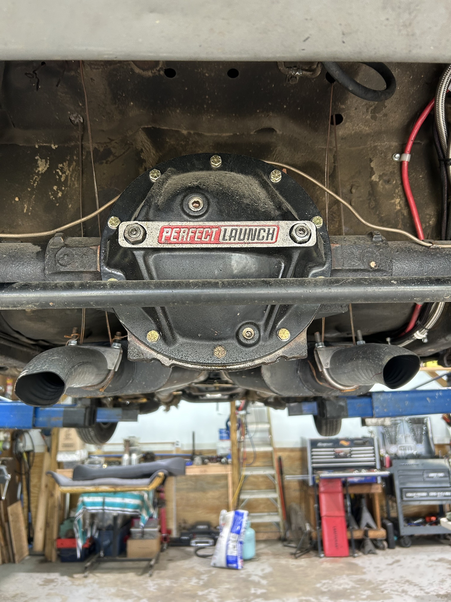

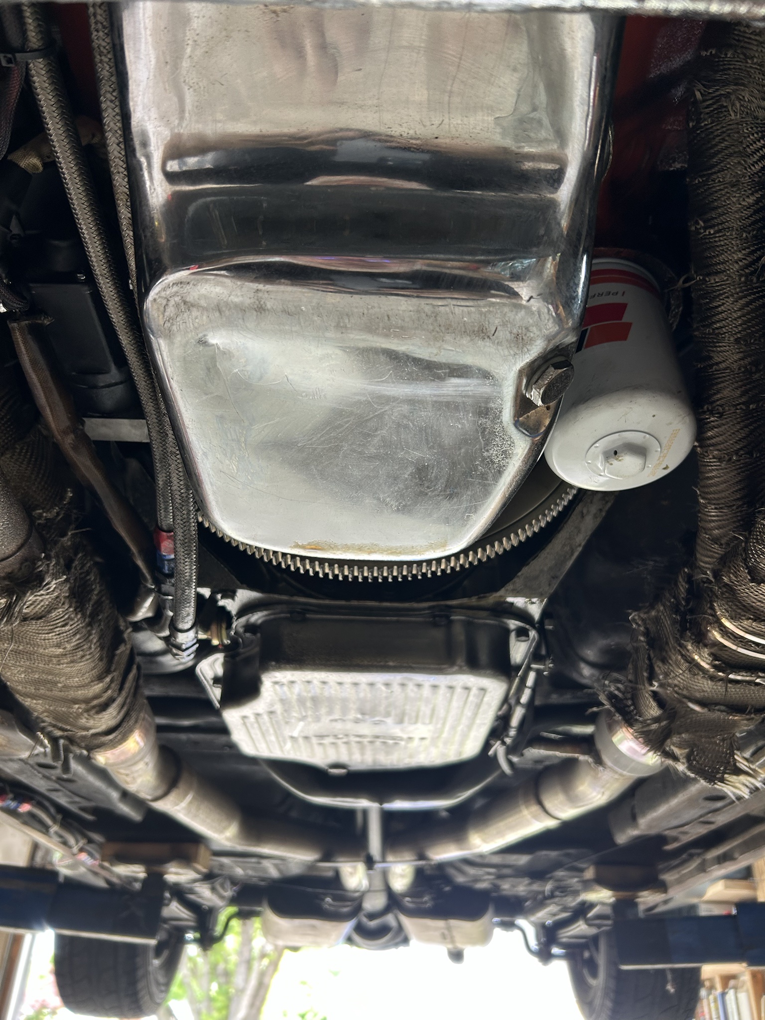

    What I have under it now is a true dual setup in 2.5", but it's butchered. It looks a lot like the kit Jeg's sells, minus the crossover. I've already replaced the headers in the pic with some mid lengths because the longtubes were cooking the starter. Apart from the 1/2" size difference, it SHOULD fit OK. I may or may not run tailpipes depending on clearance. My buddy has a 69 and cannot get 3" tailpipes to fit.
    Here's what's on it:
    Here's the Jeg's kit:
