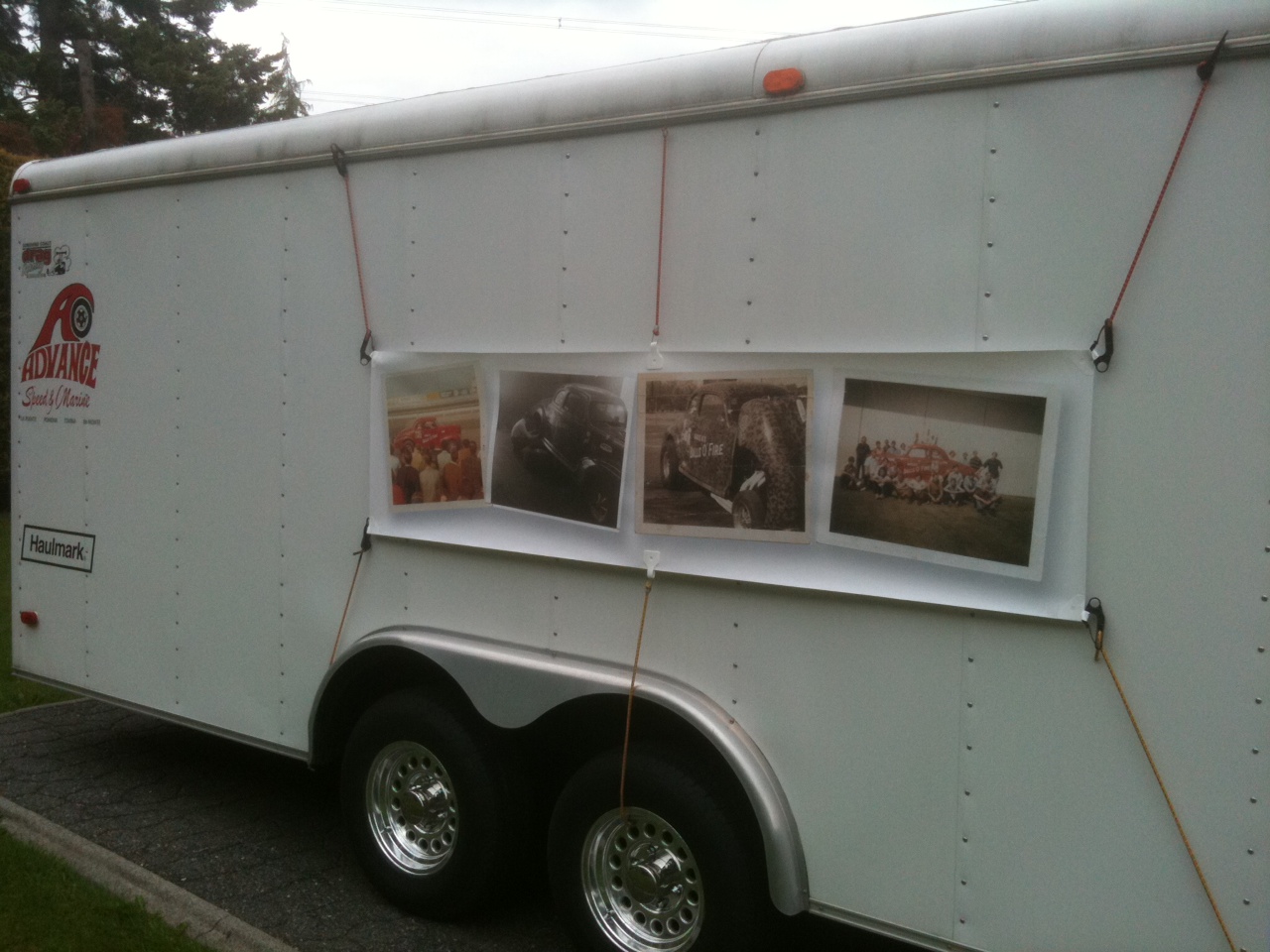

    we made this display of images printed on plastic/canvas to put on the side of the trailer , i also have 2 large framed posters and other memorabilia to hang from the rain gutter......any other ideas?

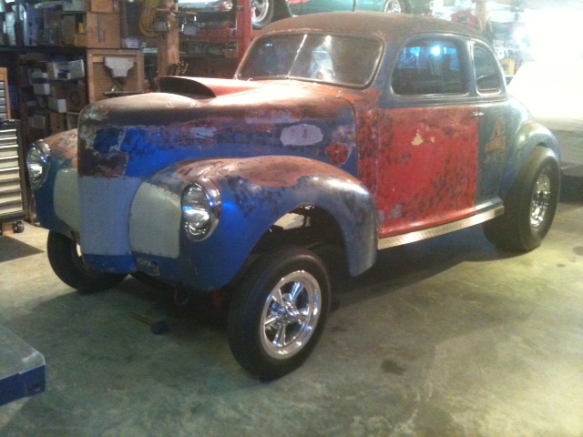

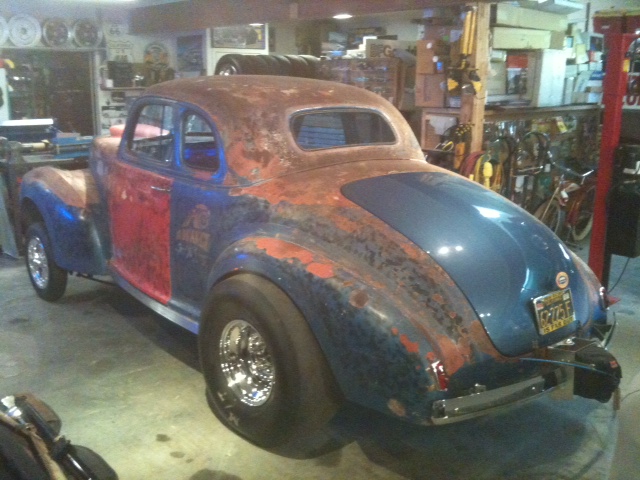

    just finished taking care of the front end attitude , raised it up 2 1/4" to where it used to be
  6. dogbreath
    Joined: Nov 27, 2010
    Posts: 16
    dogbreath
    Looking sweet! Looks fast just sitting there :)
  7. TheTrailerGuy
    Joined: Jun 18, 2011
    Posts: 392
    TheTrailerGuy
    That thing just looks soooooo .... bad. Just perfect to look at. Congrats.

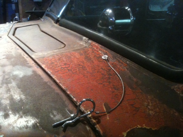

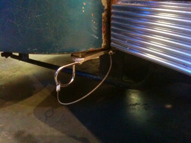

    todays work........got the tilt front retaining pins and studs mounted with aircraft cable tethers

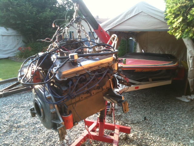

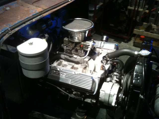

    more tales of woe...the engine shop building the main engine(ex motor ) and the spare "beater" engine caught fire( not serious but will delay the dyno test runs for a while) , so i ran out and bought a 455 that is in a flat bottom ski boat, sounds great, 180lbs compression and 60lbs oil press. this one is going in the car for now
  15. 5w32
    Joined: Jan 17, 2006
    Posts: 1,082
    5w32
    here she is , stripped of all the marine gear. ready to go in!
  16. 5w32
    Posts: 1,082
    5w32

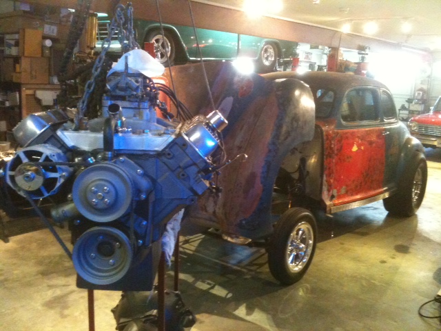

    wow what a thrash, the motor is in! lots more work to go.....first time the car has had an engine in the chassis since 1974!

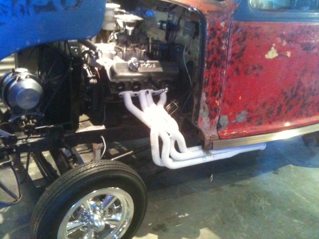

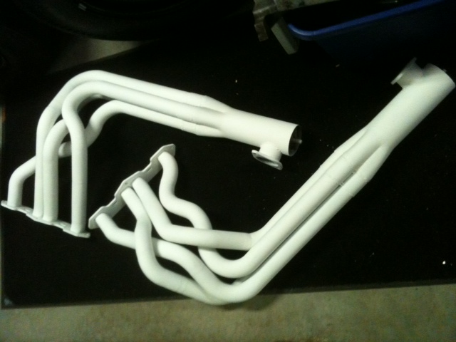

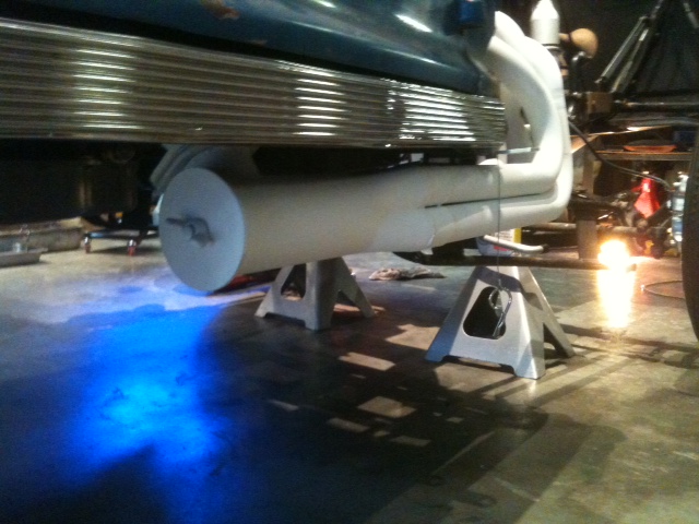

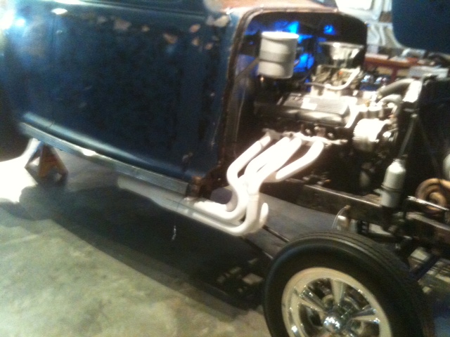

    sandblasted and painted the headers with vht white today
  20. 5w32
    Posts: 1,082
    5w32

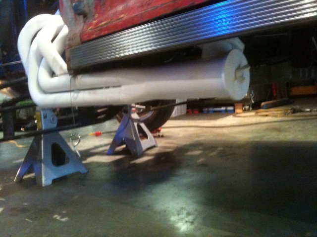

    headers in and exhaust hooked up to the glasspacks!

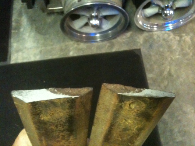

    put the front spring back in yesterday, tightened it up only to hear a really loud snap!! here is the main spring , looks like its been crack for a long time! good thing it didnt go SNAP when i was driving.....
    thanks to pacific spring in langley, they built me a new main spring and i had it back in and on the ground the same day!
  22. chief-imagineer
    Joined: Nov 26, 2010
    Posts: 35
    chief-imagineer
    Egad!!! That might have started when the aluminum Olds spicer rear end exploded. When the ends of the original lift bars were ripped off during the incident, the front end jumped over a foot off the ground. The front came down really hard. We checked the camber and distance between the spring eyes and all measurements corresponded with the originals. The spring was removed and visually inspected. It appeared to be alright. I guess we should have had it magna-fluxed. However, that may well have been the beginning of the eventual complete fracture. If so, it sure lasted for a hell of a lot of passes over the years. Oh well, it was out of warranty anyway. :) <?xml:namespace prefix = o ns = "urn:schemas-microsoft-com:eek:ffice:eek:ffice" /><o:p></o:p>
